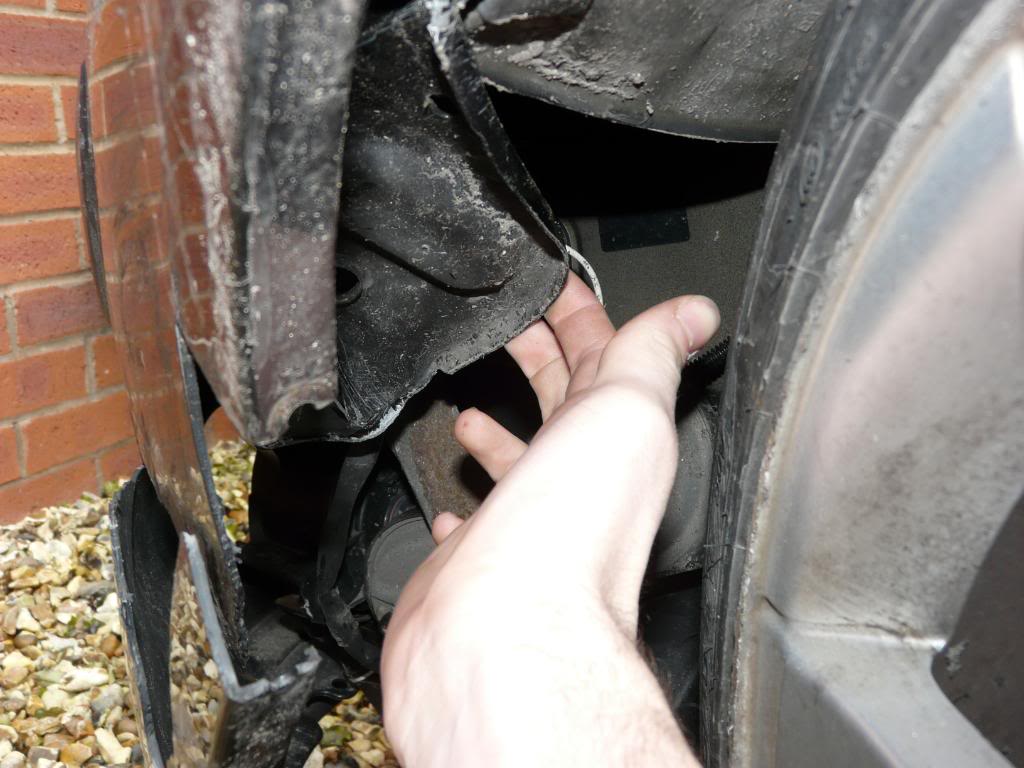

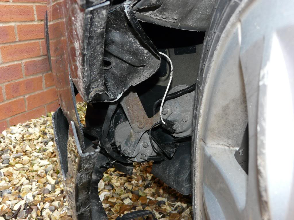

just had a look in the arch, the arch liner has been smashed off all the fog lamp brackets and horn brackets are bent and there is a big piece of metal that is bent too
Note the big piece of metal im pointing too

The slam pannel, ahh ryt, not good then,.
That was the last thing that i can find wrong with it just by looking at it, does the slam pannel just protect the car from impacts?

Thats pretty much buggered. The whole front of the car has been shunted over and the chances are its probably done suspension and subframe damage. The rack is propered FUBAR!

that will be wrote off. i say subframe rack bumper horn bonnet wing headlight , all the stuff thats bent needs redoing.

The part you were pointing to is the valance, it's not that bad.
Shocked it snapped your steering rack tho! Very random.
Racks are around £600 from Renault and plus the rest I can't see them wanting to repair it.
Keep us up to date with what the assessor says and throw me a pm if you need any advice, settlement or claim wise.
really £600 for a steering rack? it looks like its the bit that bolts onto the subframe that is broken can i not just replace that?
No, because at that side the nut is welded onto the rack, so you just bolt the bolt through the back of the subframe into that and it holds it in place, the passenger side is just bolt through and nut.
