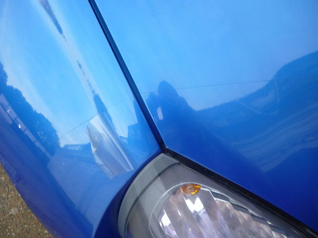

This car had the old armourfend ( IIRC?) & with age ( only a 5 plate ) the edges have become loose on all the bonnet & wings-

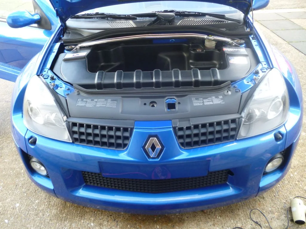

I was hoping that my 75p Hairdryer could work its magic!
During removal-!
Phase 1 of the front end done!

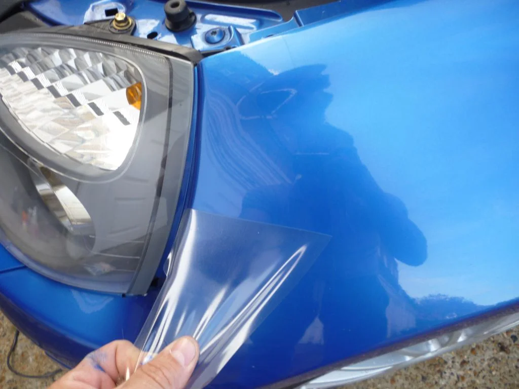

Its worked-
All it left was a line which wiped away- the key as with all stickers is to get the glue soft so it all peels away!
the paint underneath is as new- apart from one or 2 chips that peirced the film & the paint-
All that is needed is one run over with the rotary to bring the paint up to final finish-

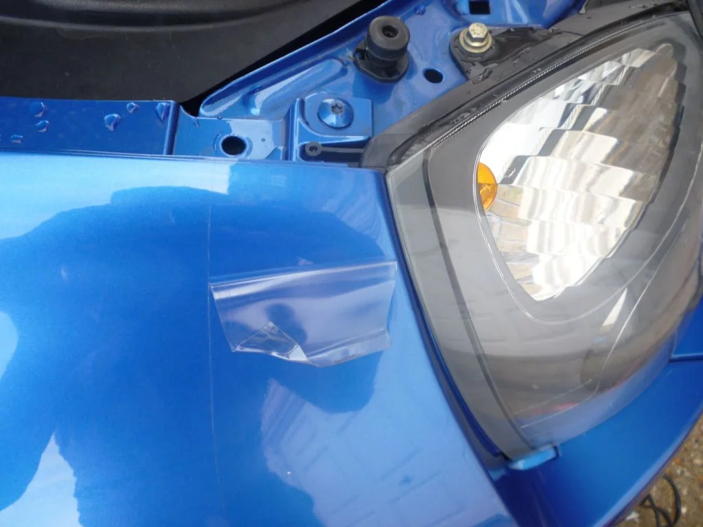

The last strip of film took a lump of paint off the bottom of the bumper-C**T
Will have to get the base of the bumper done :(
My only gripe about the armourfend on mine is that the edges collect dirt as illustrated in your pics Steve. Glad it came off without too much trouble bar the bumper.
