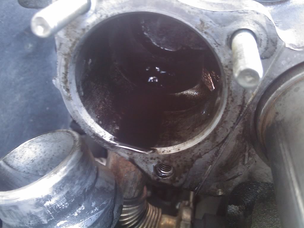

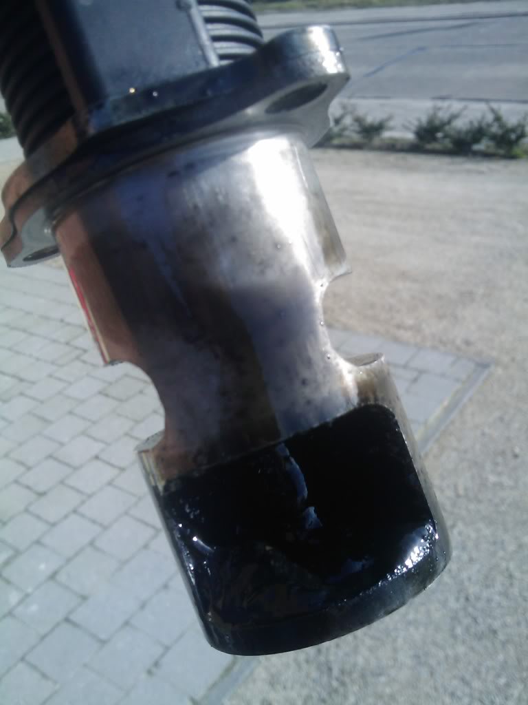

Doesn't sound like the EGR valvue at all, but if you want to rule that out here is a guide: http://www.renaultdci.net/index.php?option=com_content&view=article&id=47&Itemid=55
When you take the EGR vavlue out and if it looks like this (Do note drive):
Then it's most likely your turbo.

Its pretty easy to take off, just need to be handy with spanners and ratchets that's all. The guide is step by step.
Funny how it only likes for 30-40 seconds after start up. I suppose you could rule the turbo out by doing the EGR value.
