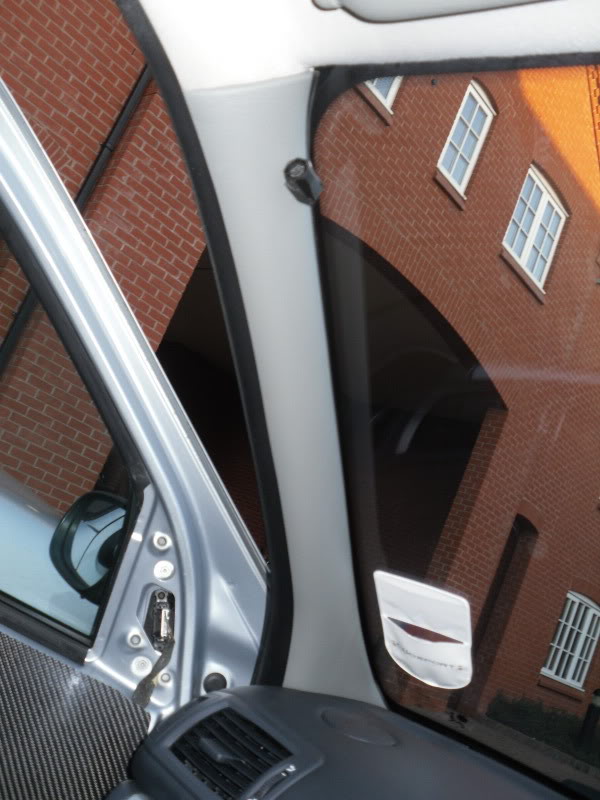

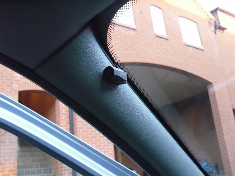

About to remove the A pillar and headlining, quick question, does anyone know on the A pillar if the sensor for the alarm comes apart easily at all and if so how?

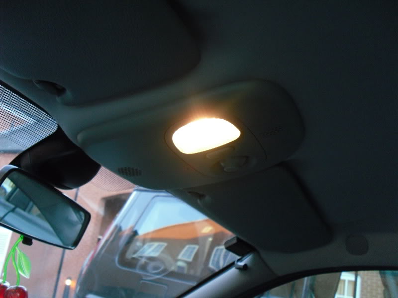

Also for the interior light, what wires/connections are under there? Is there enough play on the loom to be able to tidy away some where? Same goes for the aerial?
Pull the alarm sensor out of the bracket and they'll more than likely be a screw under there.
Pull the door seal off and they're one clip acouple of inches down from the top, pull up and out done.
Never had the headlining out so don't know the other two sorry!
