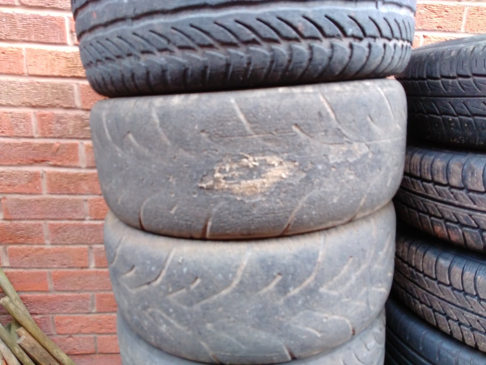

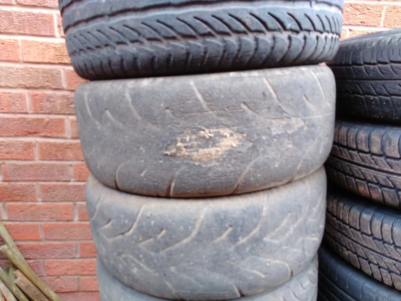

I'm pleased that I finished off my old A048 from my Elise (race use) last Sunday on the Targa Rally at Wethersfield Airfield. Yes, an event running under road rally regulations (but all within the confines of an airfield) so if the MSA guidance had been fully communicated I wouldn't have been able to use my A048 tyres! No longer an issue for me going forward.

Interestingly, I've just been sorting tyres after a 12 Car rally last night - I noticed that my shot A048 are E marked, but they are definitely on list 1C, which the MSA are stating are not for road use. So not all E marked tyres can be considered road legal. Again, no definitive definition of what constitutes a legal road tyre.
