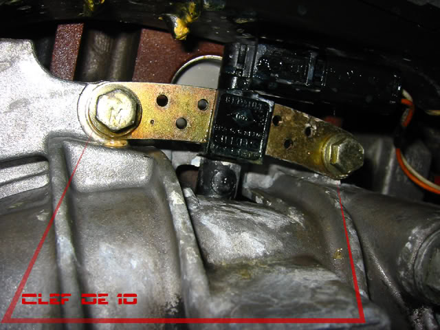

Cheers guys for the pointers! Ive heard of this TDC sensor possibly being suspect. If its cheap, I might just replace it myself if its easy to do so - keep me going till it gets seen to by Mike.
BTW, where is the TDC? Perhaps a dodgy connection that I can check? Runs absolutely fine once started. Infact, the moment the car starts up and `catches` its perfect - no unsteady idling or anything.

Mate, the TDC sensor is on the top of the gearbox at the bell housing end, above the flywheel. Its held in by 2 10mm bolts, not that hard todo to be honest. If you are gonna disconnect it make sure you've got the ignition off, a bit of electric cleaner, tighten the terminals usually helps.
Thats the one.... Not my photo, been on the PC for ages dunno where from...
Common as muck the TDC sensor failing
Cheers for the pic Tom! :)
