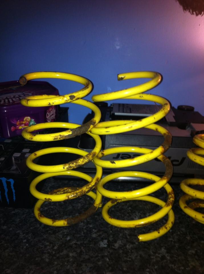

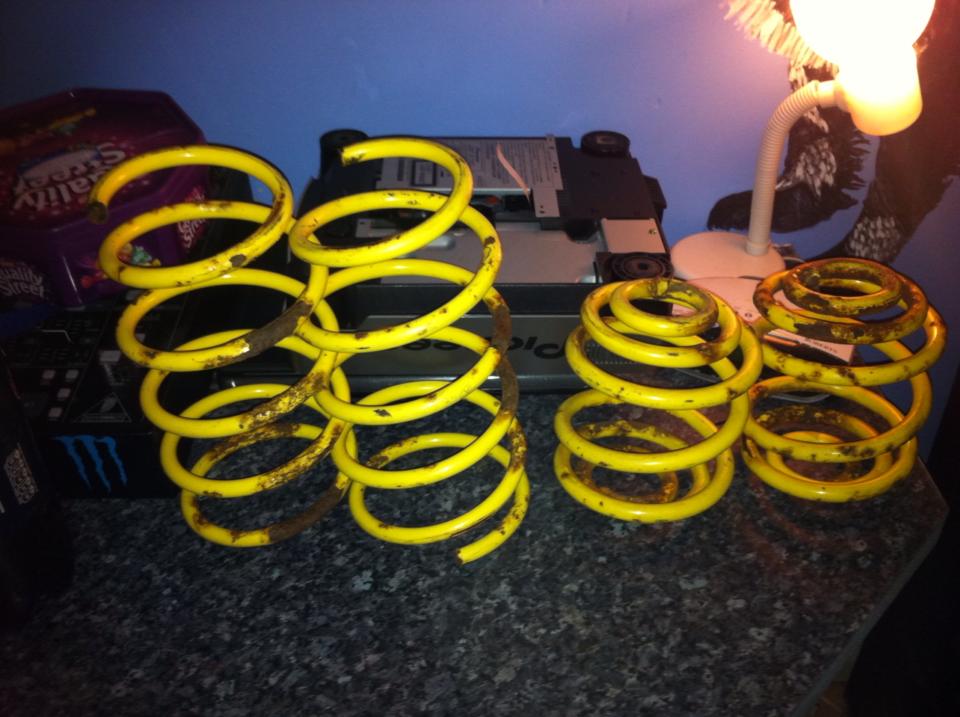

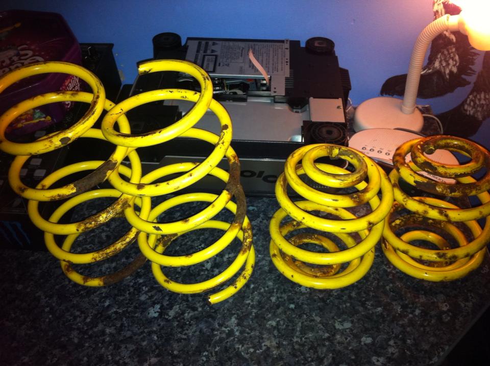

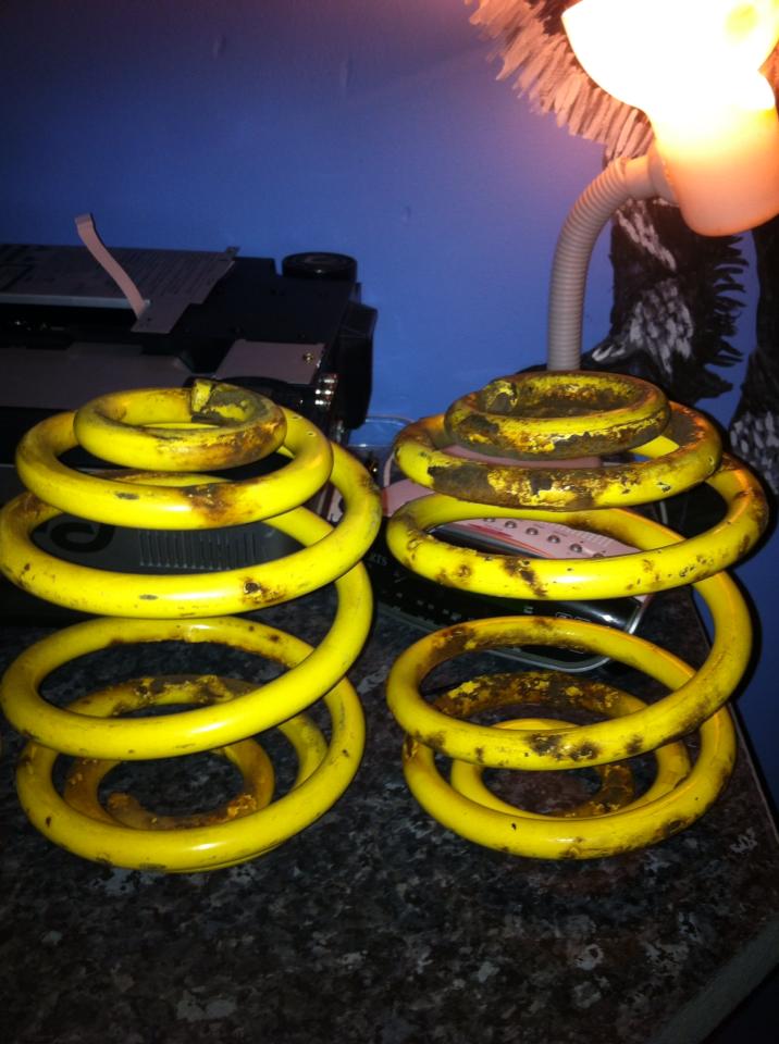

Thanks for the replies everyone, many people are saying the apex are a load of s***e , but I bought them today anyway for a daft £30 (silly not to relay)! They need a bit of a wire down, and a coat or 2 of hammerite which ill do tomorrow. These are to go on my 1.2 mk2 extreme, The lad who I purchased them off did not know the drop but he had them on 17" (like me) and he said he got no rubbing, which I'm pleased about, but I'm sure these are a 60mm front and 40mm back! So now I am not sure if ill be ok on the standard dampers and he seemed to mention that I may need up rated wheel bearings ?? (if anyone could answer this for me I would be thankful). The part Number I have from them is: "150-40601 VA 72/06 *" which strangely I can't find on the apex website (yet they have the apex logo all over them) I have enclosed a few images of them here:
1)
2)
3)
4)
Thanks everyone!

i currently have apex springs on my 1.2, apex only do 60mm springs and 40mm springs for clio 1.2, 60mm on 17's would rub, thats why i got 40mm but now i run 16's for coilovers. the springs you bought should just be a straight swap with the originals theres no need to touch the wheel bearing atall duno what he was on about and those springs are defo apex got same set, i cant get over how dodgy the back springs look when there in place lol
i currently have apex springs on my 1.2, apex only do 60mm springs and 40mm springs for clio 1.2, 60mm on 17's would rub, thats why i got 40mm but now i run 16's for coilovers. the springs you bought should just be a straight swap with the originals theres no need to touch the wheel bearing at all duno what he was on about and those springs are defo apex got same set, i cant get over how dodgy the back springs look when there in place lol
thanks for that reply, glad to hear from someone who has the same car and springs as me! Unfortunately we don't know how much they actually drop because he got them given to him, so there is a 50/50 chance they could be 60mm! If they are 60mm then I'm knackered as I have 17"!
