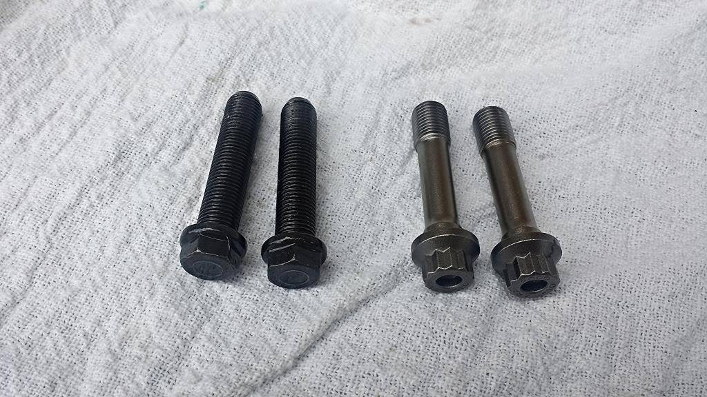

Factory rod bolts are sh1t, get the changed for a set of ARP's.

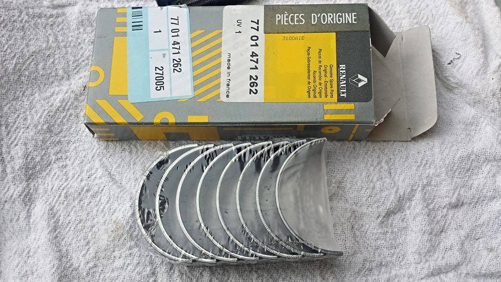

I fitted a set to mine along with a set of bearing's.
Factory bolts on the left.

Rod bolts, check and replace shells, big end and mains if needed. Mod oil pressure relief valve and check plunger is free to move.
