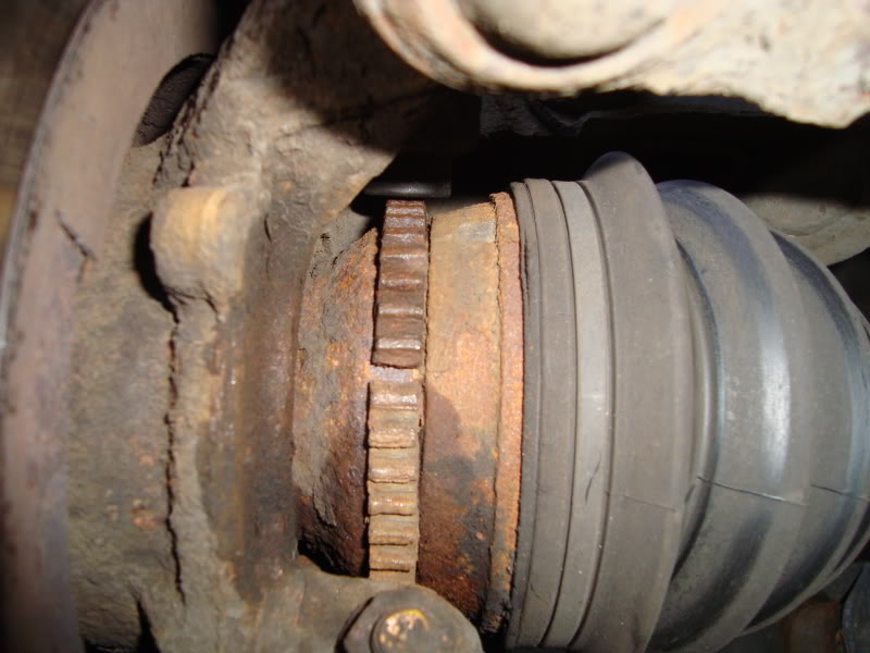

Right, just been inspecting the fronts and found this;
That's the second time in a row Kwik Fit have mis-diagnosed a problem or not found one at all!
So can these rings not be fitted by myself?
Yes they can be fitted by you, but unless your ok with jobs like this, id get a garage to do it....You need to heat the new rings with a blow torch to get them on...mine is being done on Wednesday, let you know how i get on...
Seems a simple enough job, but does it not fit at all without being heated up?
