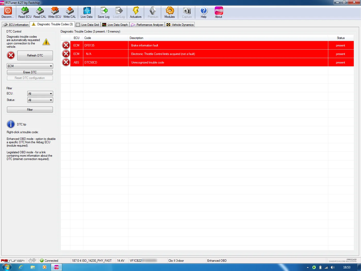

Hi all,
I’ve got an intermittent issue, and in fact the previous owner warned me about it when I was buying the car and said that they’d failed to get it fixed and simply put up with it! Unfortunately I am not the type who can just ignore a problem, now I know it’s there I have to get it fixed.
What happens is that midway through a journey the ABS + ESP + Service Lights all come on simultaneously. Turning the car off and on again turns them off. I’ve had the lights come light up on two successive days, but then not come on for two weeks.
When the lights are on the brakes still work etc, but I think I could hear the ABS pump firing every time the brakes were used for the rest of the journey (I need it to happen again to confirm it was the ABS pump and not a noise in my head!)
So I’ve plugged my RSTuner in (Firmware 1.85 with the Mk2Ph2 ABS Module) and below are the errors it found:
Note that at the time of scanning the lights were not illuminated; the error had happened on a previous outbound journey but then cleared by the return journey home. Next time the lights illuminate on a journey home I’ll leave the car running and plug the RSTuner in whilst the lights are still on and the error is active rather than previously stored.
Any ideas on what might be causing this? Do the error messages mean anything to anyone?
Trying to think about what might be the cause I remembered that one time when the lights came on I had just hit an unavoidable bump. Also because it’s both the ABS + ESP lights coming on I’m trying to think for a common factor between the two systems, and my idea is that both systems use the wheel speed sensors… and a wheel speed sensor missing a rotation could indeed be caused by a bump.
However I obviously don’t want to go round replacing sensors at each corner without knowing it’s a wheel speed sensor at fault and in particular which one!
So yeah, any suggestions on things it might be or ways to narrow it down would be gratefully received!

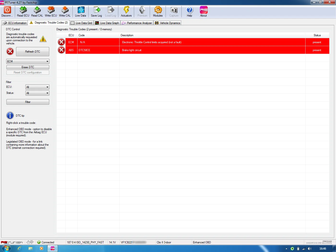

So after clearing the error I had it happen again a couple of times. The noise that I thought was the ABS pump was infact in my head (am I going mad?!) and I gave it some welly to check whether the ABS & ESP were still functioning with the lights lit - they were not.
I then finally had it happen on a journey home so once I got in I grabbed my garage laptop and plugged the RSTuner in with the car still running and the lights on.
As you can see, it was DTC50CE Brake Light Circuit error that was active and bringing the ABS + ESP + Service Lights on.
Some searching on here revealed that this error is because the car has noticed that the brakes are on (from the brake servo I guess) but that the brake lamps are not on :eek:. It's warning you that the brake lamp switch on the brake pedal is not working.
I tested the brake lamps vs the pedal on my car and found that the lamps did come on, but I took a good stomp on the pedal to bring them on. Light braking did not bring the brake lamps on. It must have been light braking in traffic that was causing the DTC50CE Brake Light Circuit error.
So I've adjusted the brake lamp switch (guide here) so that now all I need to do is breathe on the brake pedal to make the brake lamps come on.
I haven't yet done enough miles to say that I've 100% fixed it (as I did previously go a couple of weeks without the error) but fingers crossed that's done it...

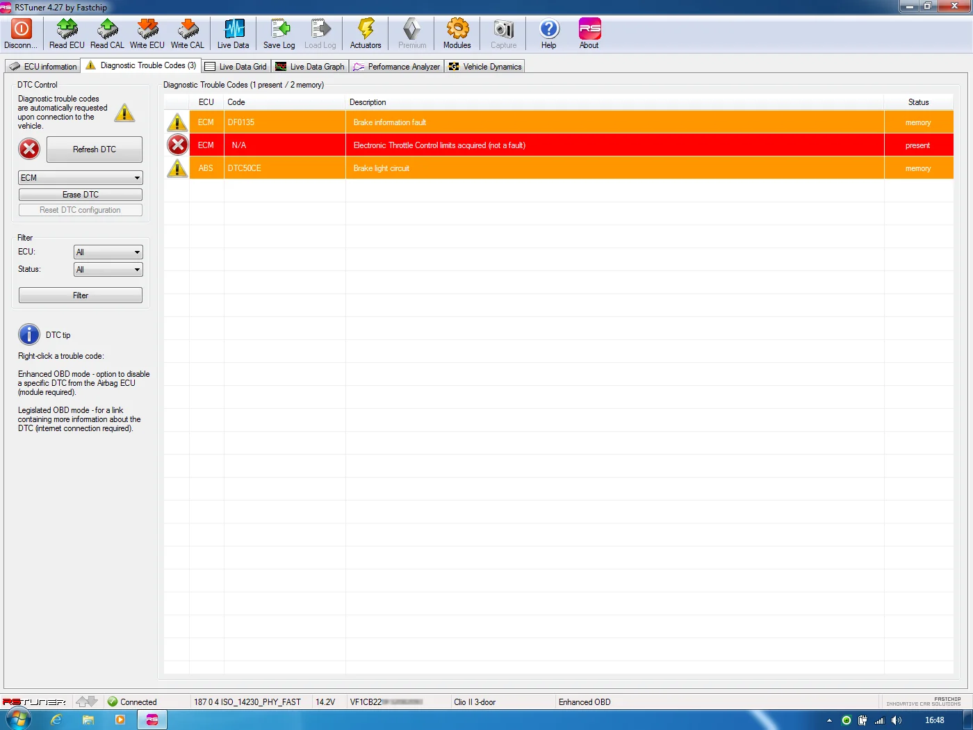

Well today I did not have the ABS + ESP + Service Lights come on... just the ESP + Service Lights.
I guess one light less is progress!
I've plugged RSTuner in and the error code is different, so I'll start a new thread...

Just to give closure:
ABS + ESP + Service Lights was caused by error codes DTC50CE + DF0135. This was that the brake light switch was not sensitive enough and needed adjusting. "The brakes have been applied but the brake lights aren't on".
ESP + Service Lights was caused by error codes DTC50CD + DF0135. This was that the brake light switch was too sensitive and needed adjusting. "The brakes lights are on but the brakes haven't been applied".
If you keep adjusting the switch as per the guide you'll find the happy medium in-between the two errors. I've now not had the error for months!
