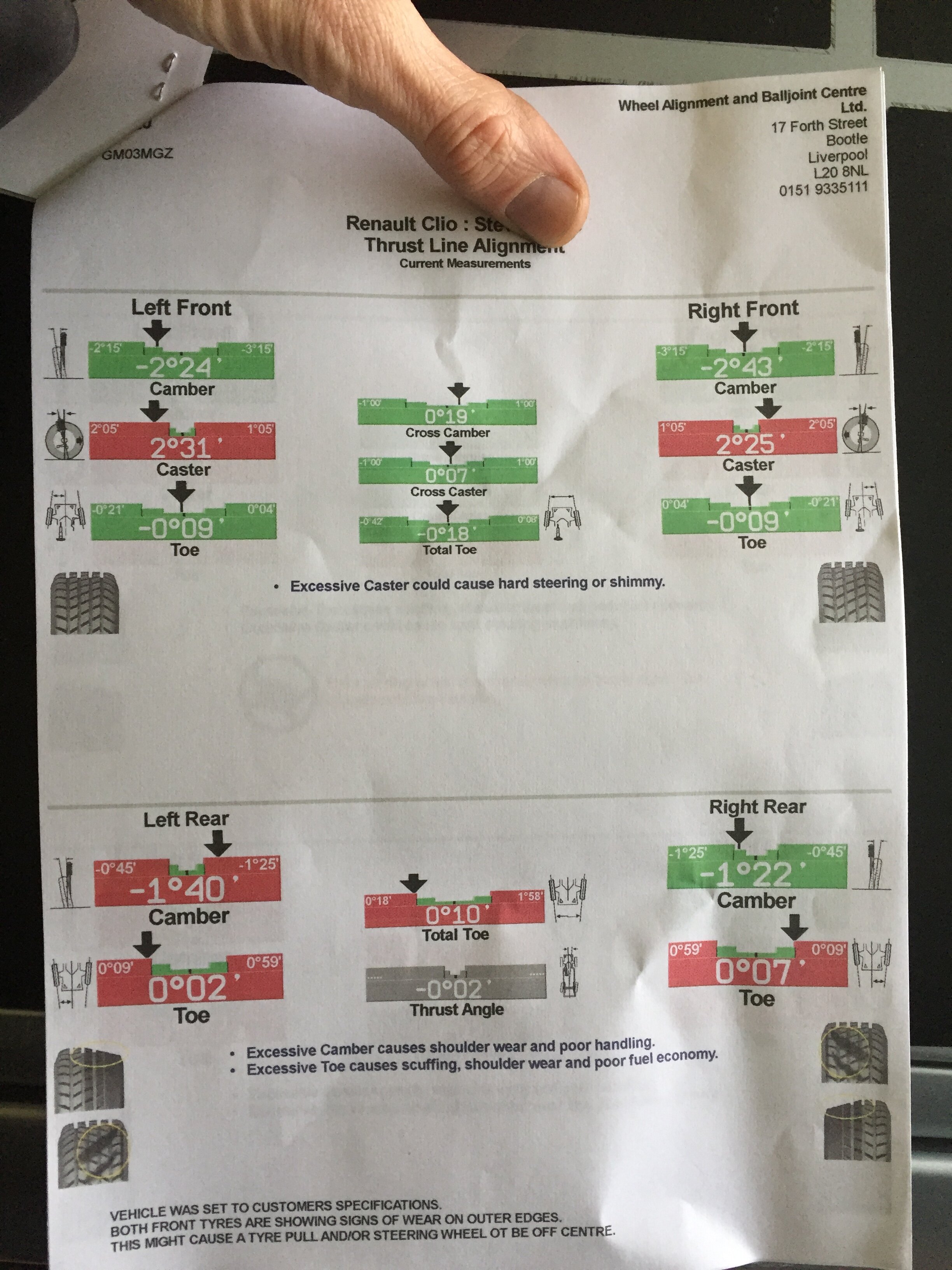

I have just had my Geo done on a Hunter, I have had the front Camber set around -2.35 each side.
The Hunter suggested the front Toe should be -17'.
So this is now what the front Toe is set at -9' each side toatl -18'.
Now the ABS and ESP light are on.
Will this effect the ABS and ESP or is it just a warning.

But this has only happened as I had the alignment done. What I am trying to find out is, Is the Toe angle too much? An is this the course? Can I adjust the sensor?

ABS cables look ok. I have just measured the threads showing each side of the track rod and one is 13.5m the other is 14.5mm guessing this is my issue. Steering wheel must just be slightly off.
stebat
  Clio 172

Is the steering wheel cocked to the side when driving straight ahead? If it's off a bit, then when your steering wheel is straight ahead, your car will actually be turning. The ESC system will then throw a fit when it sees that the steering angle sensor is reporting your steering wheel pointing straight ahead, but the left and right wheel speeds are different.
To begin with this can cause the ESC to randomly fire the brakes (not so fun in a corner), and eventually it figures something is up and disables the systems (with the accompanying lights).

I'm almost certain this is steering angle sensor related. If it's coming on when driving the yaw sensor is detecting the car going straight but the angle sensor will be slightly off, so thinking there's a steering input and it's confusing it. It's likely that if they've adjusted the toe it's moved the steering wheel position slightly.
Wouldn't have thought it would throw an error if unless it was moved massively mind you. Just needs recalibrated though and it'll sort it. Pretty sure it can be done on most decent diagnostic machines

I thinks it’s defo the steering wheel just out 👍🏼

I’ve booked myself in to Blink motorsport next Friday. I’m not going back to the other place to mess about ( plus I wasn’t happy with the marks left on the alloys by the Hunter attachments). If it’s done properly and Blink align the steering wheel it should go, if not then I’ll investigate further.
