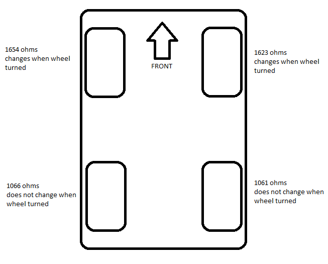

Not sure if this helps but i went round all my abs sensors tonight with my albeit crappy multimeter.
Not sure if this shows any issues?
Help?

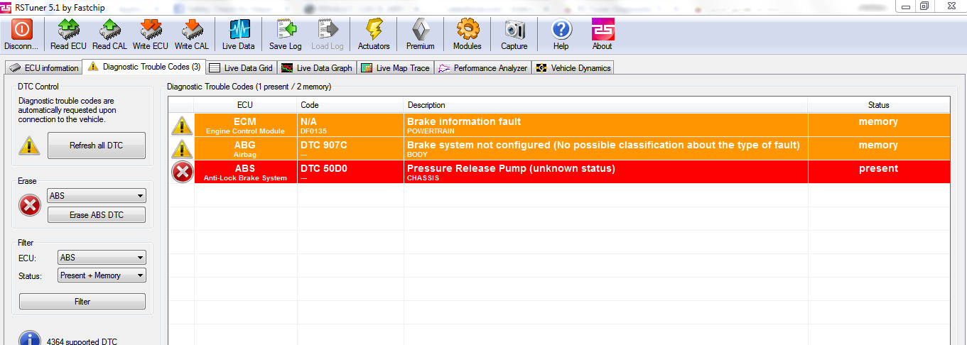

Ok guys.....popped on an RSTuner and now I am a bit worried.
Can someone please help?

Start with a proper diagnostic session. No disrespect to RST but it's not CLIP/AutoLogic so go to someone wit hone of these two systems. After that, you'll know what is actually wrong and can concentrate on fixing it from there on.

Have checked the resistance of all sensors and none are open or anything.
