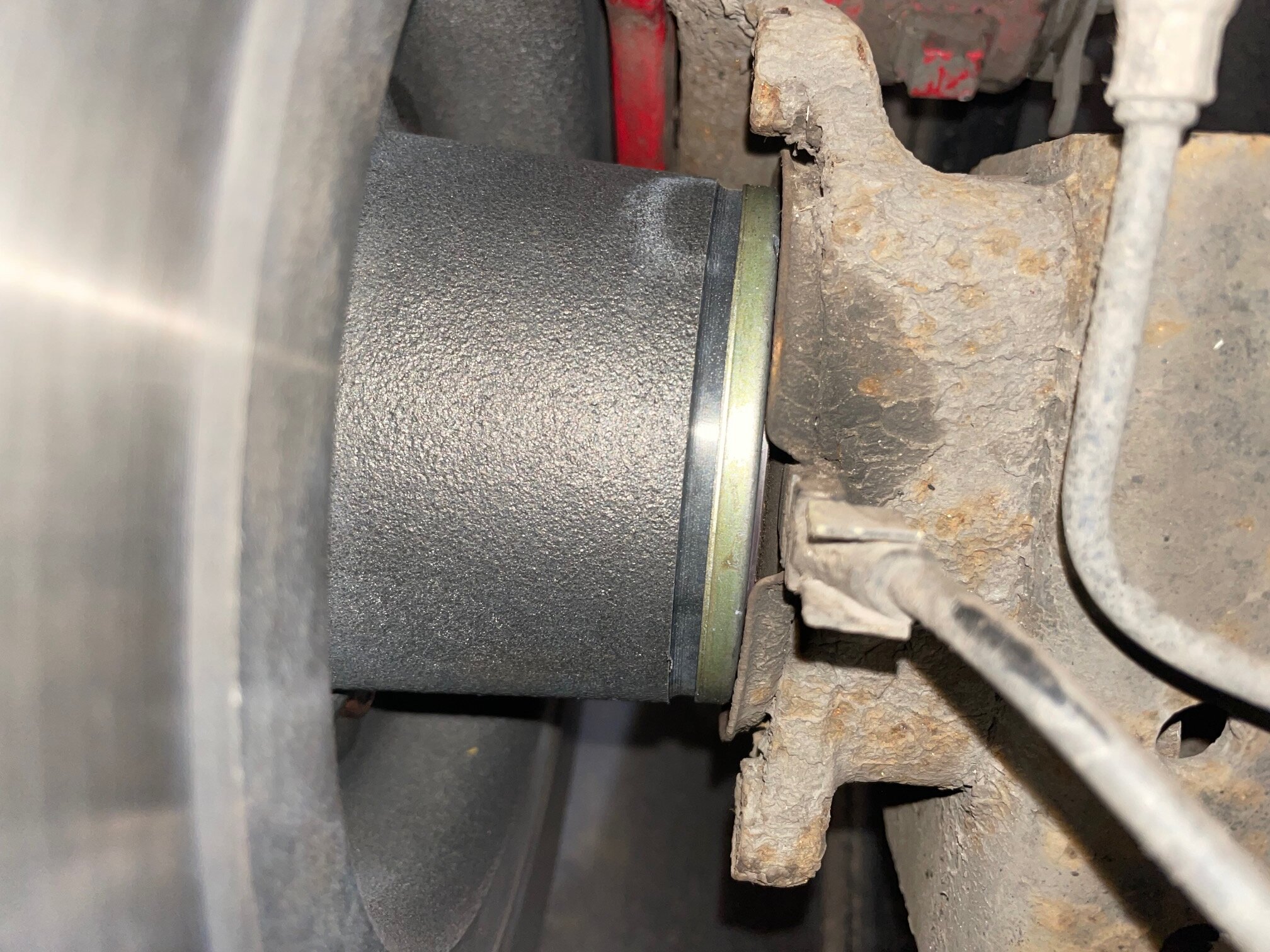

What condition are the abs rings?
The rings on the rear discs are new, the brackets the sensor fits in have some surface rust but look decent enough.
I am tempted to swap out the brackets since most things online point to them but I just can't believe they're causing the issue, when people post photos of theirs online they are properly rotten which mine aren't.
jenic
Genuine Renault, it's a 200, they don't have a spacer (I really hope they don't, one didn't come off 😂 )

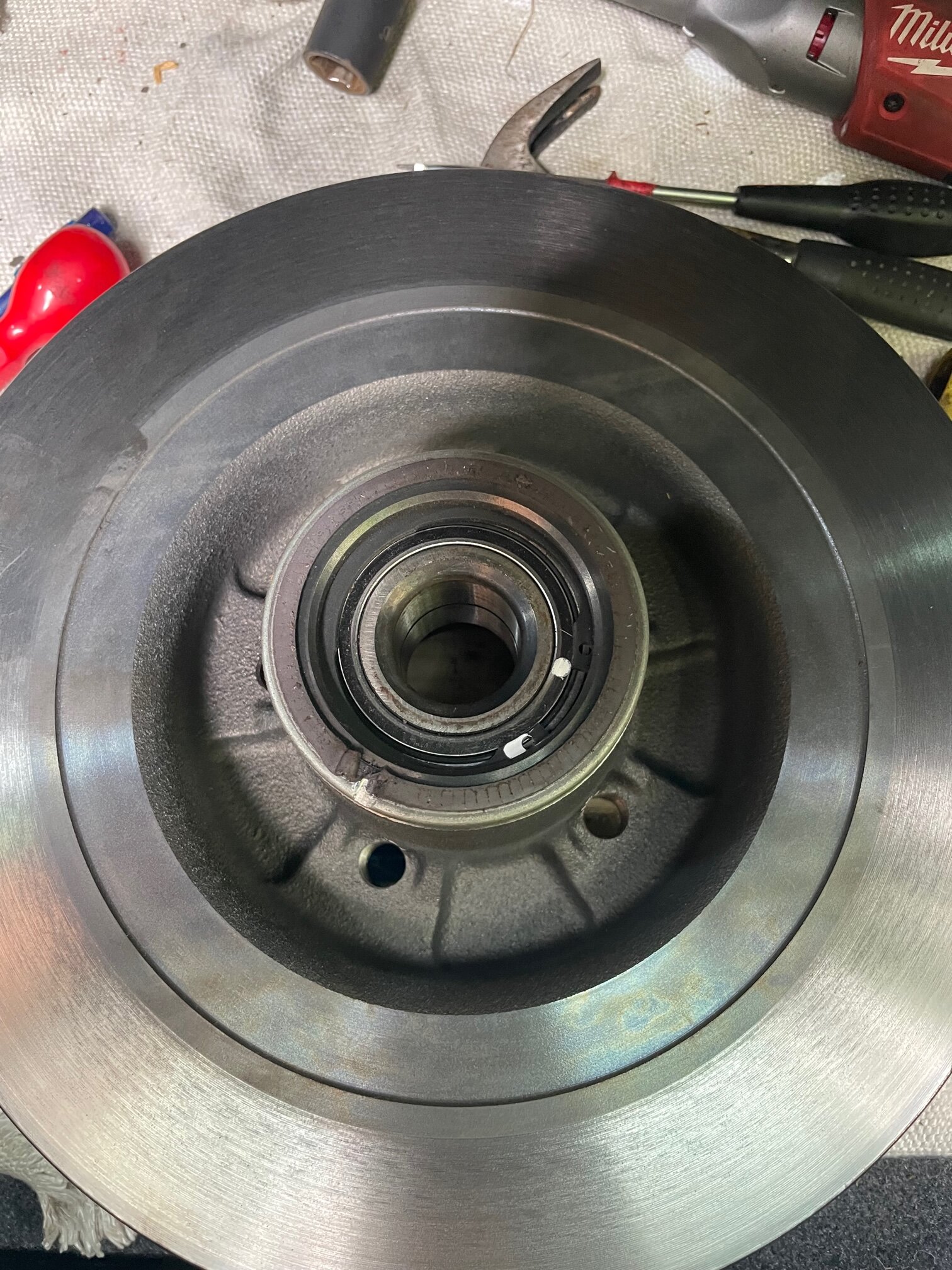

Well mystery solved, kind of.
I noticed a slight imperfection in the ring on the rear drivers side so took it off, all my focus until now had been the other side as that what the original code pointed to.
Pretty shocked to find this:
The sensor bracket doesn't look bad though, and the disc was torqued to spec and seemed to spin freely. I can only assume something got caught between the disc and hub, a small stone or something, and caused the damage before vacating the area.
Ordered a new ring anyway and will give that bracket a right good clean up too.
jenic
Imperfection 😅
Something has properly gouged that.
Definitely wasn't damaged in transit?
It wasn't like that when I got it, I'd have noticed, so it's my fault.
I should be clearer, from the outside it looked like an imperfection:
Brigsy
  T.Turbo
Easy done that. Ive just caught the same type of abs ring when pressing in a wheel bearing on another car and it give the same issues.
  306td
As the rings are a series of North and South magnets, there's been a bit of rust or shard of metal on it when you've picked it up to fit it. Always check the rings for foreign matter immediately before fitting.
