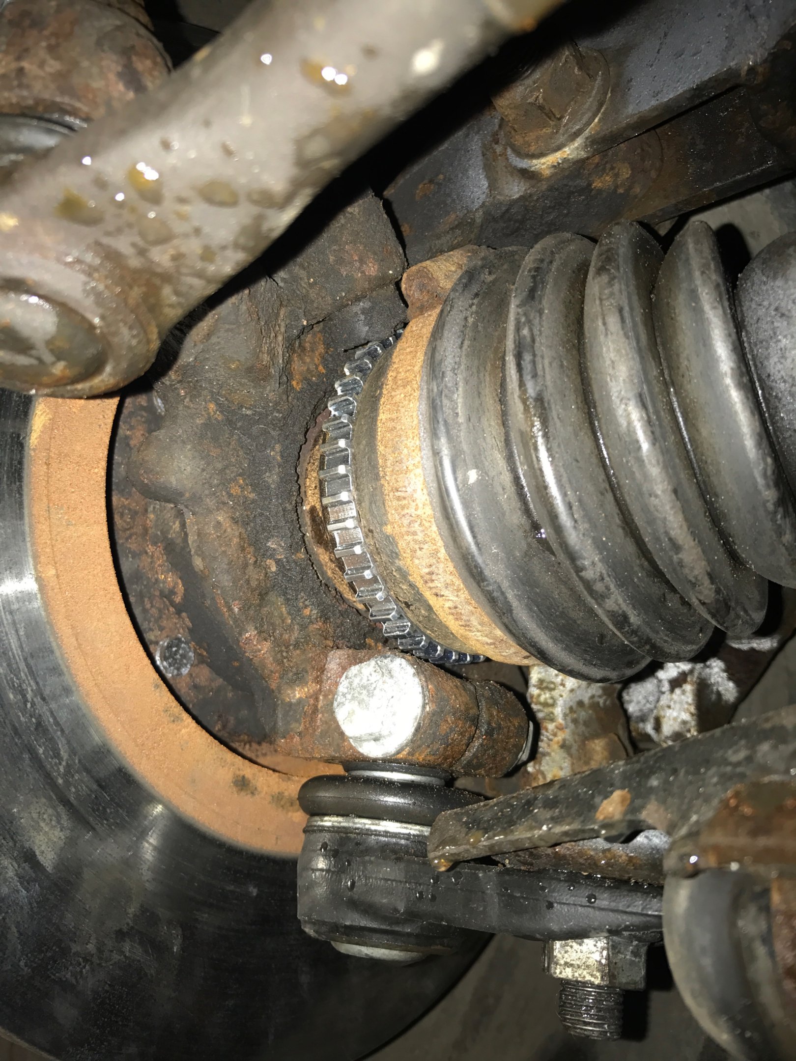

I changed mine a couple weeks ago, very easy job!
- Slaken the hub castle nuts on the ground (30mm).
- Jack both sides up on axle stands, wheels off.
- Remove the castle nut, and both bottom strut bolts (21mm).
- Remove the driveshaft you might need to use a mallet or punch to help knock it out the hub.
- Pull the driveshaft to one side and knock off the old ring, if it's cracked it should come off quite easy.
- Clean up the drive shaft using a steel wire attachment or rub it down by hand to remove any debris.
- Put a thin layer of grease inside the new ring and on the shaft to help it on, slowly tap it on evenly try not to damage the ring.
- Refit in reverse order, make sure to re-torque everything (Castle nut 280nm, strut bolts 180nm)
I changed both rings whilst I was at it, for the sake of a couple pound it's worth doing especially if you have camber bolts etc as the cost of having to get it realigned in the future out weighs it.
Hope that helps.
To give you an idea what your attacking...
