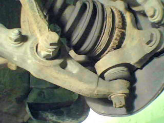

You can check the rings very easily using a torch! The failed ones are *likely* (95% probability) to be the fronts.
Under the front bumper, look at the inside of the wheel and look for the toothed ring as seen here (not a Clio):
Cracked rings are a pretty straightforward fix for any DIY mechanic. I'd allow a few hours for a newbie.
