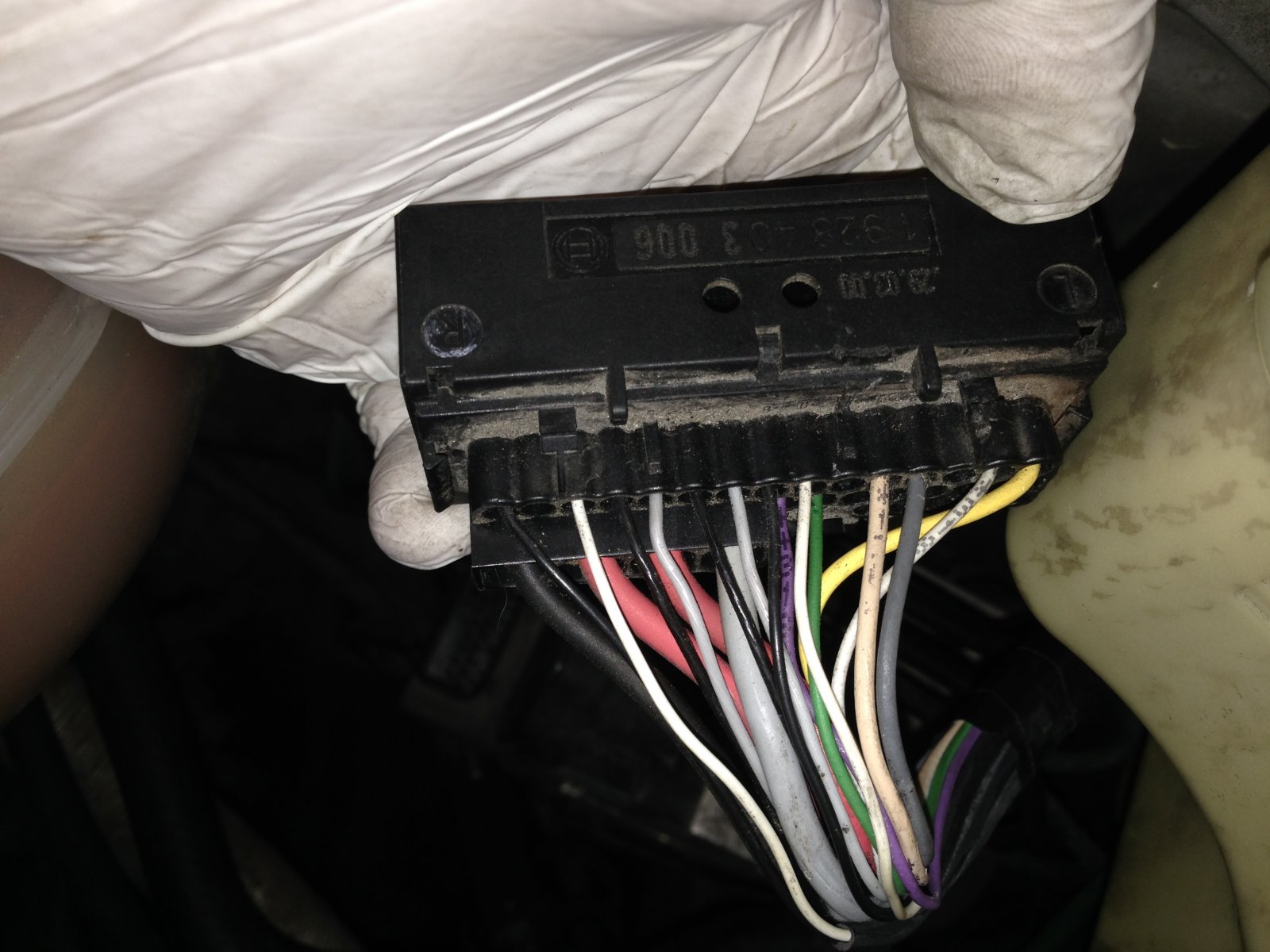

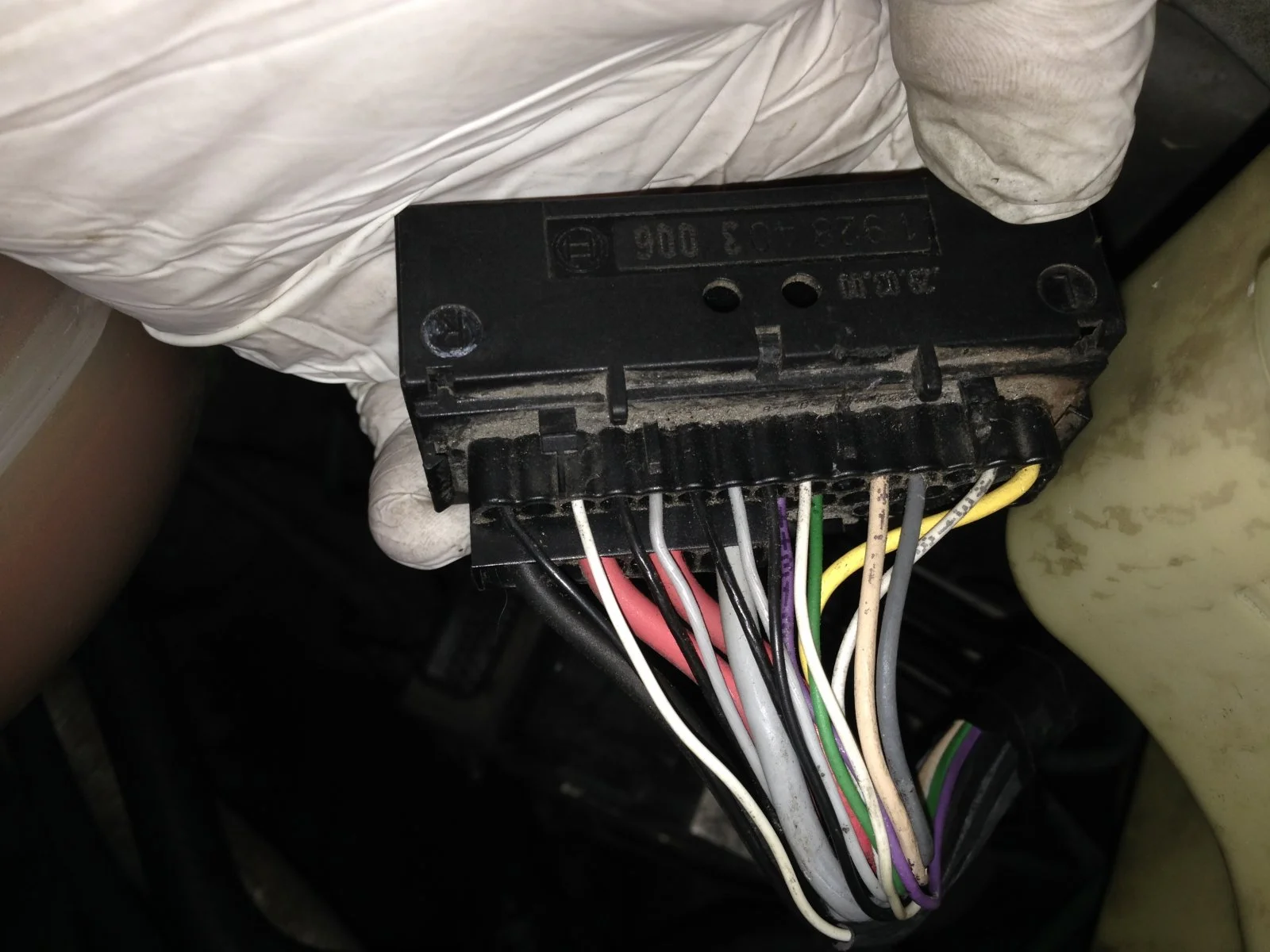

This is the wiring to the controller plug, the top row of pins start with 1 on the left and these are the connections I'm seeing:
1+3 offside rear sensor
4+5 offside front sensor
6+7 nearside front sensor
8+9 nearside rear sensor
Haynes and Autodata both say:
1+2 offside rear
3+5 offside front
6+7 nearside front
8+9 nearside rear

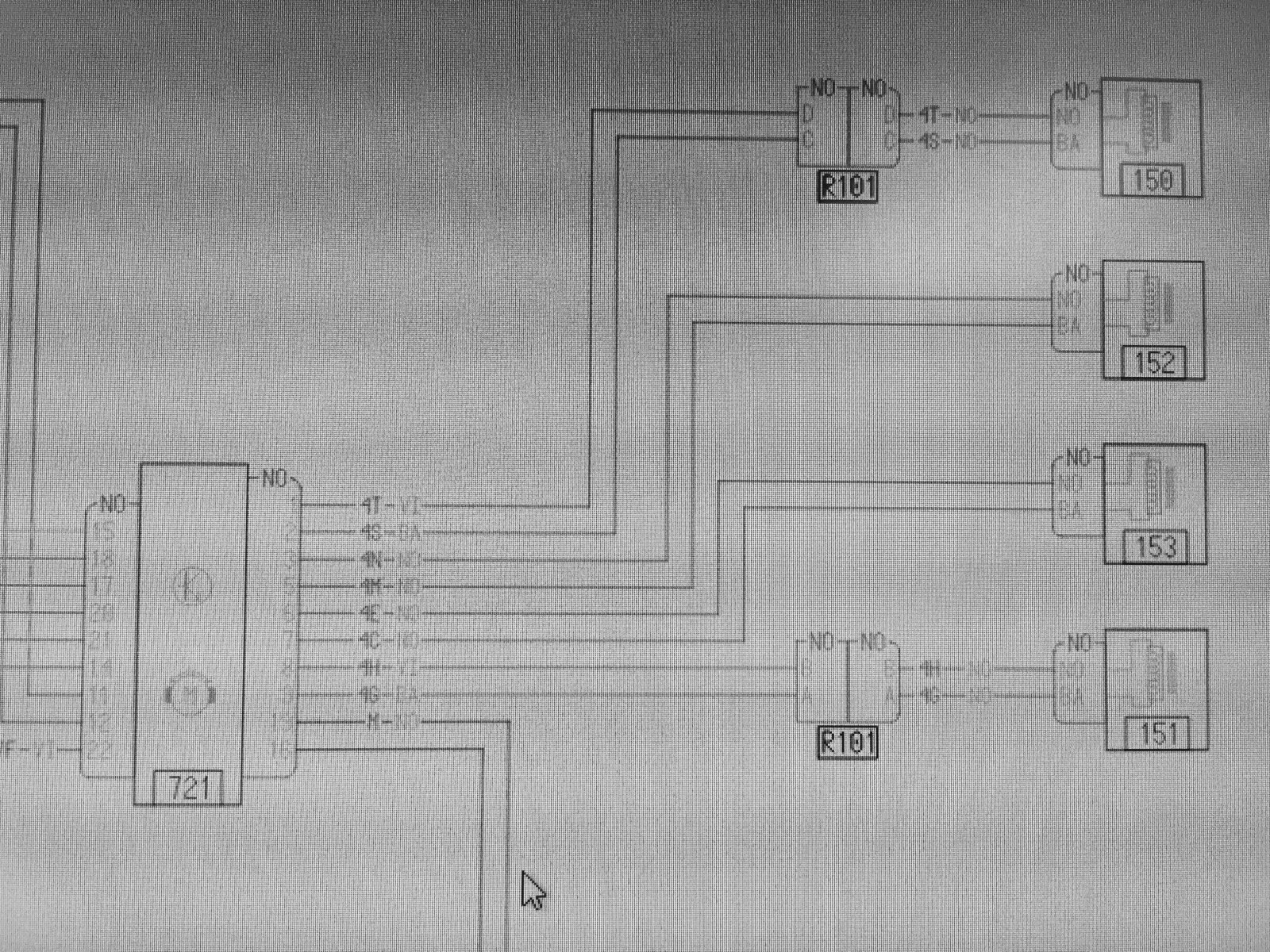

Sorry for the poor image but our screens refresh rates are designed to stop this s**t.
The O/S/F sensor is component '152' so pins 3 and 5
Thanks for that. I was hoping it would be different to autodata but it is probably where autodata actually got their info in the first place. I wonder if a mistake has been duplicated by autodata and haynes? Has anyone actually checked the continuity of their abs sensors and found the diagram to be wrong? (or found it to be right for that matter?)
