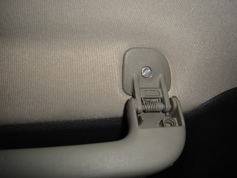

I glued my roof lining in just to make sure it stayed there as wasn't sure it would stick in the middle.
I cut off the broken plastic bits that fit in the metal work and managed make metal brackets and nuts that I could position and fix in the holes. I also drilled out and countersunk all the screw holes in the plastic trim and used larger countersunk screws, which look quite smart. Much better than the rubbish torx ones by renault.
here's a photo of one of the new screws.
