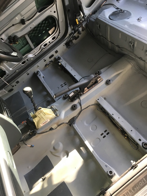

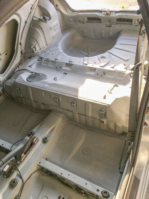

Car was partially stripped when I got it, since then I've removed a lot more. Had it on the weigh bridge at weekend 980kg. Plan is to get it around 950ish.

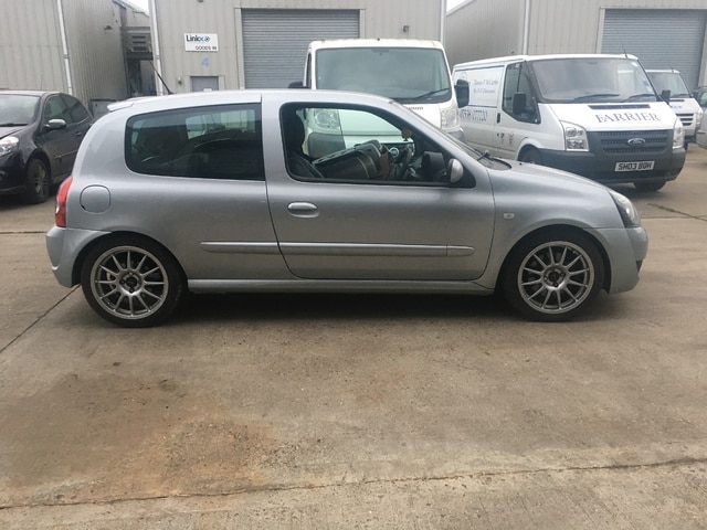

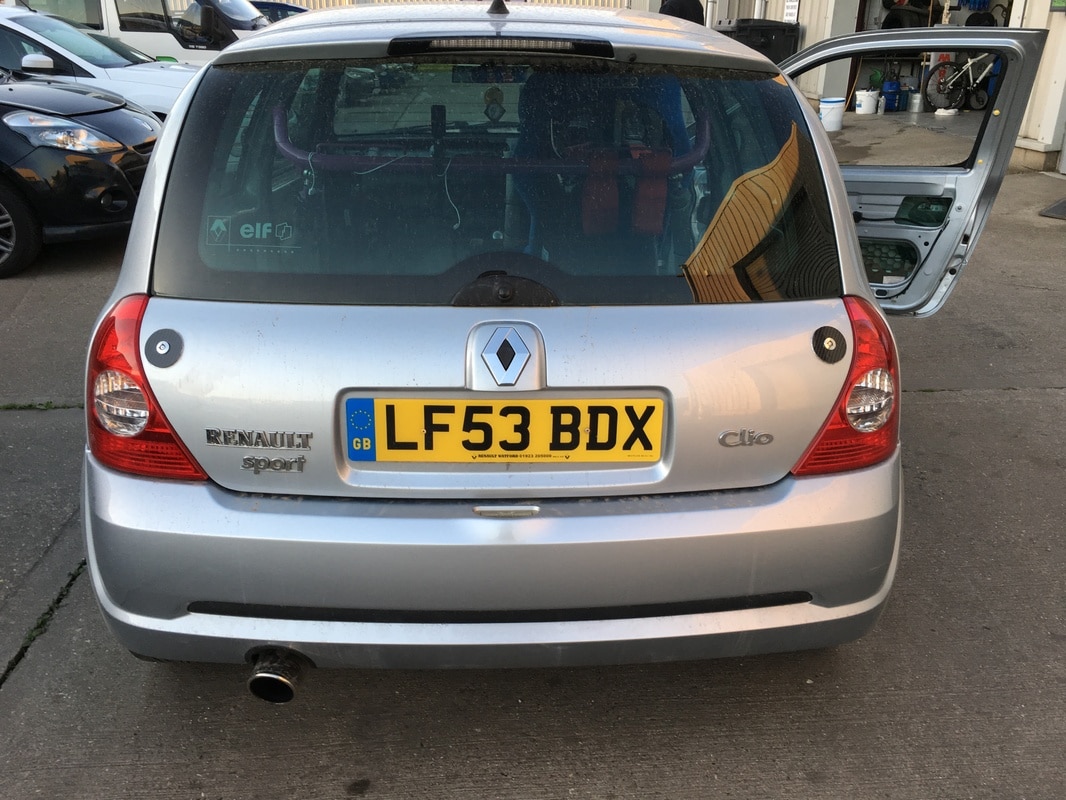

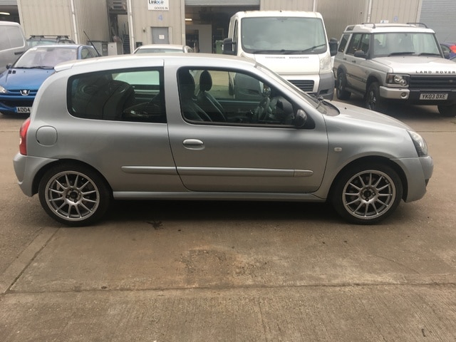

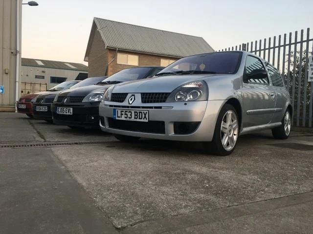

I'll get some pics of it soon, in the meantime here's a couple of rubbish pics and one of my other car.

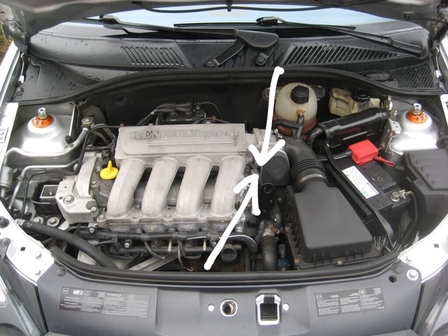

I'm sure that pipe went to a valve under the passenger headlight but everyone gets rid of the valve.

as above, its for the acoustic valve on the end of the airbox feed in the wheel arch, pointless so probs been removed so just leave the vac connection blanked

Removed the sound deadening pads from the front, not a lot of weight but soon adds up

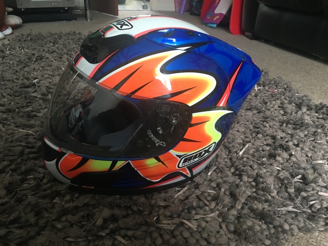

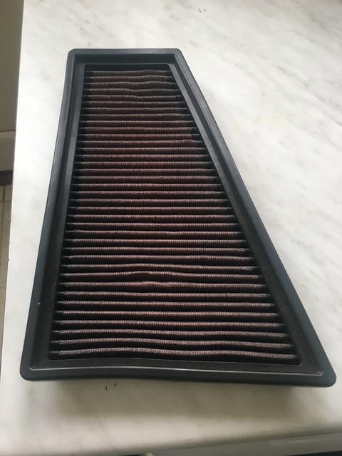

Panel filter and helmet arrived.

As said, goes to the acoustic valve. Pull it all out and you can get a nice silicone end cap to put on it off eBay for a quid or 2.
It's already been done mate.

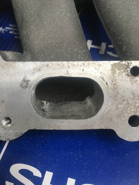

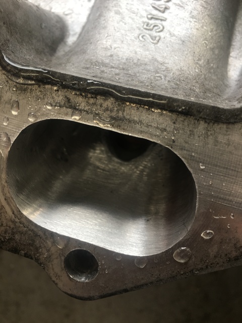

Removed the inlet manifold to port match it and some nice person has already done that to :grimacing:
I did the port matching :) I forgot to mention that in the sale thread.

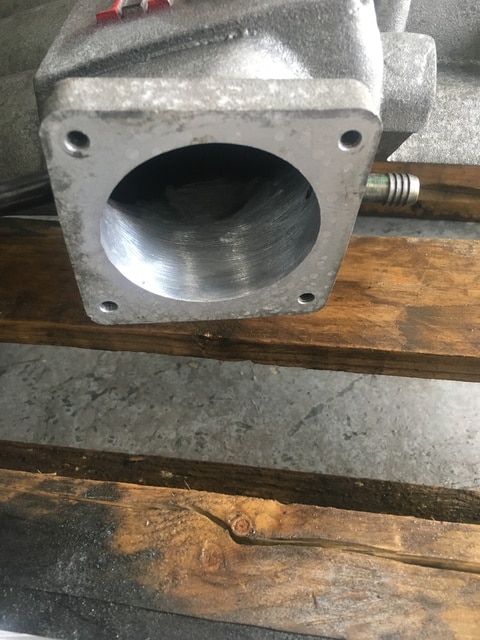

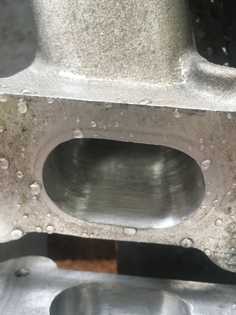

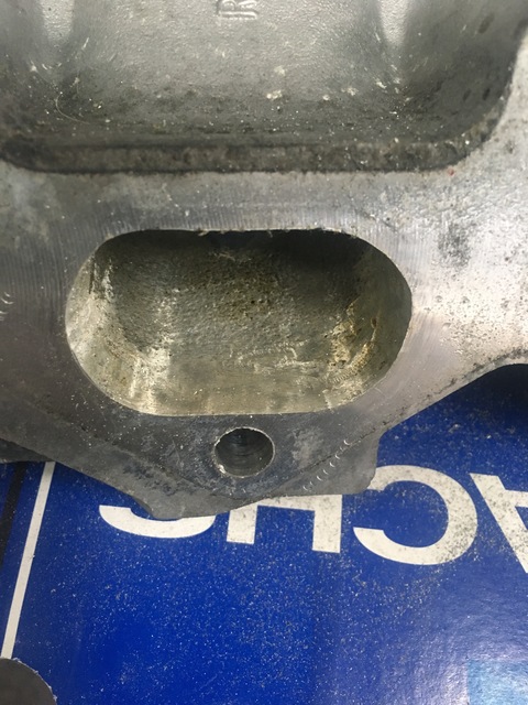

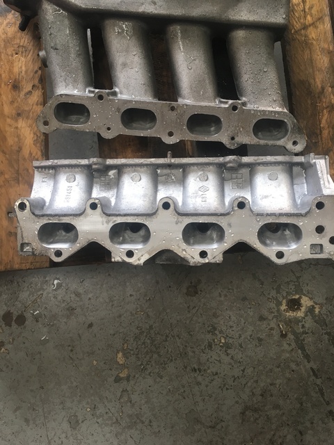

Removed the inlet manifold again to match the throttle body, ended up removing both parts of the inlet manifold and taking quite a bit more off them.
Before
After
Throttle body

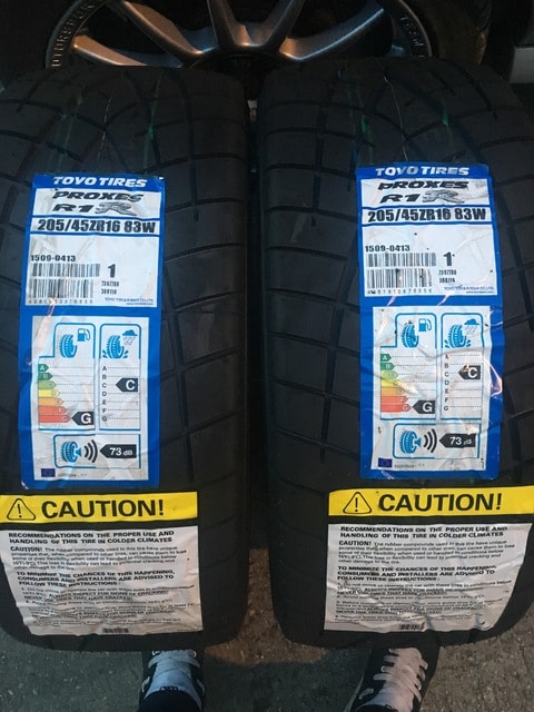

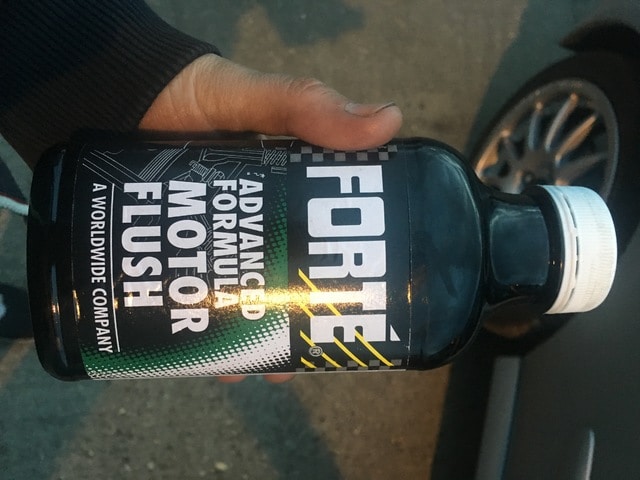

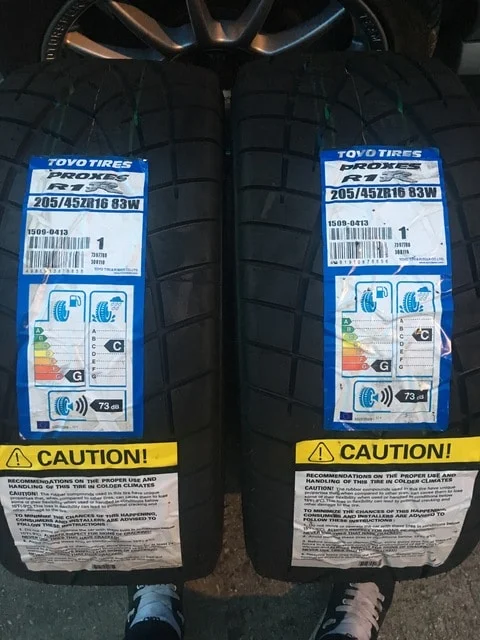

Did a engine clean with the Forte flush then oil and filter change. My first 2 tyres turned up to. Toyo R1R :grimacing:

Isn't it not a great idea to flush these engines in between oil changes or is that just some rubbish I've picked up from somewhere?

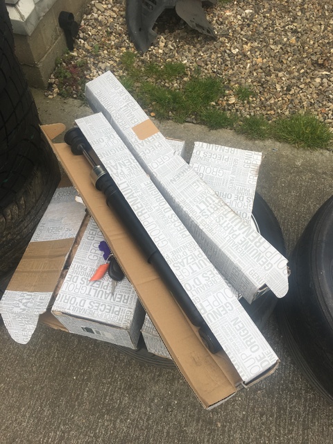

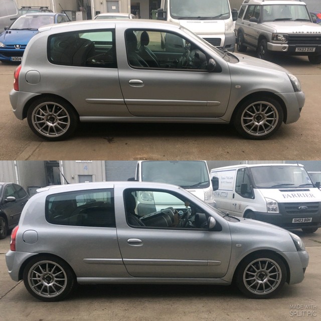

Got new 172 cup shocks front and rear, cooksport springs, new top mounts etc, hoping it's gonna settle a bit as it's hardly any lower :laughing::laughing:
  172
Fitted new Cup shocks front and rear with cooksport springs, new mounts, bearings etc. Hoping it's gonna settle a bit as it's not really any lower 🙈:laughing:

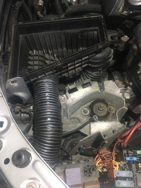

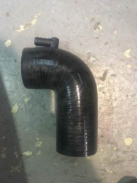

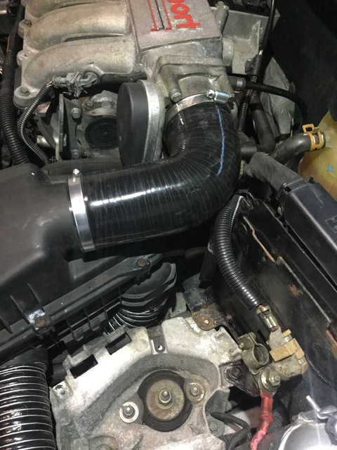

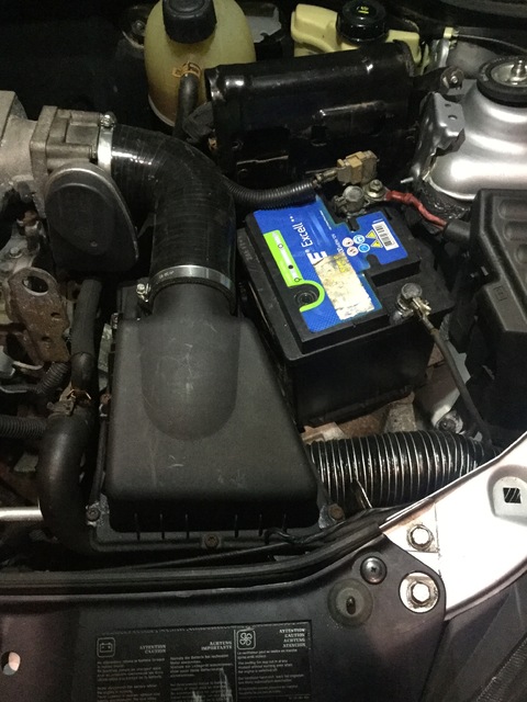

Twin air feeds fitted today, one straight to the middle bumper grill, moved battery and ECU a bit, silicon intake pipe with the breather in, K&N panel filter.
I only use my R1r's in the wet but for me they are a very capable tyre, plenty of grip even from cold, I'm sure I've read somewhere that they are loosely based on the r888, albeit these are a harder compound in comparison

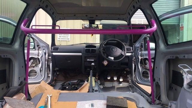

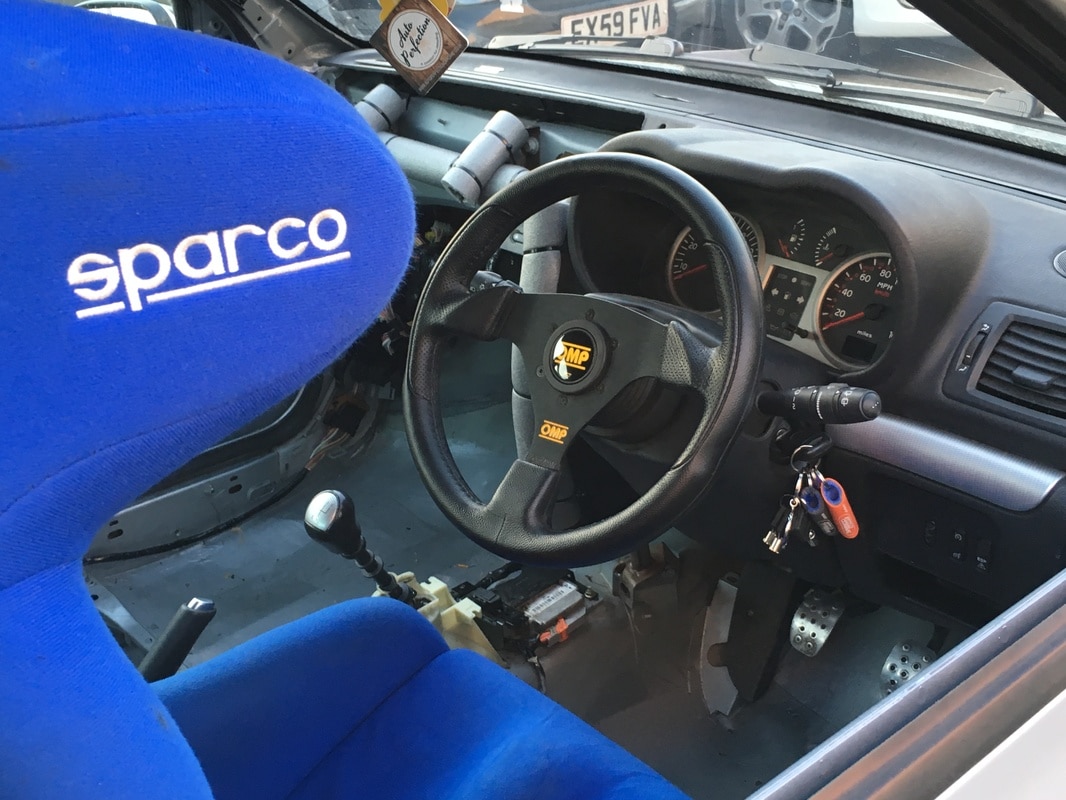

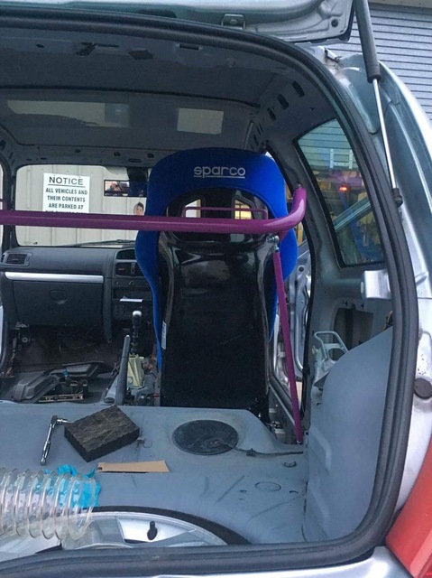

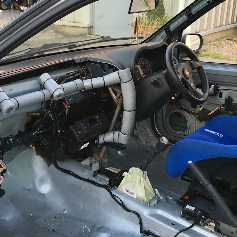

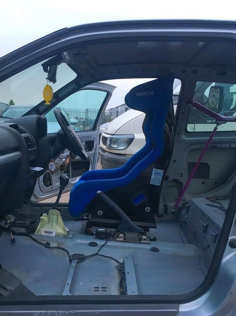

Inside painted, tidied loom, tailgate pins fitted, removed dash to modify, new steering wheel, harnesses.
  172

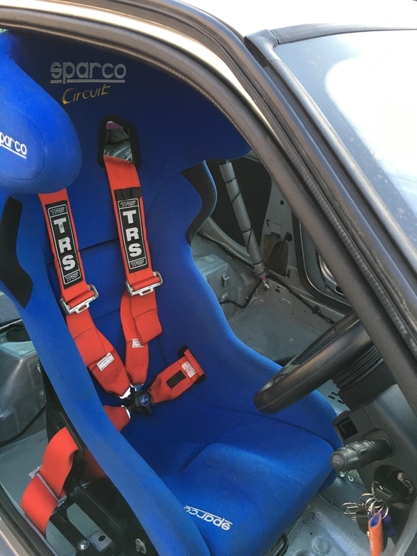

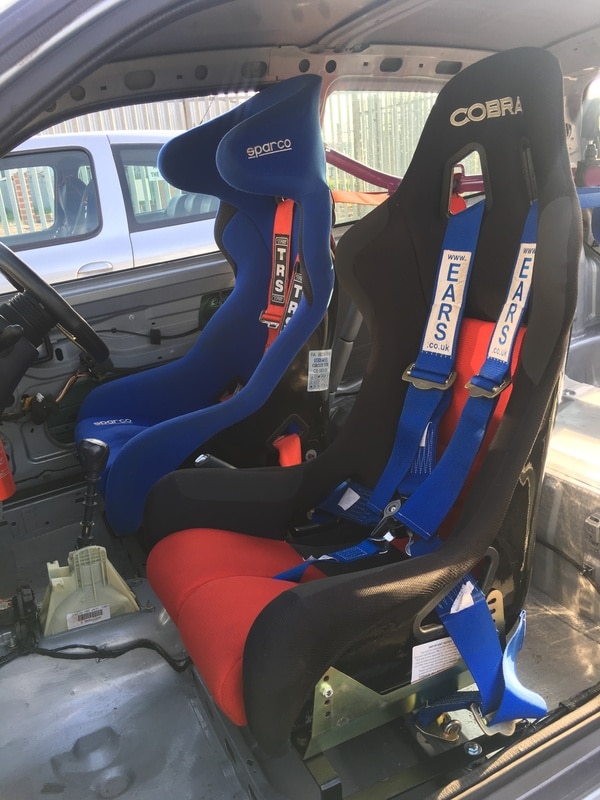

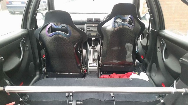

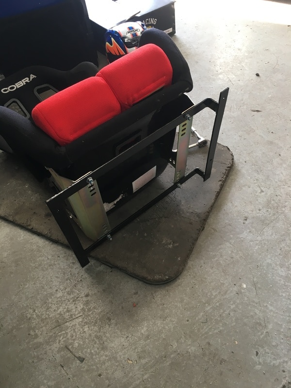

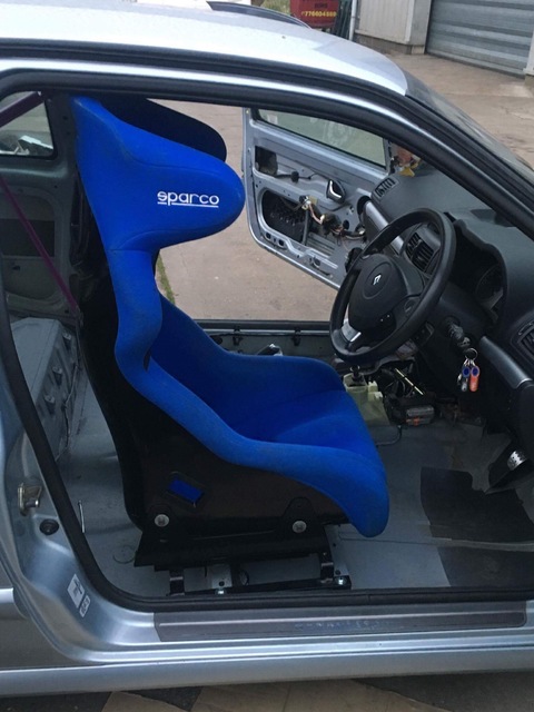

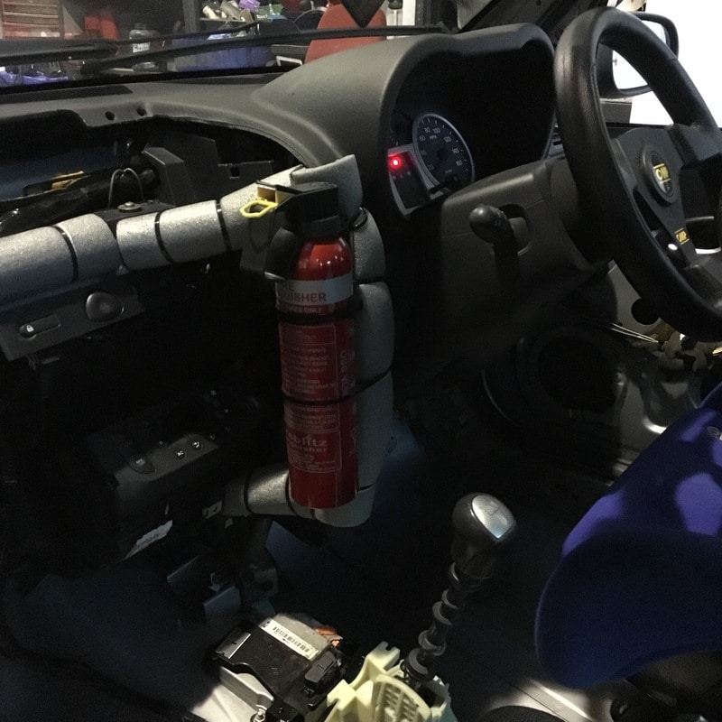

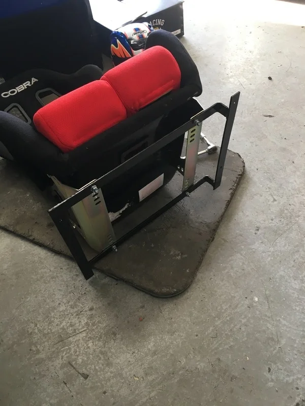

Both seats and harnesses now in, after seeing how simple my cobra drivers side subframe was I ordered some flat bar and made a matching passengers side subframe. R1R tyres fitted, waiting for track rod ends so I can get alignment done, from our little camber gauge I think I've got 3 degrees front and 2.25 rear. Fitted tow eye and fire extinguisher ready for my first track day at Snetterton in a few days time.

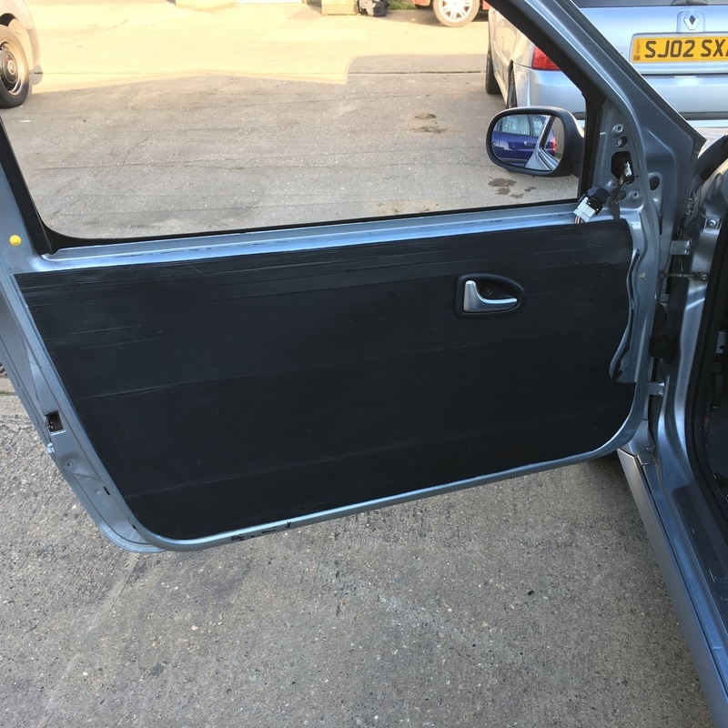

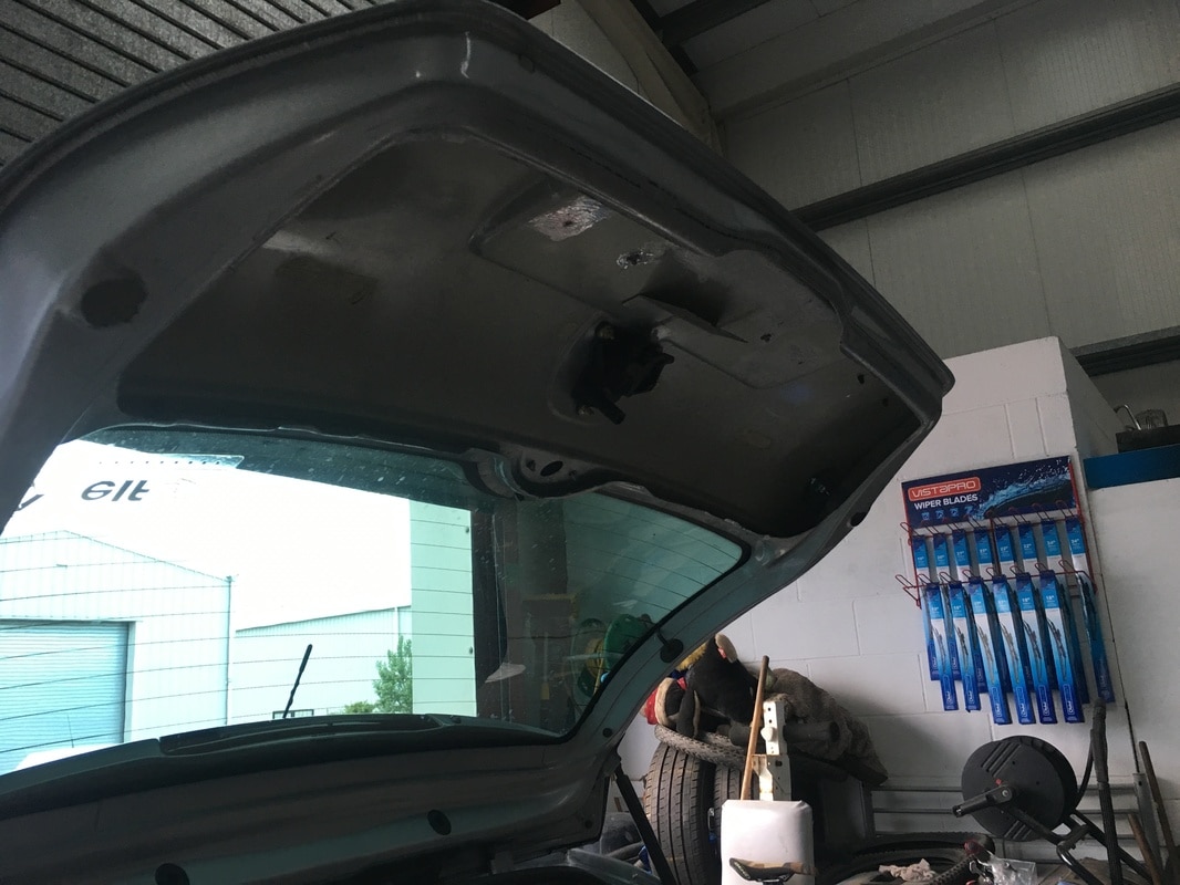

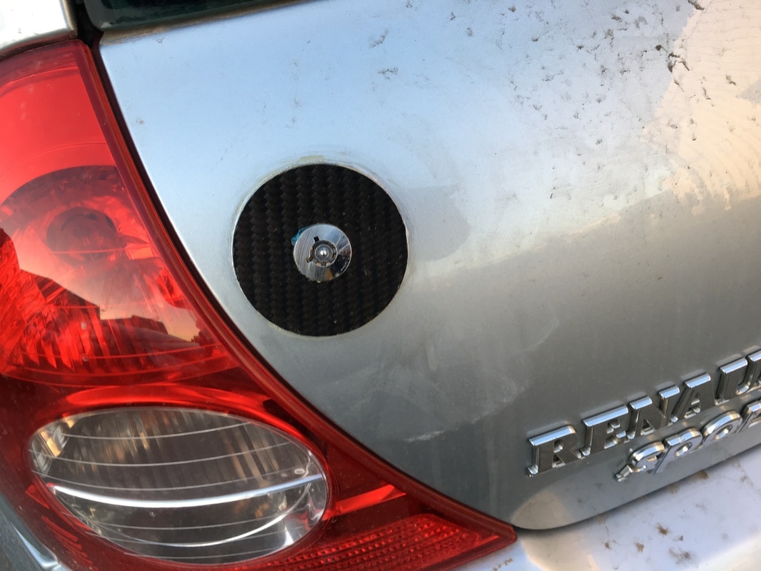

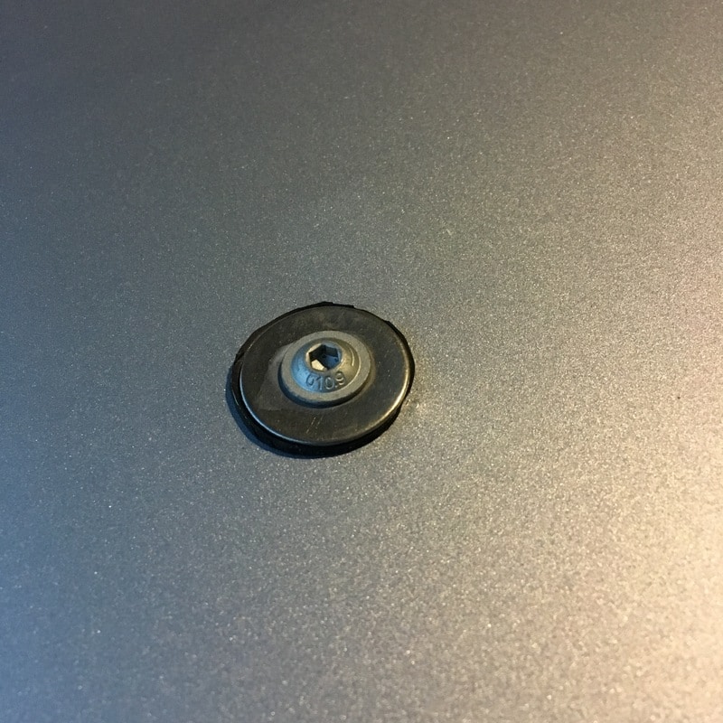

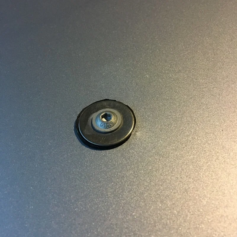

I also gutted the tailgate and made some cheapy door cards, not that pretty but they do the job. Aerial also removed and replaced with a bolt/gasket/washer.
