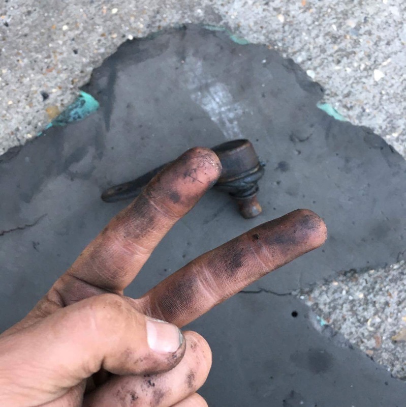

Been busy with this, 2 new track rod ends, new ball joint and she went straight through a MOT so is now on the road.

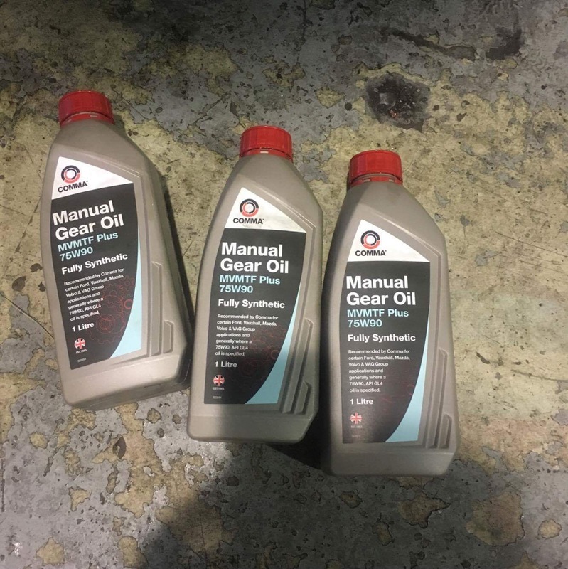

Changed gearbox oil, this is the right stuff?

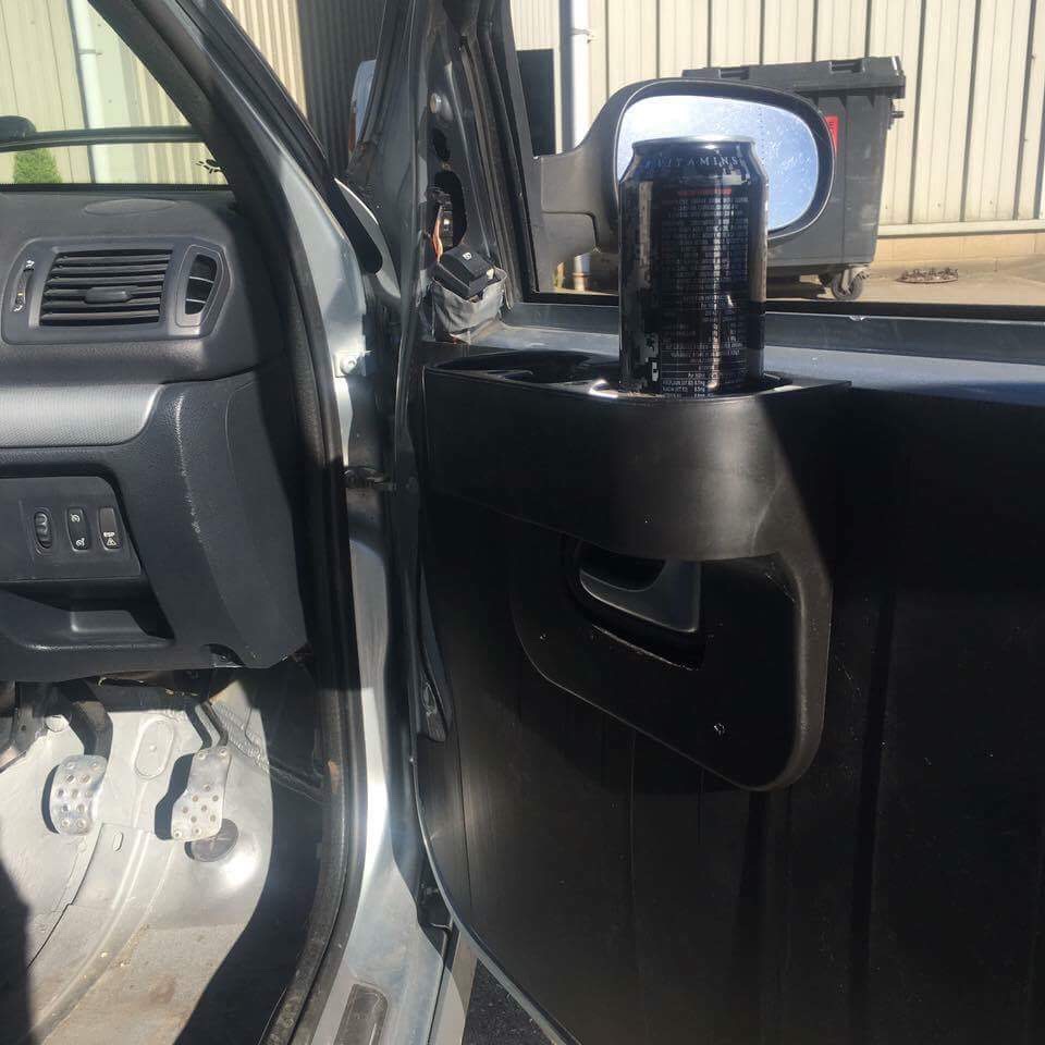

Got fed up of having no cup holder so now have this bad boy

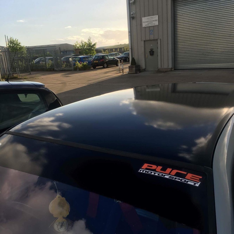

Decided to have a go at wrapping the roof black and making a sun strip, with the help of friends it didn't come out to bad

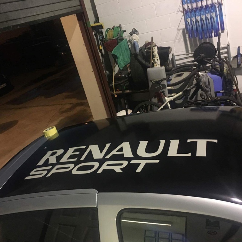

Then the decal

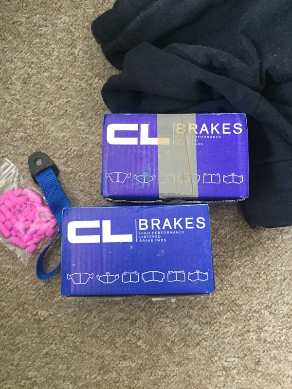

Replaced both front and rear pads with Carbone Lorraine RC5+ the difference is amazing!

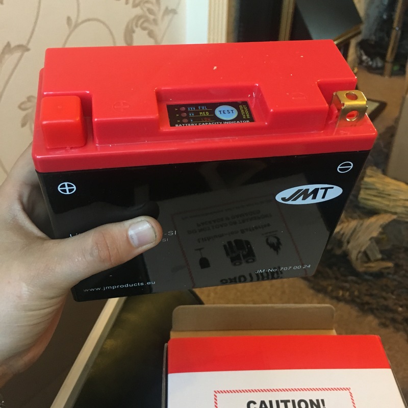

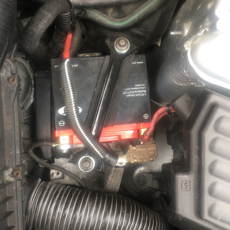

Mounted ECU flat and fitted new lithium battery. Barry weighs under 1kg 😊

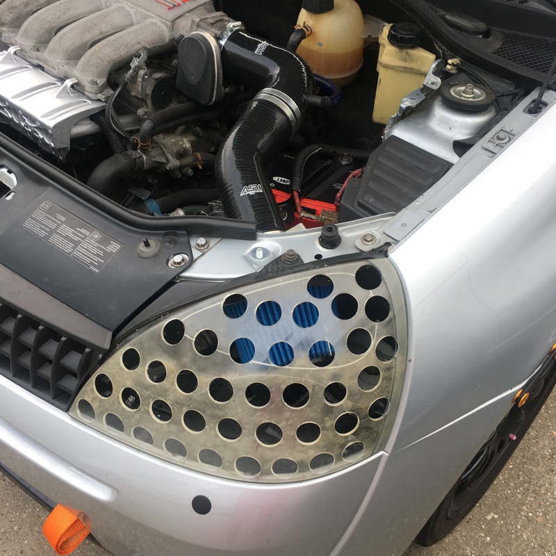

Next is induction kit and air feed headlight.
  172

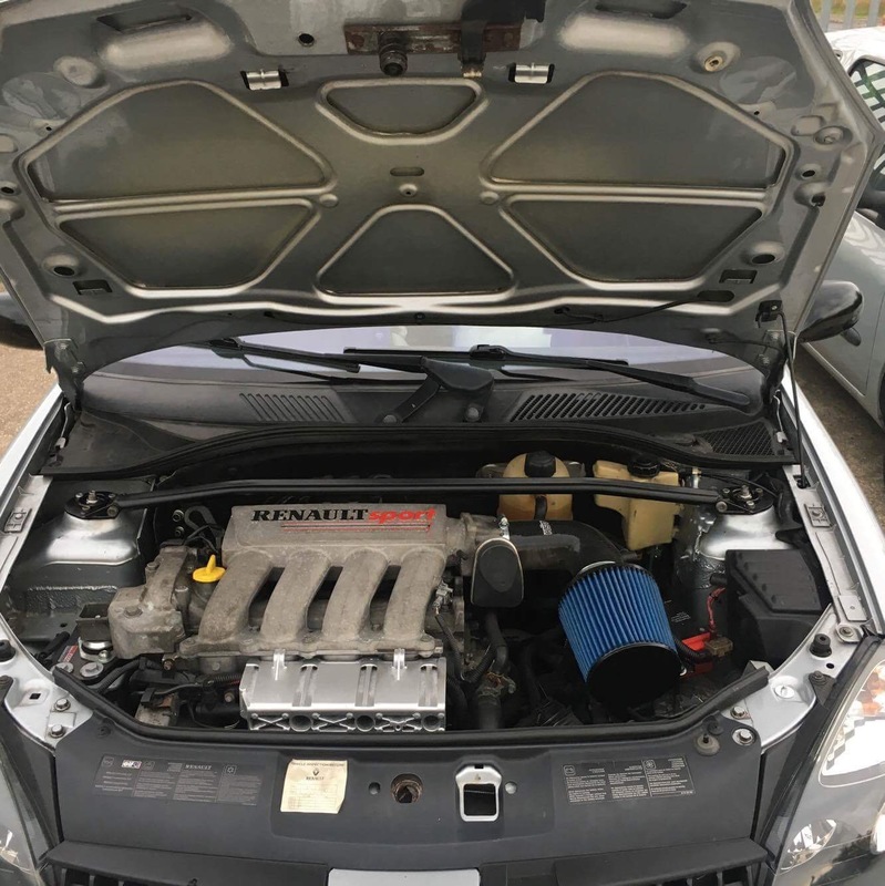

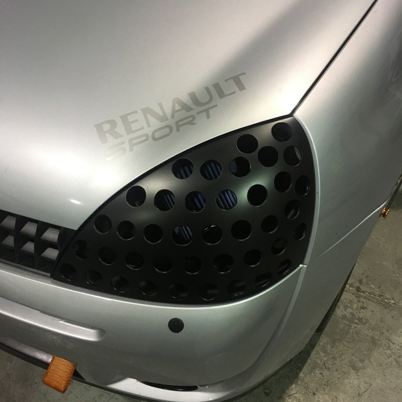

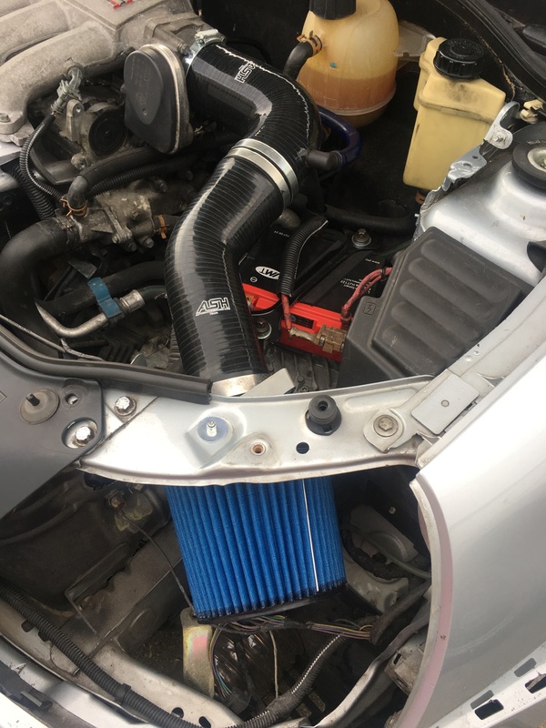

New induction setup. Not quite finished yet, the filter will sit a little further forward when the rest of the parts arrive. Going to paint the light over the weekend to.

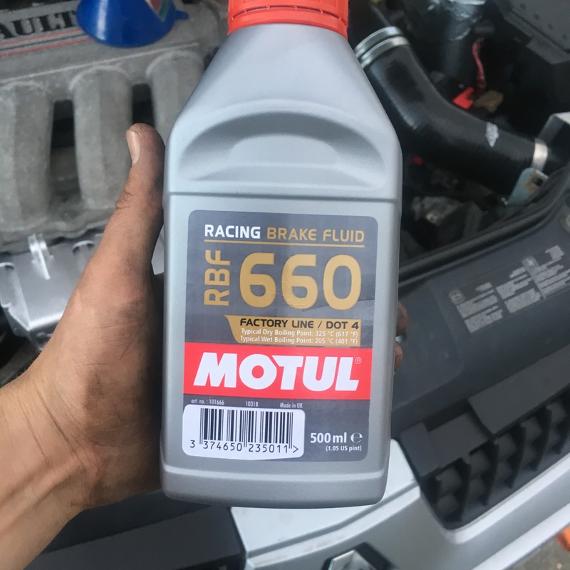

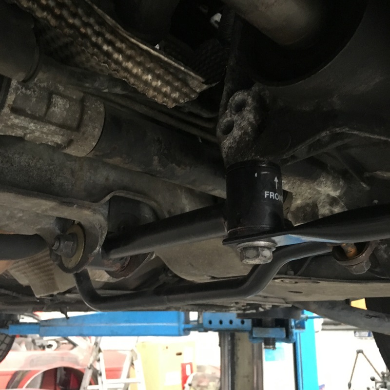

changed the brake fluid for Motul 660. Managed to pick up a new whiteline anti roll bar Sunday afternoon, quickly fitted it Sunday night ready for my 2nd track day last night, also installed some RS Tuner software :cool:

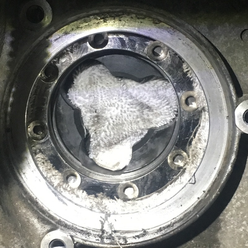

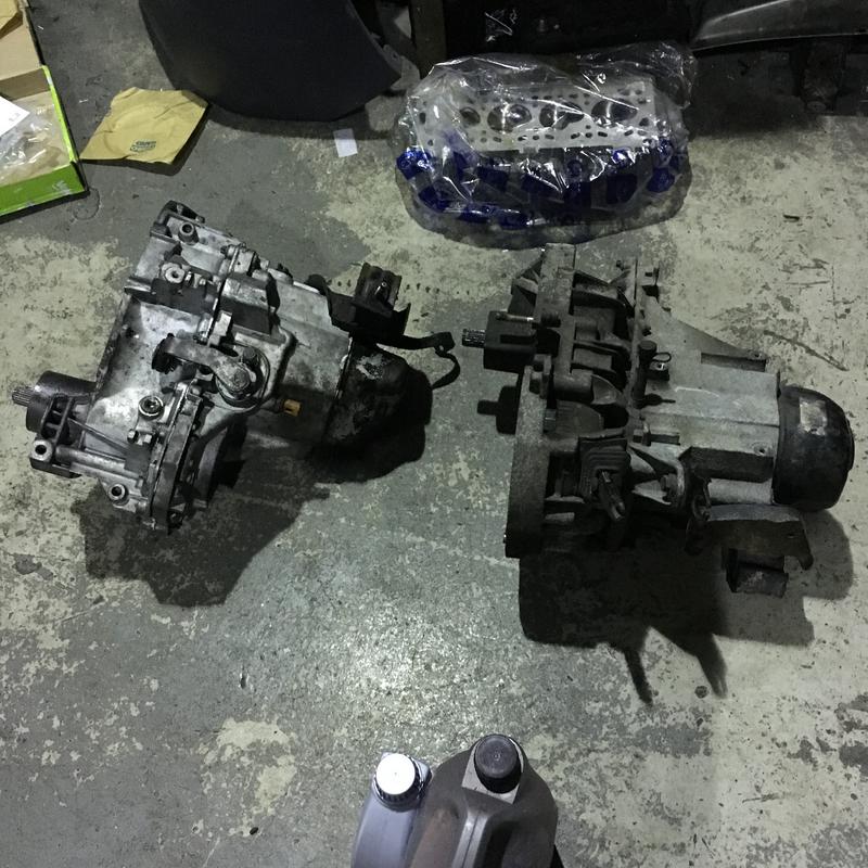

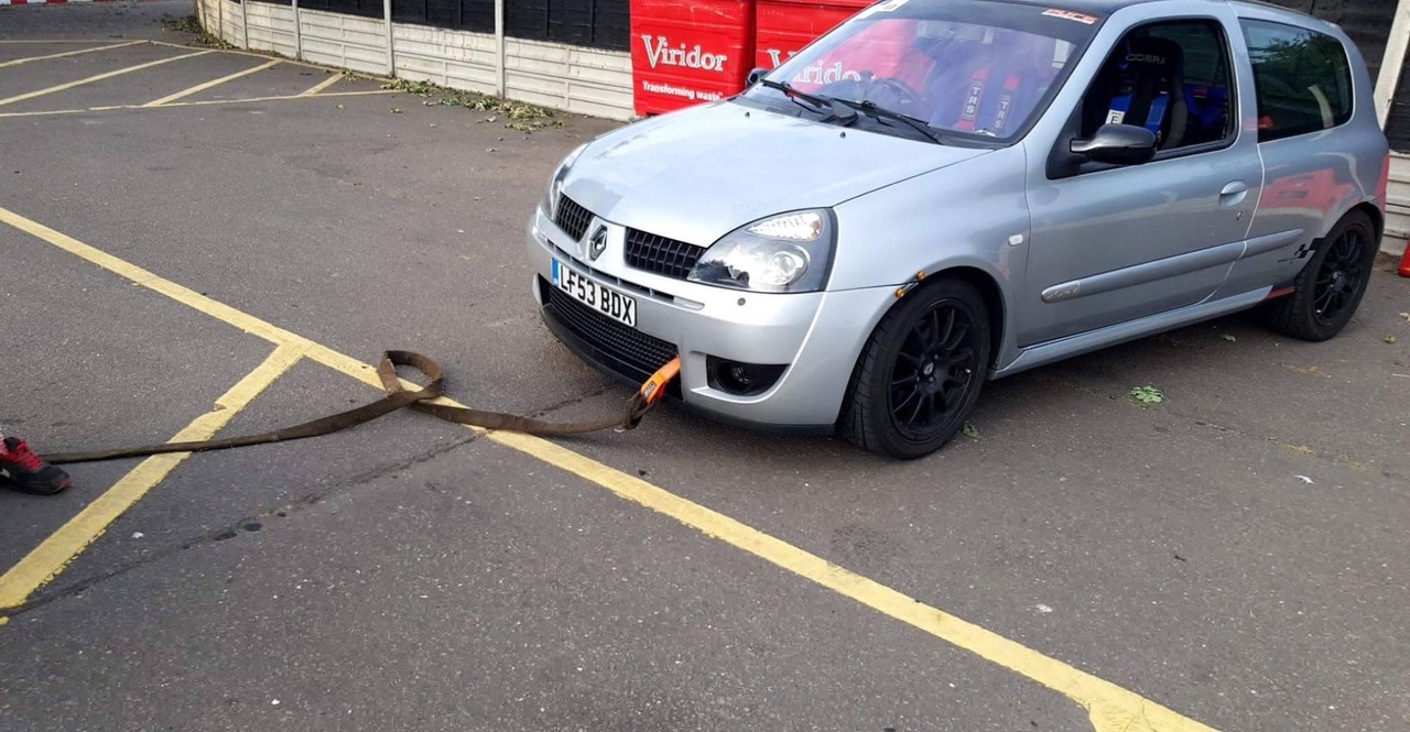

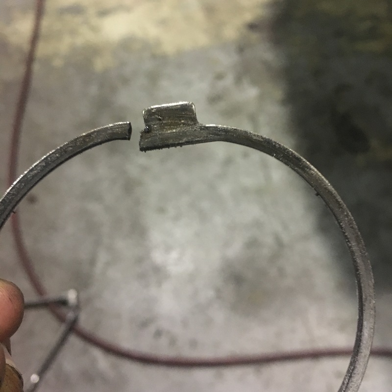

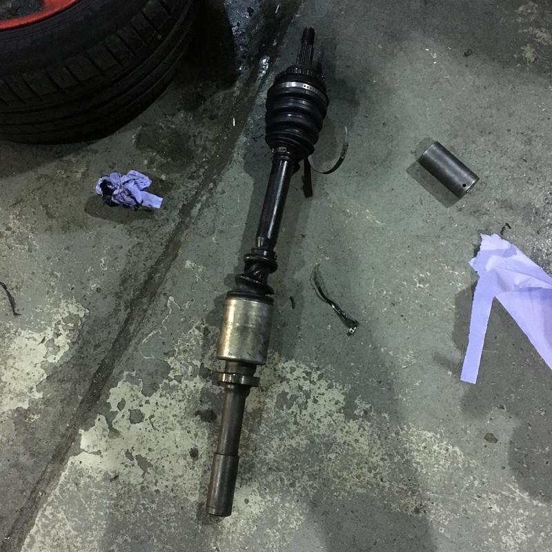

Track day was going really well .... until I lost all drive 🙈 managed to freewheel into the pits where I was towed home. Hopefully it's just the circlip on the diff that's popped out which I'll replace with a Renfort plate.

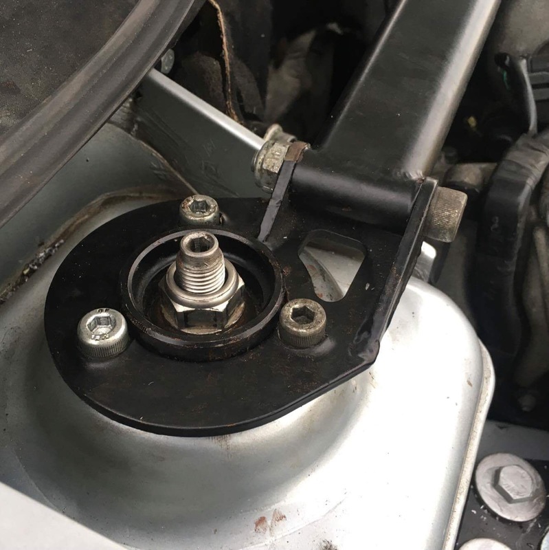

Fitted K-Tec solid top mounts and PMS strut brace tonight.
I have a Renfort plate that is hopefully going to fix my gearbox issue, hopefully get it fitted soon so I can get back out on track.
  172
Gearbox fixed! The shim had snapped and popped the circlip out.
Fixed with a Renfort plate

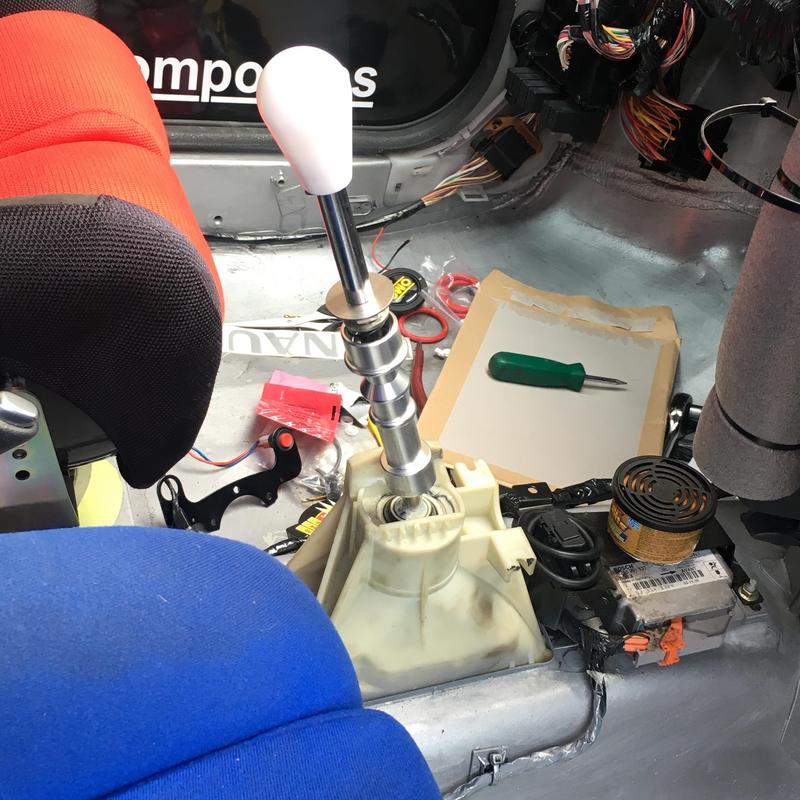

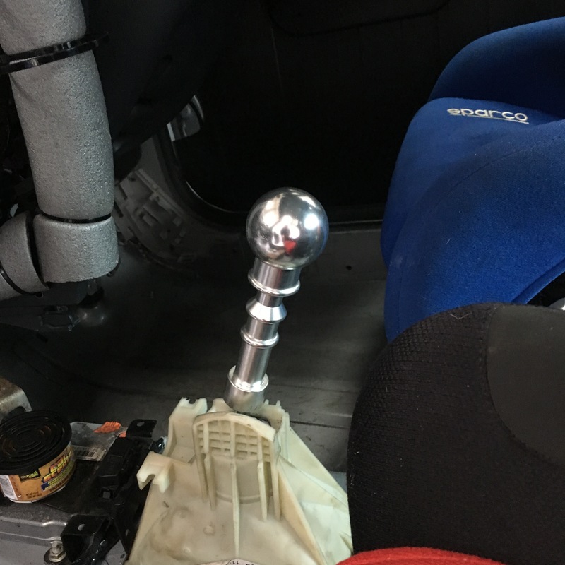

Replaced my gear shifter

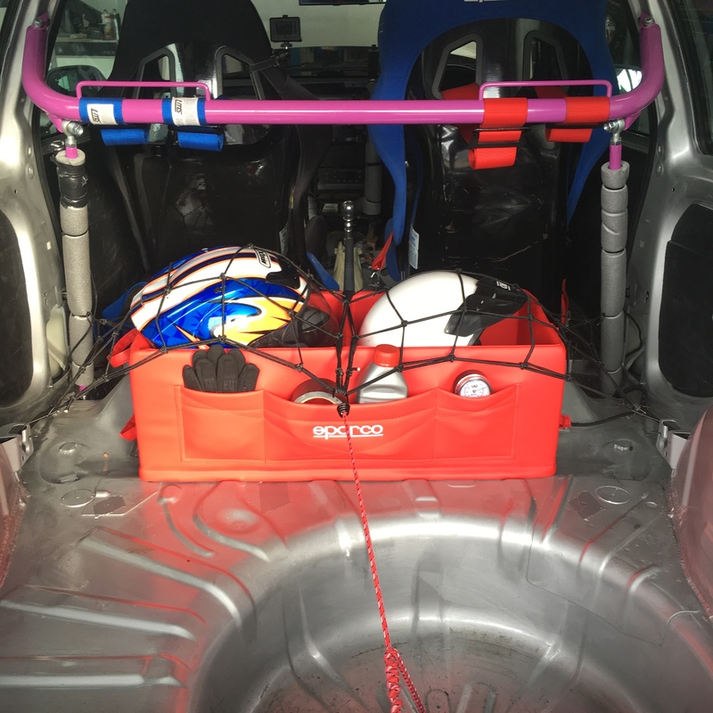

New helmet box, this things really handy for a track car

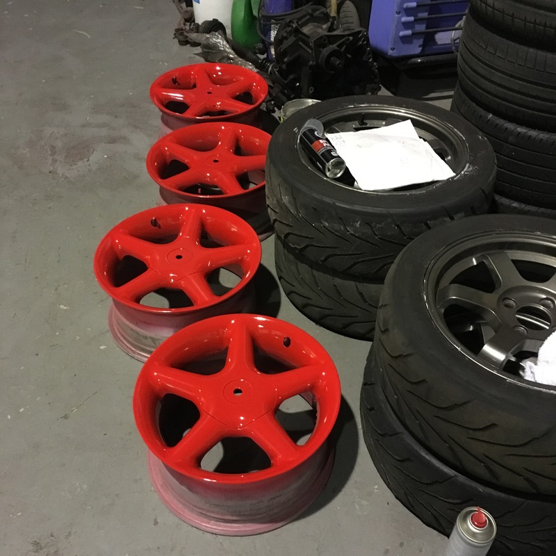

New dry track wheels
Picked up another cheaply set for wets, quick prep and paint, just waiting for new badges.
Parts finally turned up to fit my induction kit properly.

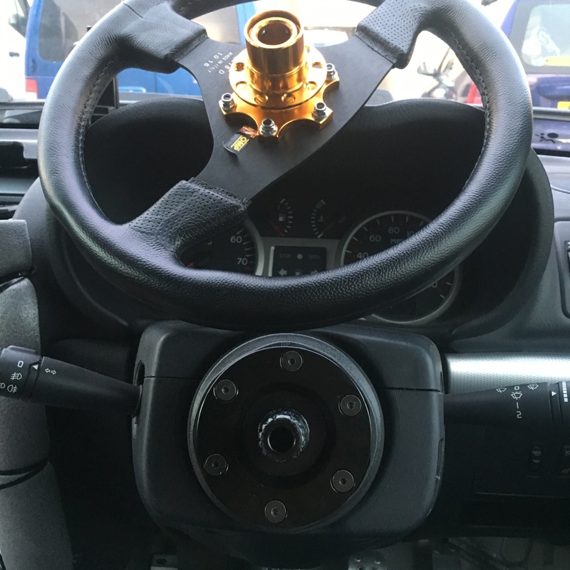

I plan to fit plastic windows with sliders soon and was a bit worried about security so fitted a quick release steering wheel.

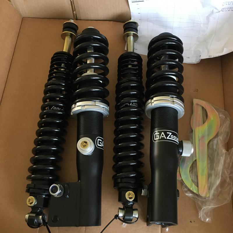

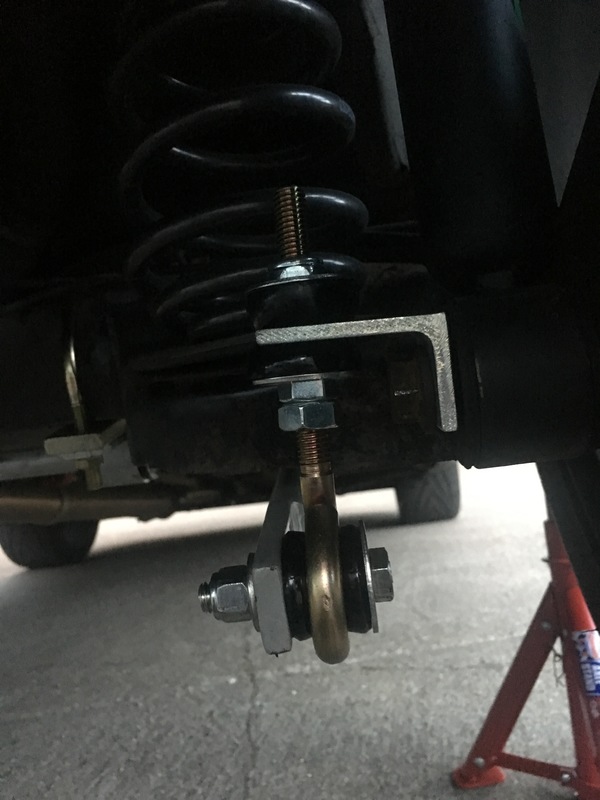

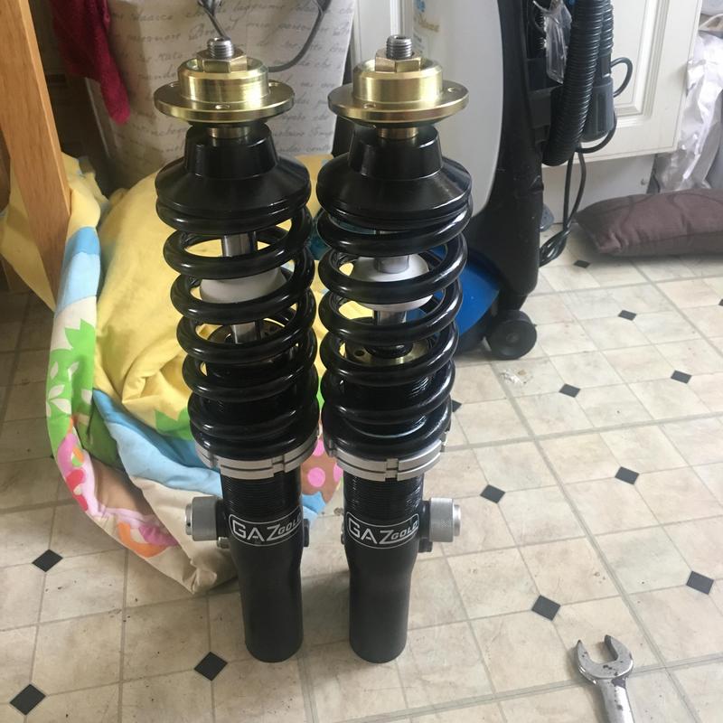

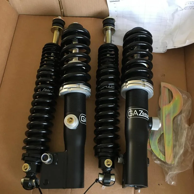

Ended up selling my Cup suspension setup and buying a new set of Gaz Golds that @Mash supplied me. Decided to go for 650 front and 500 rear springs,
Next up some Pure Motorsport top mounts.

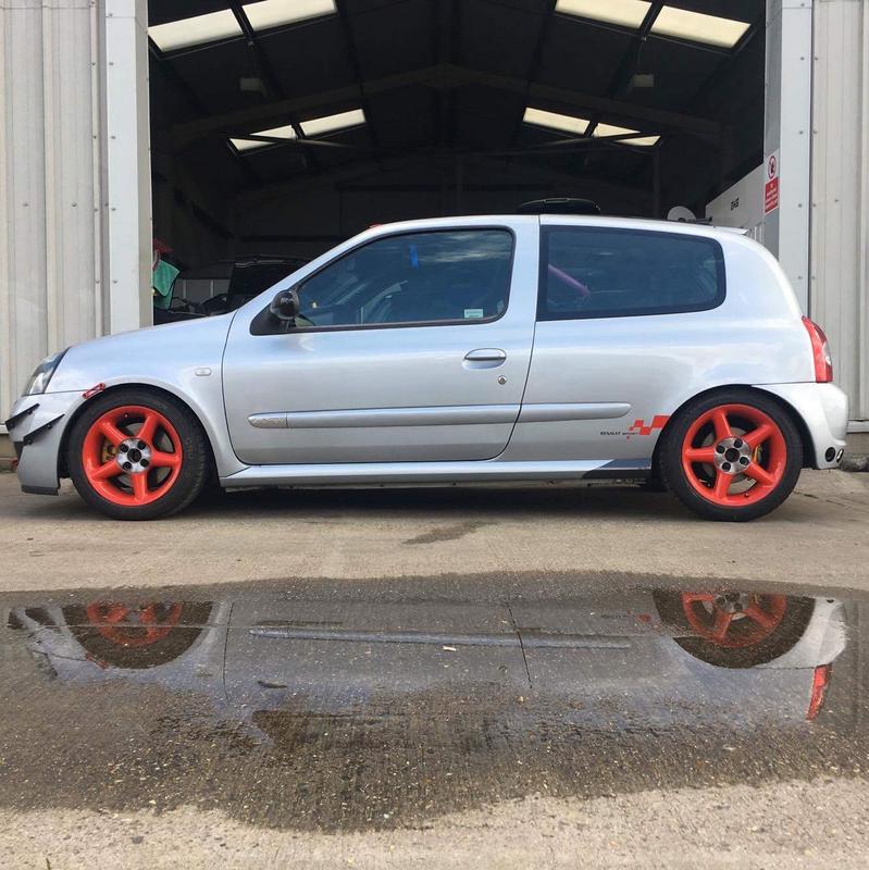

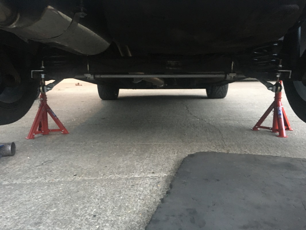

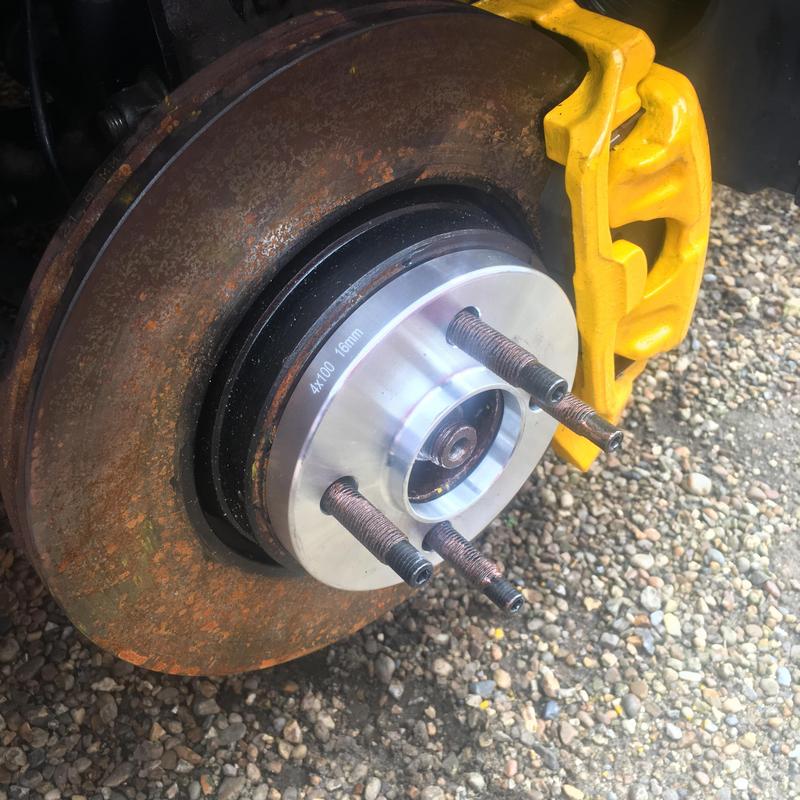

Changed to a stud and nut conversion with some 16mm front spacers, tidied up the calipers with some high temp paint.Excuse the rust on discs it's been sitting 3 weeks
Fitted the coilovers, sits like this at the moment but will probably raise the rear up a bit.

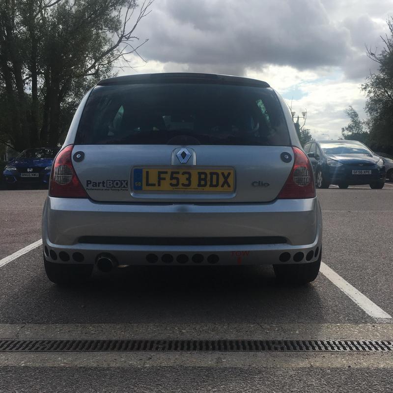

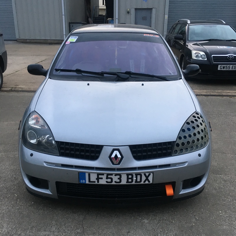

Going to remove all the arch liners so cut some holes in rear bumper to let the air out
Modified the shifter.

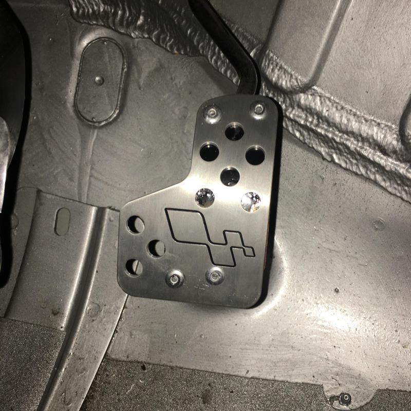

New heel and toe pedal

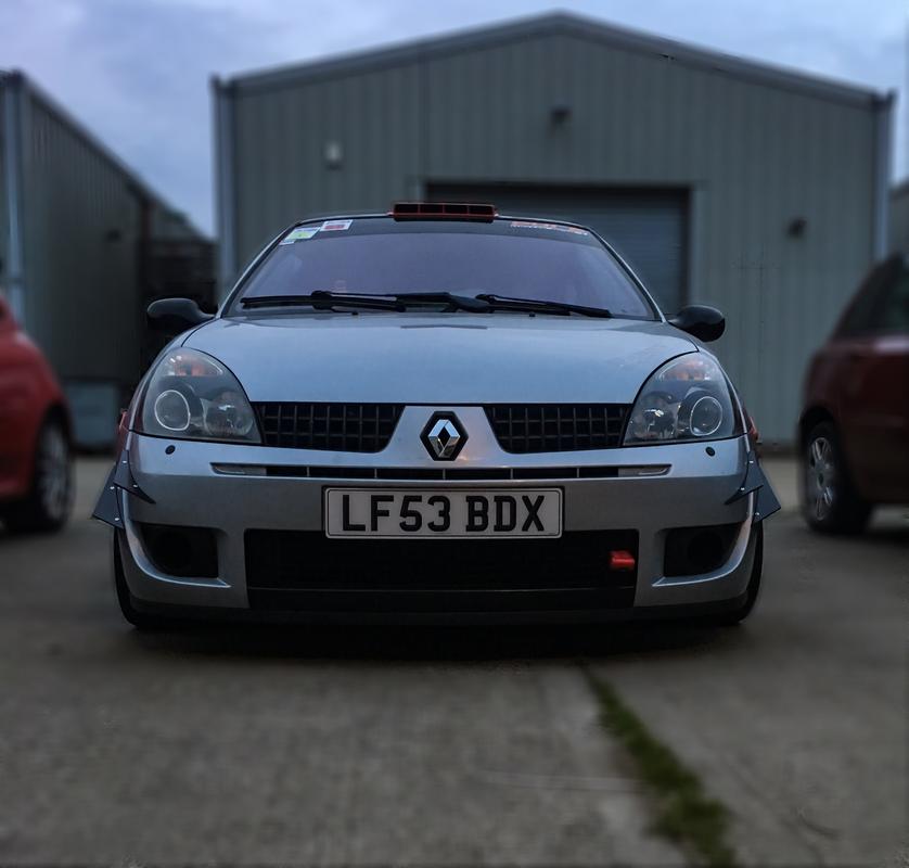

Messed about fitting some canards
Next I think I'll make a front splitter and have a go at a roof vent, might have a go at some plastic windows to.

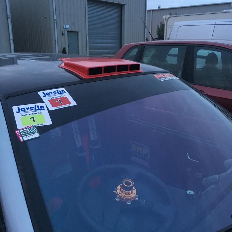

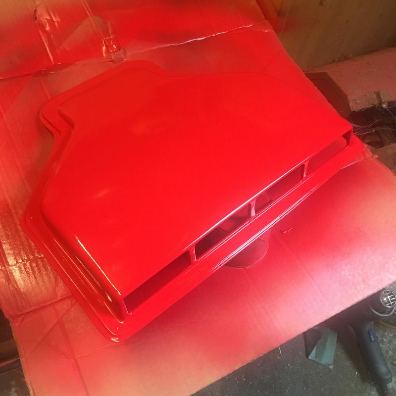

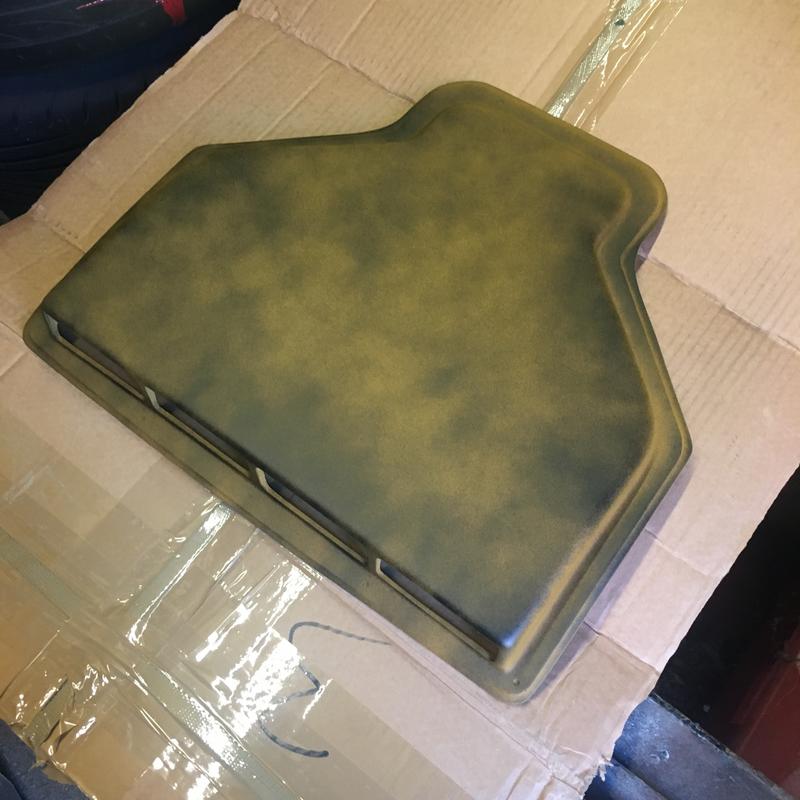

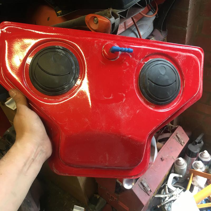

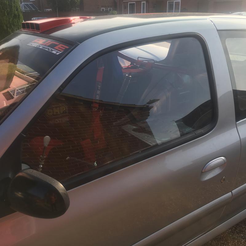

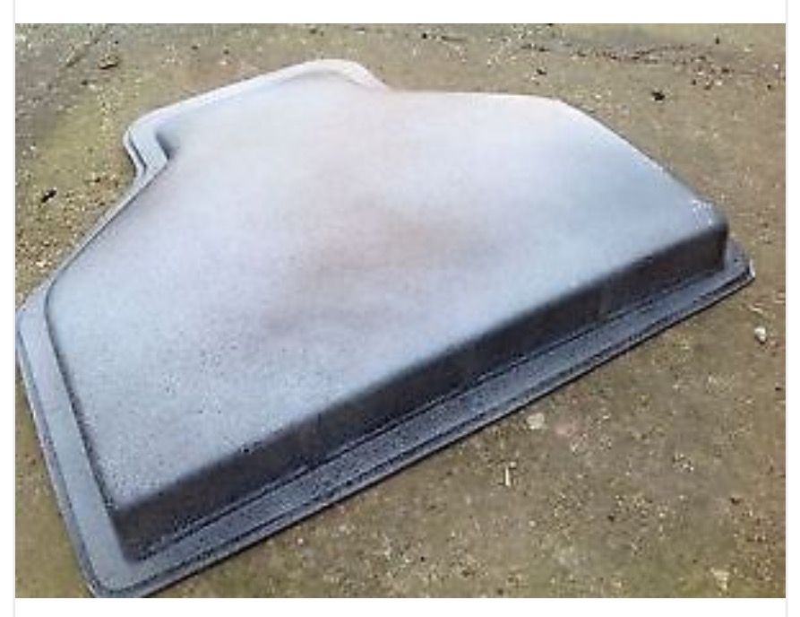

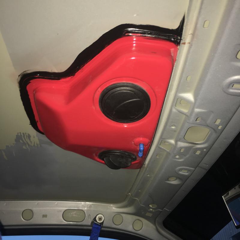

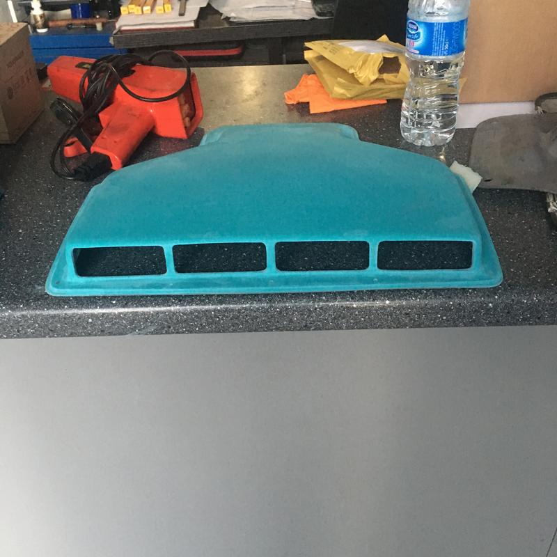

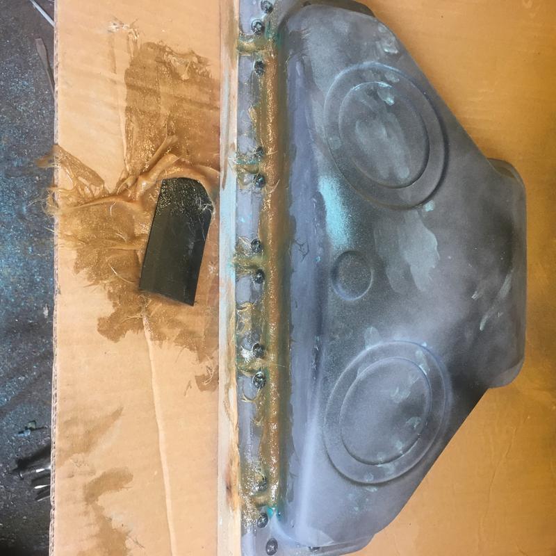

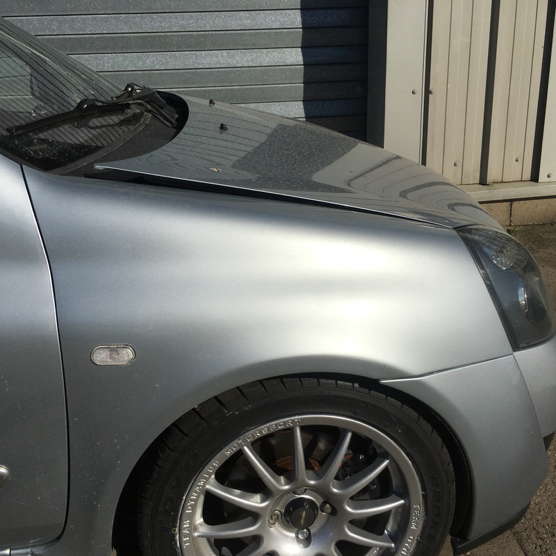

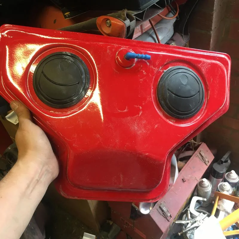

Been working on a roof vent, took a while but got there in the front end. Makes a massive difference.
  Clio 172 Merc ML55
Looks smart does that, is it one of the universal eBay ones? If so what vents have you used

Looking good, some nice purposeful mods happening, especially those gaz golds :wink:

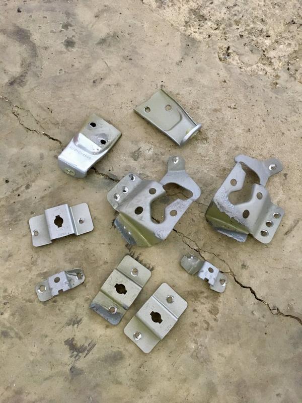

Can I ask, are those tailgate pins lockable and could you share a link from where you sourced them, they're more subtle than the aerocatches?
  172
They are lockable, took a bit of modification to get them in.
These are the ones I bought
http://www.ebay.co.uk/itm/Universal...878857&hash=item1a0b3c19a2:g:jboAAOSw1S9We5DY
If you want them quicker these ones are in the UK
http://www.ebay.co.uk/itm/AROSPEED-...980202?hash=item3f821e8e2a:g:E3oAAOSwX3NZbN9J

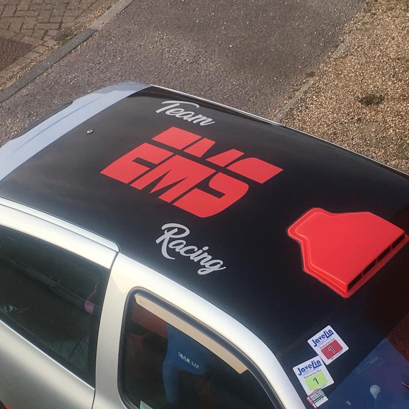

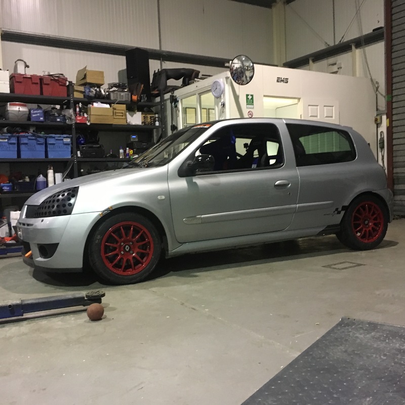

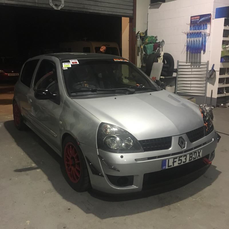

Changed my roof decals, EMS is my mates garage Elite Motor Services, all our clios are prepared there.
Tried my wets on, can't put the centres on due to stud conversion.

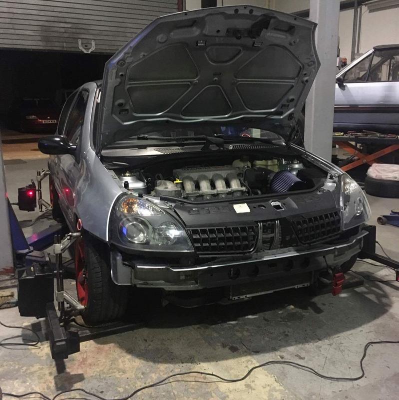

We picked up a 4 wheel laser aligner to, should save a few quid between us

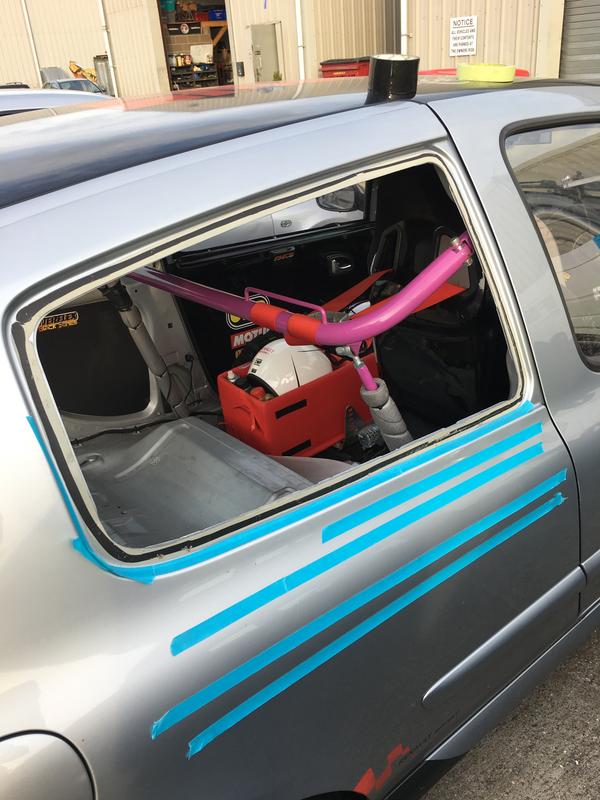

Next job is polycarbonate windows

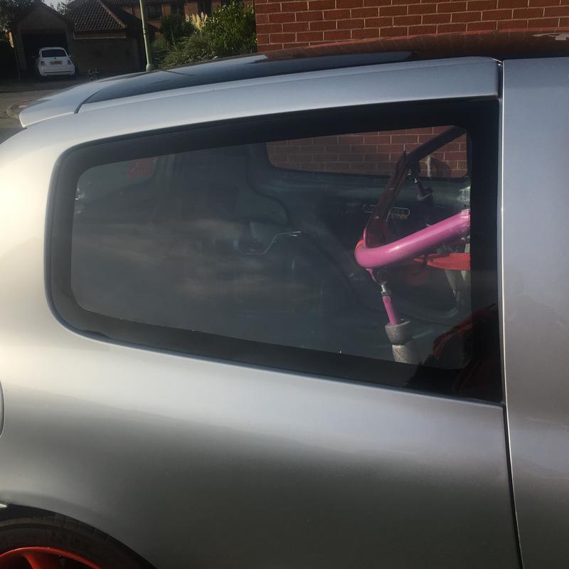

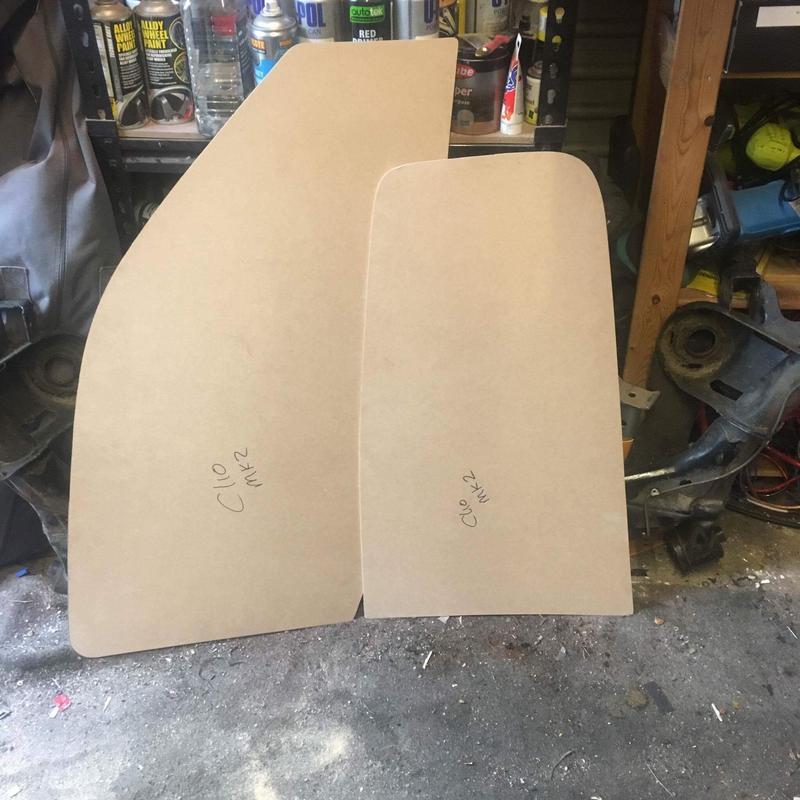

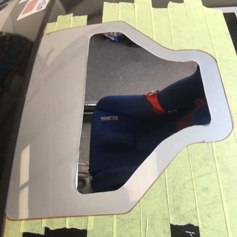

So ... knocked myself up some polycarbonate windows, there all in now.

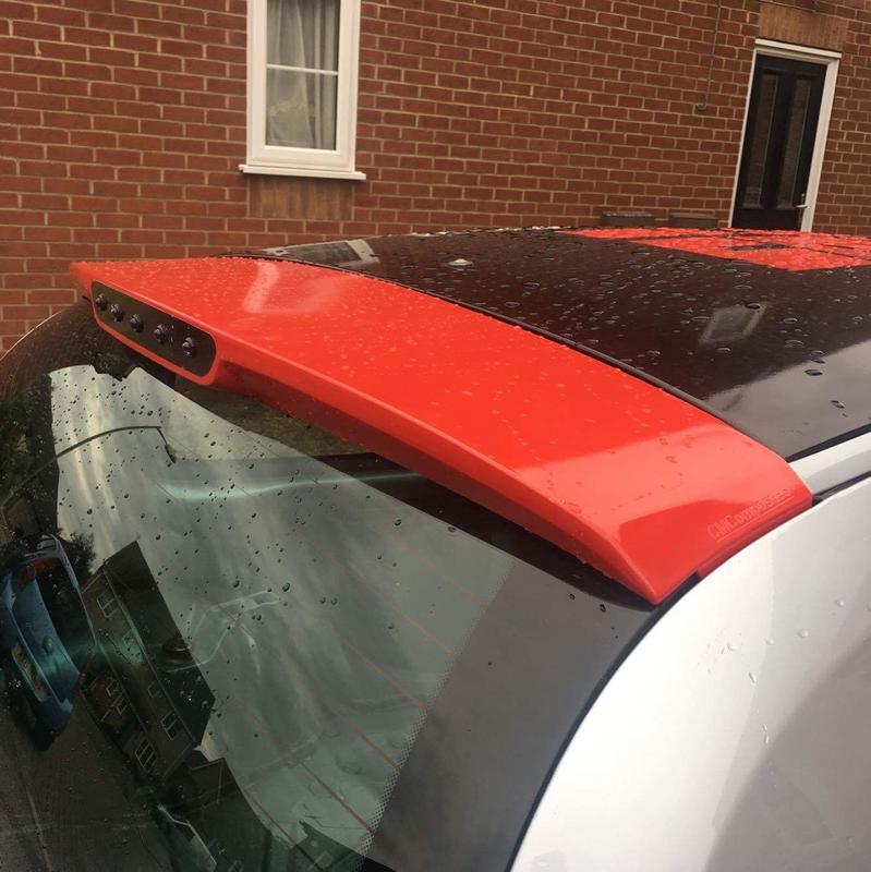

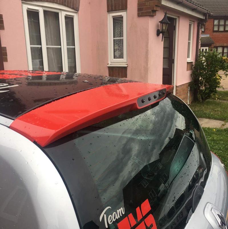

Got a CM Composites rear cup spoiler, painted and fitted that along with some led brake lights, only weighs 1kg

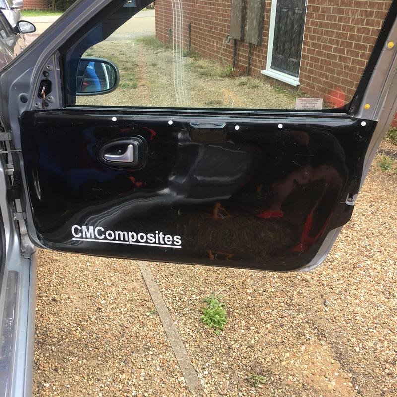

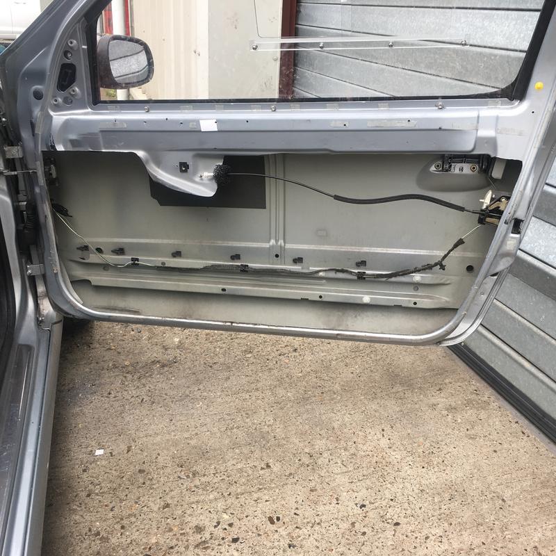

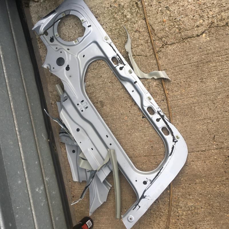

Lightened the doors, removed regulators, inner frame etc.

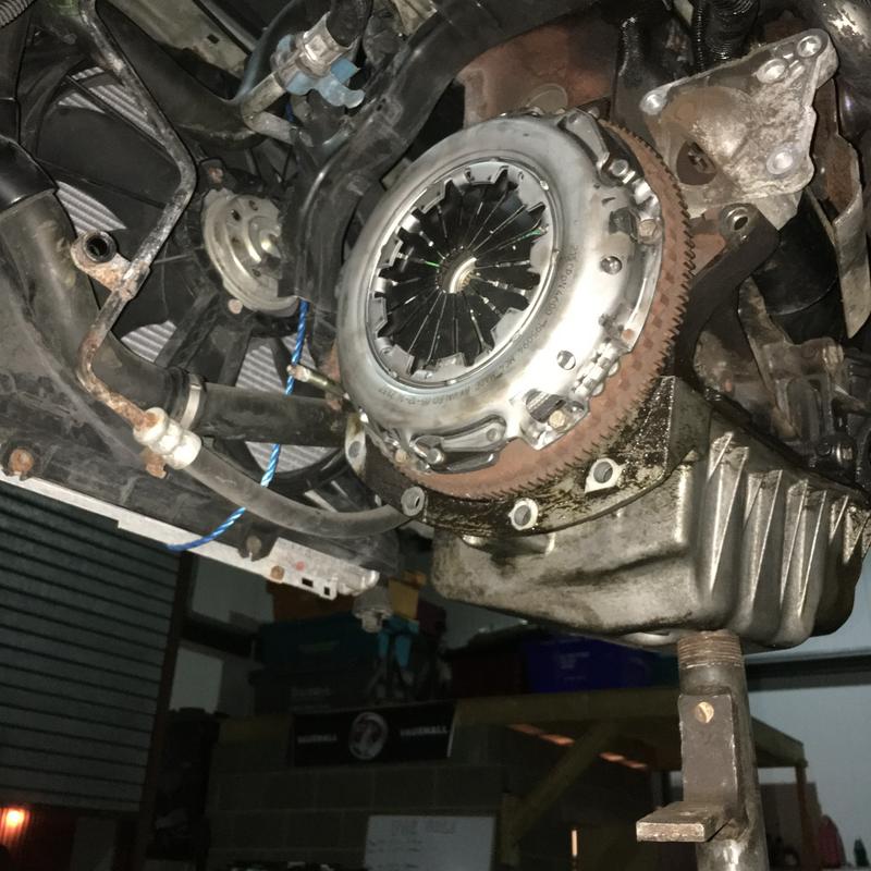

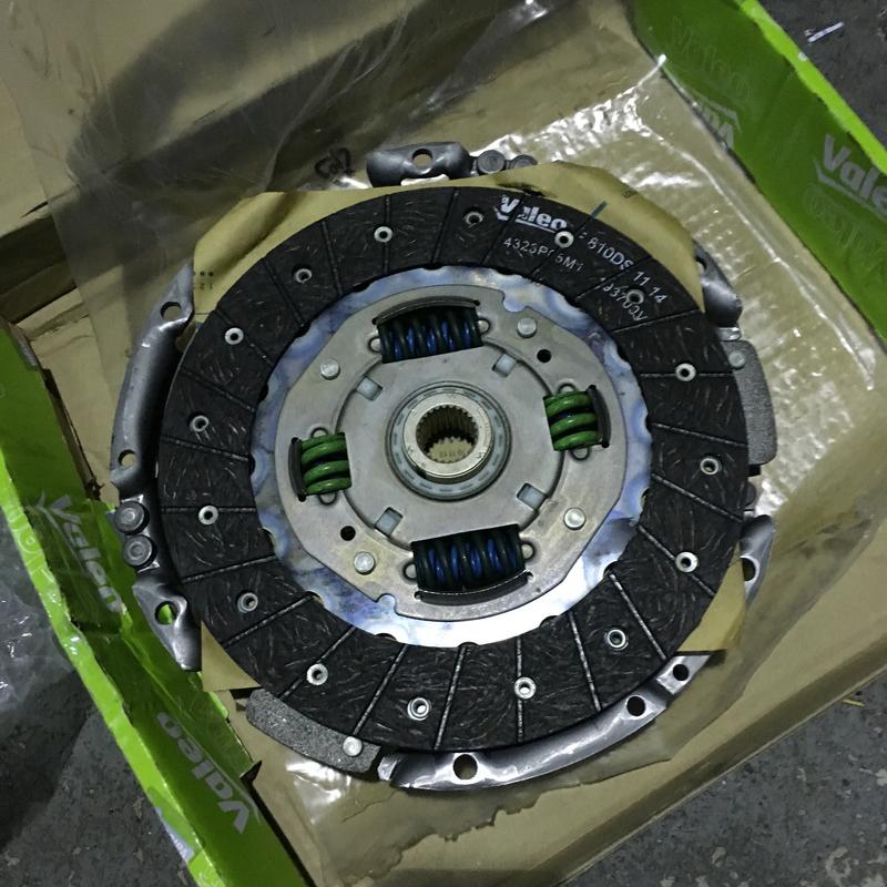

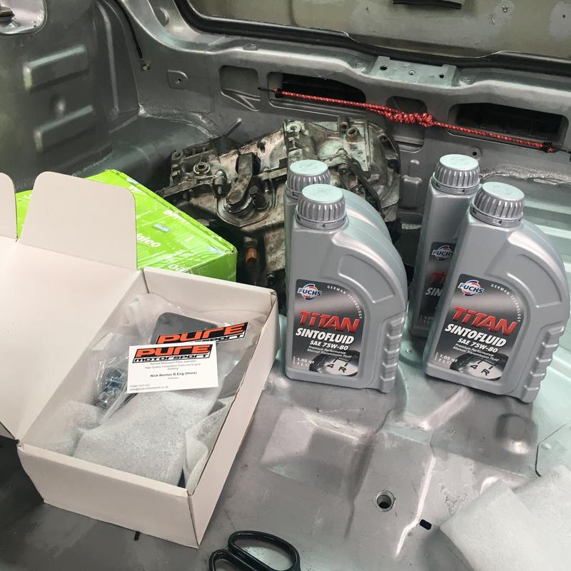

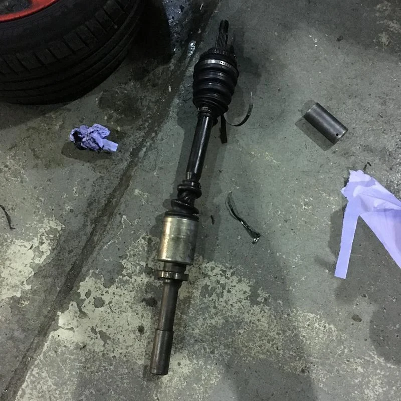

Got a rebuilt gearbox with a Quaife diff fitted, new valeo clutch kit
New CV gaitors
