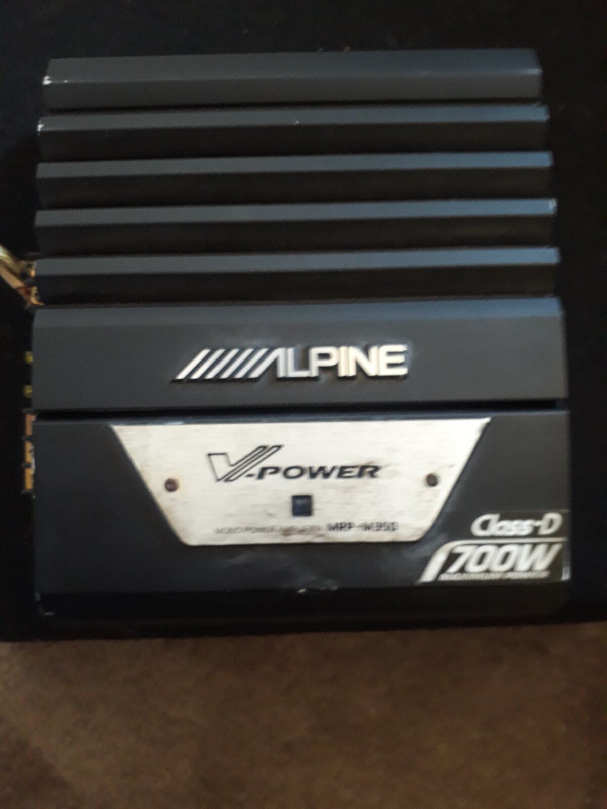

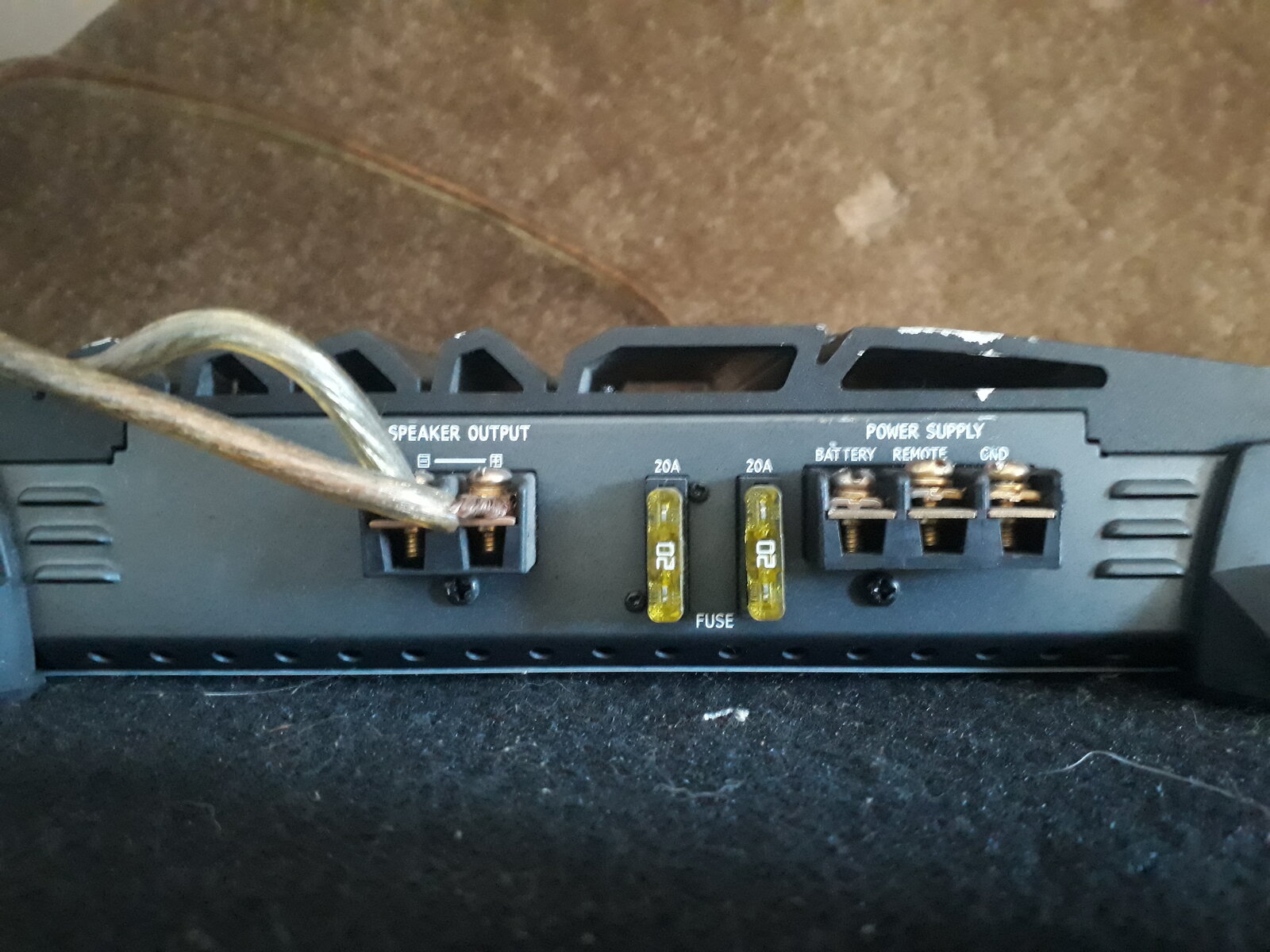

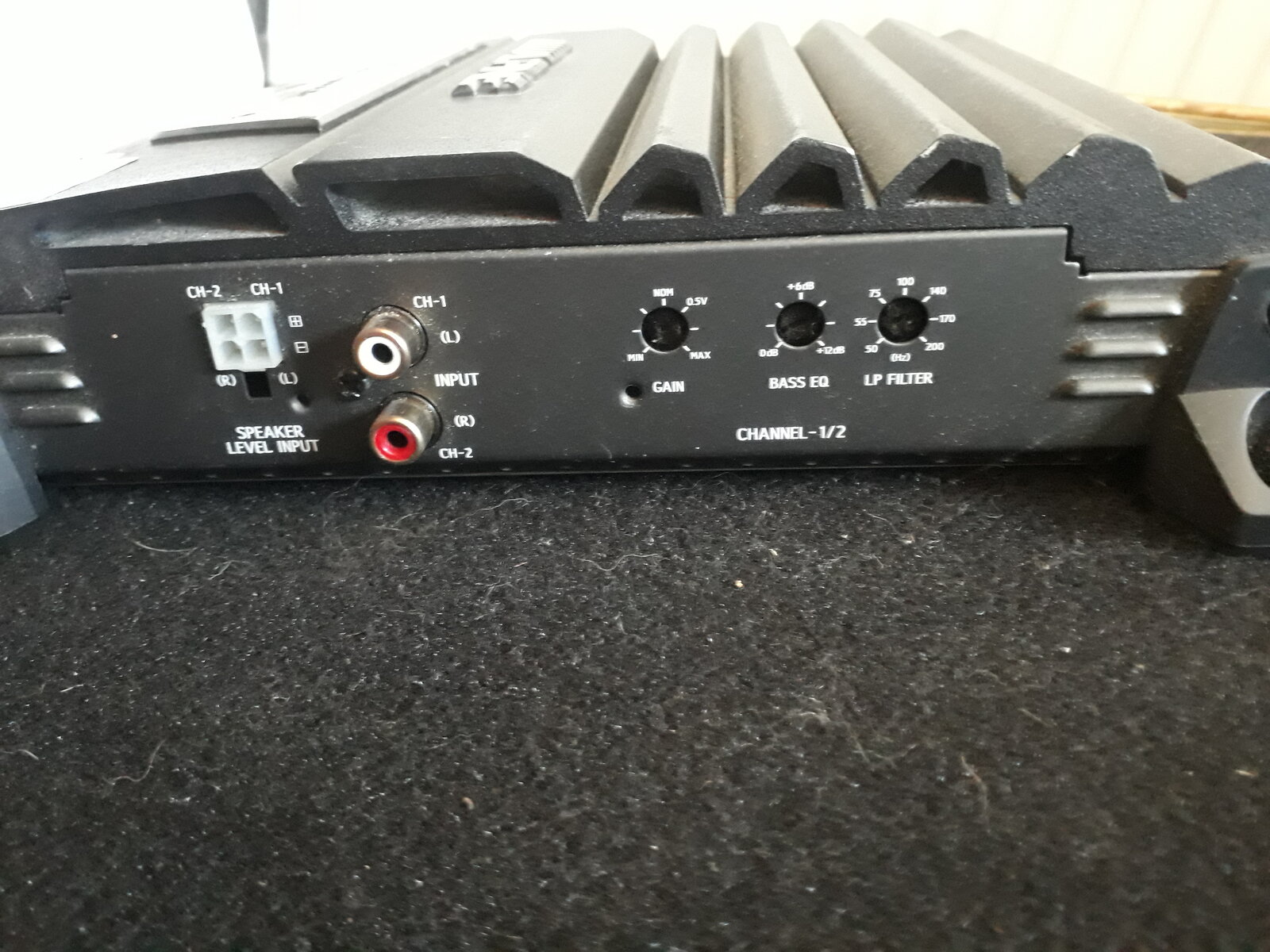

This is the amp i have, i think its running a 1000watt kenwood sub, but id have to remove it from the box to check the wattage

The connector on the left of the RCA input is the speaker level input, looks like it needs the adapter that would have been provided originally.
If you don't have this I would just purchase a line out converter and connect it to the rear speaker wires and use the RCA input on the amp.
In terms of adjustment, you won't have much, but you could use the front to rear fader to control the volume of the sub.
