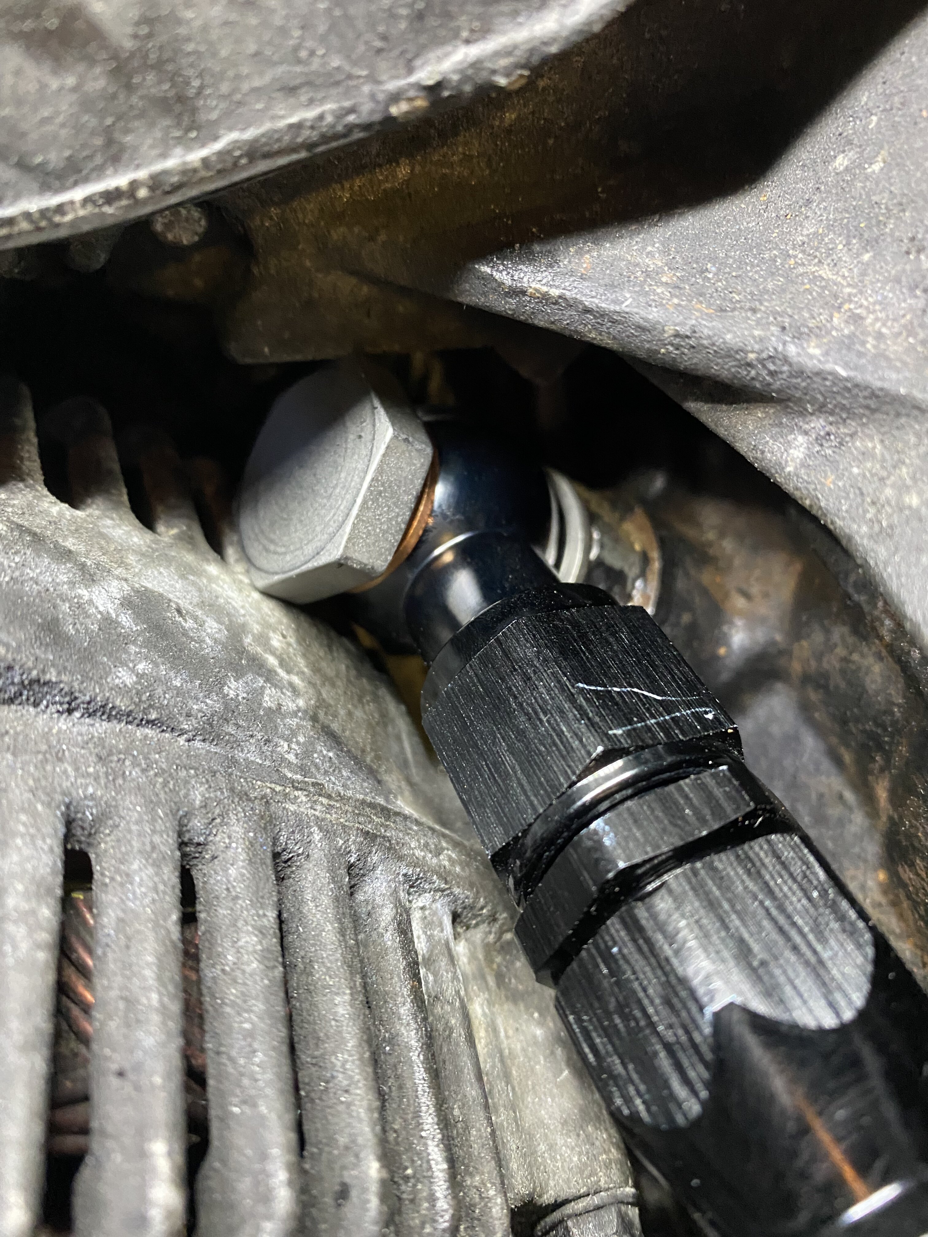

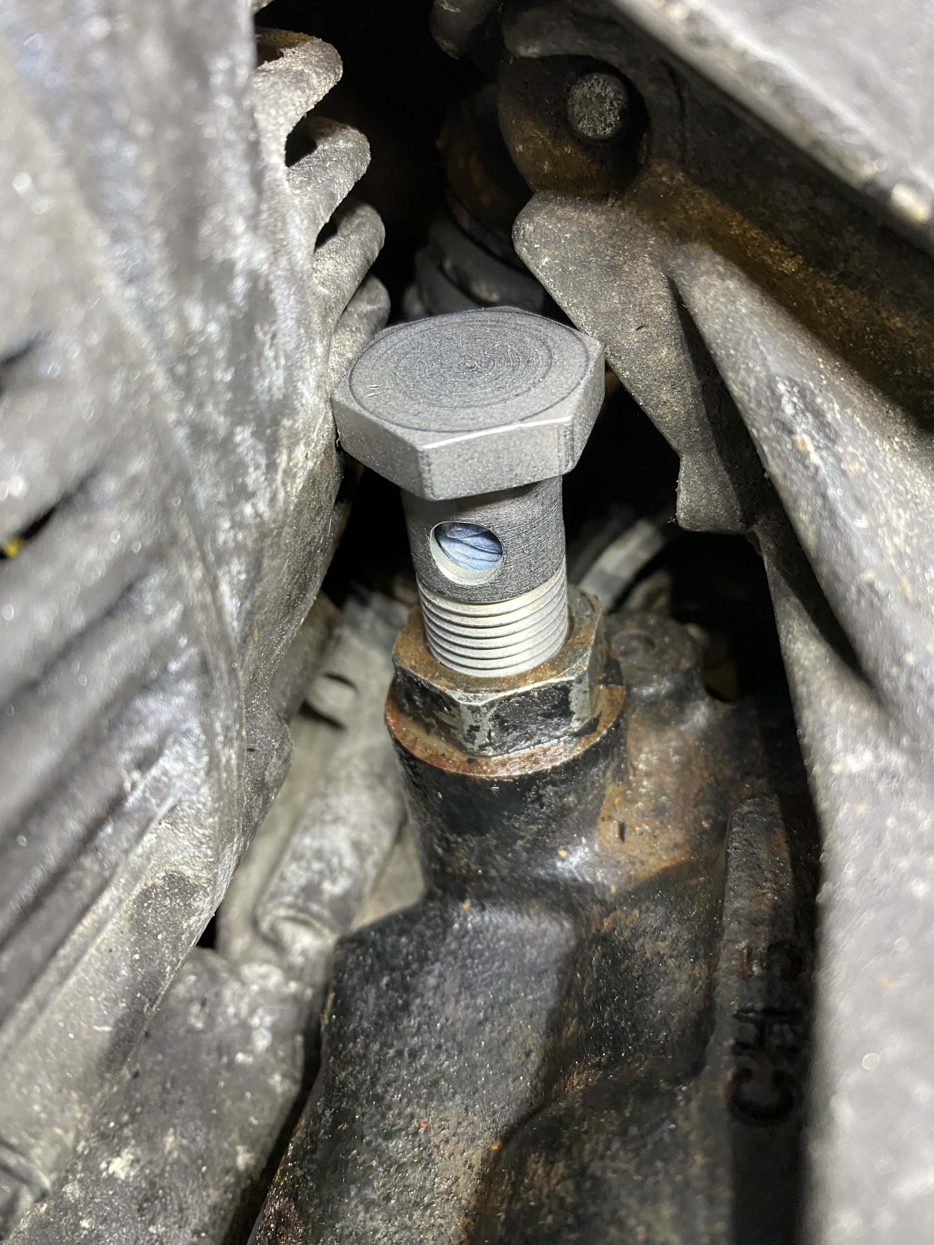

As title I’ve fitted 95% of the kit but the pump banjo is to close to the alternator to be able to turn the bolt!? It’s straight but no turns on the threads possible!?

Remove the top alternator bolt and loosen then bottom then move the alternator slightly? It'll pivot
