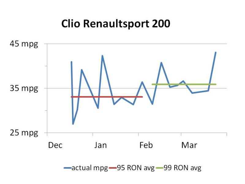

...I've done some science, and come up with the following...
Firstly, the accountant in me is obsessed with working out the true cost to me of this car, so from day one I have religiously recorded every penny spent using Fuel Log (Android app). After 4 months and almost 6,000 miles I think I've got enough data to support/dispel the myth surrounding higher octane fuel.
Run on 95 from purchase switching to 99 RON fuel early in February, the graph above shows the actual calculated mpg for each fill up over 2,000 miles on each fuel grade.
Mileage covered is mostly minor A and B roads, is consistent from week to week, and my driving style varies from enjoying the car as Renault intended to being on a mission to extract the absolute maximum mpg I can get. Fuel was provided by Tesco.
Headline figures are (95 v 99);
  • Fuel price = 135.9 v 140.9
  • Average mpg = 33.08 v 35.87
  • Cost increase = +3.68%
  • Mpg improvement = +8.44%
So higher octane fuel costs more, but you go further on it.
Cost per mile;
  • 95 RON = 18.68p
  • 99 RON = 17.86p
Saving from running 99 RON = 1.18ppl, -4.369%
Doesn't sound much?
That saving, over a full year covering;
  • 6,000 miles p.a. = £81
  • 12,000 miles p.a. = £163
  • 18,000 miles p.a. = £244
  • 24,000 miles p.a. = £326
I for one am sticking with it...not only is the throttle response, flat spot, and general driveability at low revs massively improved, at 18k p.a. I get almost 4 full tanks for free over a year.

Interesting stuff. I can't quite work out whether the extra outlay for the expensive stuff will recoup itself for me, pains me when I see 1.44 come up when I reach for the Ultra unleaded pump!
  Sunflower Ph1 172
Suppose it could be said that the cooler weather and denser air could contribute to lower MPG during December and January, plus you'd just bought the car and therefore enjoying it a little more, calming down after a couple of months.....
I'm just playing devils advocate really.

Fuel becomes denser too. Fill a plastic jerry can up on a cold morning and see how much it expands in the afternoon! Swings and round abouts i guess.
Interesting read though.

Agreed, while you might expect a higher RON fuel to give slightly better economy I dont think you can call half a dozen tanks at a different time of year a particularly accurate test.

Understood that there are other factors here...question to Chip...when switching fuel, how long before the engine properly works its best with it?
I'm going to carry on adding to this data, so will alternate between 95 and 99...but want to make sure I get a good reading from each change of fuel.

OK, plenty to think about then. If I'm honest, most of the previous 5 posts are simply noise to me LOL
Going to keep the data coming in, think I might alternate each month so 4 tanks or so on each grade.

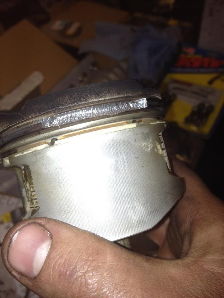

Bear in mind while doing these tests that at full throttle on 95 RON each time the knock sensor triggers its because your engine has been subjected to a potentially damaging detonation event which has just sent huge shockwaves through the piston and rod etc and that over time you may well increase the chance of the rubbish quality cast pistons breaking up as a result.
So while its quite interesting to do, I wouldnt really be up for doing the same testing myself if its a car you care about and you are likely to drive hard.
This is the sort of end that the pistons are likely to end up at prematurely if they experience a lot of det.

Really?
Even though on the filler cap it lists both fuels?
On my 172 Cup the flap says 98 recommended, but there's no recommendation on my 200.

If Renault list it as 95 RON safe then it shouldnt be an issue mate, apologies, im too used to the earlier cars and wasnt aware they had made that change on the 200.
Although personally even still, I would prefer the added safety of a more det resistant fuel.

I find that sort of damage hard to believe from the standard cars map. Maybe from an aggressive remap that has a smaller safety margin by being on the brink all the time.
