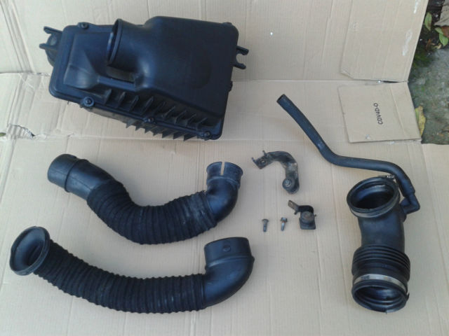

What is the bar called that runs up the side of the battery in a 182 that secures the air box. I cant find any and the 182 is missing it so the air box bounces around a lot.

Unsure what you mean when you say the "Bar" as the bar i have got does not hold my air box in.

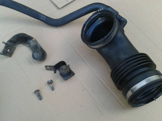

There is two rubber bushes that come with the air box, One at the front and back.
Shown in the picture below is the bolts and the brackets that connect to the two bushes.
  RB182

Can the bushes be purchased seperately?
My airbox seems to be missing the rear rubber bushing.
My airbox seems to have two spaces for the bushes (1 front and 1 rear) but they are open ended and seem as if a bush could just fall out (likely what happened with the rear)

Im sure the bushes come with the air box as i can't find them as a part or part number
The bushes have grooves / slits in them and the slide in and hold.
Here is the only picture i have
Don't buy new, find someone who is breaking a 1*2 and buy them.
Pop a wanted add in the wanted section with the picture which you have posted.
