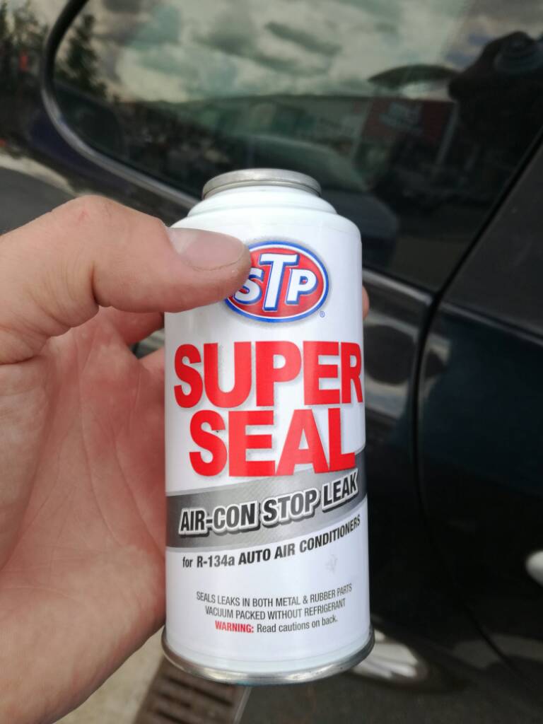

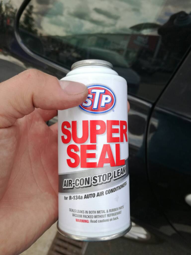

Have used it today, no click or any a/c clutch engagement noise unfortunately. Also booked on a Groupon website an air con check n refill for 19£, Derby area. Will visit them next week, pre booking required as well. Hopefully, the air con sealer worked fine, no way to check it(((

Ffs you've not even looked to see where the leak is and how big it is before putting that in.
You can't just throw refrigerant into the system if it won't hold vacuum.
Yep, not looked in, just cuz tech said it had a pressure in accordance system for a few minutes, and started going down a bit later. So I hope that was a minor leakage. (((

Don't use super sealant. When I re gas a car with this stuff in it blocks my aircon recharging machine up and I have to strip my machine apart to clear the blockage. Now I won't 're gas a machine that's had that stuff put in. Find the leak and fix it
