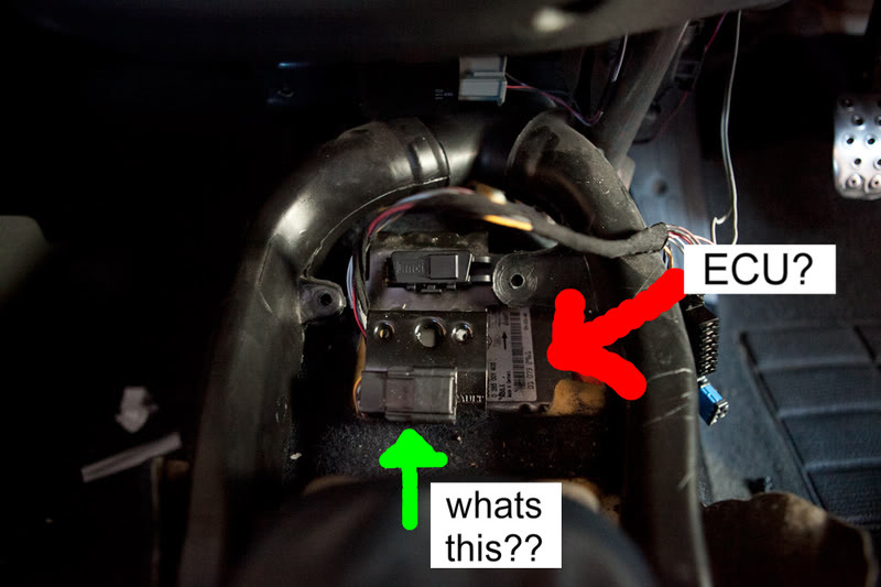

Please have a look at the pic
is the red the ecu and that the hell is the green arrow pointing at because it had nothing plugged into it.
And HOW do I get the airbag ecu out!!
Help please :(
got it out. what a mission. a bolt on the bottom left, top left and top right, and a clip thing in the middle of the ecu plug that you push in to get the plug out.
Still have no idea what the random plug is for?
Not sure either. The only thing under there are obd and cigarette lighter bits iirc. Car working without the ecu ok?
Ye its confusing. oh well
