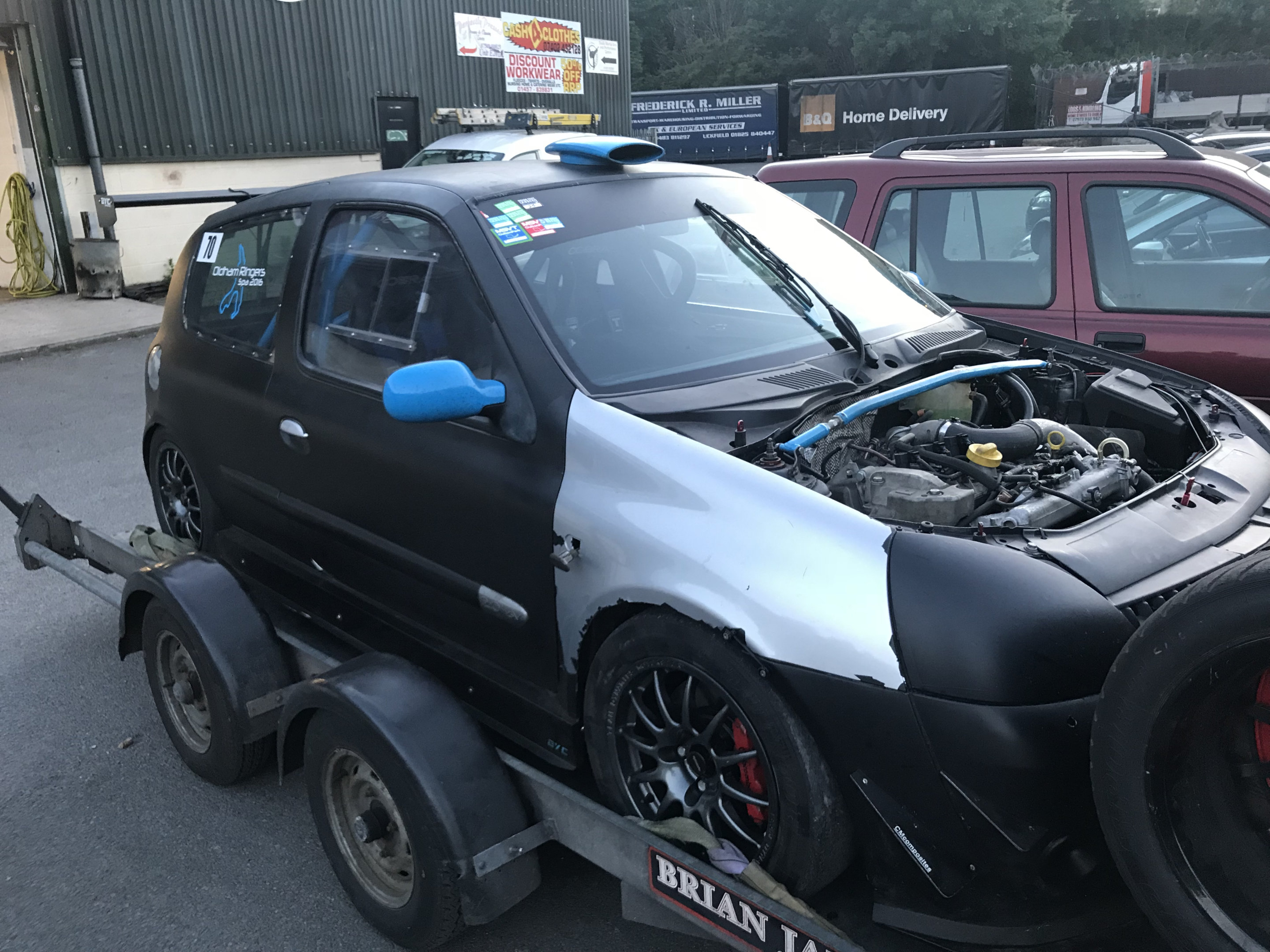

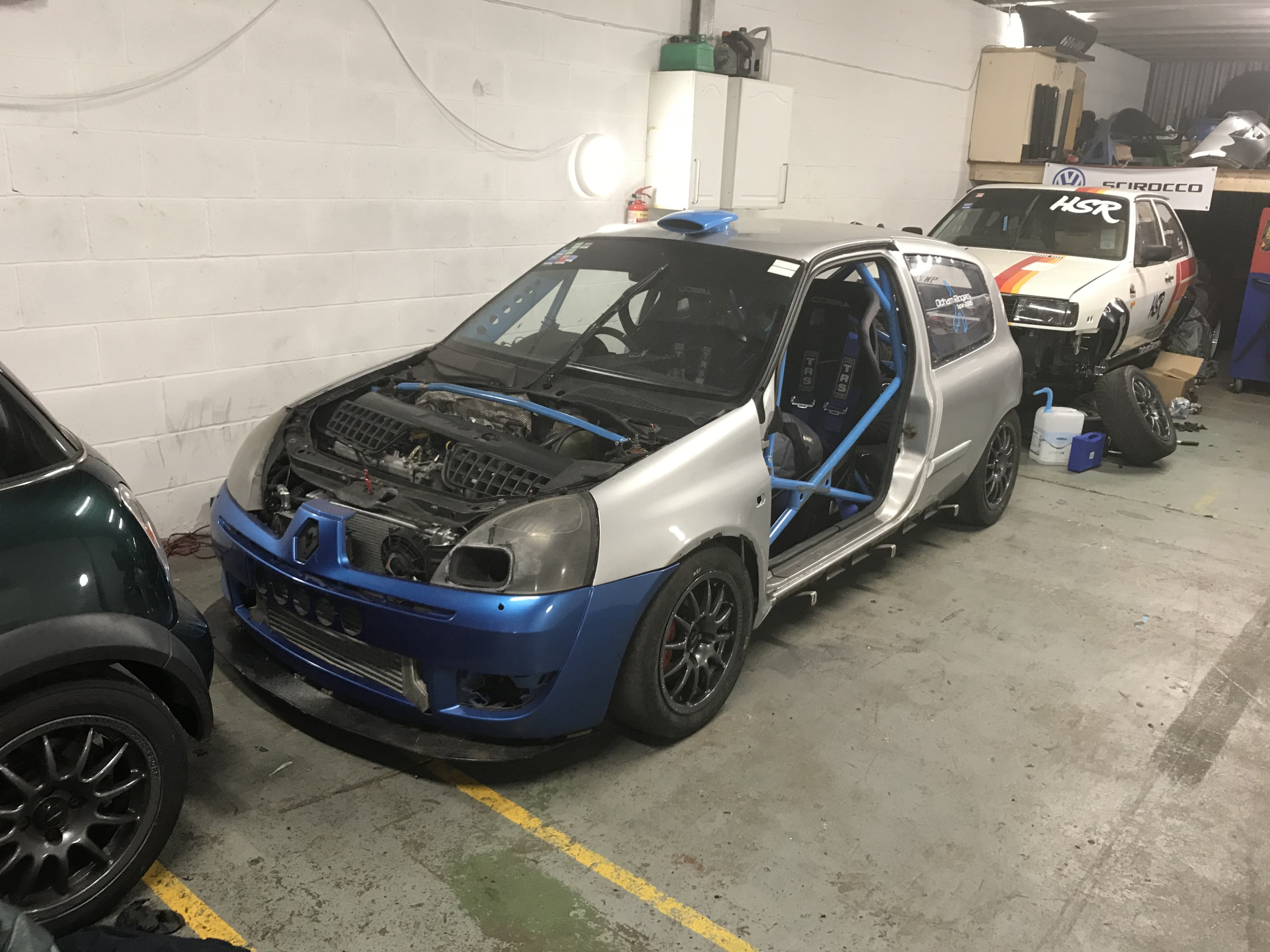

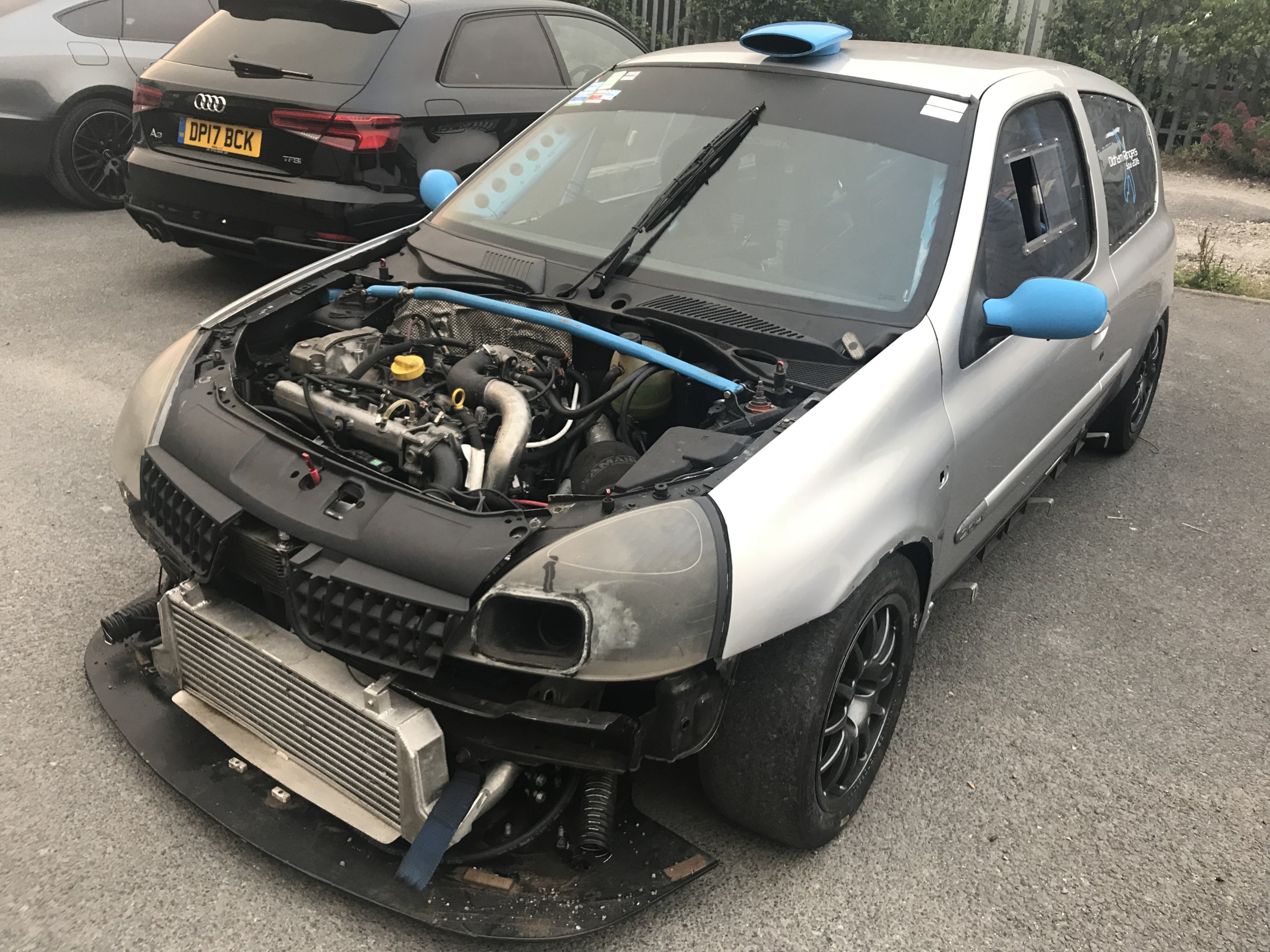

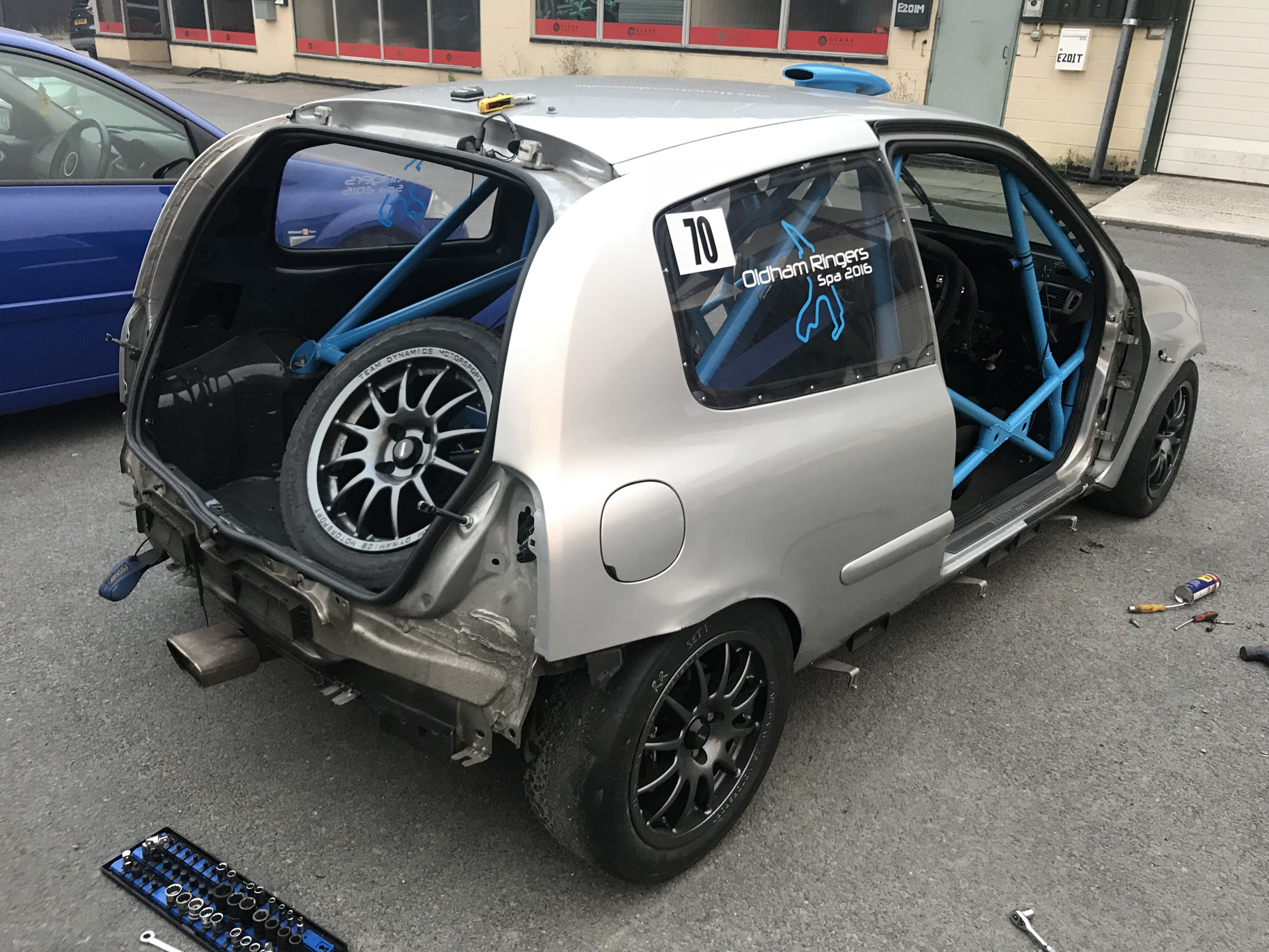

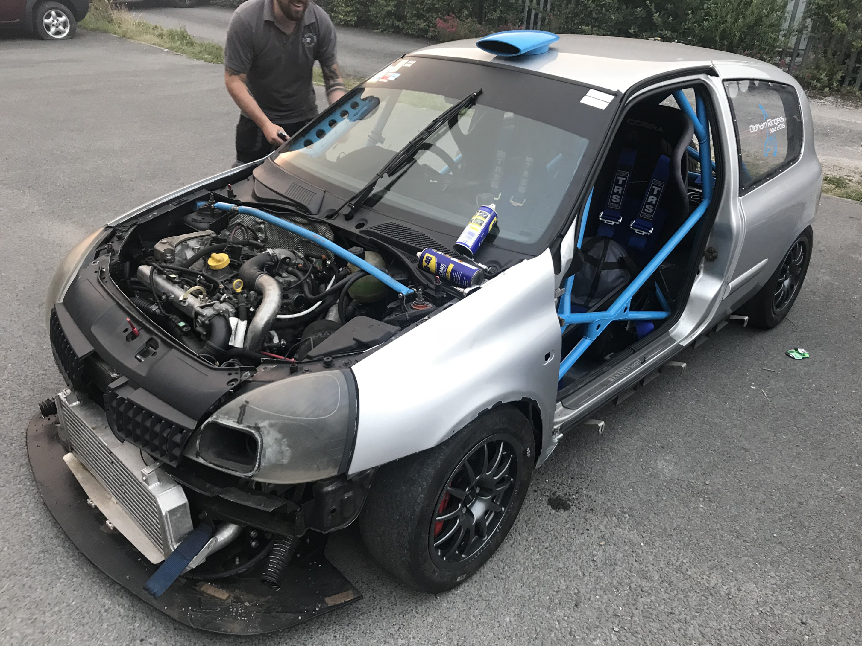

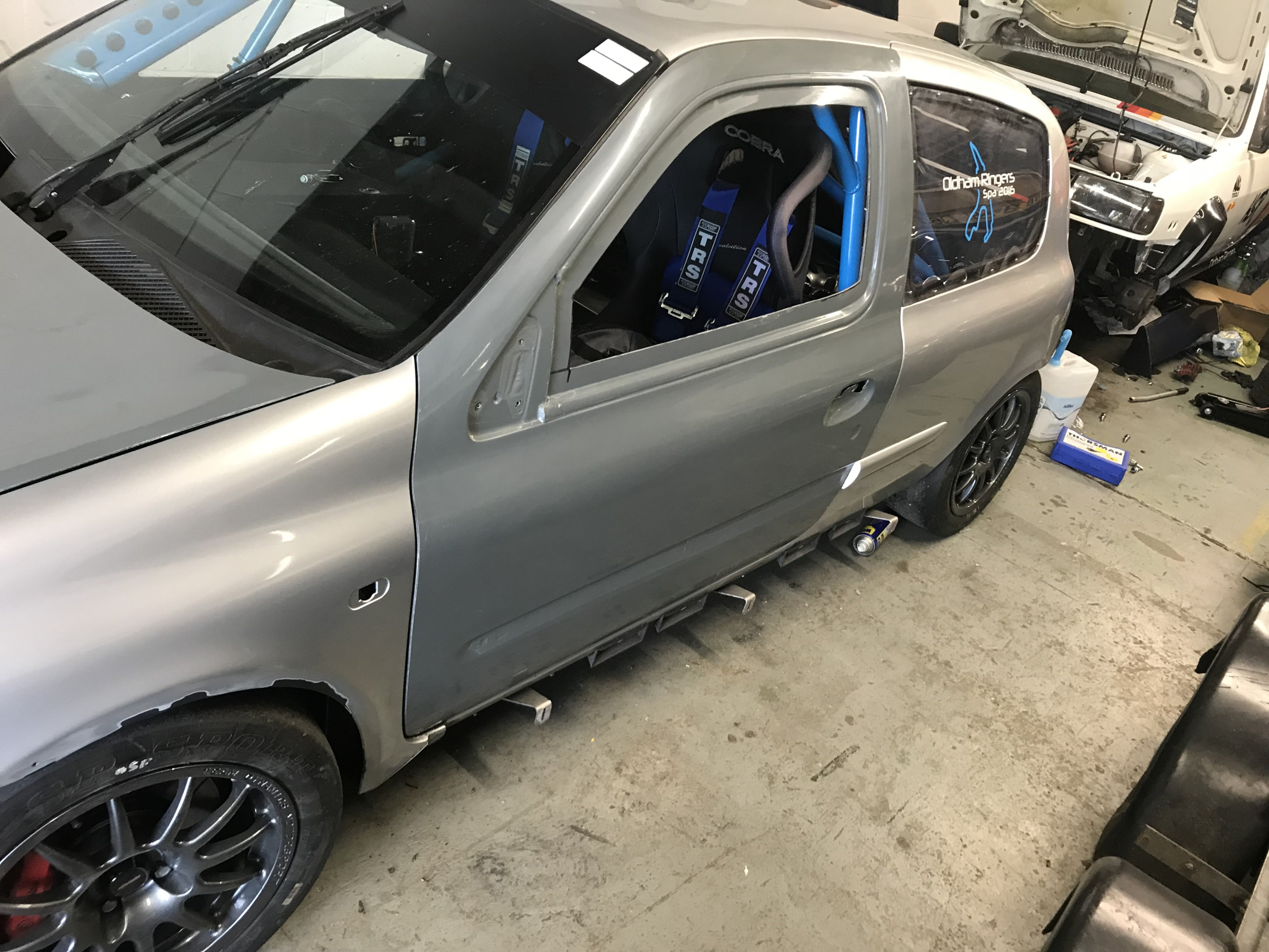

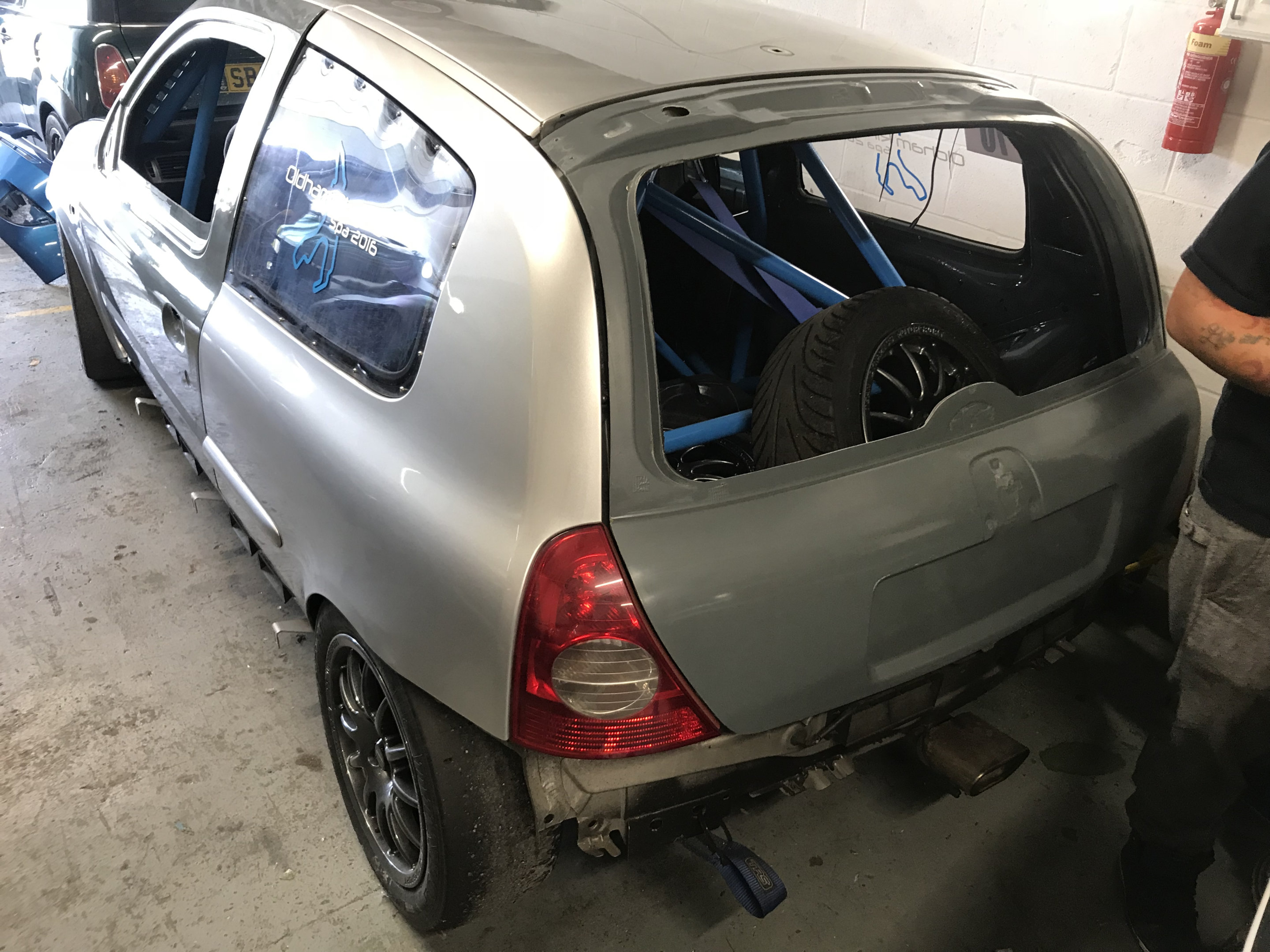

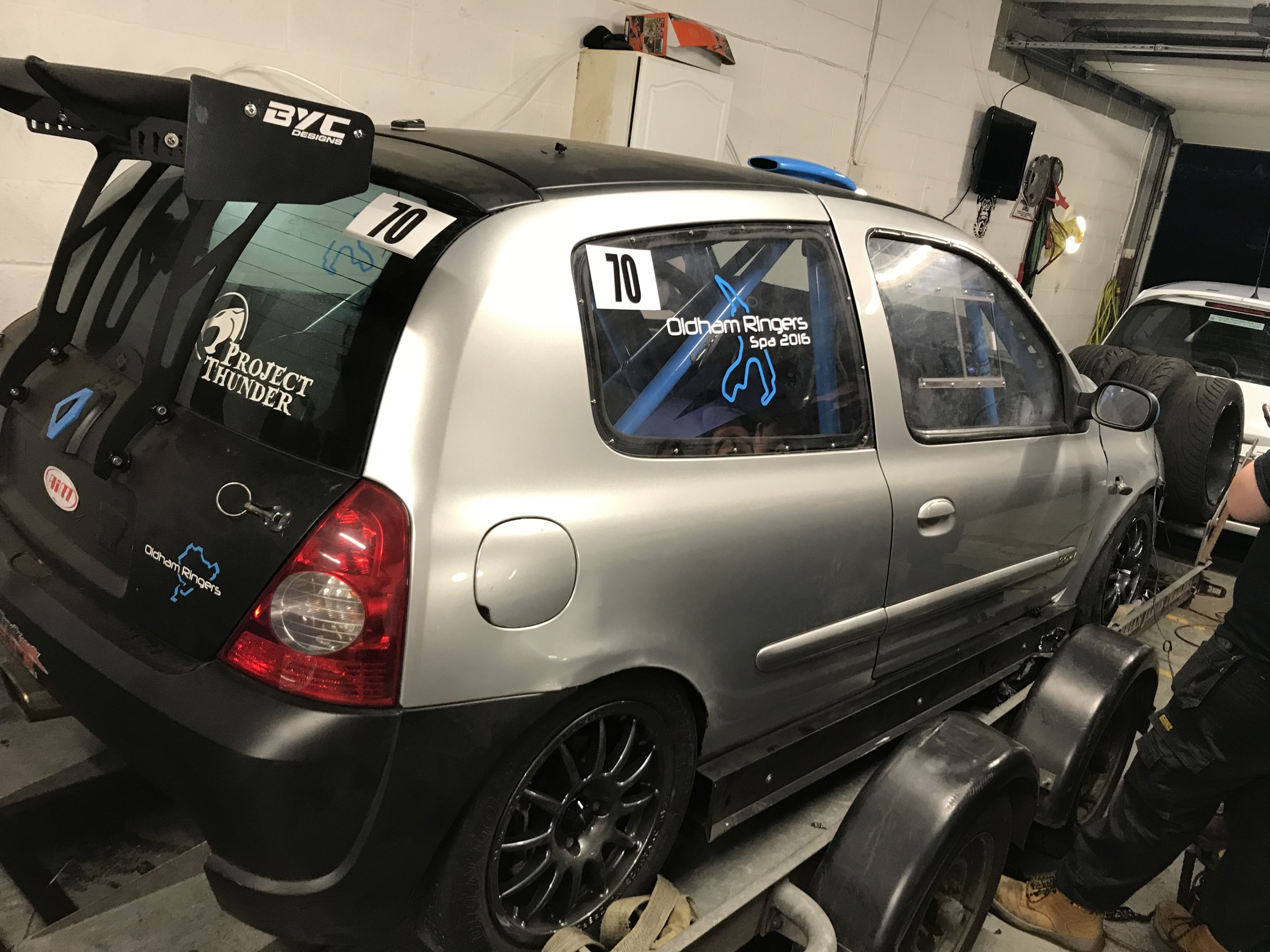

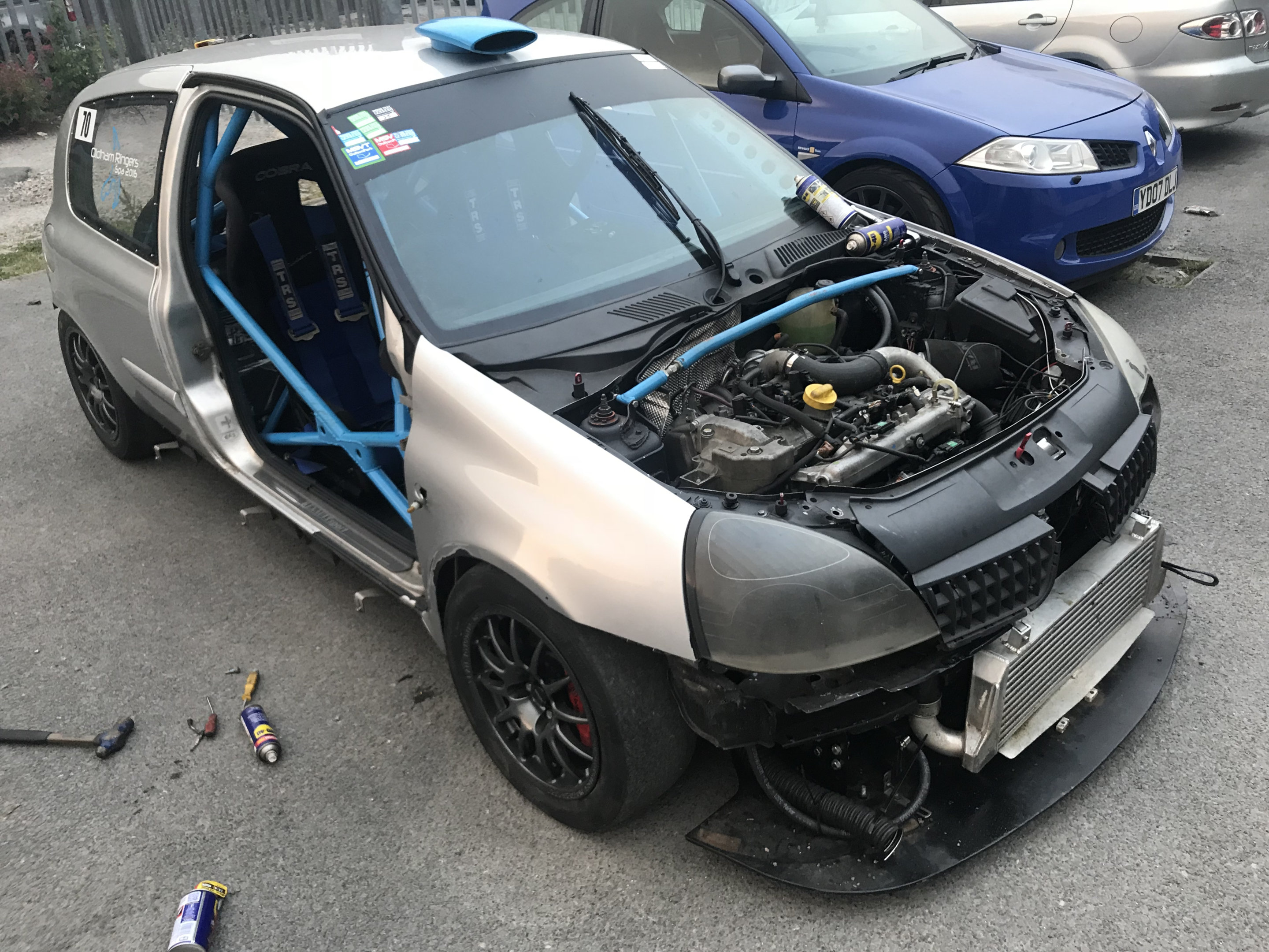

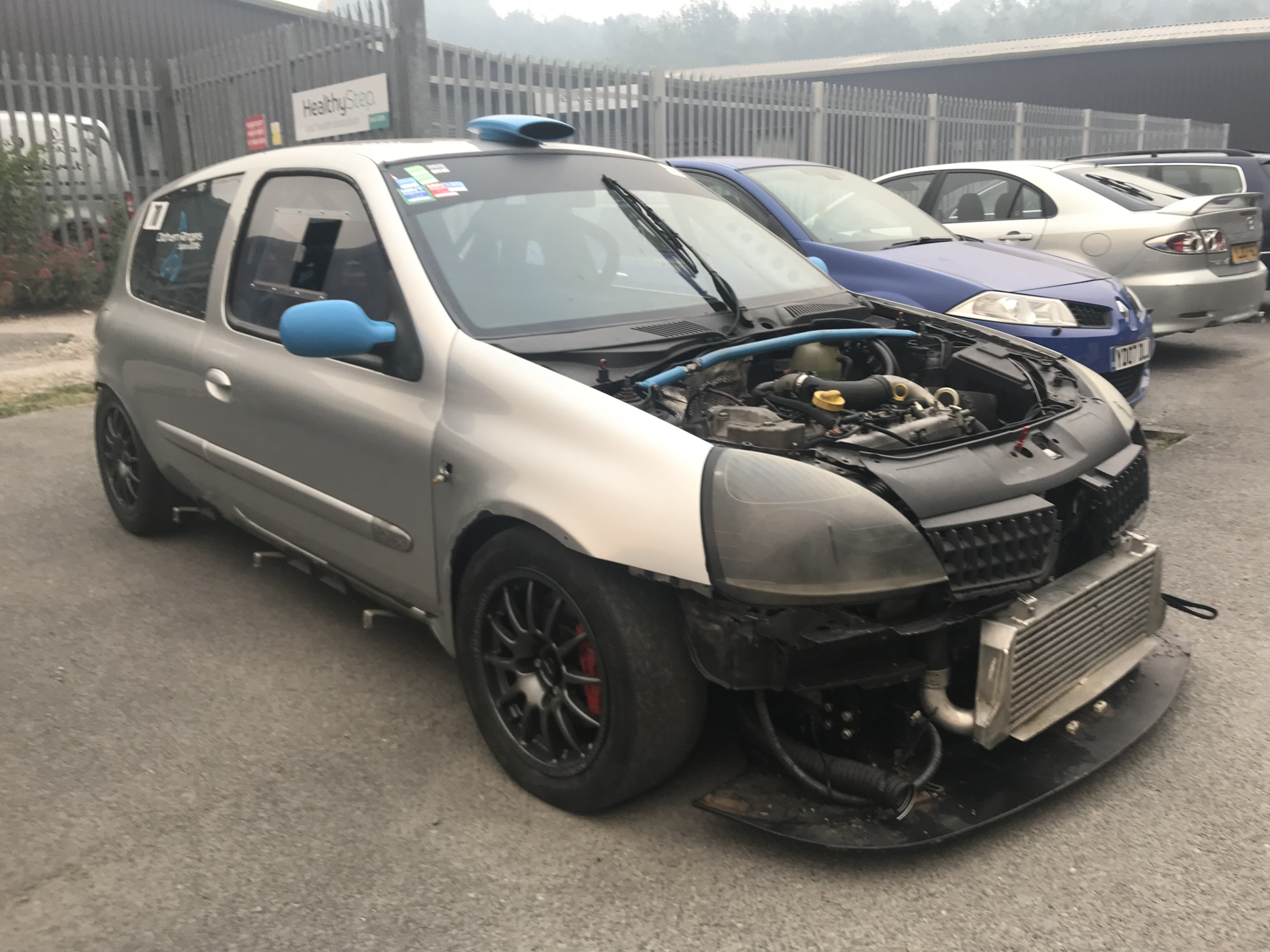

ok update time! cars been off the road since the last trackday in Feb. for no other reason than to upgrade. the car was perfect on the last outing and I have taken it all apart again!
Main thing were the group buy on roll correction hubs, which have been done and fitted and then the geo redone at Blink including straitening me wonky rear beam so car should be better than its ever been at the min!

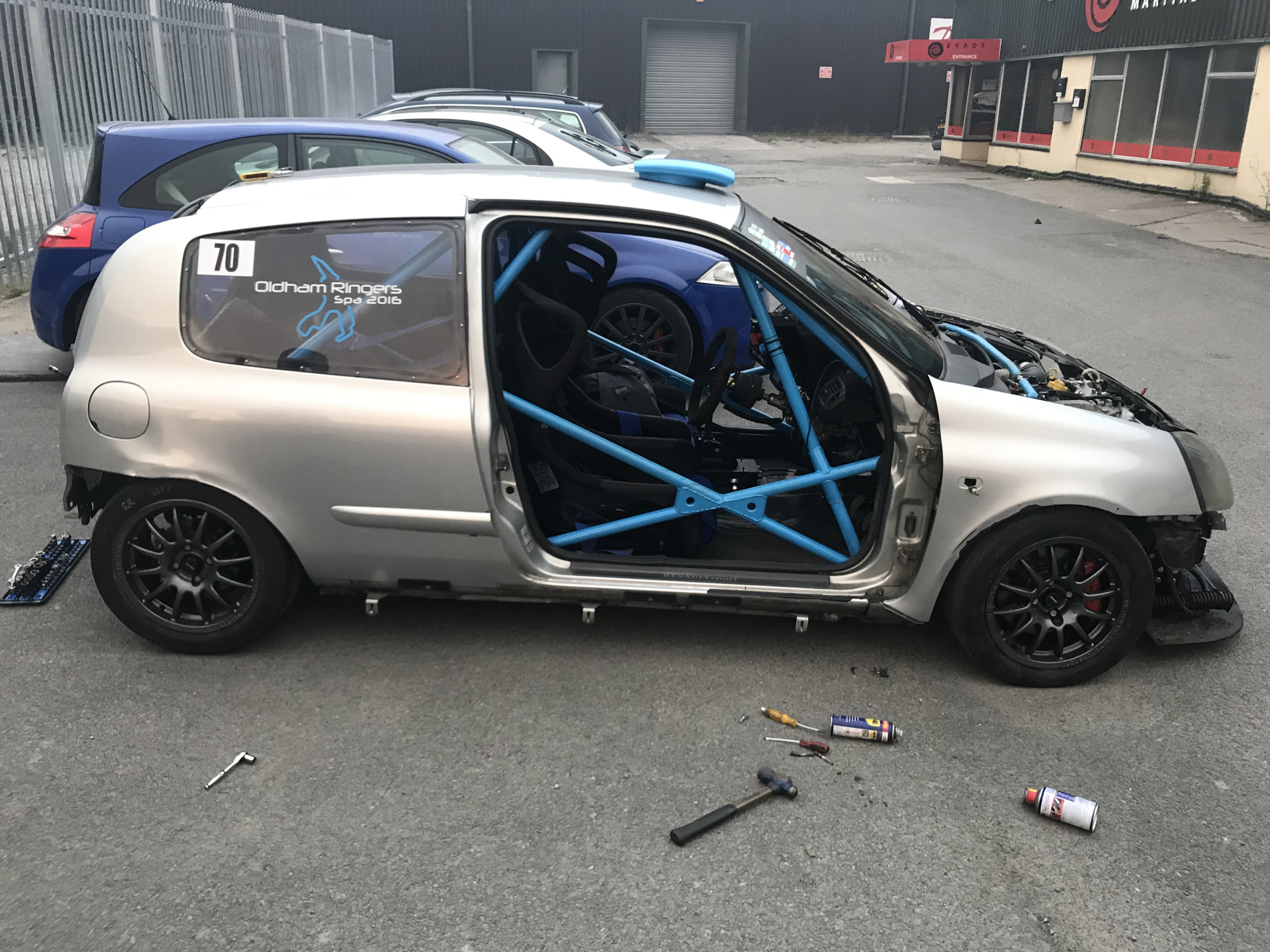

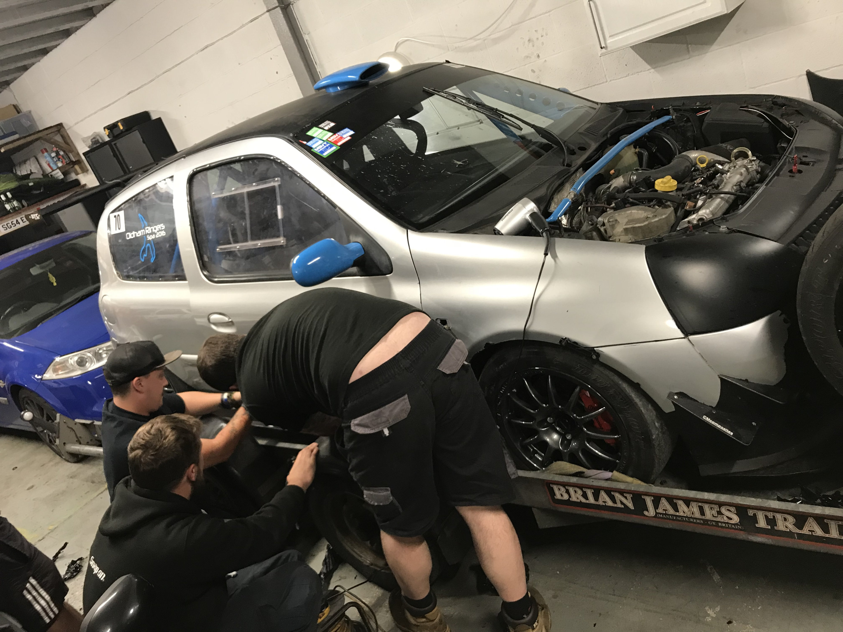

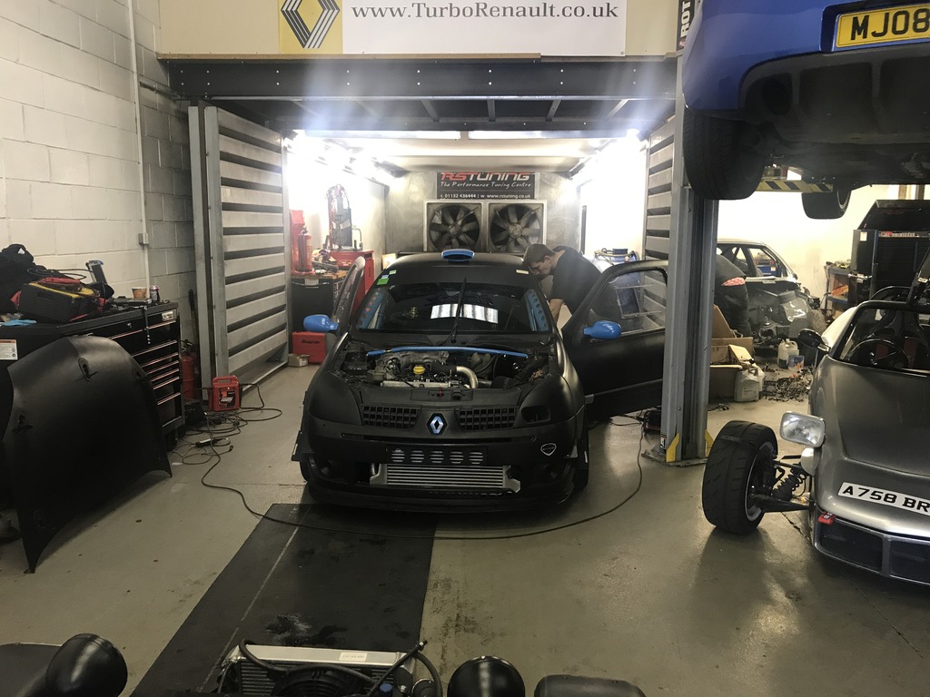

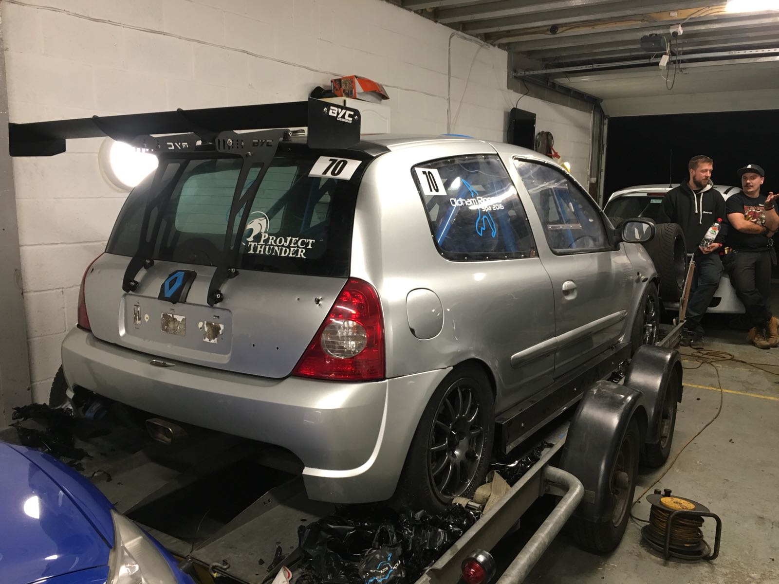

Upgrade, well a full Megane 250 came up for sale. It was a risky one as I spoke to the lad who crashed the car and he said the engine/box were dead so walk away. ended up looking at the pics and taking the risk and buying the full car. turns out engine/box both survived it had just pulled the driveshaft out spilling gear oil everywhere, Result! I broke the car and sold everything I didn't need including the LSD box as I would retain my gripper diff 225 box. the original plan was to run the engine on my loom/ecu and loose the VVT like most people do. however paul at rs tuning who was at the time building his mk4 clio with 250 engine/ecu/VVT setup said, if mine works we can try on yours. turns out this is possible but not straight forward. Ultimately paul and specky have done it. the car is now a mixture of many things from a megane 225 and a 250 but mainly the ecu is 250 loom 250 boost pipe setup and intercooler (forged item that came off the crashed megane) car was mapped last week at RS Ttuning and made a healthy 312 BHP whilst leaving the torque at 330 to see if it can actually use the power on track first.
That's pretty much where I am up to, car goes to oulton park on Tuesday the 19th for testing as its driven off the trailer to the ramp so far so a bit unknown.

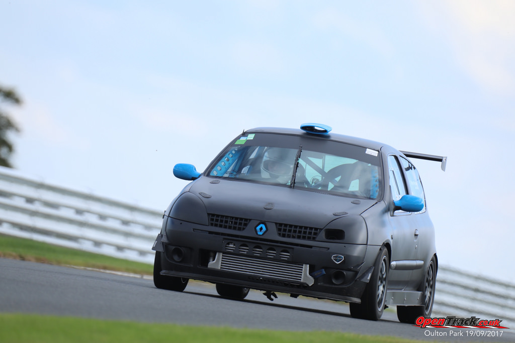

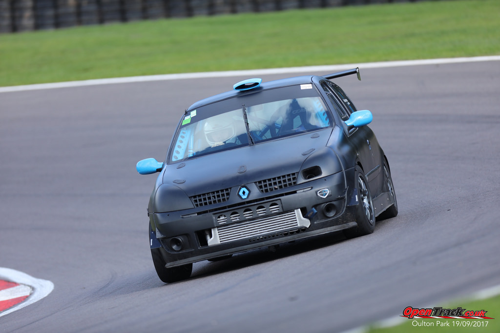

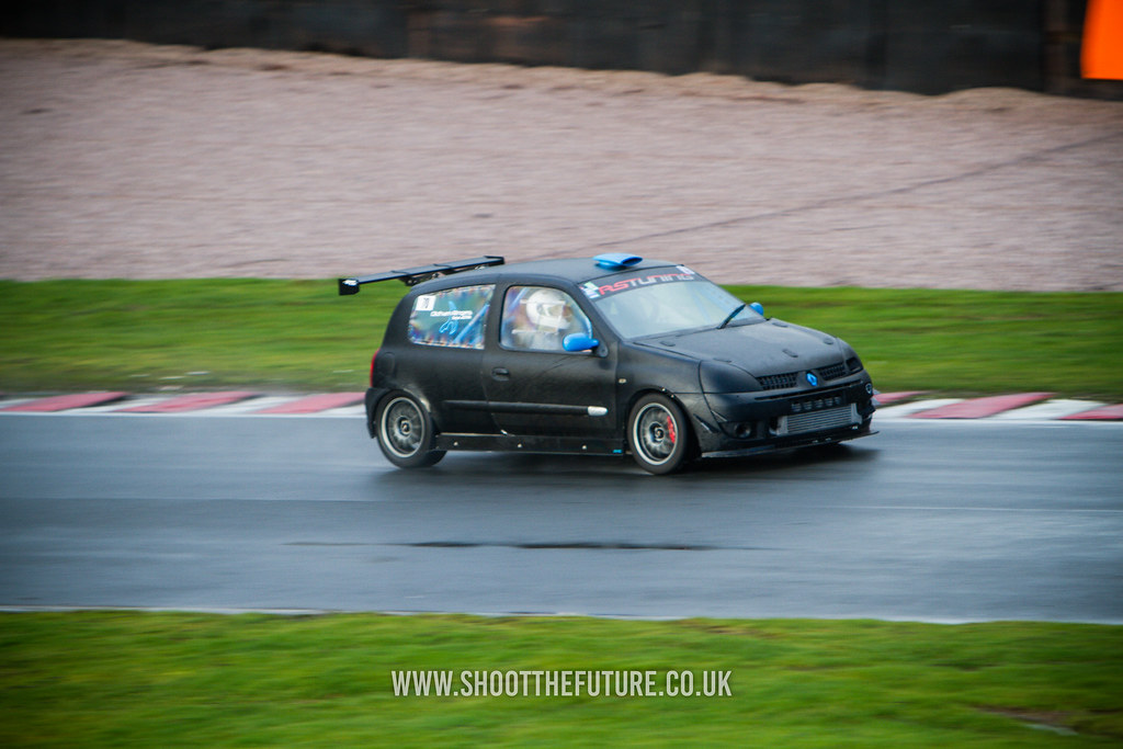

Did oulton park last tuesday with OpenTrack and for its first outing it actually did very well and ran all day till the end. Only little issue was again the fuel pump wont seal and when it has a full tank leaks fuel around the corners. Going to try and tighten it down with the proper tool and possibly seal it shut as its happened before. Apart from that the car run faultless all day. bit of under steer all day which i think was from the rear tyres. only had 20PSI and didnt have a pump, but was only to test the engine so just ran it like that for the day. Car pulls and pulls in any gear now RS tuning have done a spot on job of mapping this one! Few pics/vids from the day. Hope to get out again in 2 weeks time another oulton with open track, may even pop the slicks on if its going ok!

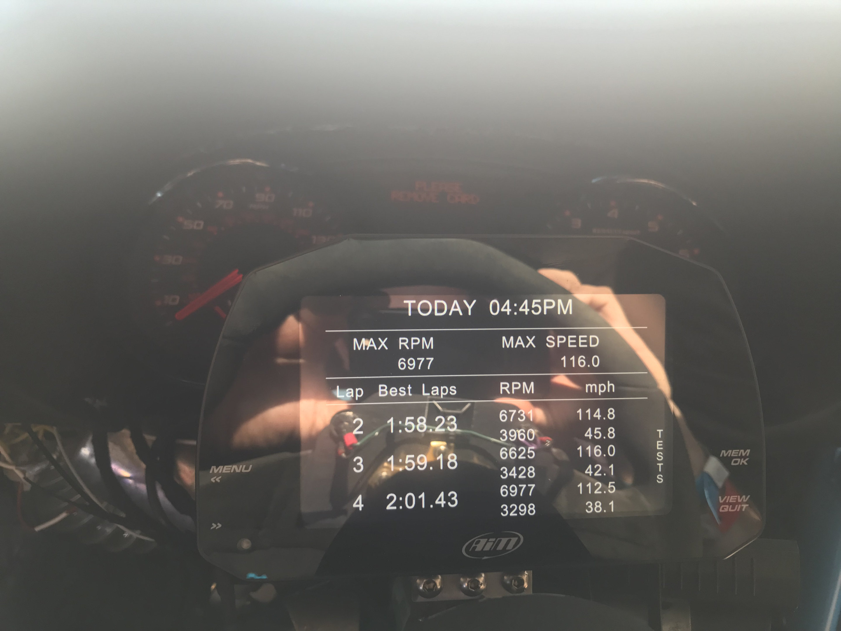

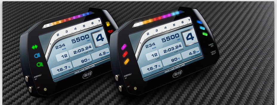

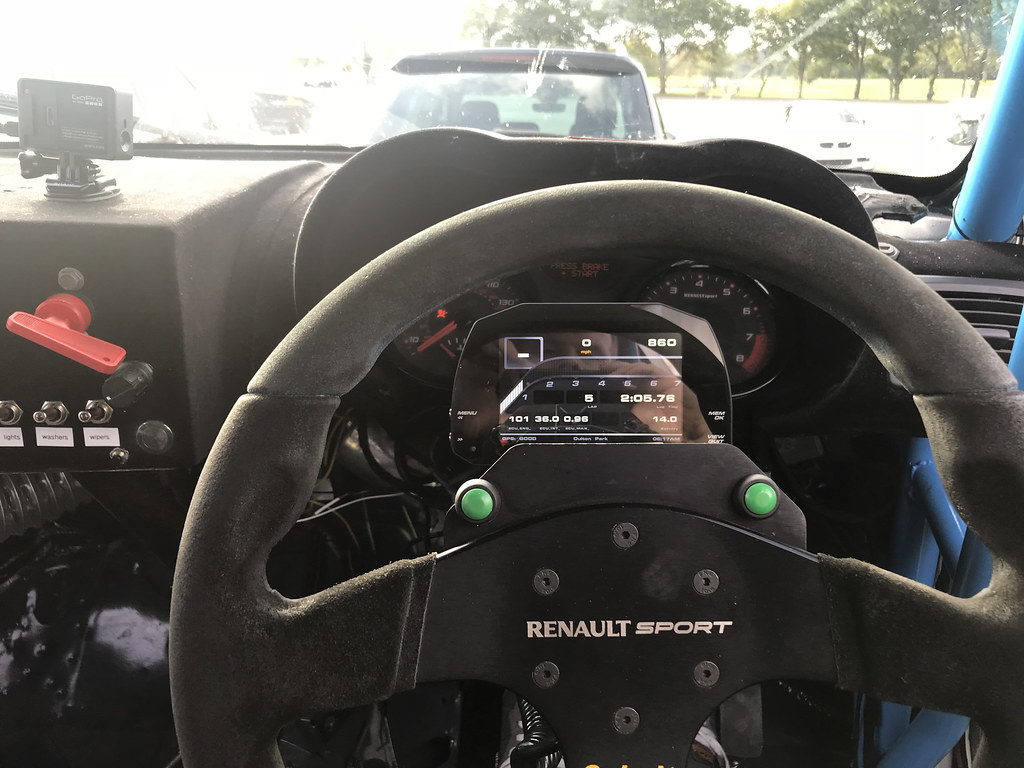

Also bought a new dash for the car as the combination of ECU's has left me with not much of a working dash. have gone for an AIM MXS Strada which will do allot of functions for me, going to start wiring this tonight so it will hopefully do something for the next track day.

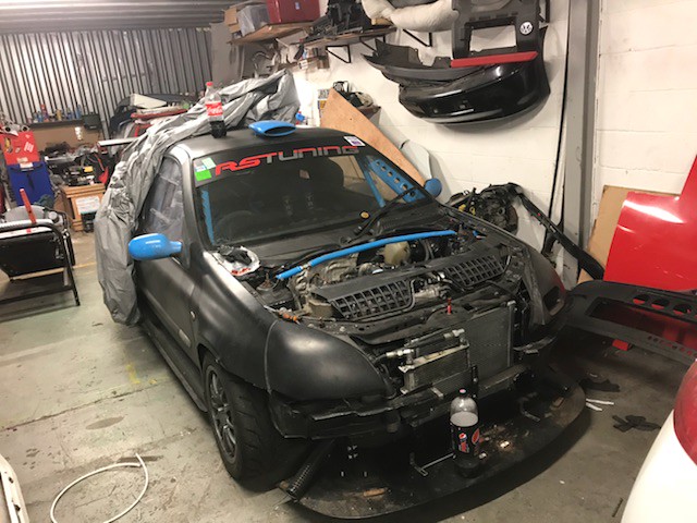

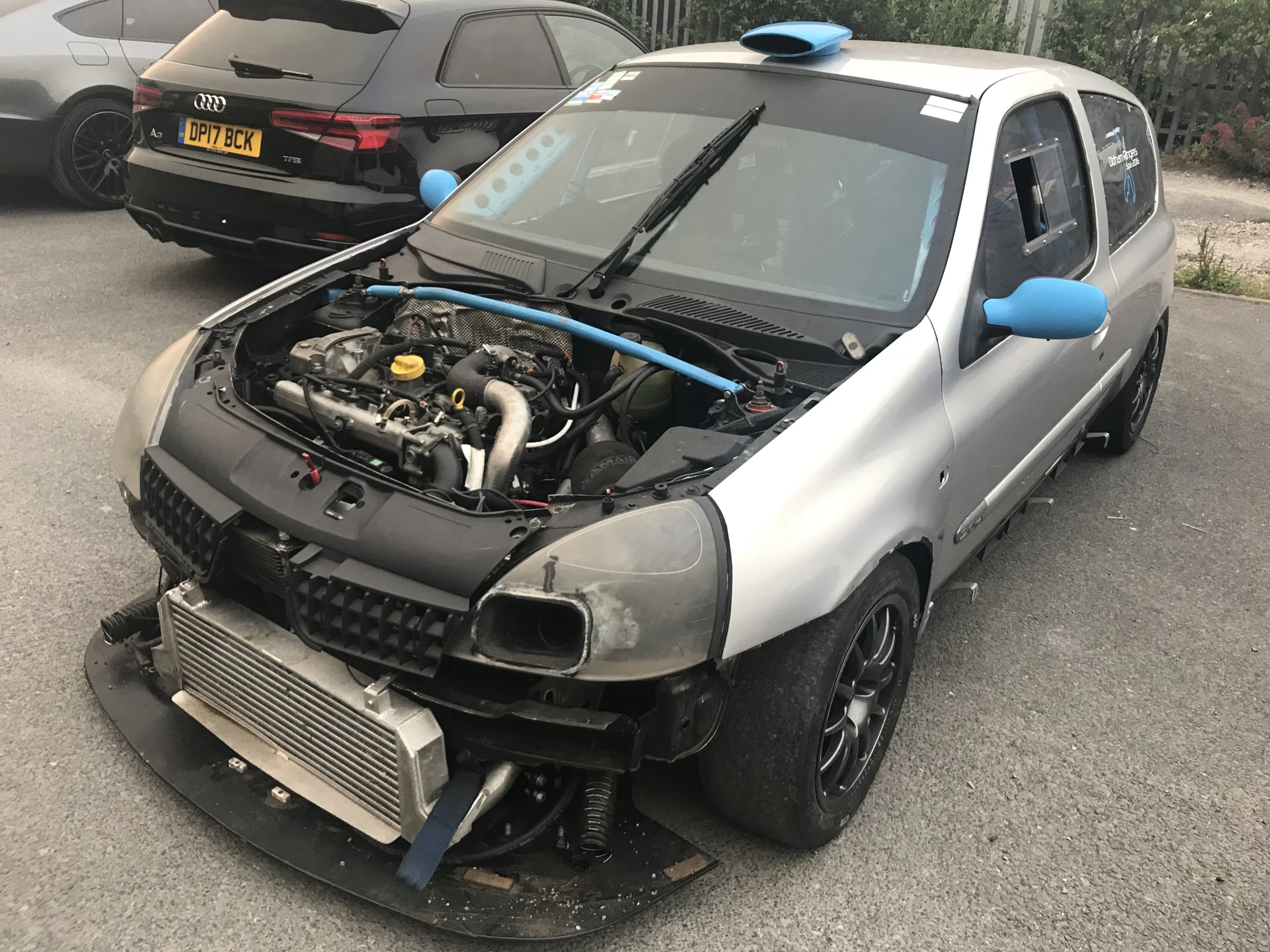

it was actually duct tape lol! there is a hole in the splitter where the oil cooler was when BYC designed the splitter so he just cut a hole at the time. we have moved the cooler now and tapped up the hole, but didn't work lol. joiner mate is going to cut me a new one long term as I have cracked this one a but getting it on the trailer!
Also need to sort the wonky exhaust since the new engine it just wont sit right
What a beast 😅 damn excited to see someone has done it before. So you say you kept the 225 box with gripper, would the 250 engine and box fit? Reason why I'm asking is because I'm from South Africa.....just landed a 250 cup engine/box/loom and Ecu, :grimacing:We don't have much info here and before I even attempt to try I would like to just find out if it would fit the Clio 182? :blush:
yes 250 engine with a 225 box and gripper diff fitted. the engine isn't a direct fit you need to notch the chassis leg and run custom shafts exhaust etc so possible but much easier to fit it to a 107 clio.
mine now runs a mix of 225 wiring loom with 250 ecu and some magic to make it all work by rs tuning. you would probably have to fit the full 250 ecu/loom and should be possible but again not straight forward!

Since fitting the Aim MXS Strada Dash (this is epic by the way) its allowing me to monitor temps much more closely and trigger alarms when things get too high. My main one was water temp. when i did oulton it became apparent it was creeping up high way to fast. was seeing 105+ very easily and saw 110 so called it a day and had to short shift/short sessions to try and get some track time. when researching the 250 megane intercooler kits come with turbo water cooler as they struggle with temps so my clio radiator wouldn't stand a chance it seems. i bought a new cup ally rad and tried some redline water wetter. Took the car to donington and it was better but still no joy, when under boost the temps just cant cope.

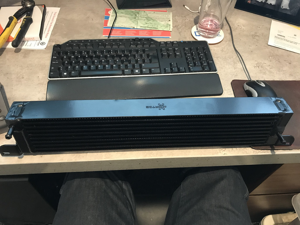

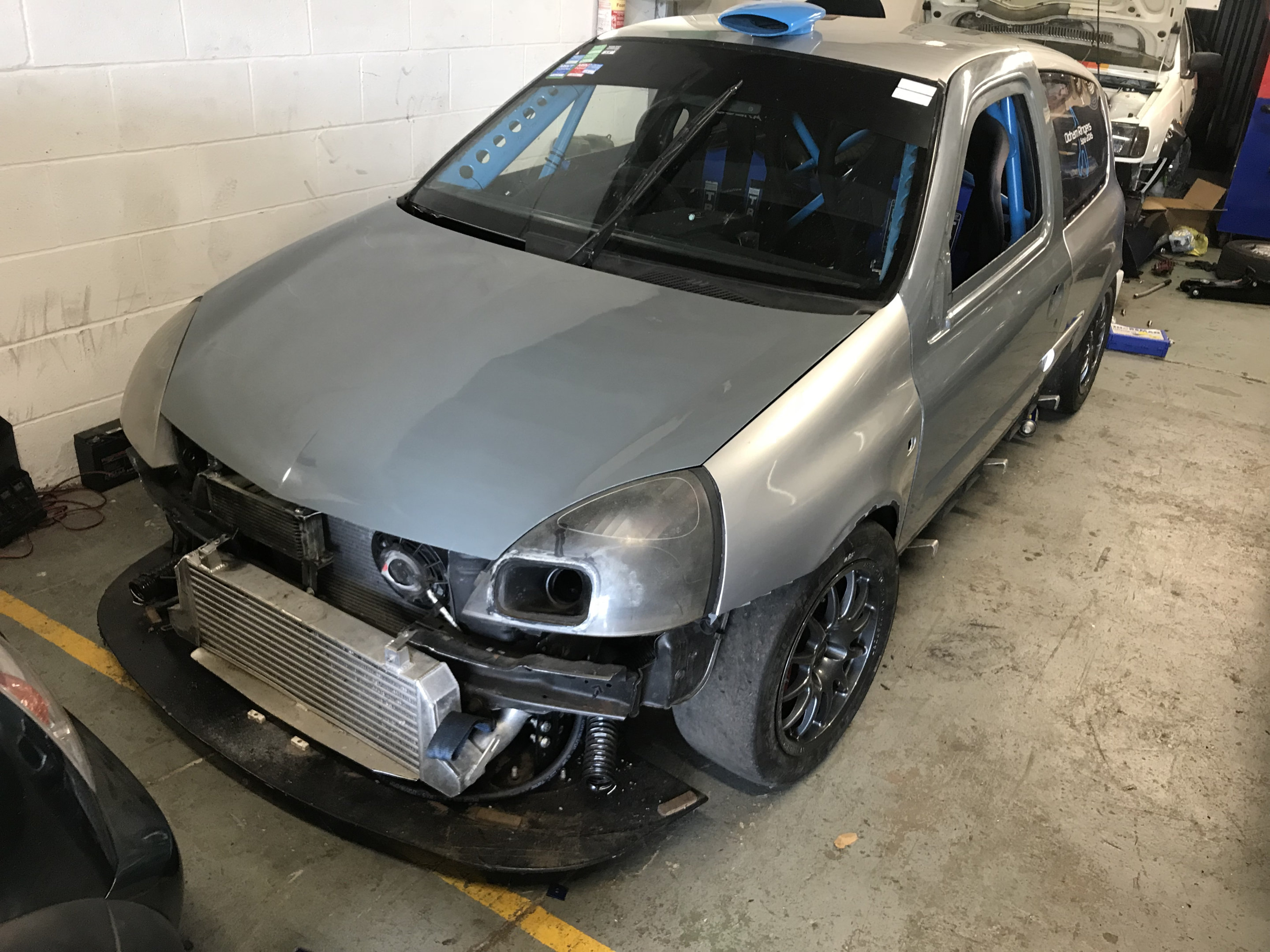

The megane turbo cooler wont fit my car and i am running out of room at the front so after a bit of digging went for an escort cosworth turbo cooler as this seemed to fit the best. Its plumbed directly off the water outlet from the turbo in hope to cool the water at its hottest point. Rad was fitted piped in few more air holes and oulton was booked for a trial. Same old didnt seem to take much in the way of pics for some reason! but pic of cooler and can just make out the brackets on the splitter

Temps were much better, it was a cold day by all means, but i never saw more then 101, it was mainly 99/100 all day so hopefully even in summer this will be fine. plan to add oil temp/oil pressure to the aim dash as the next project. Few pics from oulton in Feb this year. Pics taken by @matt123roll from this site (cheers fella)

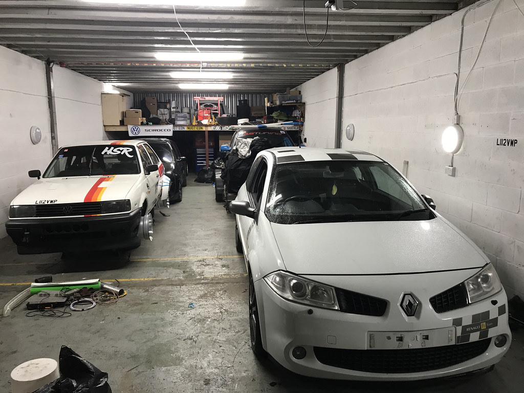

have also done some work in our unit and built a new mez floor to tidy things up a bit!

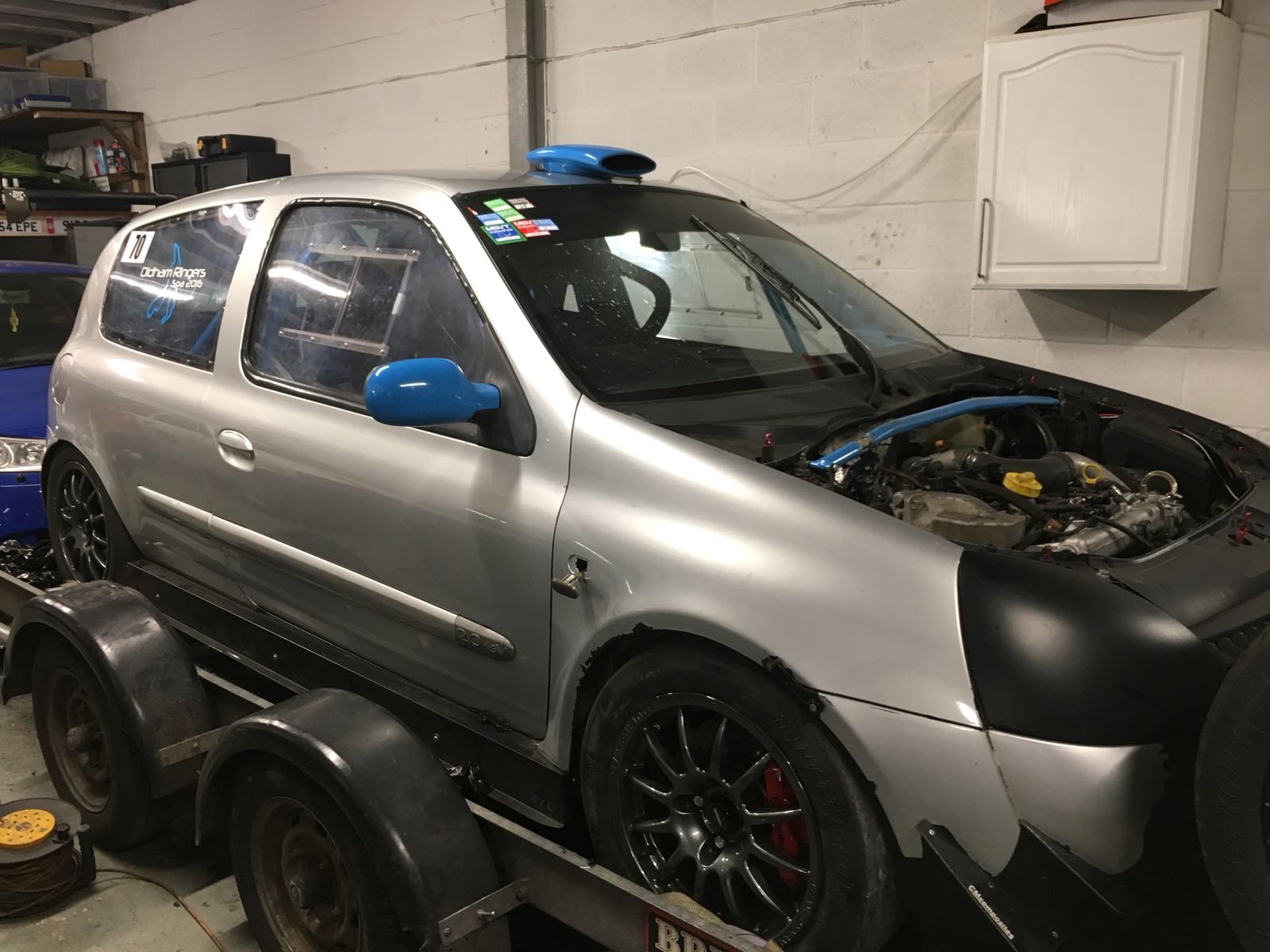

managed to get the car off the trailer for a check over, slicks all look good so they can go again. Coolant was low but hoping this was due to being warm when filled at track so will keep an eye on that. have taken the plunge and the wrap is half gone so no going back now.
looks so different back in silver! new wrap is trying to be located now and hopefully done before angelsey next month. Lap time from last week
decided i have had enough of the bonnet having to keep removing it so going back down the standard route. changed mind at the last minute and went for a fibreglass one but hinged from https://ccf-fibreglass.co.uk/ then kinda ended up going the full hog before the wrap so bonnet, doors and bootlid are on the way. had to get a new bumper as mine had been chopped to death. its being wrapped monday/tuesday next week hopefully doors and bootlid will fit easily enough, so i think its all ready for the wrap.
Added oil pressure/temp senders to the AIM dash (love this!) so now can keep an eye on all the engine and what its up too. was showing 1.6bar pressure at warm idle. has had new oil and filter whilst i was at it and a good check over
