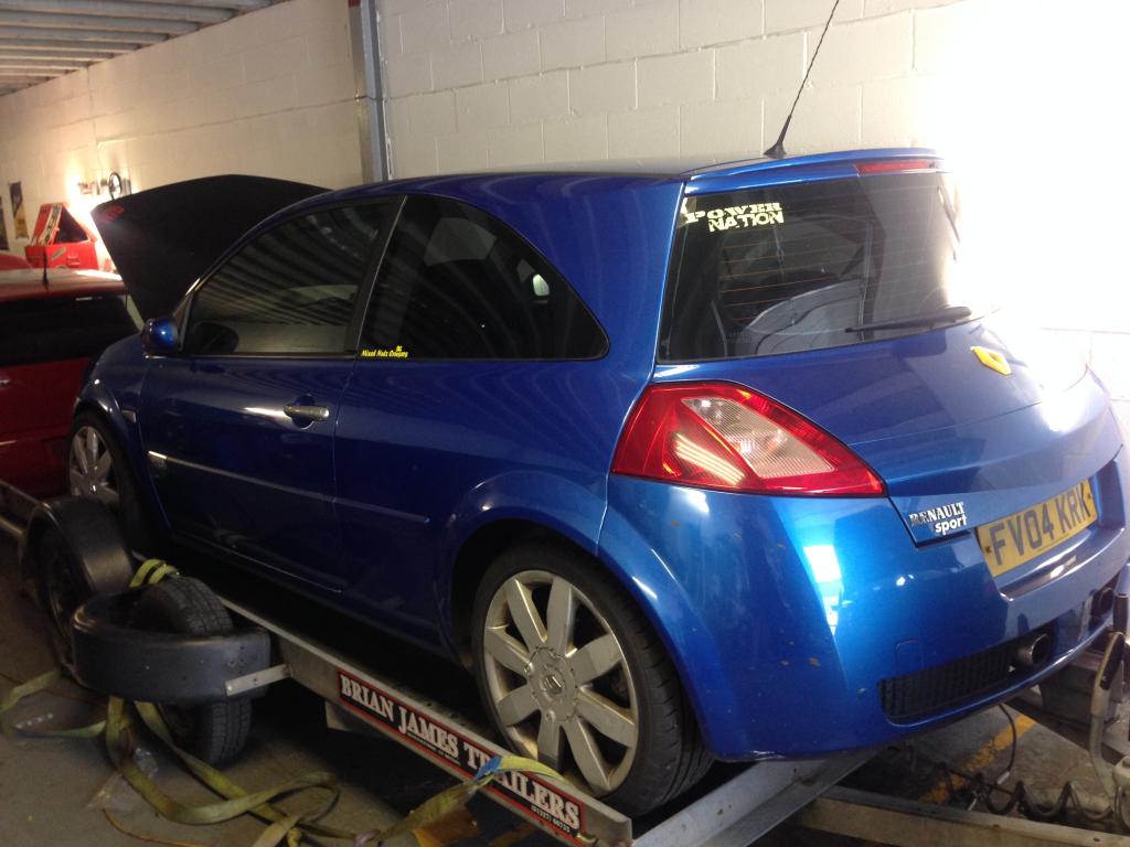

Onwards and upward, basically I came across a full megane 225 car with minimal damage I had never intended on doing the conversion but the car was to cheap to turn away so enter the megane 225 with slight suspension damage and no key!

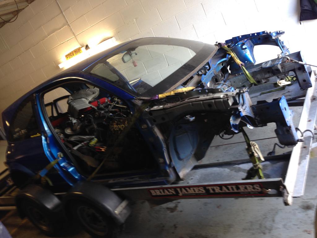

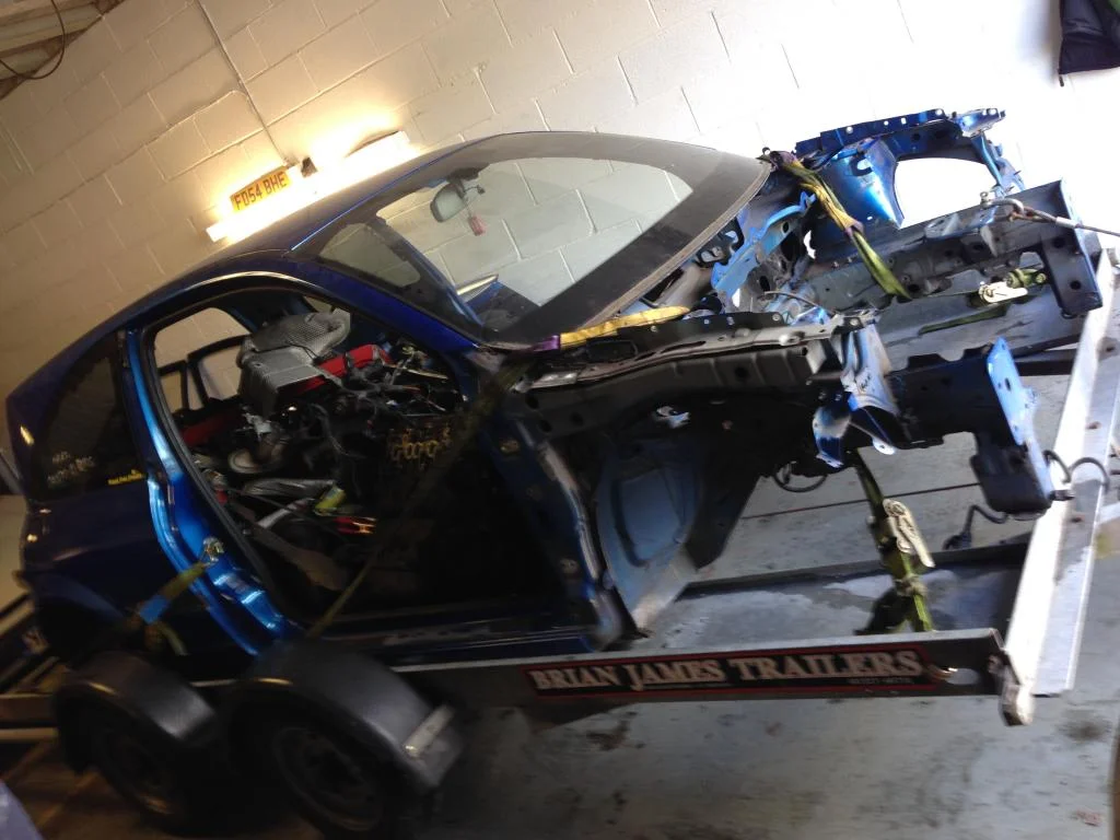

We stripped everything off the car, and either kept it for the conversion or sold it to fund the project.
Off it goes to the scrap yard as a shell
The car in question for the conversion this was September 2014 the very same day we removed the engine and box ready to start the conversion

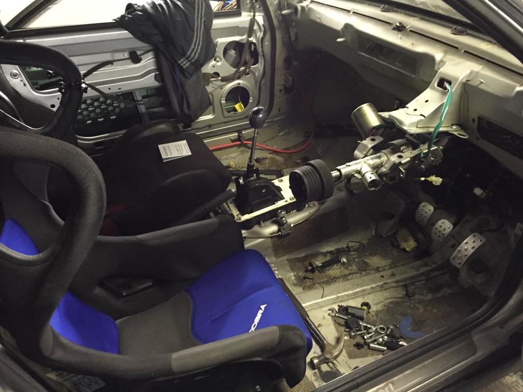

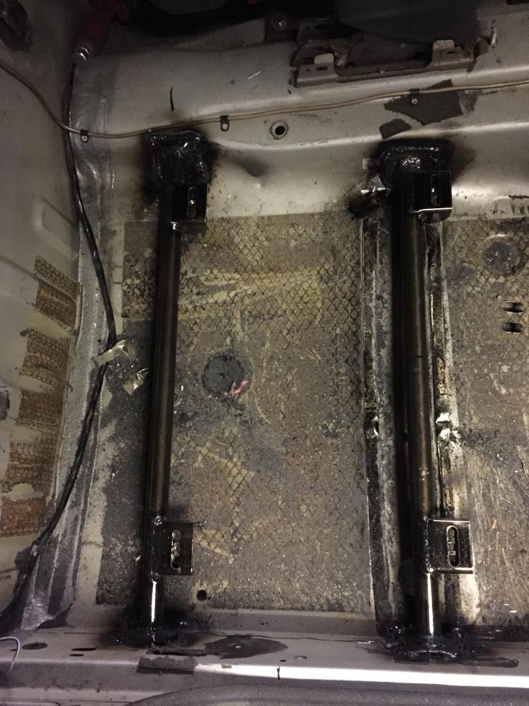

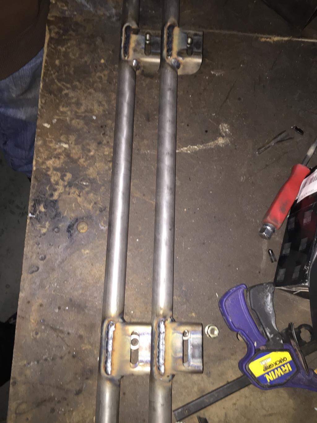

first thing was to fit the seat so so we could mount the steering wheel/pedal where we wanted them. Our resident welder ste has fabricated all this in our unit with a super £150 welder!
you can see the electric steering, custom pedals and the megane shifter mounted on top of the tunnel instead to bring it closer to the steering wheel.

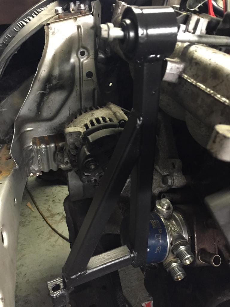

Next was to actually fit the engine and gearbox to see if it actually fits. in short no it doesn't but its not by much, it requires the passenger side chasis leg to be cut and notched to allow clearance for the gearbox. a bit of hammering to the subframe also so nothing fouled. We had to make up 2 engine mounts to go along side 2 of the standard mounts. few quick pics of these.
rear dog bone mount

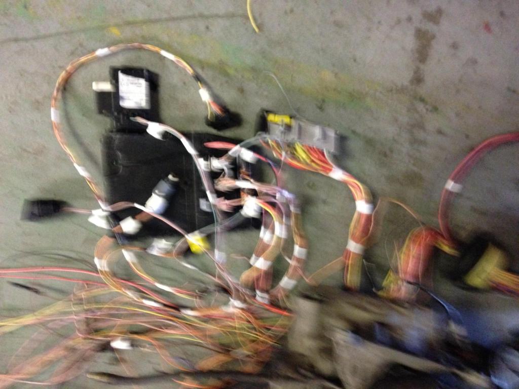

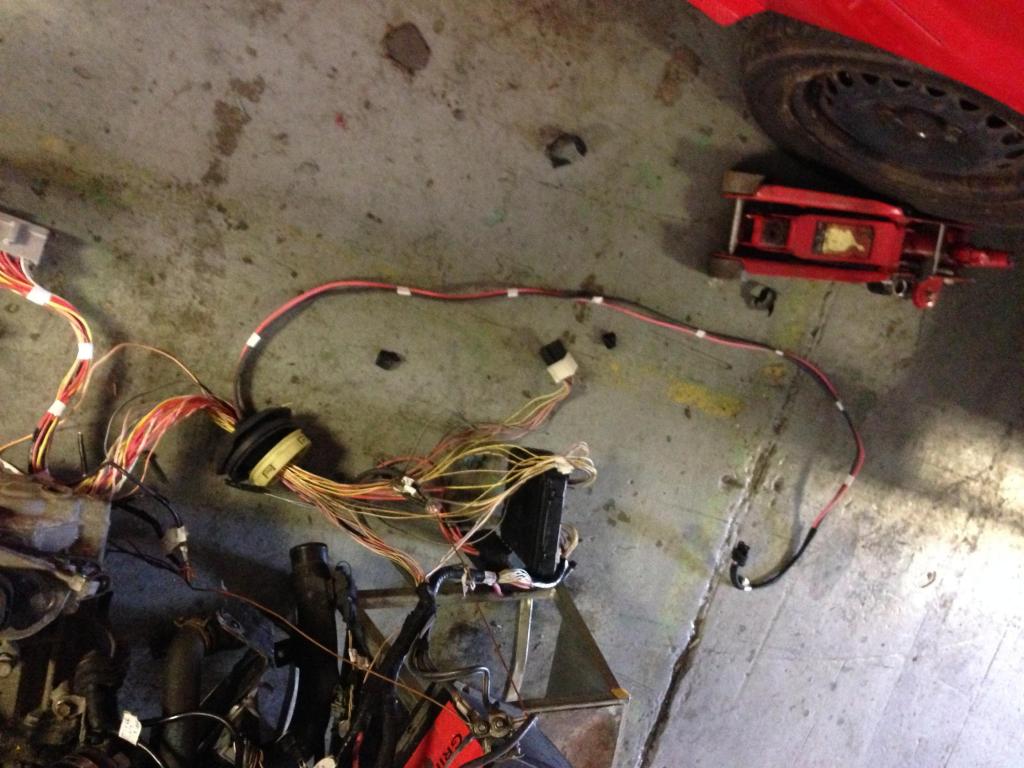

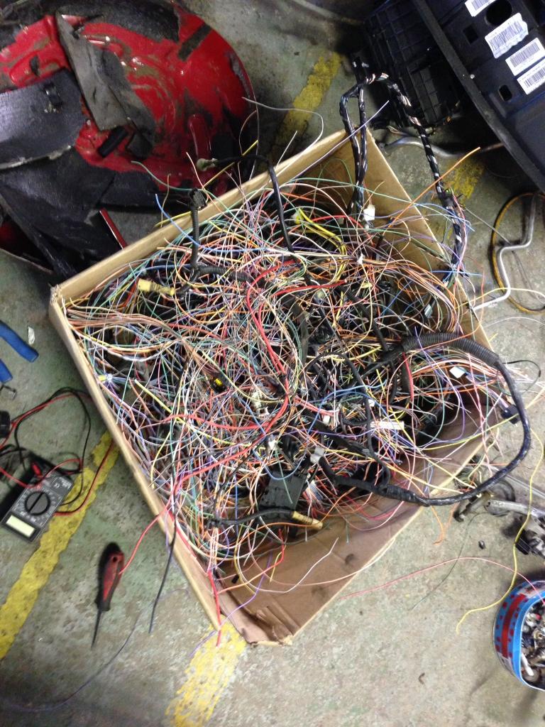

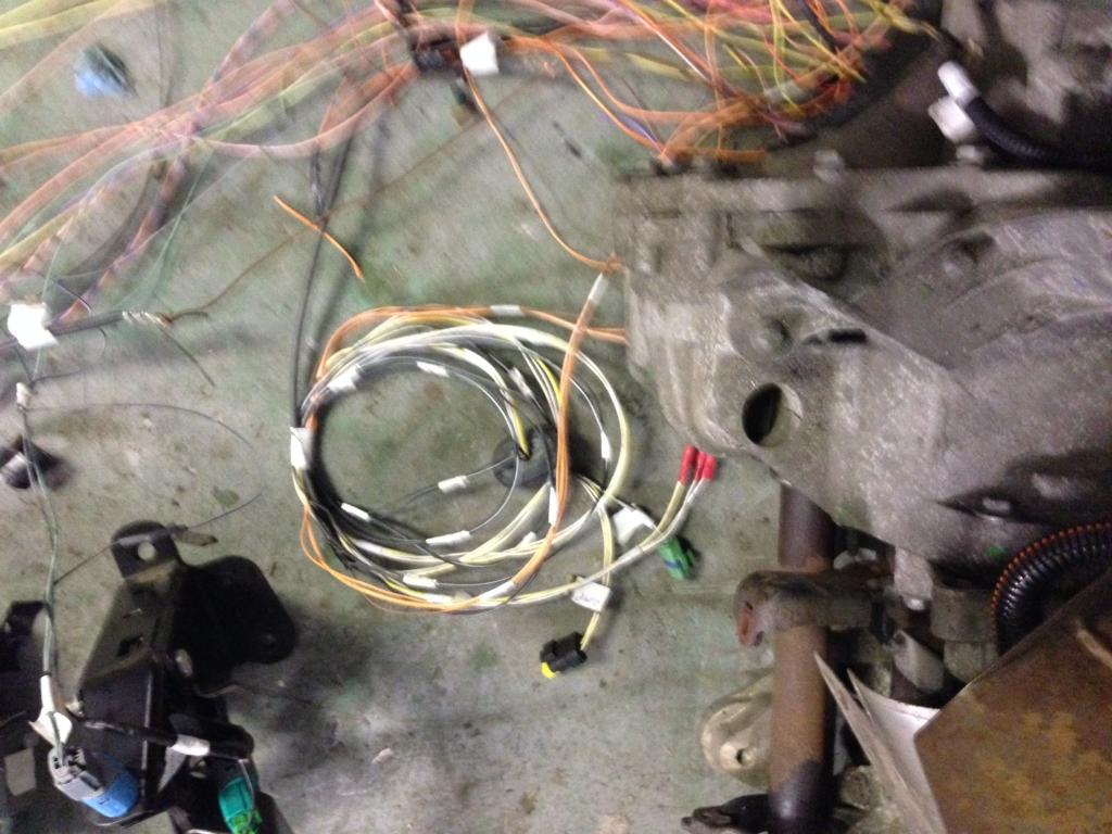

Next step wiring! the plan was to get the engine running on the floor to see if we could bypass the meagane system. after a bit of head scratching we managed this so far so good. did have a vid of this somewhere but will have to dig it out. Next step was to remove all the megane wires that aren't needed. This was by far the worse part as one c**k up here we would never be able to retrace. But again it was managed with a bit of head scratching we managed to remove pretty much 80% of the megane loom with the engine still running.
left over loom

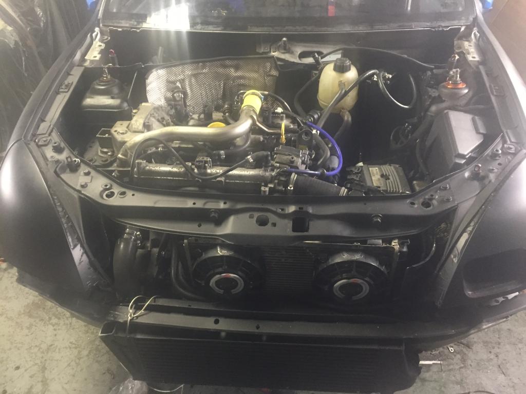

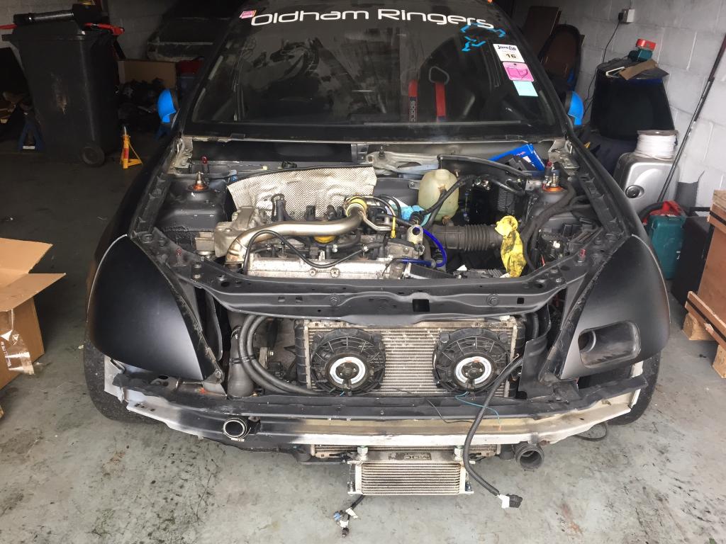

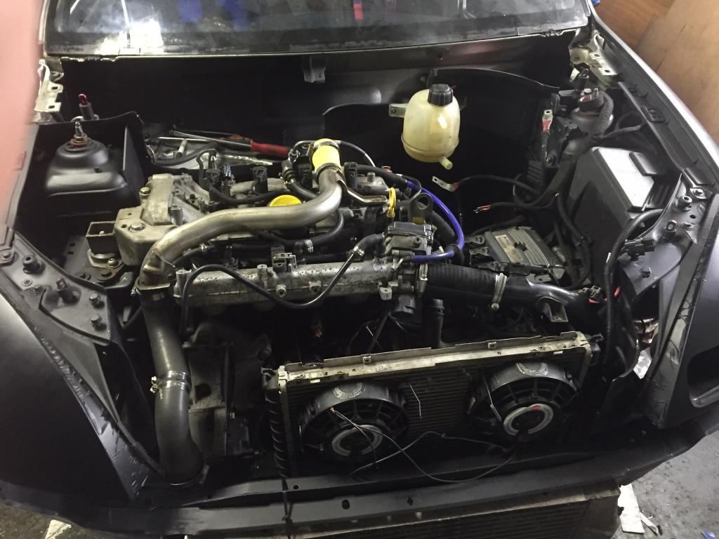

at this point the engine was fully in and mounted level. we started to add the megane ecu and loom and plumb in the boost/water system
trial fitting the megane 225 intercooler and all plumbed in and wired.

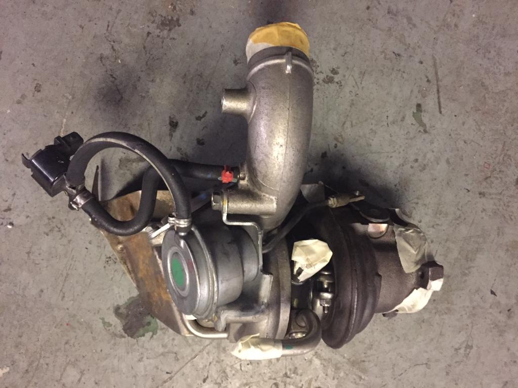

The turbo at this point was found to have allot of play so was sent away to have a brand new core

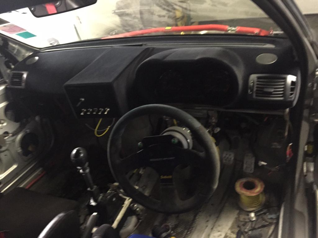

we have then concentrated on the other things. Brake system is all done you can see the remote megane reservoir which has the hydraulic clutch built in just behind the turbo heat shield
I bought a fibreglass switch panel for the dash and had it flocked to house the megane keycard, battery cut off and some switchs.

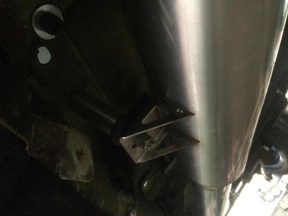

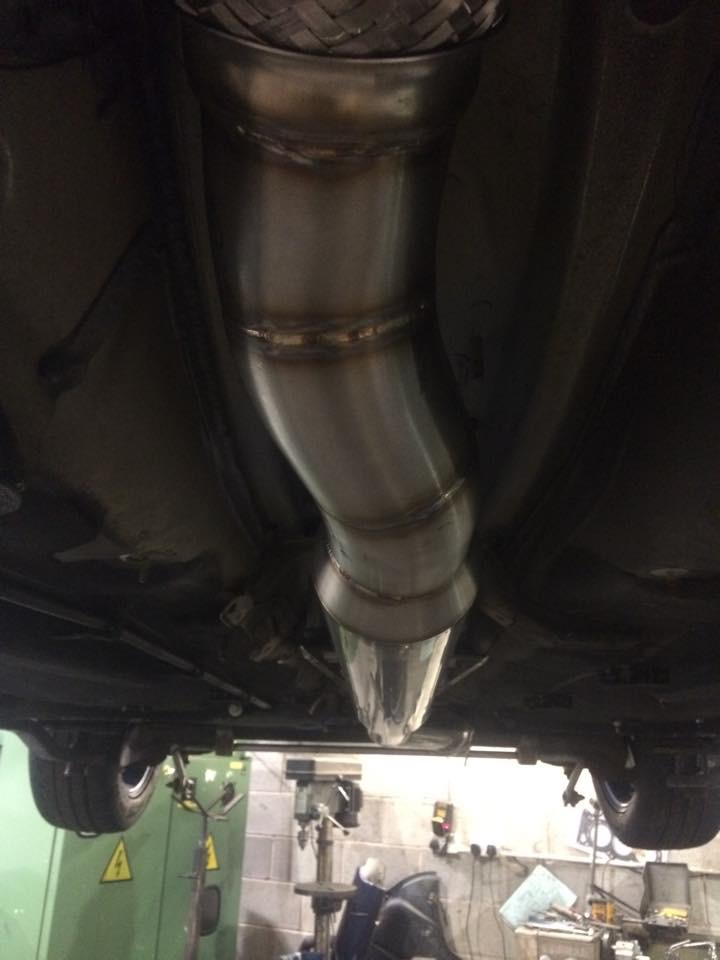

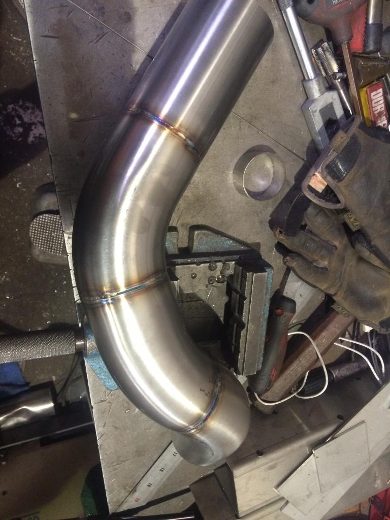

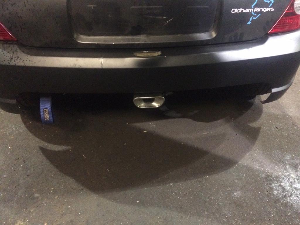

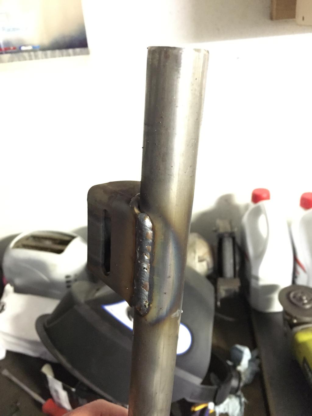

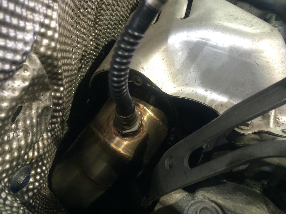

the car is away at the minute with a friend who is fabricating the exhaust, intercooler and custom driveshaft's, but is due back today. Tonight we should be able to start it with the new full 3" turbo back exahaust, driveshaft's aren't quite ready yet so cant actually test drive it just yet.
Few pics of his exhaust work
3" downpipe, apparently this was a pig to fit in!

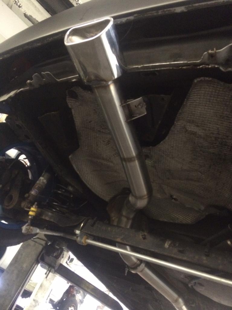

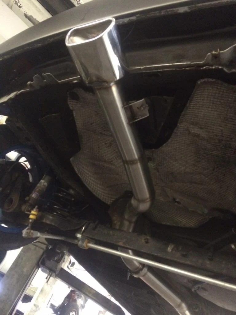

megane 250 tailpipe
very impressed with his exhaust work, if your in the market for a custom exhaust this is your guy!

Have you got any photo's of the chassis rail and gearbox mount? Did the upper drivers mount bolt directly onto the 225 engine too?
windle
  Evo 9 Gt, 182 Toy
Not sure why but no oddly never took any when working on it! It's clear when you do it what needs chopping out though.
Drivers engine mount is a direct fit yes!
  Trophy,R26,GSXR1000
I used both upper engine mounts from a Clio, plus a custom rear mount. Everything was nice and level. Used a bit of heat and a hammer on the chassis rail and didn't touch the sub frame.

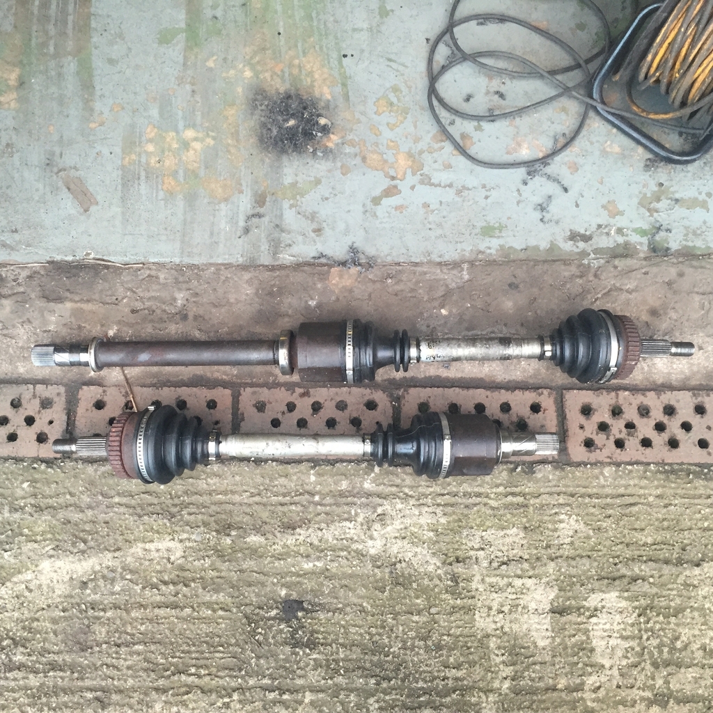

£150 + PP for the shafts with you providing 2 clio and 2 megane shafts
fitted a new CV boot last night and carried on with some more wiring for the indicators and brake lights all working now. Just the hazards to sort out now. We also sprayed up the intercooler

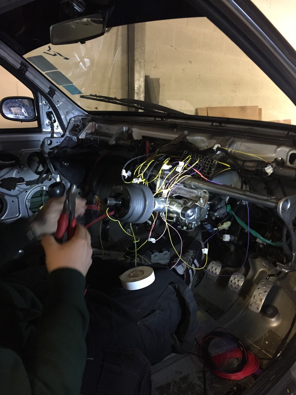

Kurt has finally finished the wiring, custom indicators and hazards that I couldn't do. Just needs a few more wires soldering and job done. Dash is all in now but no pic yet, just a shot of the wires!

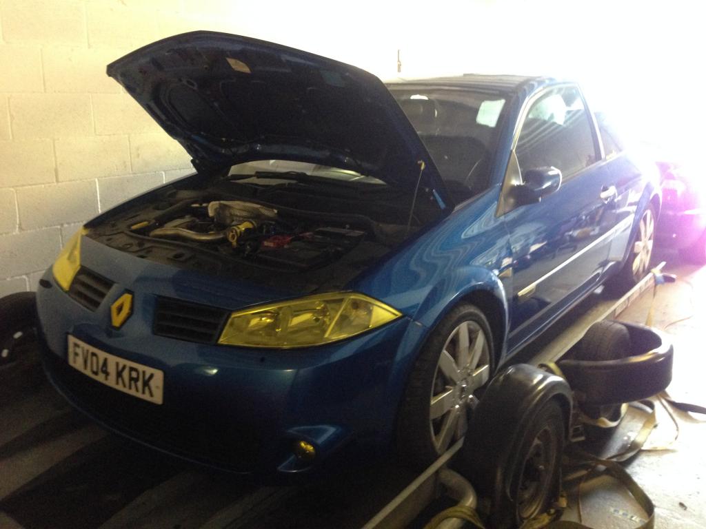

car went to EFI parts on Sunday for a couple of runs. Chris was happy with the fuelling and boost etc which was good to hear. Slightly lean as it came on boost very low down but very safe everywhere else. Made 235BHP and 239Torque so very happy with that on a 100k standard engine.
Bought some tracking gauges and camber gauges to get the car pointing where we want it. looking to book it on its first track outing in may.
couple of vids on the rollers.

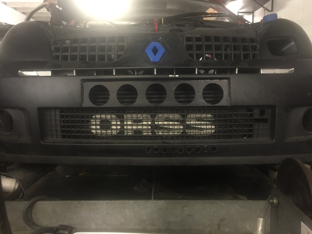

Custom Inlet, Intercooler, Engine mount, 3" Exhaust

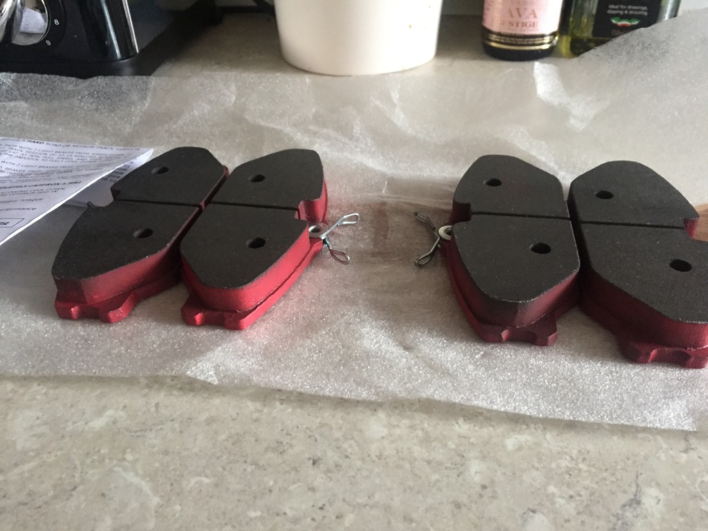

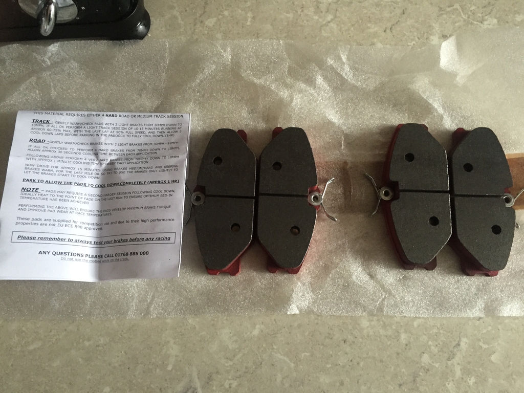

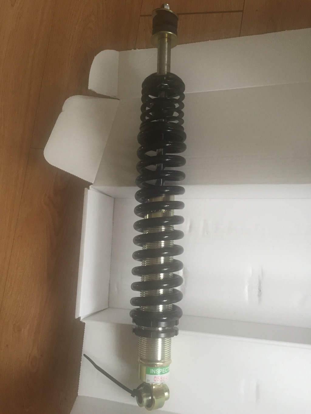

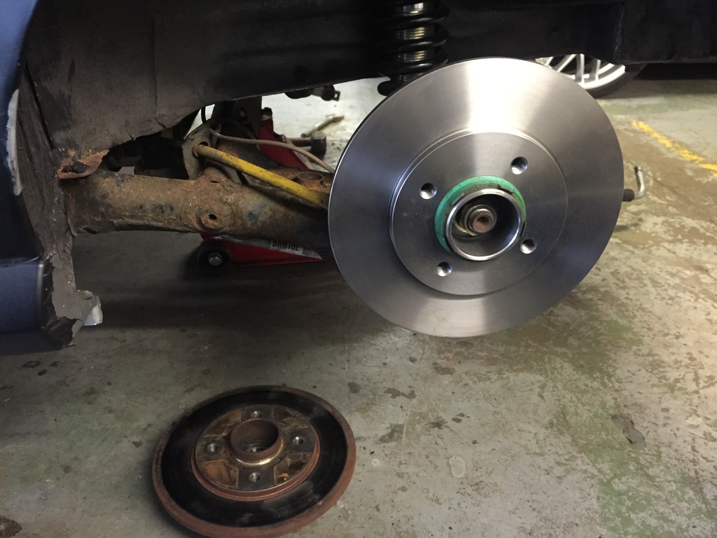

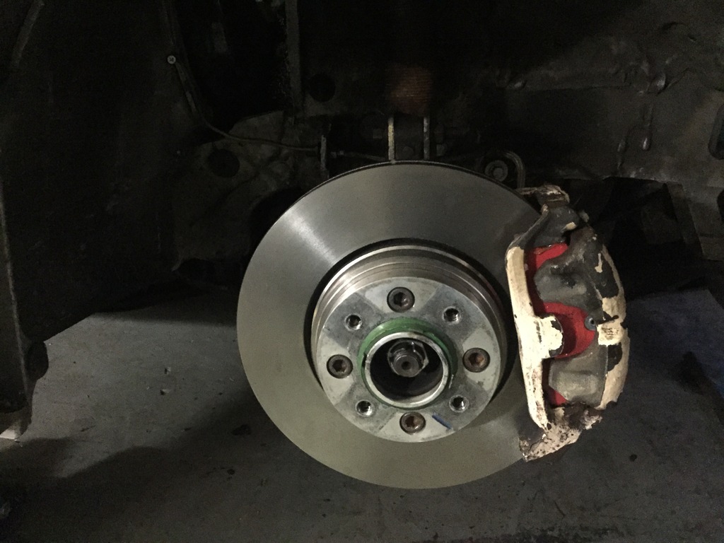

did oulton park a few weeks back and car still behaving as it should, but brakes have been suffering stil.. Work for a few laps then too much heat and start fading away... about half 4 on the day I felt the rear end twitch a bit. jacked it up and the off side rear bearing had some play in so packed up for the day.
I then set out to sort the brakes out, so this week have ordered a new set of brembo rear discs to sort the bearing issue out
Next onto the fronts, I got a set of new brembo HC Discs up front, mine were juddering on the last track day and for the cost of new discs thought I may as well! fitted these and went for an upgrade in Brake Pads. After speaking with Ian he advised with the new power level the old pads were worn and had took a beating and recommended going for the next grade up, so ordered and fitted those.
We are booked on Donington for Bank holiday Monday so shall see how the brakes go then. Will have to brake them in on track sadly as I cant use the car on the road. Will look at some ducting soon also, but these pads to require heat to keep them at their best so we shall see!
