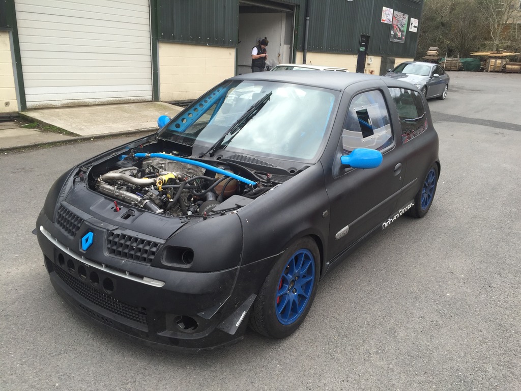

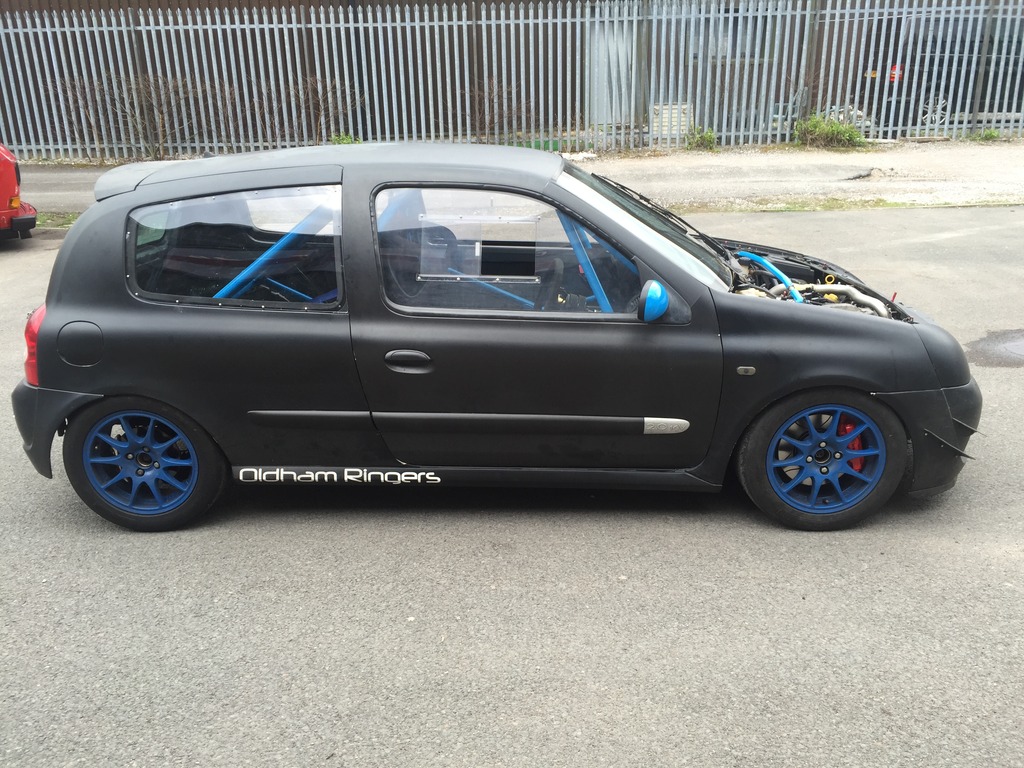

Cars nearly there ready for Saturday at oulton. We are actually going down on the Friday so will be there for the Renault day with the car but its not booked on track on the Friday. will be using a mates R26R on the day

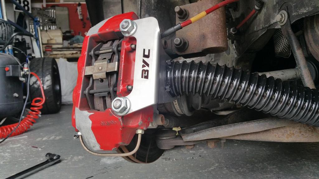

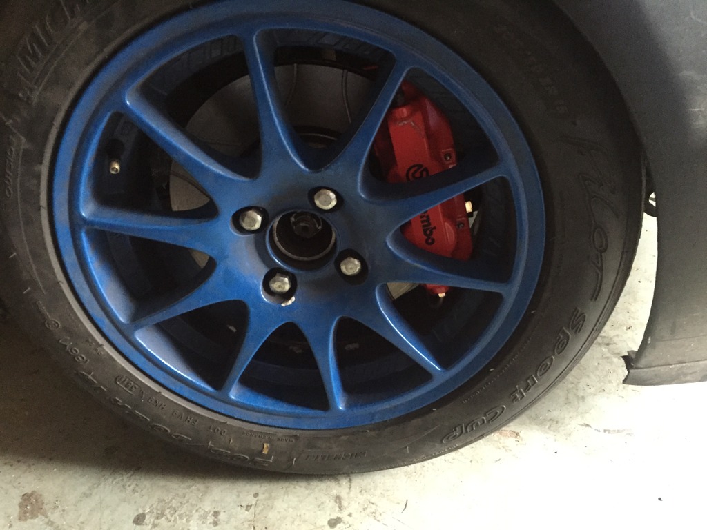

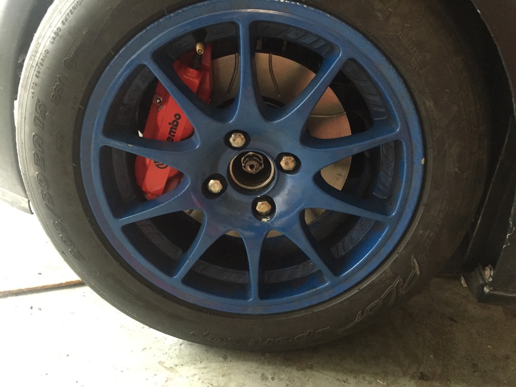

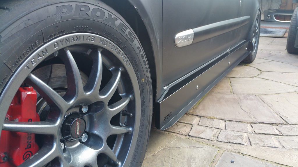

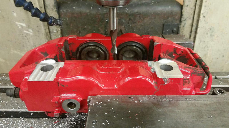

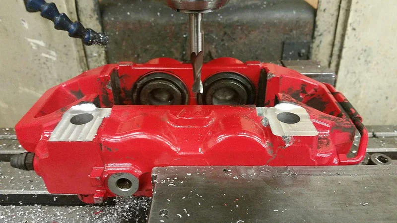

We have fitted the brembo's we have an R26 in for breaking so used the calipers from that. mr H machined the brackets and a touch off the calipers to fit under my wheels, have had to remove the wheel weights and get them redone next week but they just about clear the 15's fitted some new brembo HC max and DS1.11 whilst I was there gearoge at RTRE spot on as usual!

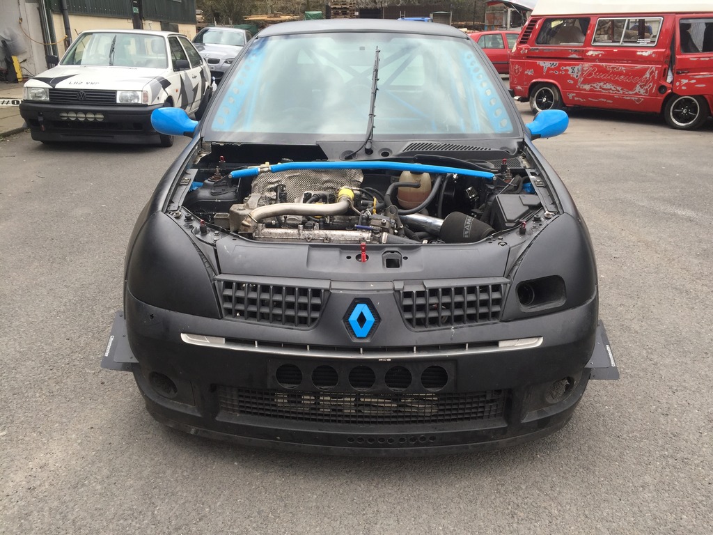

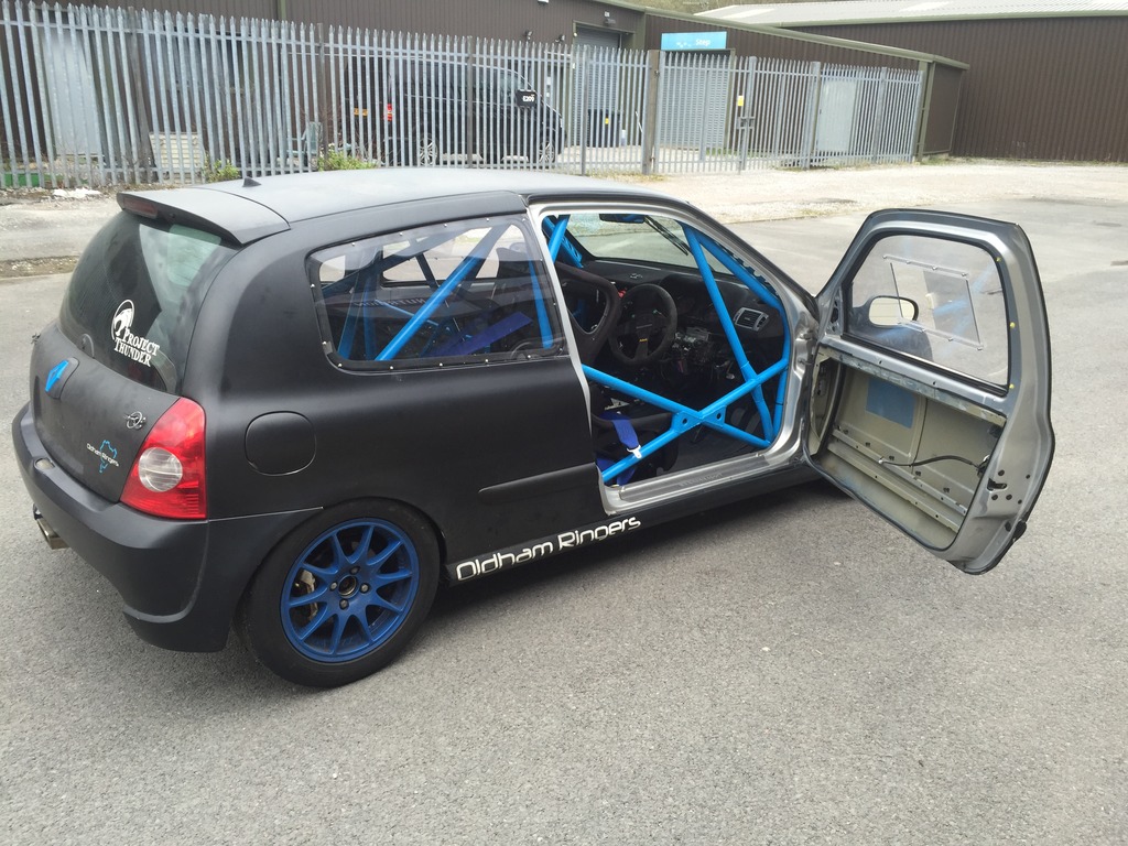

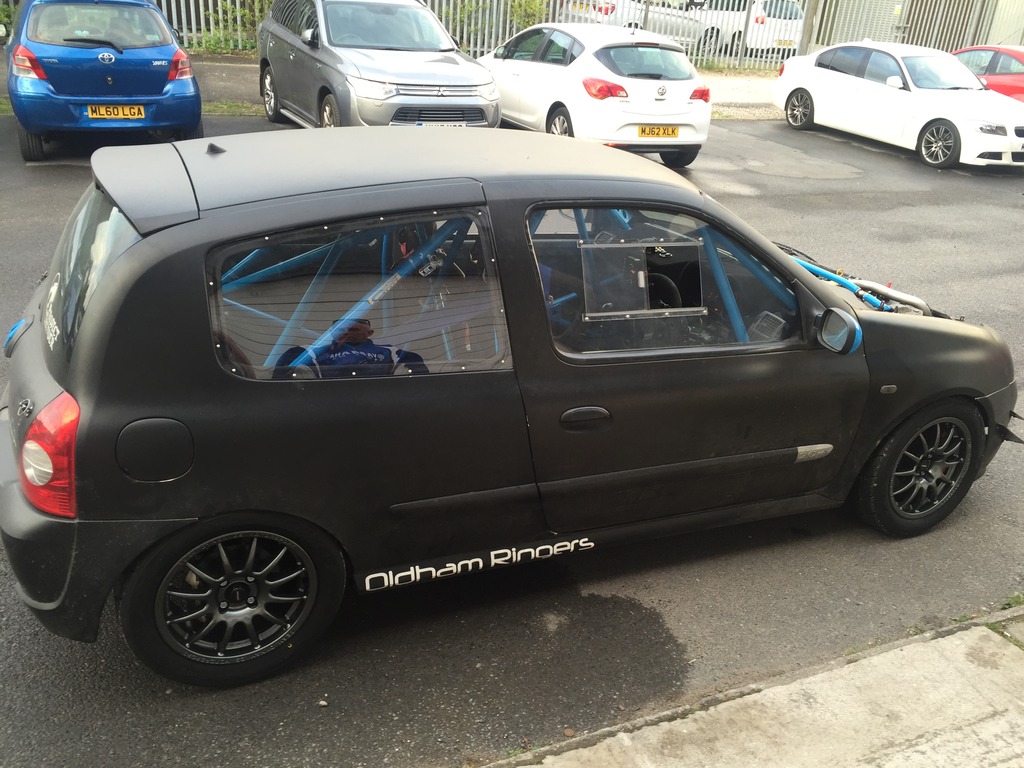

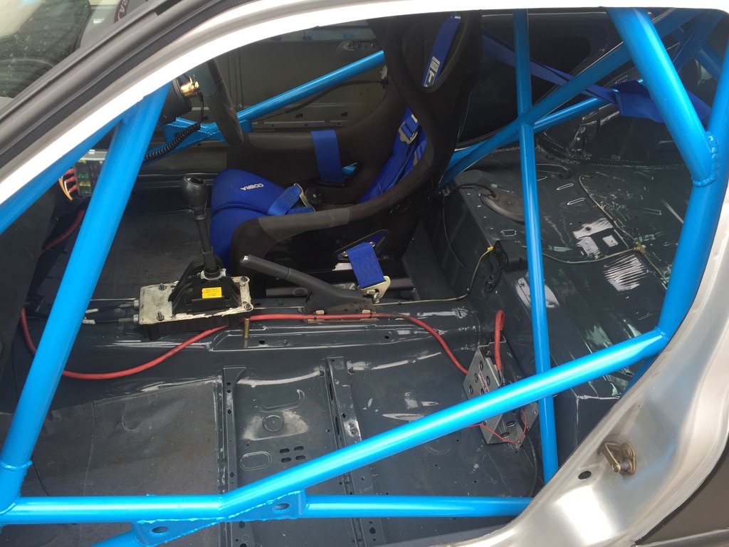

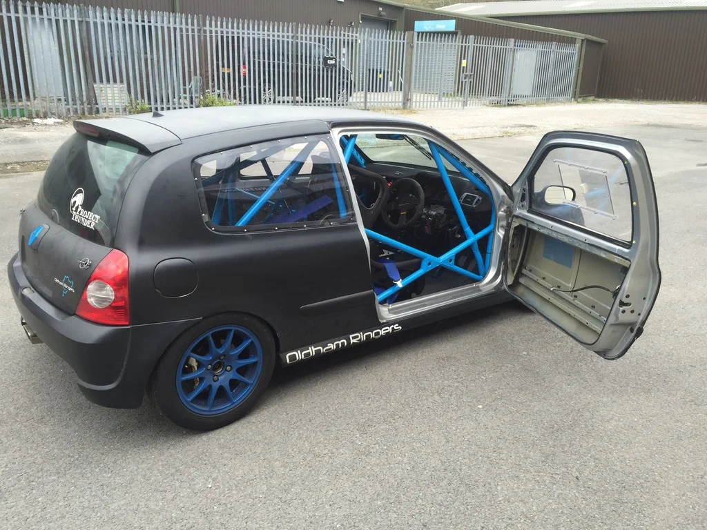

Rear windows fitted, just needs a final check over suspension raised a touch we can then re corner weight it and set the geo and see how it does

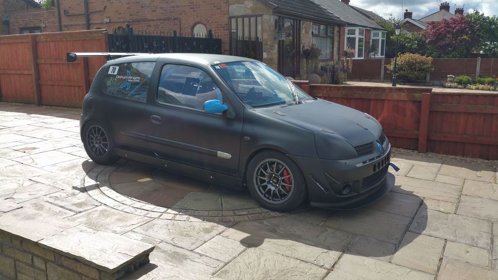

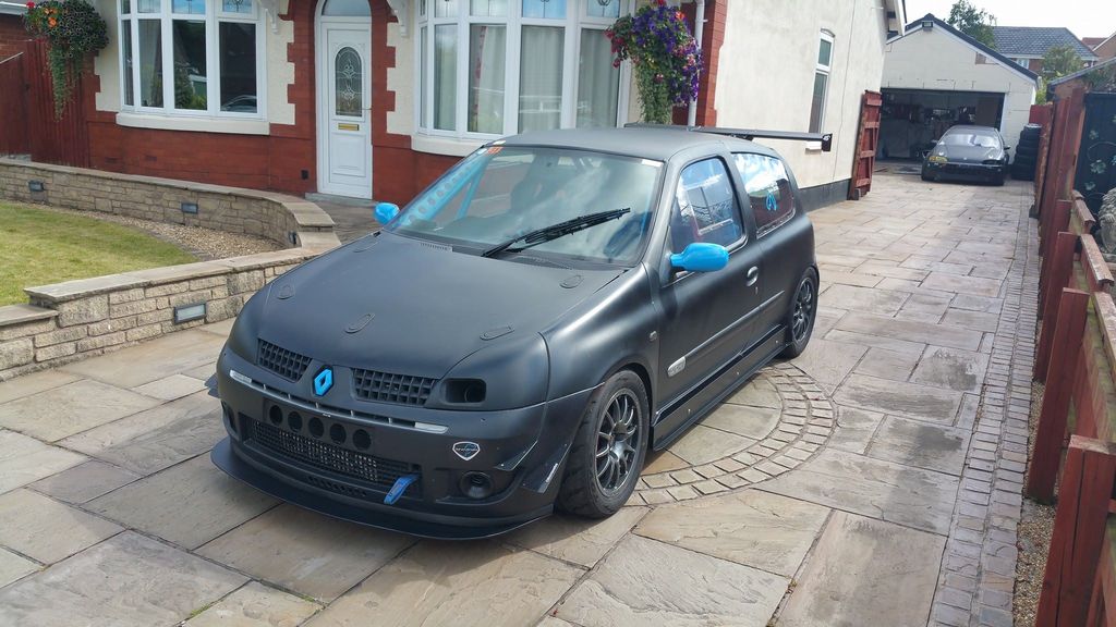

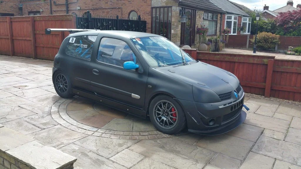

Test drove it around the yard after bleeding the brakes/clutch so far so good but wont know till ive bedded the brakes in on track at the weekend, some outside pics. it now needs a damn good wash

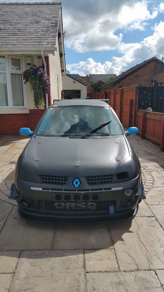

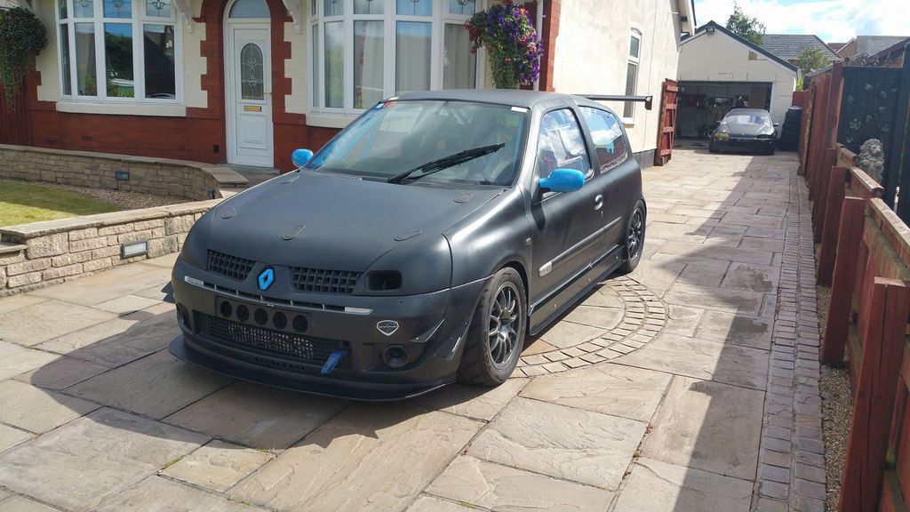

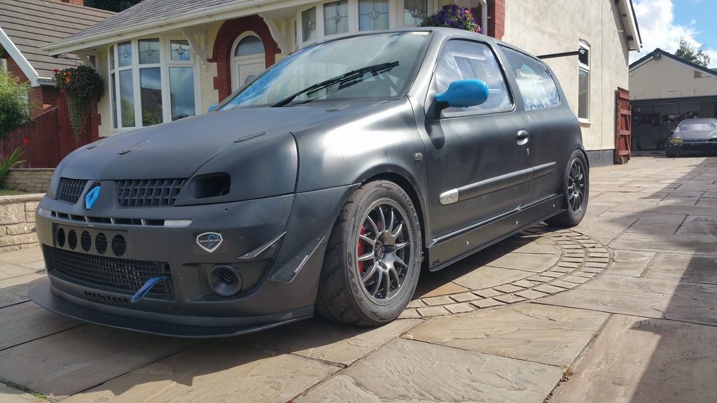

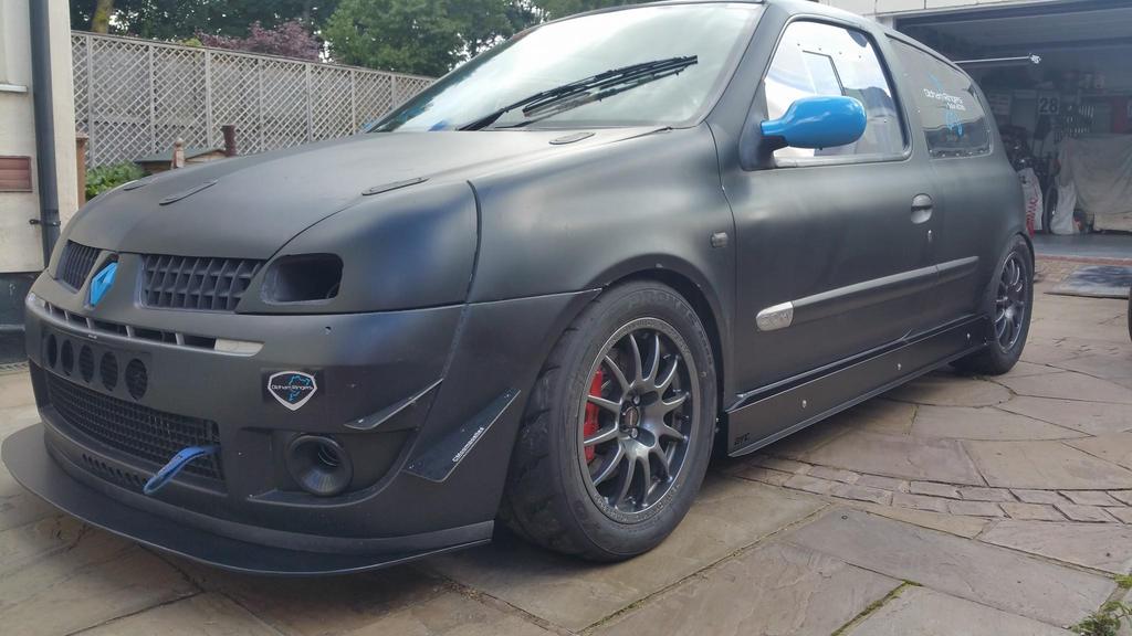

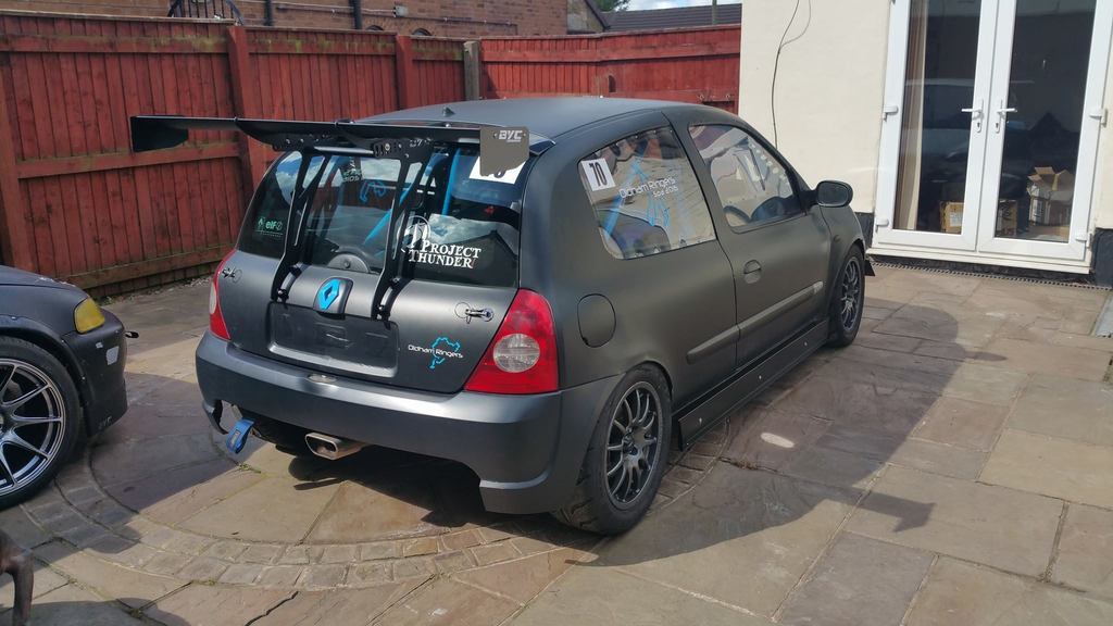

So that's it a pic below on the new wheels different offset front/rear to avoid any spacers. suspension has been raised a touch but may do it a bit more as the rears are quite close to the rear arches.

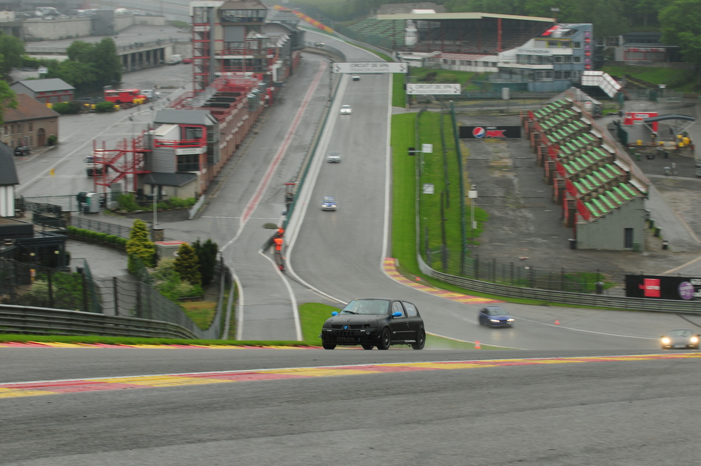

Did Spa last week, what can I say but it should be definitely on your bucket list!
8 cars went 2 were trailering all loaded up meeting a the pub Saturday driving to hull

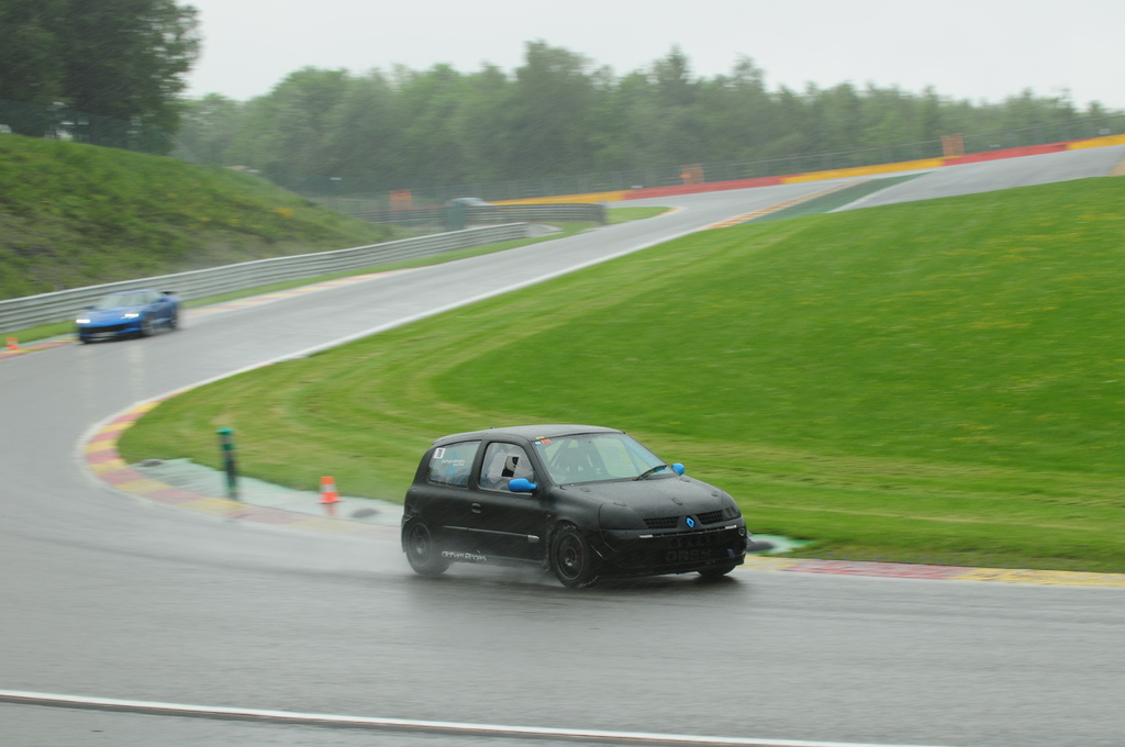

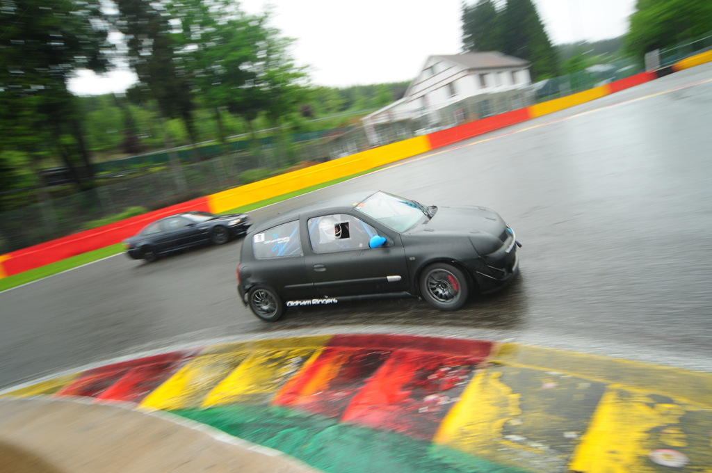

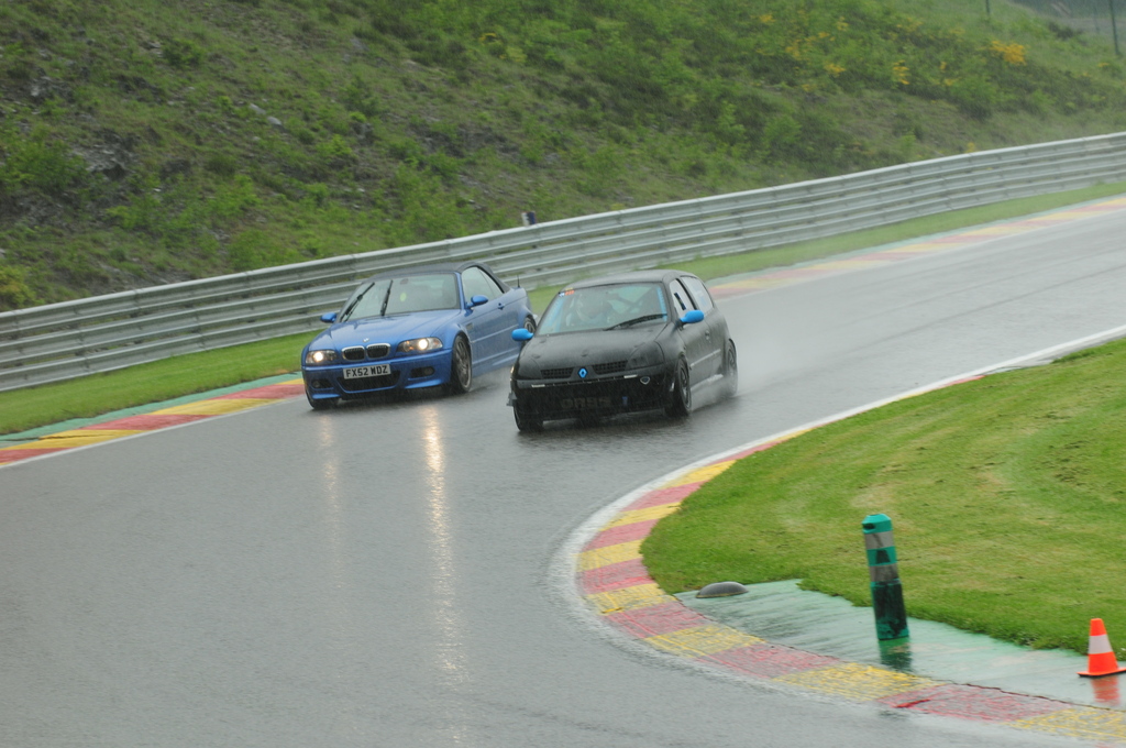

Finally got to track on the Monday and conditions were very bad! heater in the clio was struggling all day to demist the windows so had to keep the laps limited in the sessions, but car seemed to be going well. Luckily had took the wets with us so all good
Clio held its own and passed allot of more expensive cars.

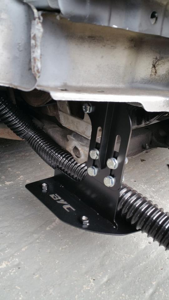

Marks stuff is awesome, he's sorted a few builds out for friends of mine now, looks awesome! (I was the guy commenting about the brake coolers being popular on the byc facebook post).

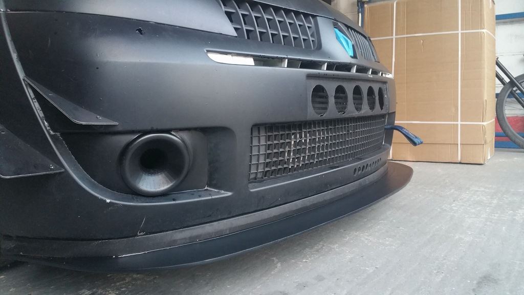

Hi just wondering how the BYC mods felt whilst on track ? As it's something I'm keeping an eye out on there website for. With regards to the front splitter do u know if they only supply the mounts as I can't find any splitters on there site. Or is it something you supplied. Also gutted as I want the brake cooling kit but I'm on wilwoods . Think you car looks an animal. Was on track at Anglesey with you a month or so ago.
windle
  Evo 9 Gt, 182 Toy
Hi mate, mark will be selling the full lot on the website I believe mine was the mock up car so bare with him or drop him a message. We would probably need your car in order to make them for the wilwoods. In terms of handling I definitely pushed more on this day as aliases to a few months ago, the car at the min is set very under steery so not getting the most from the aero. Plan is to go and have it dailied in again at blink Motorsport and try it again. It caused bad torque steer last time but hoping that was down to my bent wheels and old tyres! Think the. Bring the wing into play will make it all work.

Did BYC supply the splitter too? Can't see them on his site, he just list the splitter mounts separately.
windle
  Evo 9 Gt, 182 Toy
BYC supplied everything mate yes, drop mark a line he's a nice fella sure he will point you in the right direction :)

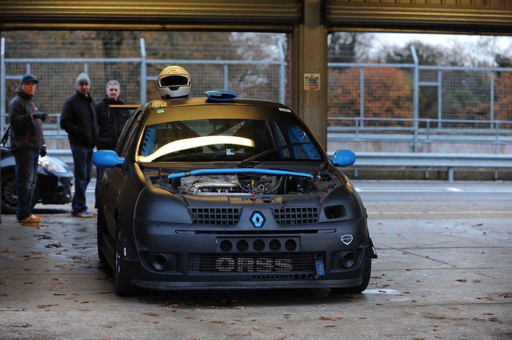

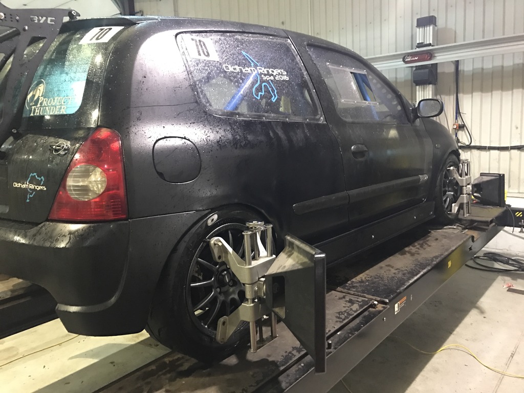

Had the car geo looked at @ track torque racing, top bunch and turns out there had been a bit of an underlying issue for a while in that the rear camber was a country mile out instead of the -2.5 we used to run it was pretty much 0! turns out the camber shims had been fitted the last time the wrong way round, can only blame me rushing the last time. but anyway that's now the correct way back to -2.5 front camber was spot on down to -2.49 on both sides, quick tweak on the toe and she was good to go.
Did oulton park a few times once in November (with the wrong rear camber) and once in Feb this year with the correct camber and it made a huge difference. I finally felt I could push the car and it felt planted. only managed 2 sessions without passengers on the day but was lapping 2.01 and I am confident it would have gone under 2 if I had a bit more traffic free laps and no passengers so happy with that.
its the most cars our group has had out on one track day
Exhaust snapped in November ending the day a little earlier but only a session or too so wasn't too bad. @orry has welded it back up, we re addressed the mount in the middle so hopefully that wont happen again. Whilst at track torque it was apparent my rear beam bushes had lots and lots of play. these have always been stock so bought so black series bushes and a pure motorsport rear beam strengthening kit which mr @orry welded up and we got it all fitted. rear geo has been checked on our gauges and were close enough but next step is shimming the rear to get it straight.
