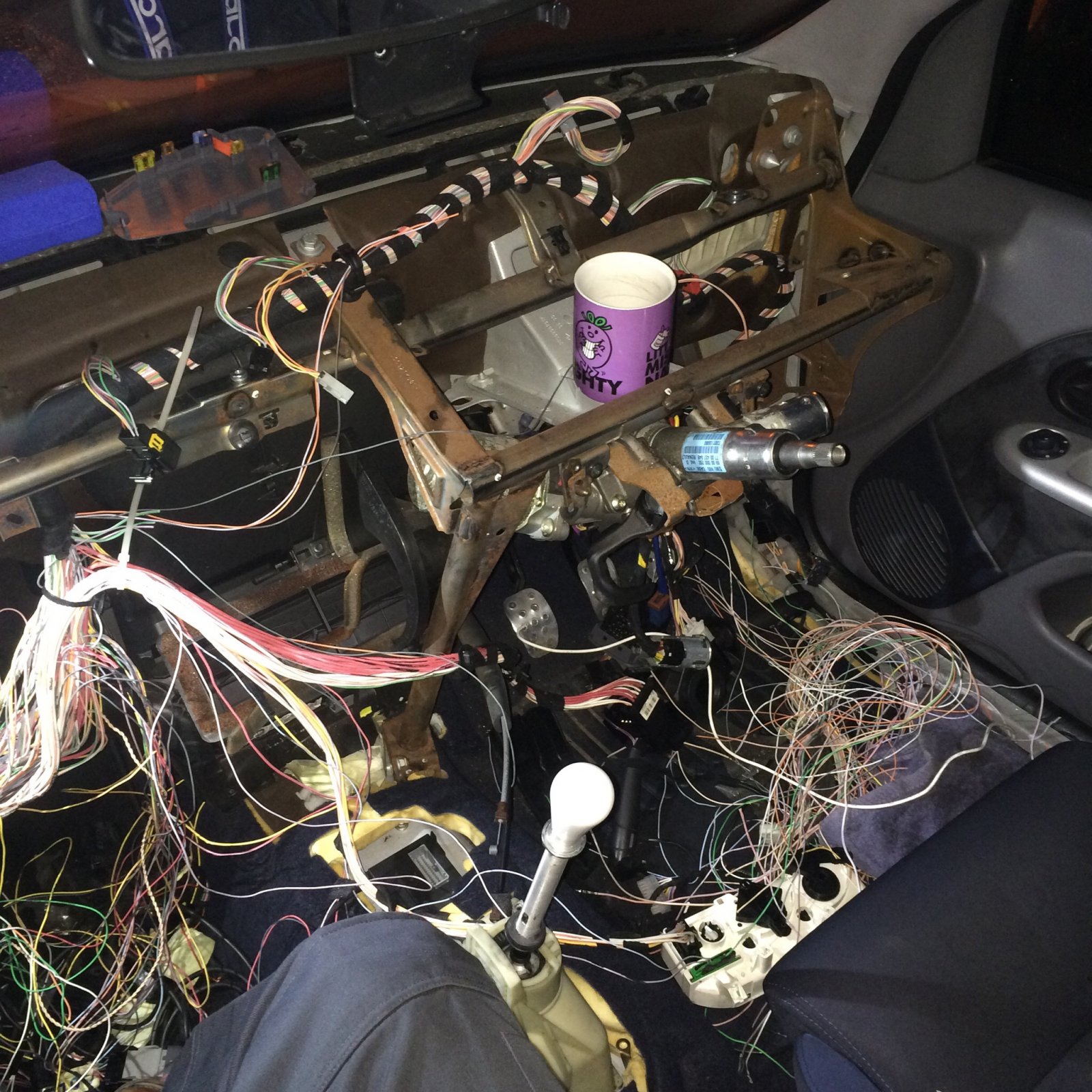

I'm currently stripping back the wiring loom on a PH1 track/race car. Looking to remove as many spare plugs/wires as I can
Can I simply just cut all the wires to the AIrbag ECU or will this cause an issue?

Did you cut the wires? I want to cut them then trace them back an remove completely. Did it cause any issues?
I also want to remove all heater an stereo wiring as these are deleted aswel

Yes completely removed it all except heating . no issues at all as no airbag ecu = no warning on dash .
Oh but I did remove the air con wiring all if it . Just left the fan speed wiring
Excellent, time to get chop happy then. Already got the loom tape all stripped off and everything traced back
Thanks for the replies @barnesautos
Tackling the engine bay loom next weekend
