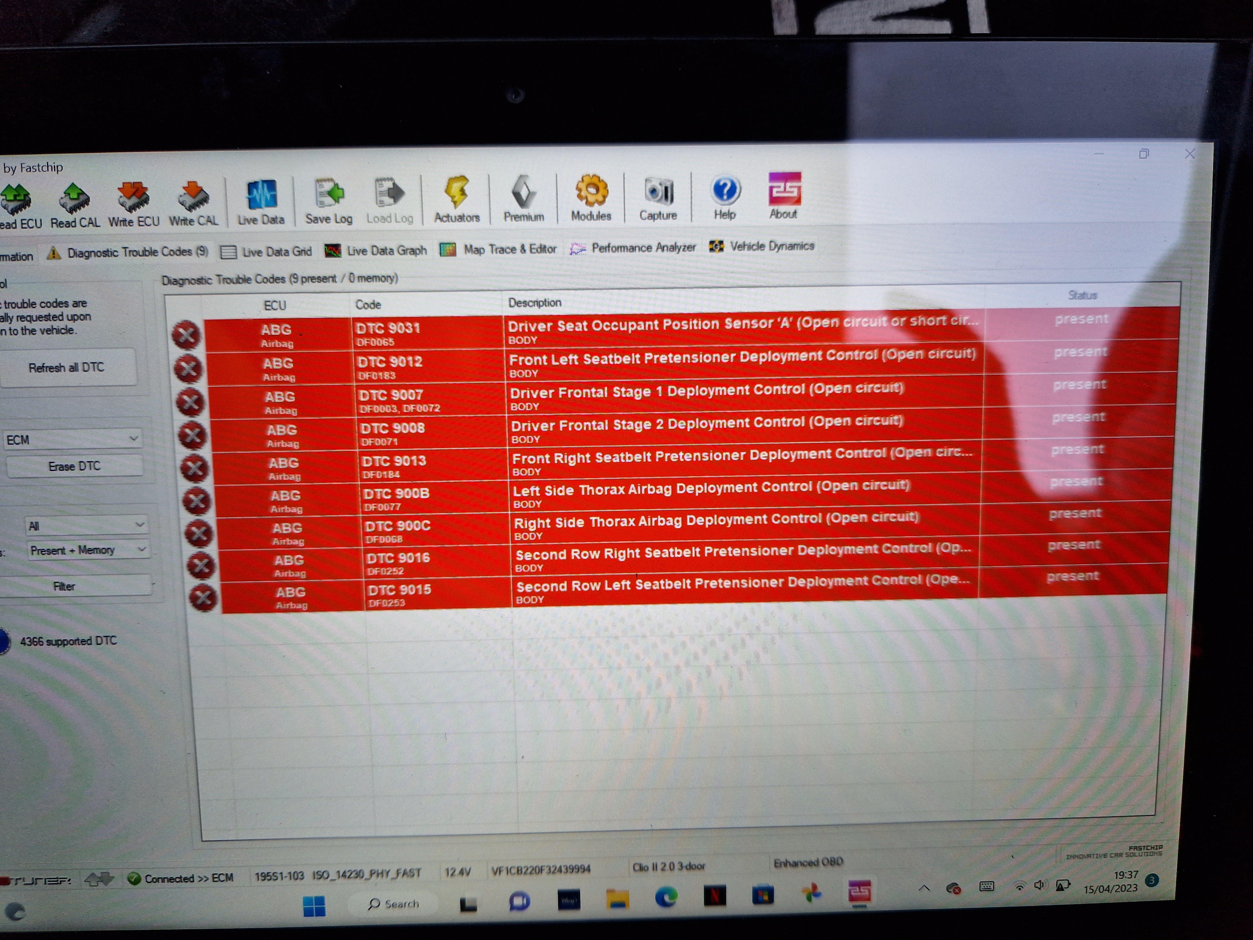

Right then, recently I bought an RS tuner with airbag module. I was able to turn off all the airbag lights/sensors but when I went over bumps/turned the wheel the light would come back on. Over another bump and off and repeat.
I plugged in the RS tuner whilst the light was on and had this;

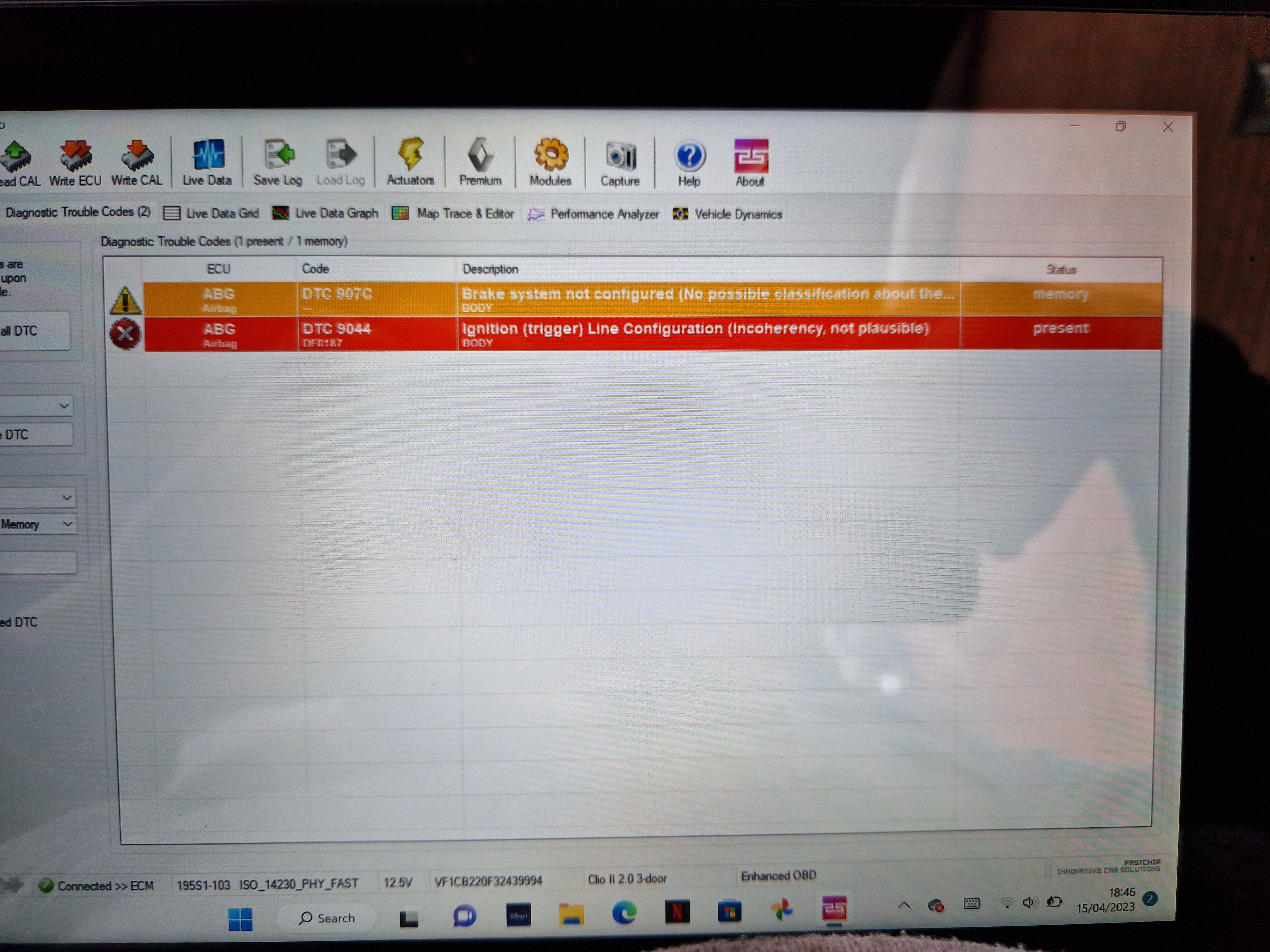

Interestingly when I enable all airbags the "ignition trigger" isn't there:

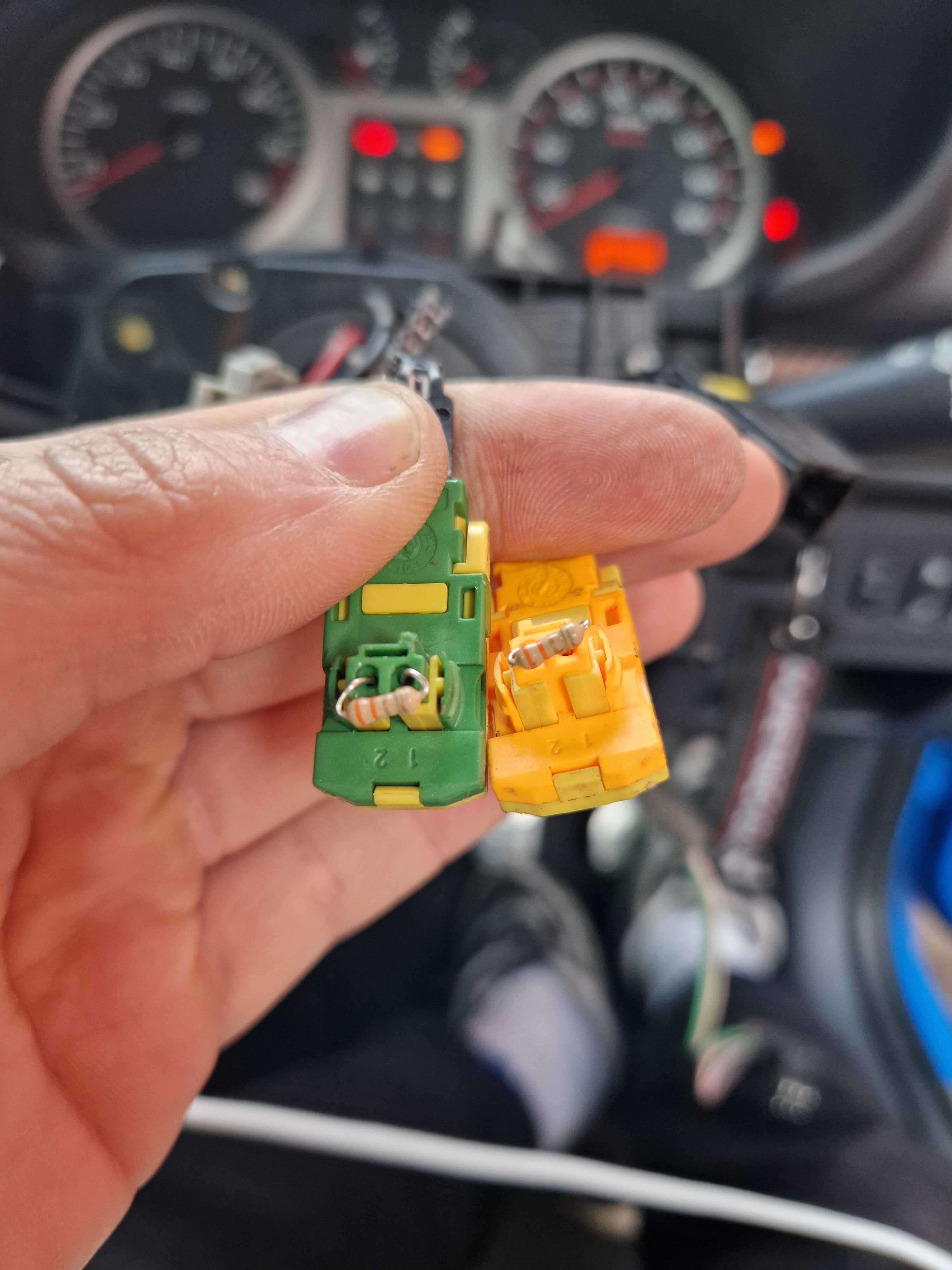

Steering wheel has resistors in these plugs.
They are usually taped up.
