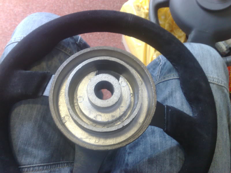

Where did you pick your boss up from and do you have a part number??? I have a momo boss from rallynuts and it doesnt seem to fit correctly :(
Il show piucs... The whole thing.. Well it fits but to turn the wheel it its god awfully tight and makes some rather rum noises :(
Grrrr
Standard renault fitting...
This so called MOMO boss for clios 2001 onwards...
I got my Boss from here:http://www.momo88.com/ for about £50 but it took 3 weeks to arrive so I wouldn't recommend them if you want it quick. I think that K-Tec stock them and their delivery is always quite speedy.
To check if yours is a Momo boss it should have 'Momo' stamped on the front where you but the bolts through to attach the steering wheel. Part no for airbag Clio boss 2001 on is 7218 and for non airbag it is 7217. Seems that the part no's are just the last 4 digits of the long numbers on Momo products - hope that helps.

Yeah the numpties at rallynuts list 7217 as 2001 Clio onwards with airbag! I'm not happy as I ordered an OMP one RE114 or something and that's the correct one
