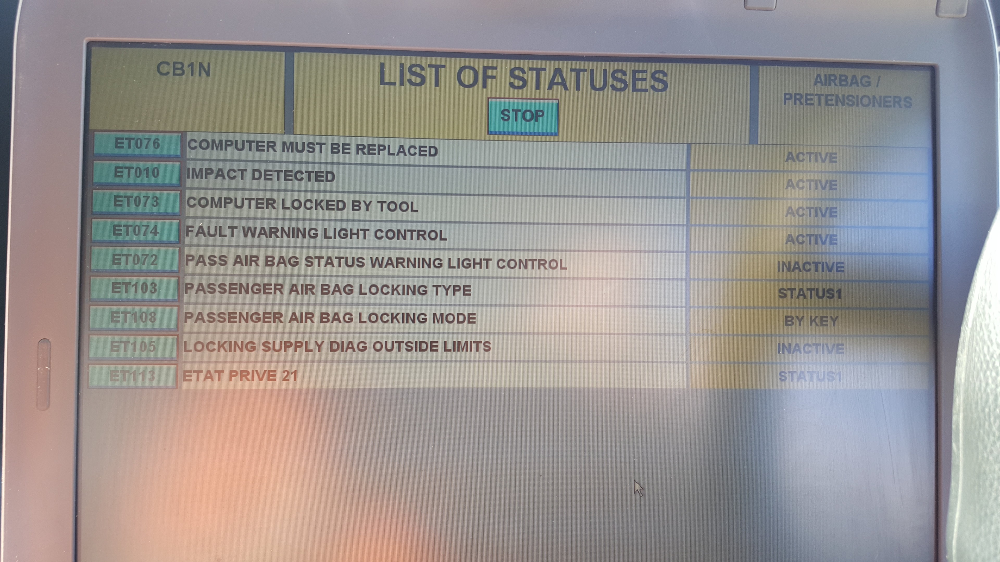

I have a similar problem, slight impact and airbag ecu is now showing as locked. I’ve taken it out and it’s been to a specialist ecu testers and they are unable to reset it. Can I just source a second hand airbag ecu plug it in and job done? My current airbag ecu has a part number of 8200277316 and I’m struggling to find one with the same part number on eBay and the likes. I can find parts that are listed to fit my car (172 Cup) but different part numbers.

If you get a second hand one you just need the configuration programmed to match the airbags your car has installed. You’d be quite lucky to get one which perfectly matched unless you get one which has come from the exact same model I can do it for £20 if you want, drop me a PM or email cars@trackityt.com
