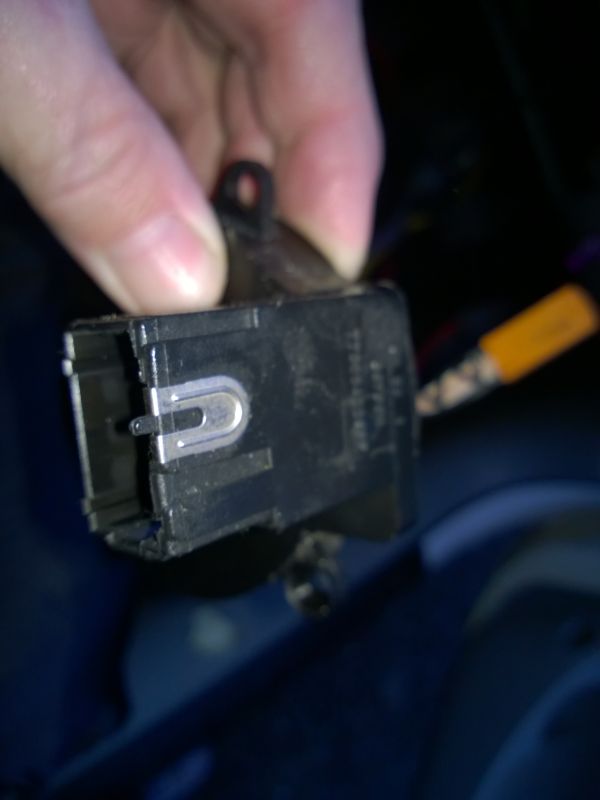

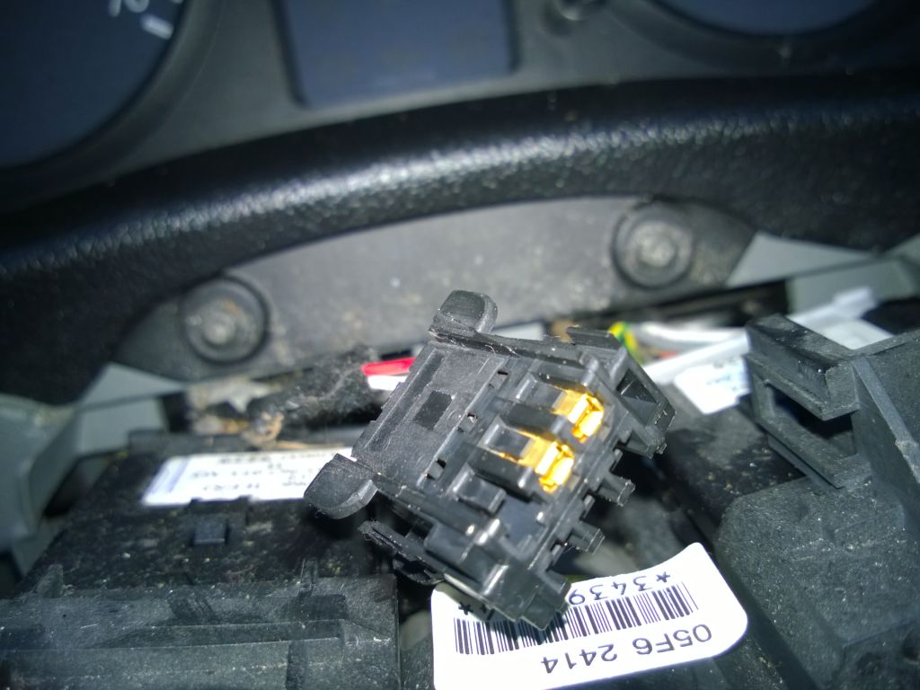

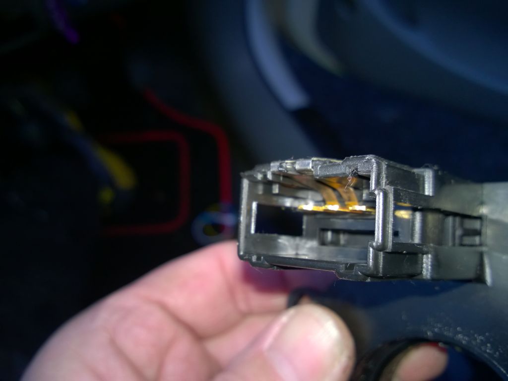

the kangoo van air bag attaches via a swivel mechanism allowing for steering wheel rotation . this has 2 pin connection but the plug seems to have a little metal clip that bridges the pins inside the connection ??
am i correct in assuming that when the 2 halves of the plug are pressed together the the spring clip is shoved out of the way breaking the contact across the pins ???

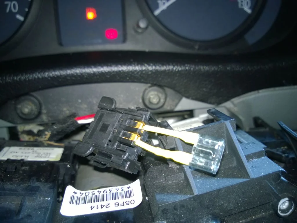

and all i have to do is bridge the feed wires on the van loom ,,red and white "in the pictures " with my resistor to fool the warning light ?
i got board and just decided to give it a go ,, so fitted the resistor were i thought it would go and guess what ! no warning light :) so if your doing a kangoo van and fancy a steering wheel change then YEP its possible because i just did it.... 3.6 ohm resistor with 2 amp fuse and if anyone is interested i will upload the pics of the modified boss
