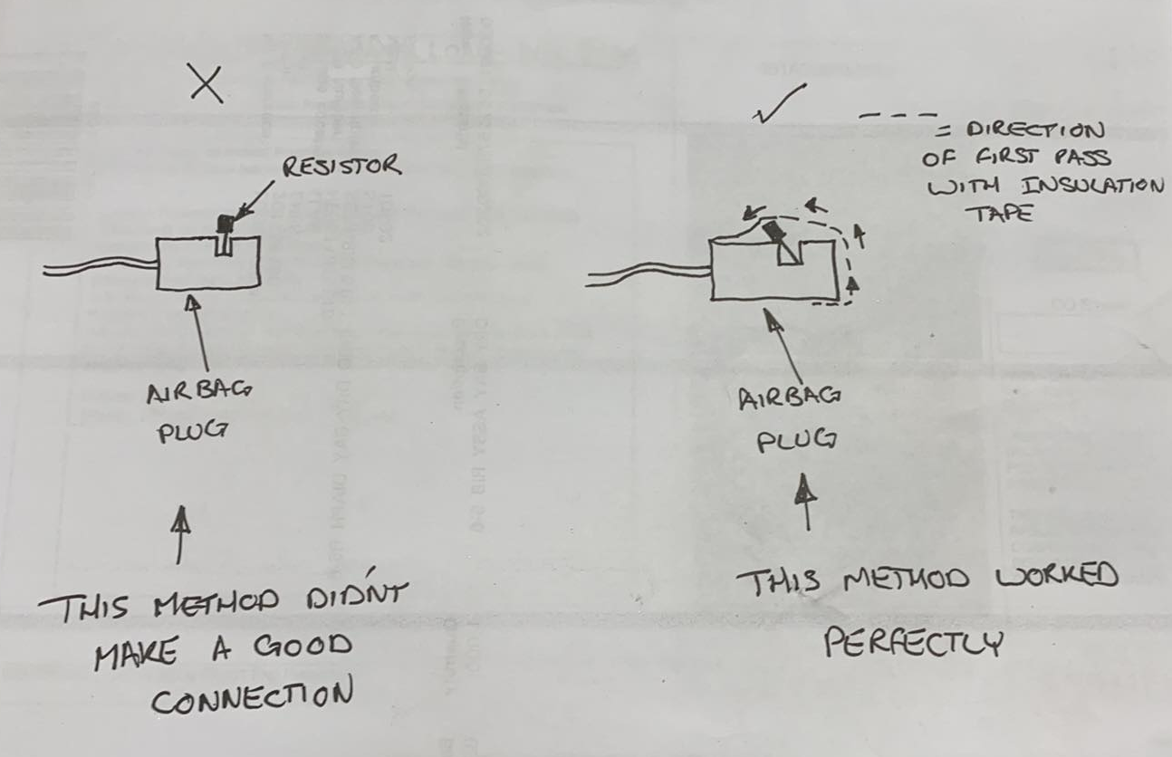

I've fitted a volantech steering wheel and their airbag resistors which were very loose so I wrapped them in insulation tape to keep them in. I'm getting sporadic airbag and SERV light popping up, is this likely just because of the poor fitting resistors?
I contacted Volantech about this same issue previously and they gave me the attached which worked for me.

A big pothole, not been on since! Seriously, although I don't use it enough to know if it's solved longterm. Volantech suggest taping the resistor at an angle which seems a bodge as they just need thicker terminals.
