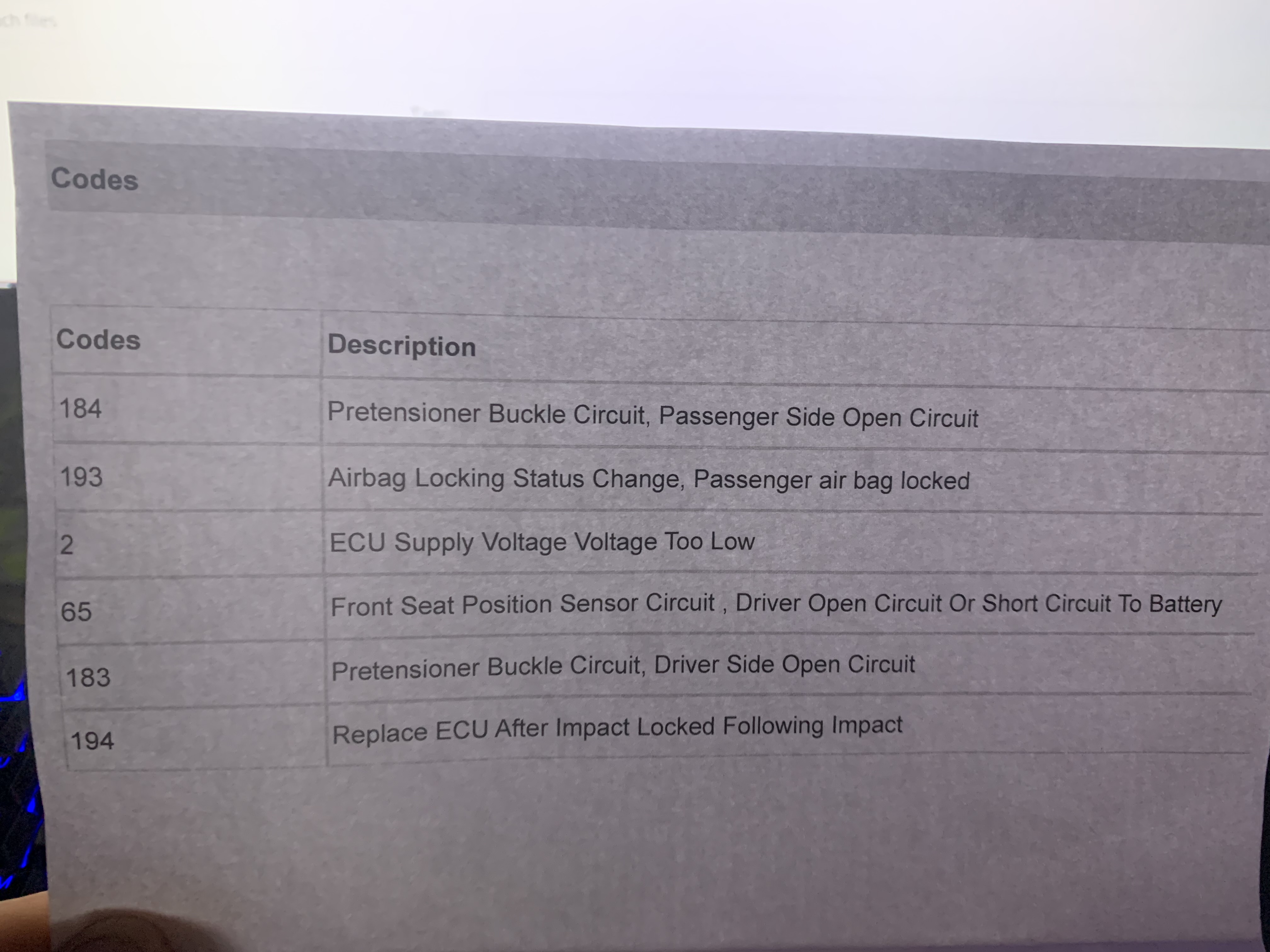

This is how the problems started, 2 weeks ago I curbed my car, both near side alloys destroyed and control arm bent! I've replaced them all but now have a Airbag/serv light on , when I plugged into my diagnostic tool it came up with this! any possible causes for so many faults? new airbag ECU?

I didn't notice anything go off. the drivers side didn't go off or none of the air bags, is there a way to check?

yes it is retracted! and it locked solid in place! so that will need replacing, it also says drivers side, but its seems ok!
