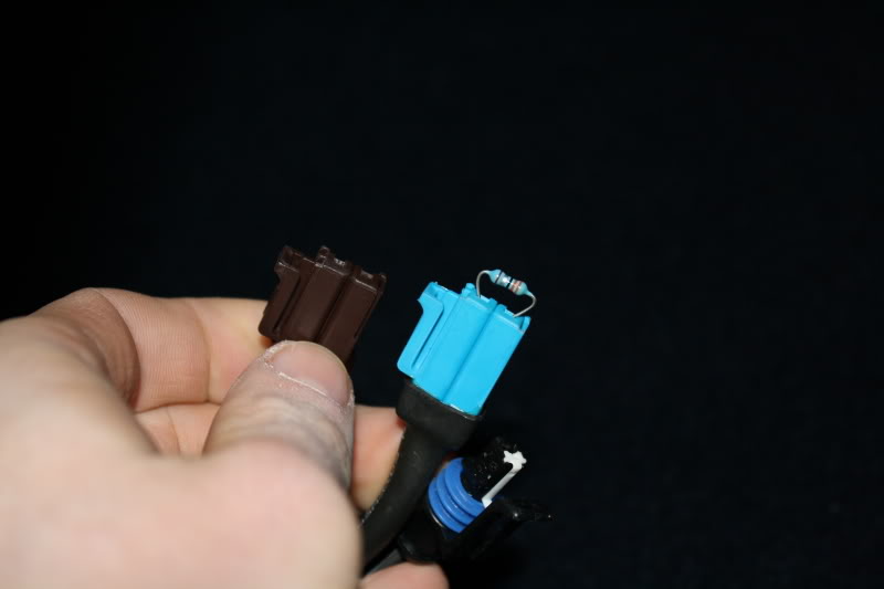

right folks, I have now stuffed various resistors into the black connectors under the bucket seats of my Trophy, but alas the damn airbag light stays firmly on.
Anyone know what might be the issue? After fitting the resistors, do I need to re-set anything? I didn't disconnect the battery while fitting these, not sure if that's important??

By the way, I put the resistors in the BLACK connector, NOT the grey one: I understand the grey connectors are for the seatbelt pretensioners.

just wanna know where the resistors are supposed to go? one says one thing, and another thread says something else.
does anyone have any pictures of what they did to theirs???ideally both the grey and black connectors to clear this topic up for us??

Its usually the seat connector but not always. If youve tried wiggling connectors the correct way is to have the code read which should identify which seat.
you have to put restistors in both of the connector blocks under the seats, not just one.
do it with the ignition off, then when it's switched back on the lights should stay off. 3.3 ohm in each one
have done that and the light came on,now no matter what i do i cant get it to go off,pics of the resistors in place would be a great help.
i believe im right in saying that the ph2's and 182's all use different colour blocks. but basically, the 2 larger blocks both need 3.3ohm resistors in each. ignition turned off. the round looking block has only 1 hole so dont worry about this

I've got a bucket seat in but with the pretensioner in use so am using that side of the wiring. The single wire/plug I'm assuming is an earth for the airbag which is shared via the loom with the pretensioner... can anyone confirm? I've got a resister setup in the airbag plug, the pretensior still plugged in and that single plug lose... still have airbag/serv lights on!
