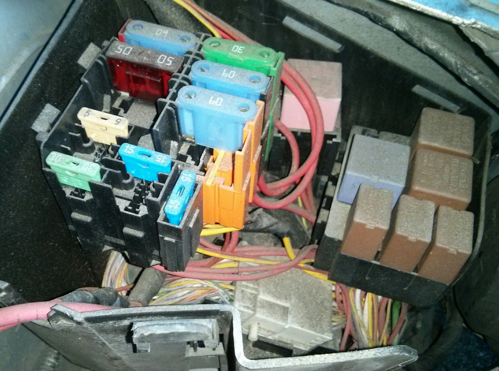

My aircon compressor clutch isn't engaging. The blowers and climate control panel work fine, and if I give the compressor 12v direct from the battery the clutch engages. So I'm guessing either a compressor clutch wiring issue, or perhaps the relay our a fuse has failed.
I read it's a big yellow relay but can't see one under the bonnet - is it visible in the attached picture? Also is there a fuse dedicated to the compressor clutch?

The relay your after is the one at the back on the right . So it's closest to the wing .
Underneath is yellow wires , a thin grey wire and 2 larger pinkish wires that feed the clutch .
If the ECU doesn't see any gas pressure IE the system is empty it won't send an earth signal down the small grey wire to operate the relay

Thanks guys, I'll check it. I should have mentioned, my aircon guy confirmed it has enough gas (and he put it back in afterwards!). Is there any way to test the relay?

Stick 12v across the coil and see if it switches

Small update, the pink relay is for the interior blowers, not the aircon compressor. Removing it makes the blowers stop working.
The pressure sensor sounds like a possibility, since it didn't seem to suddenly die but seemed a poor before going completely, which could have been caused by the pressure switching toggling intermittently. Does anyone know which of the three pins in the conector I would need to short to test it?
