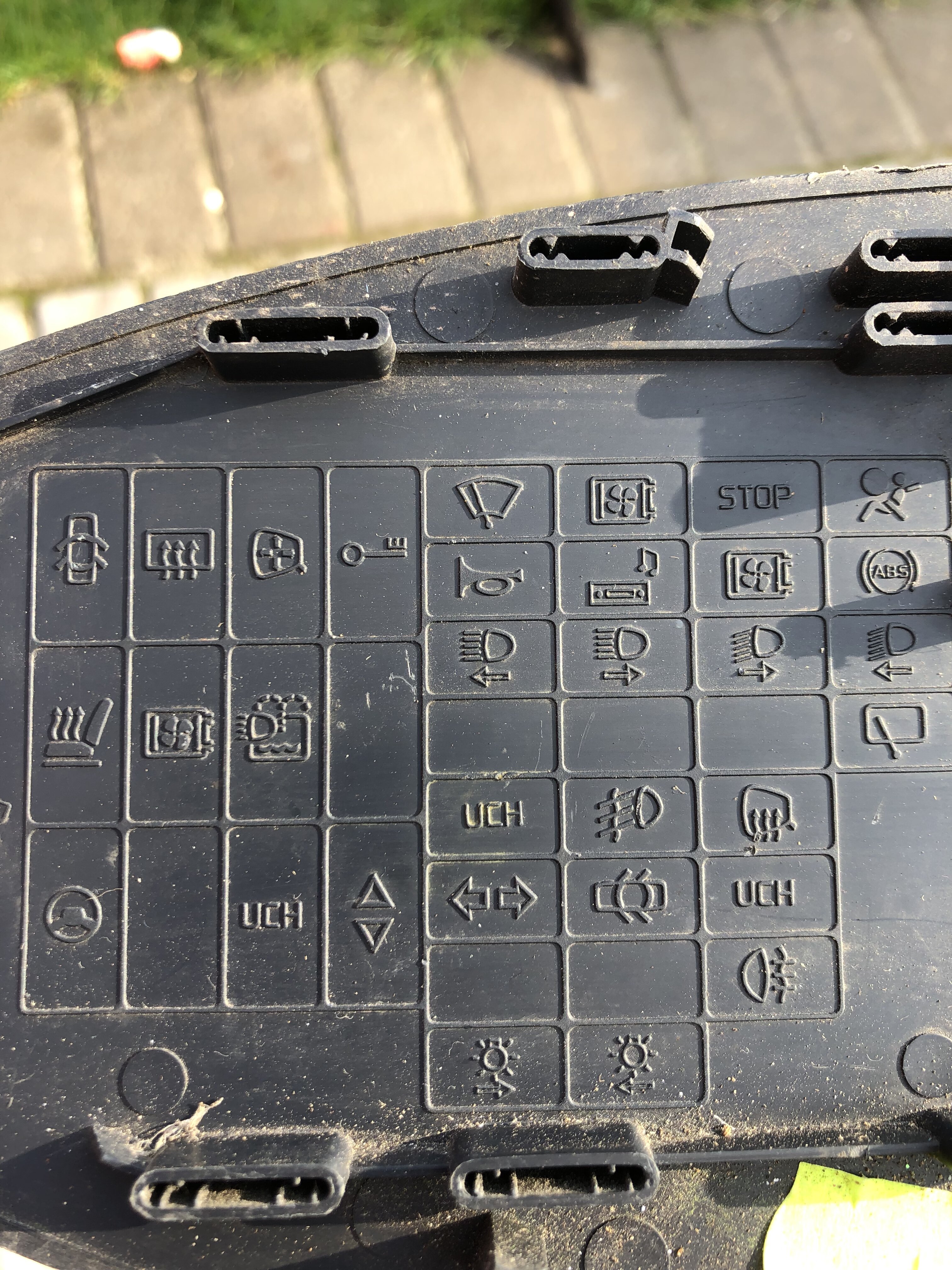

Anyone know which one the blower fuse is please?
You can bridge the connector on the resistor pack which will make it run. This then isolates the problem.
Just dont leave it bridged too long
Ok so tried a new resistor pack and same thing so got a spare now. Still no blowers. Anyone know which the blower fuse is please. Not very clear on the fuse panel cover. Control panel all seems to work. (Well it lights up and changes when I select a/c, blower speed etc).
