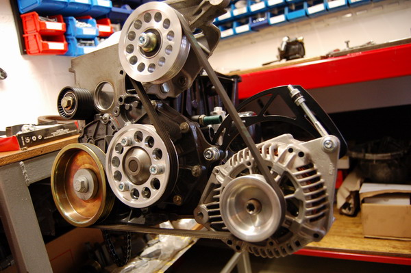

cup set up with p/s delete:

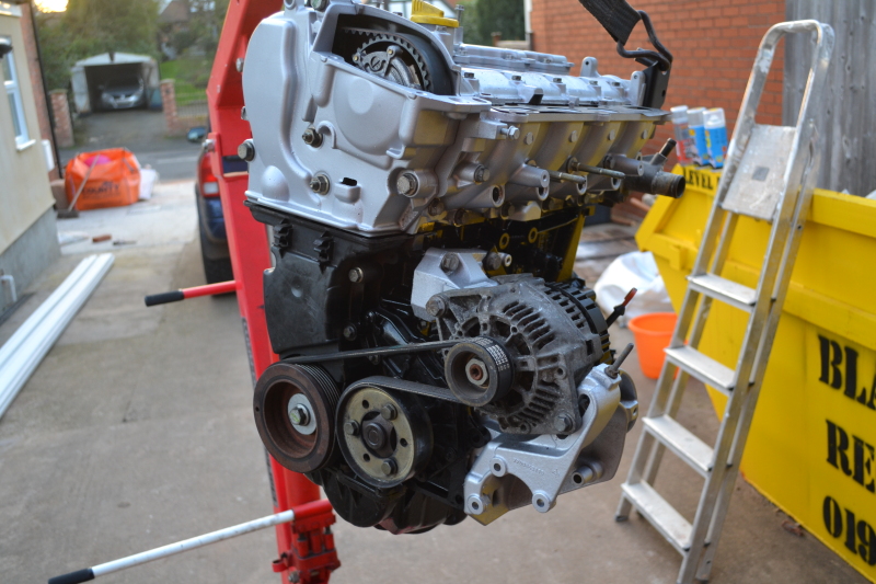

PMS with P/S delete
Just noticed the PMS kit in that picture has the water pump rotating backwards
Edit: no it's not just me being Dumb!

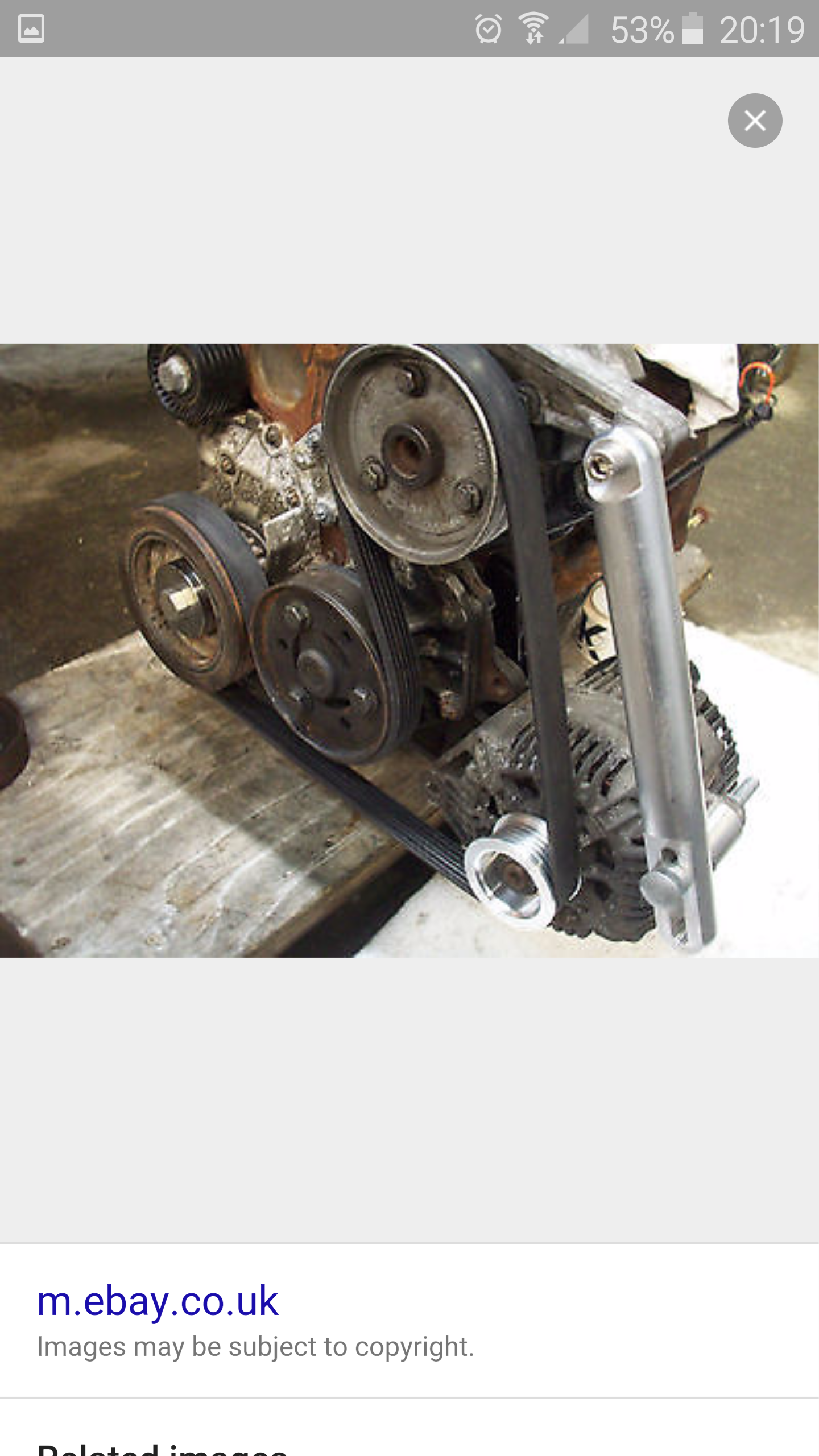

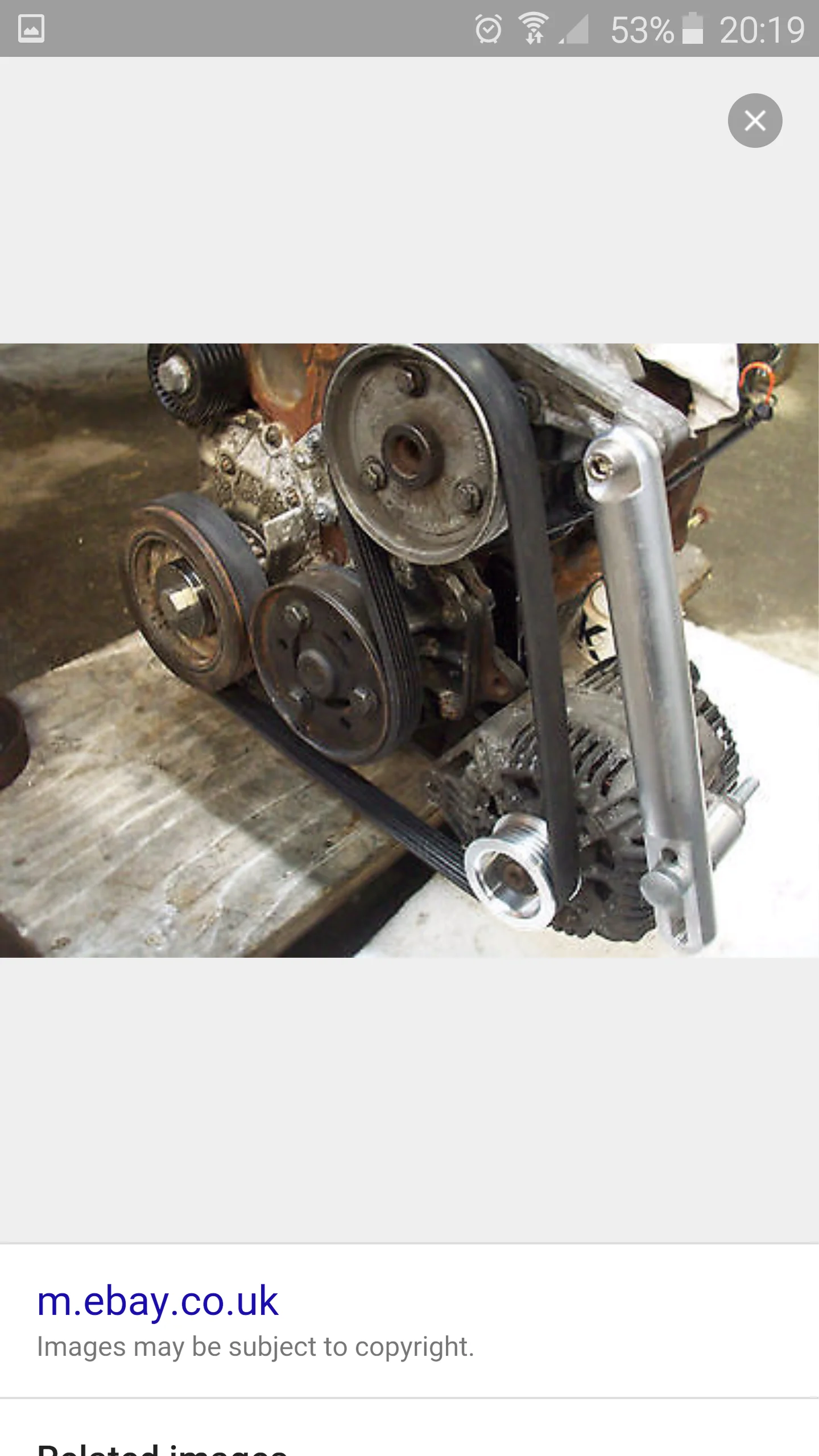

I bought an aircon delete kit from Kingsnorth engineering best 109 notes ive spent revs better now an takes 5 mins to replace the aux belt
