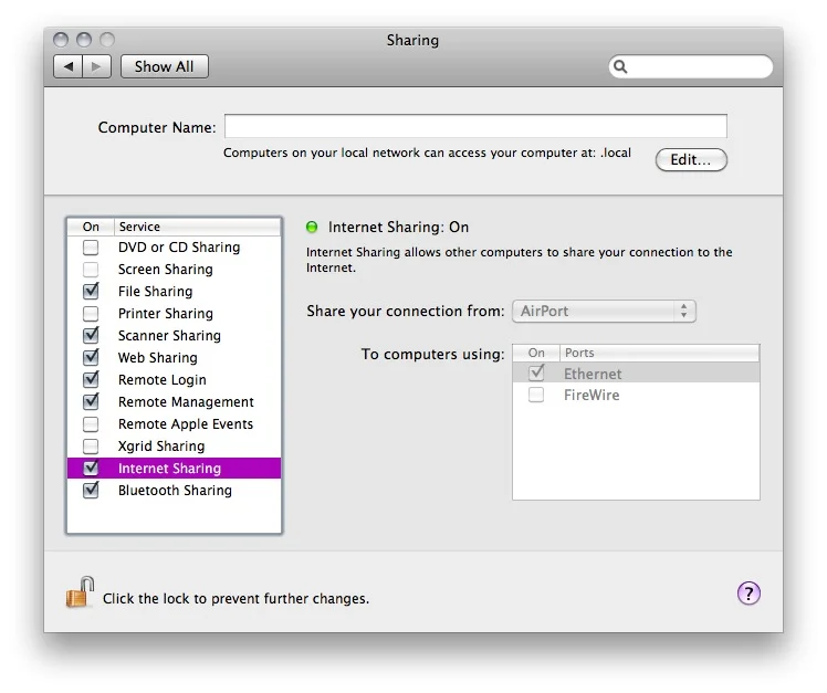

Turn on internet sharing in preferences and then hook the PC up with a ethernet.

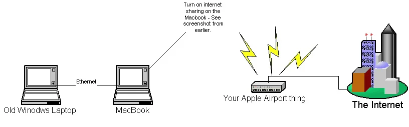

Thanks. Do I need to connect the Windows laptop to the Mac via an ethernet cable then? And will this cable have to be connected to the both of them for me to be able to use the net on the Windows laptop?
  Fiat Panda 100hp
Yes. Once connected you can download your service pack then it should be good to go on the wireless.
