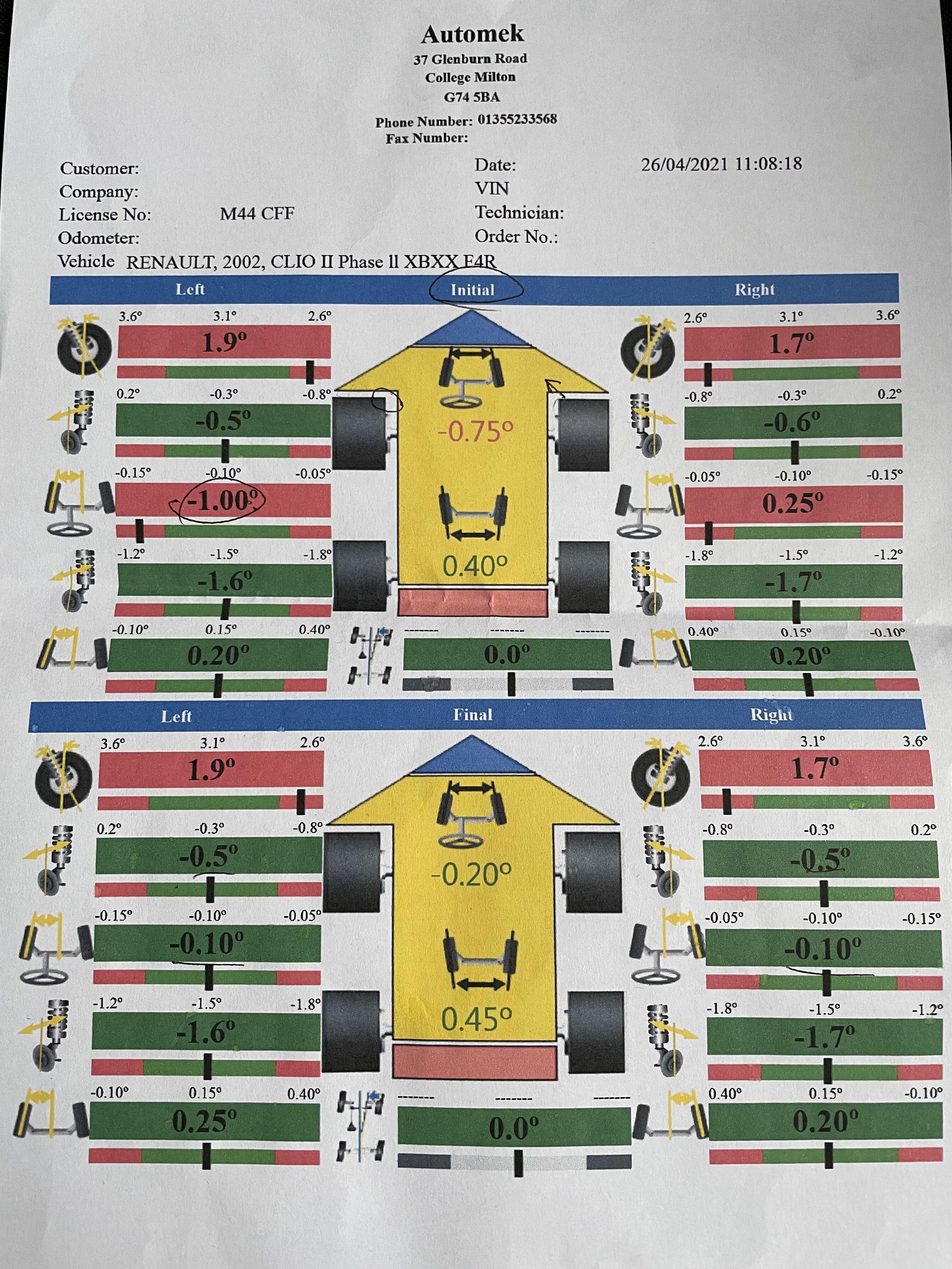

Kwik Fit hunter alignment should be more than capable- just ask for your required camber etc and they’ll set it up for that.
I believe it’s £65 for a front alignment.
Mine was very out of wack previously due to having the engine and subframe off and a rack change. Understandably it drives like a totally new car. Mine is mostly on the road too and drives superbly!
The above settings are a good base but depending on how hard you corner and how you like your steering, you could consider more camber up front. I found increasing front camber vastly improves turn-in and steering feel, at the expense of wearing the front tyres on the inner edge if you spend a lot of time driving in straight lines.

Thanks pal. Car spends more time going round corners than in a straight line. I’d say cornering was medium to hard usually.
Good man! I'm running 3 degrees camber on the front with solid top mounts. The OEM rubber mounts and camber settings weren't to my liking at all. I am getting my camber and caster from adjustable top mounts - not sure how much camber you can get with bolts, but if you like cornering then max it out I say!
3° of neg camber is a lot on a road car.
My daily runs at -1.5 and feels wonderful on 595RS-PRO's.
Might consider-2.0 as an experiment.
Had -3.5 for a week or two once (waiting for alignment) lovely when pushing on in corners, terrible squeeling and hunting everywhere else.
