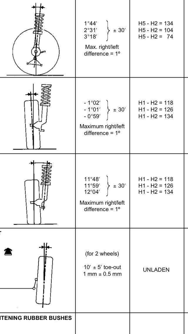

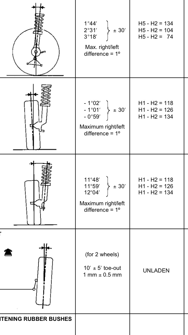

@bbracer16v these clios run 1deg as standard fella .
So when I'm saying 2deg , that's add 1deg to what it's got anyway .
So I'm now thinking your 1deg is pretty much the same figure overall

These cars toe out anyway , so a degree is fine

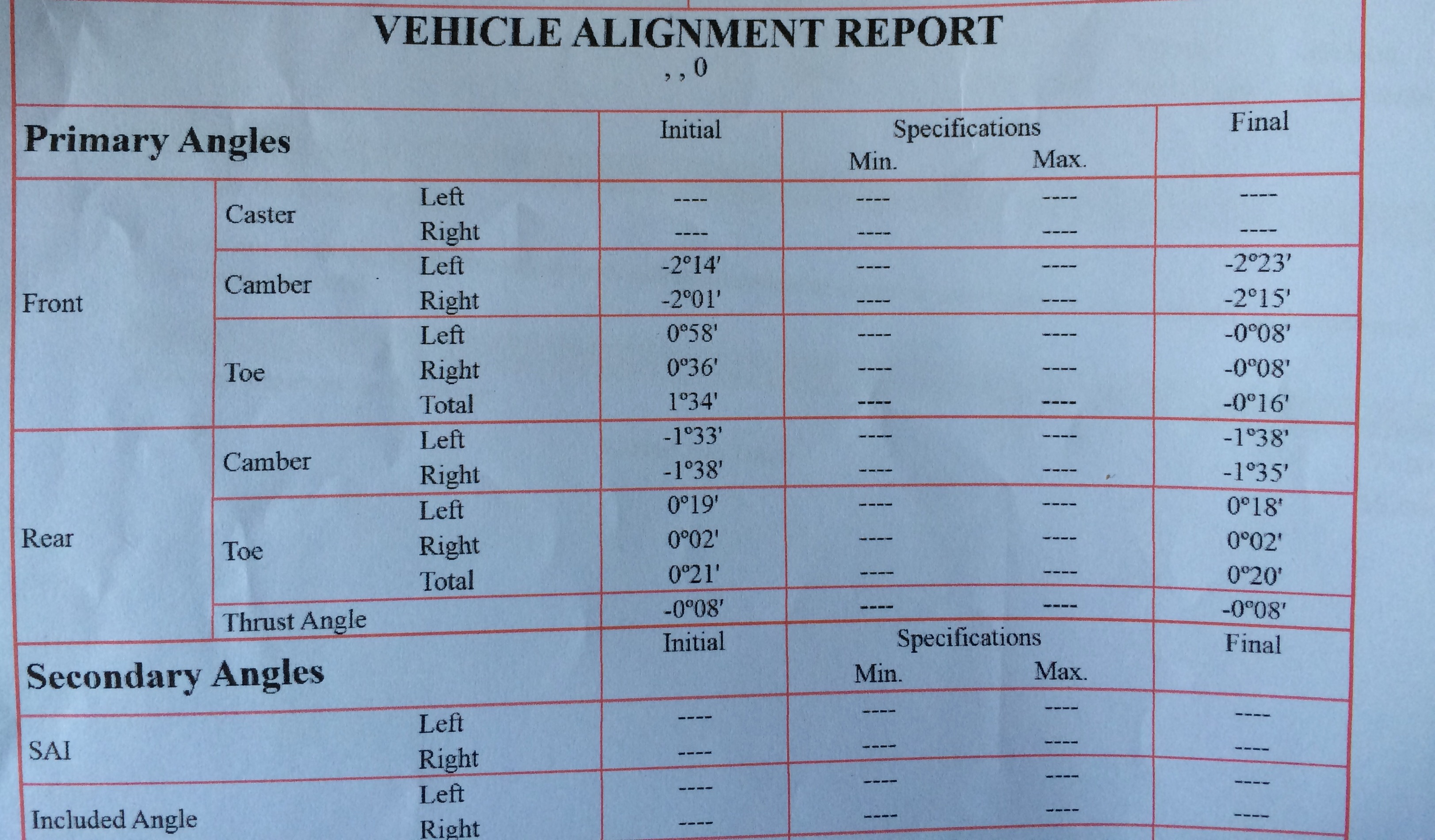

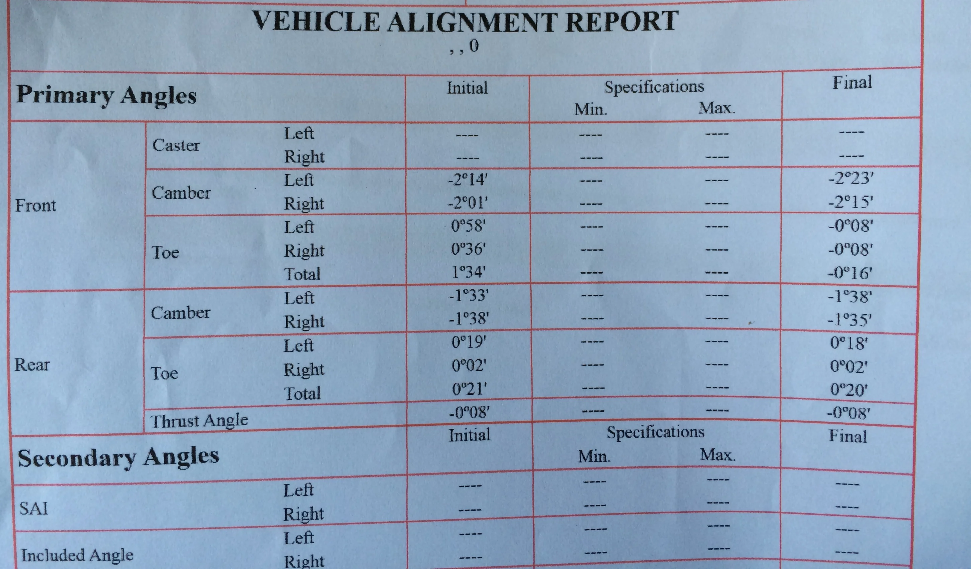

I've recently had mine done and went for the following:
Front Camber: -2 degrees
Rear Camber: Standard
Toe F: 10 mins out
Toe R: Standard

No such thing as a free lunch so ask yourself what you want the changes to actually do - that'll inform you of what setup to try. For what it's worth this is my setup, very similar to what's already been posted.
My toe on the car was changed from 2 to .06 out. Previously it was taking off the inside of the tyres. It now has better toe in IMO.
How much camber are you running? Both my RST and my old Focus were lowered 40mm, maybe a little more for the former. With the negative camber put on as a result the tyre wear was still OK with the toe set right.
-2.2, but to be fair I'm also running 888s and it's track wear so really it's not that excessive.

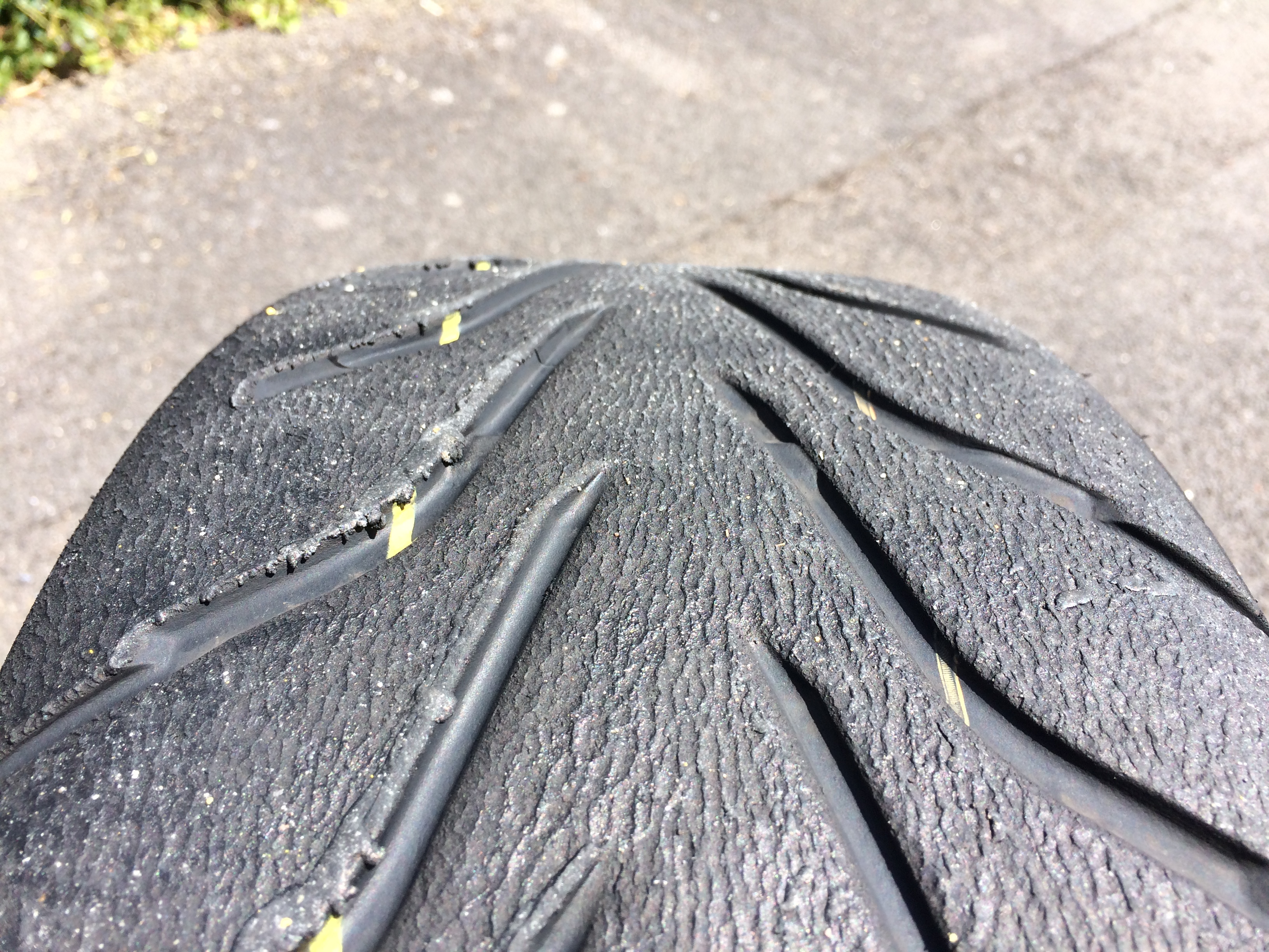

I'm running close to that and just started to notice the inner edges getting low .
I've just spent the last week swapping the tyres over off the wheels as they are directionals . Need to get the max out of them I'd say .
This is how they looked before the most recent track day. They're now definitely not legal but should have another day in them I think. Probably a couple of mm extra wear on the inside of the tyre compared to the outside.
