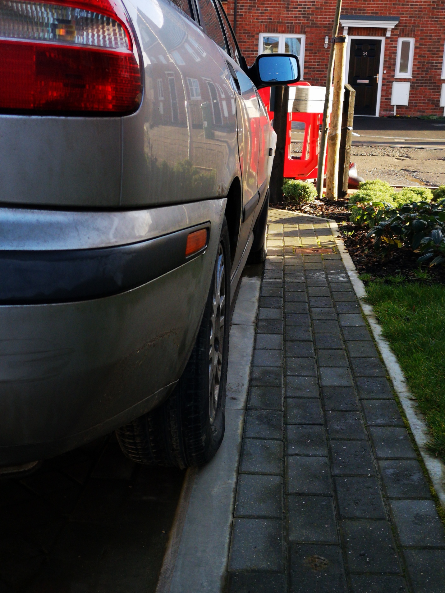

I've noticed recently the back end is crabbing, it hasn't always been like this, only in the last month or two and hasn't had a knock or anything. Thought all this new stuff and a proper 4 wheel hunter alignment would sort it out but no.
Car feels worse than before, really unstable at motorway speeds, proper floaty, seems to be crabbing badly and when turning, it'll be fine then feel really loose.

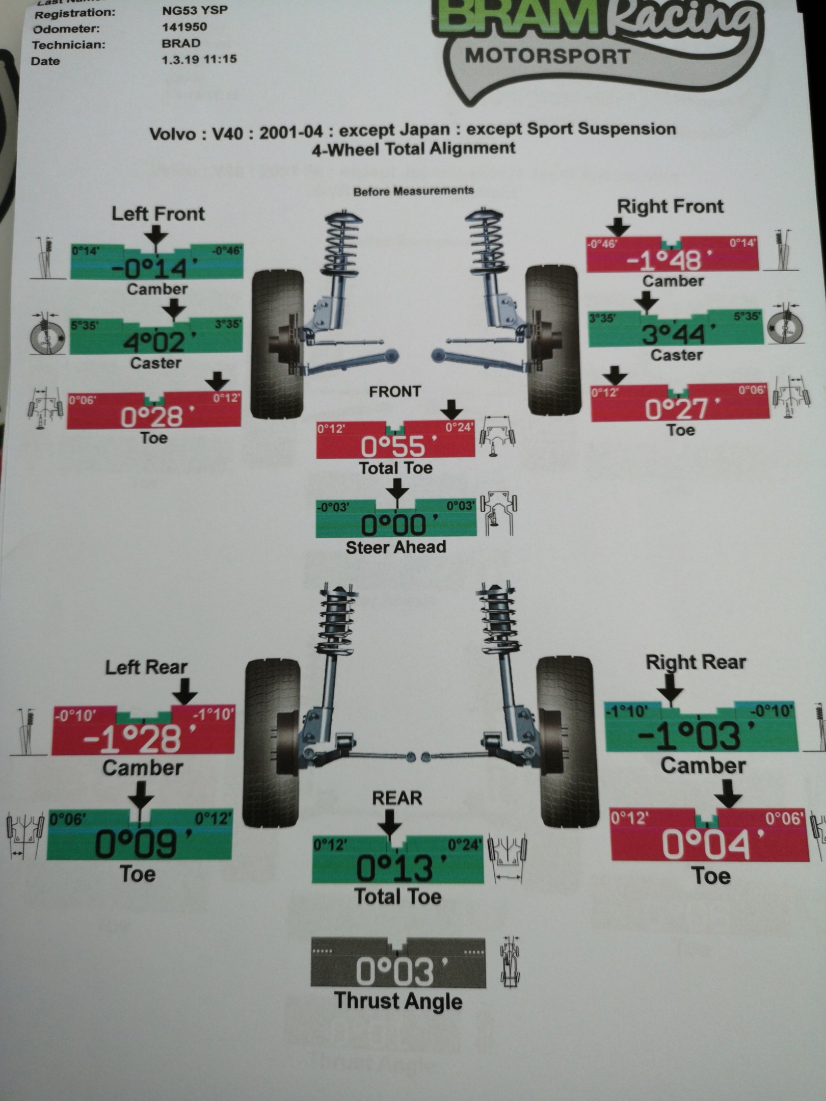

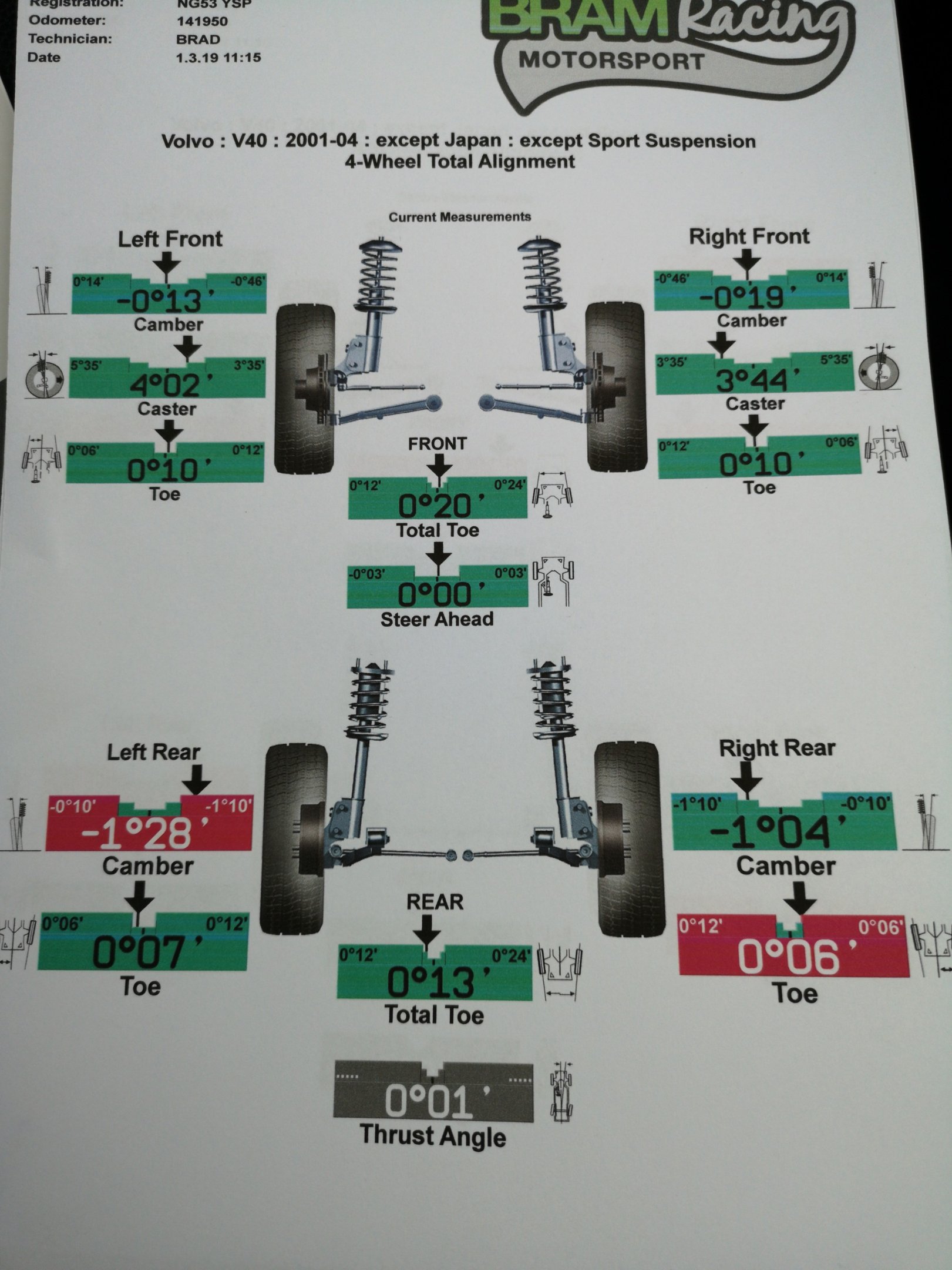

See alignment specs before and after. Also photo that shows the crabbing. Tyres aren't as flat as they look, it's just the little kerby thing they're sat on. But that kerby thing is bang on straight so you can see the crabbing is quite bad.
Thrust angle is also spot on so not sure why it's still crabbing and handling as it is. I'm obviously going back to the place that did the alignment but thought I'd ask the CS.net gurus, who know all, before I do.

Topped them up tonight but as I say, it's because they're on the little kerby bit that it looks worse than what they are.

Alignment looks all good, as long as they set the machine up properly.
Could potentially be worn bushes?

Just park it straight you gimp. ?
Couldn't they see it was out like that when it was on the hunter?
Thing is, you can't. When the fronts straight, the back wonky. When the backs straight, the fronts wonky haha.
Thrust angle shows its dead straight which is strange.
