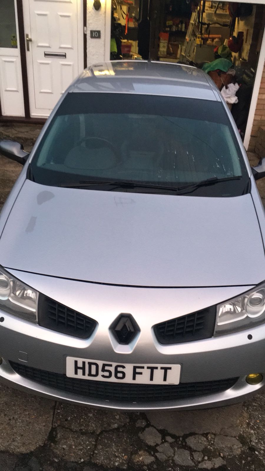

Ordered up a new sunstrip, not keen how small this is so it’s going a few inches bigger, with the typical red vinyl stripe along the bottom when I can do it!
Going to wet and dry my head lights, remove the yellow tint from the fogs and possibley do them as well. Trying to think of things to keep me occupied while the cars off the road.

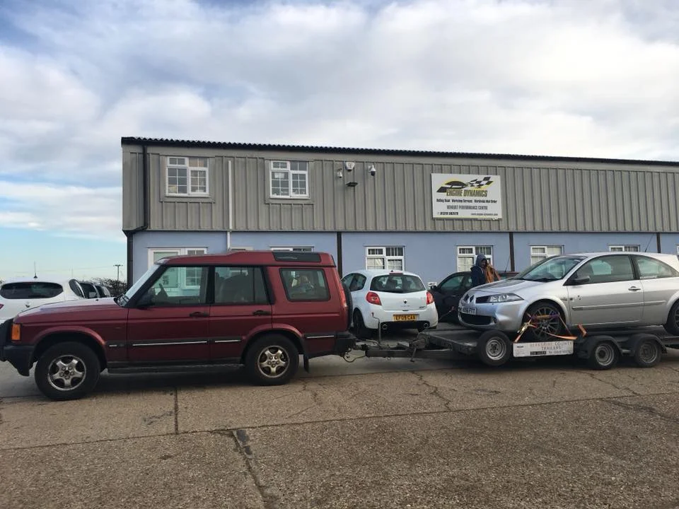

So now I have some time i can type upp.

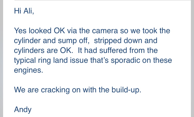

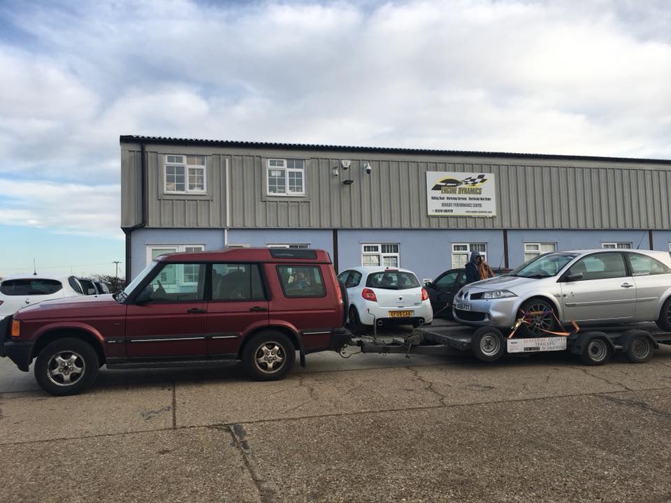

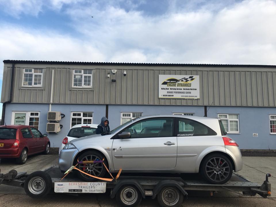

Left this morning about 8:00 AM, got there just past 9, not bad with the Monday morning traffic. Met Andy, sorted everything out and I was on my way, with a very light pack pocket!
70 mile trip back was good, boring motorways and not something I wanted with a newly built engine, but It was alright I guess. 70 or so miles on the engine, past the MOT this afternoon so all is go! Coilovers will be here this week, so I'll get them fitted next week hopefully.

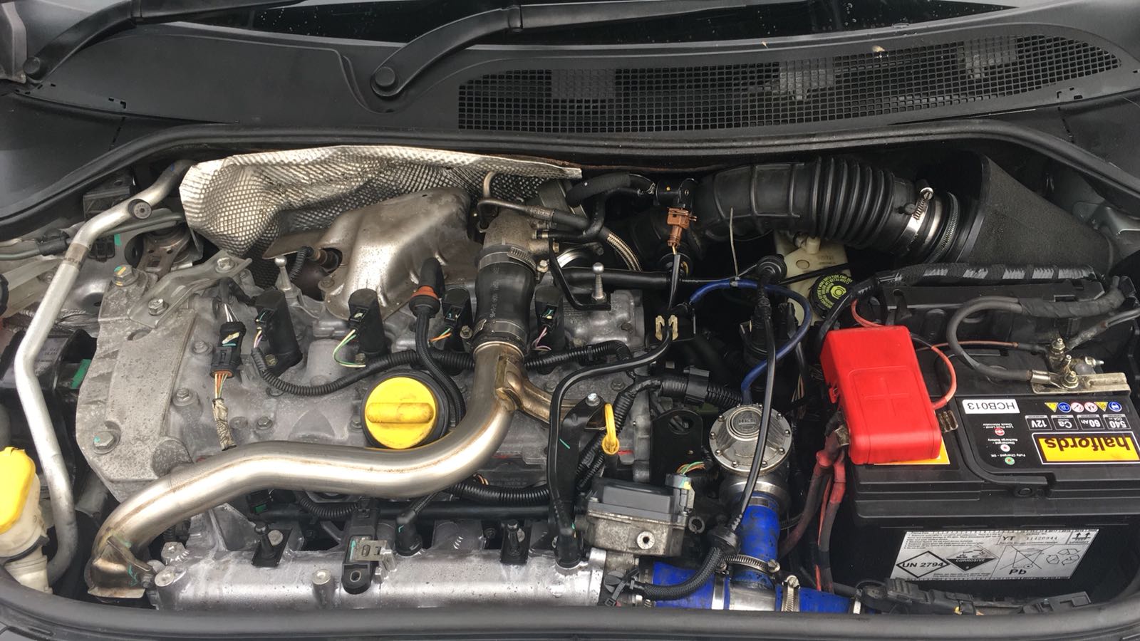

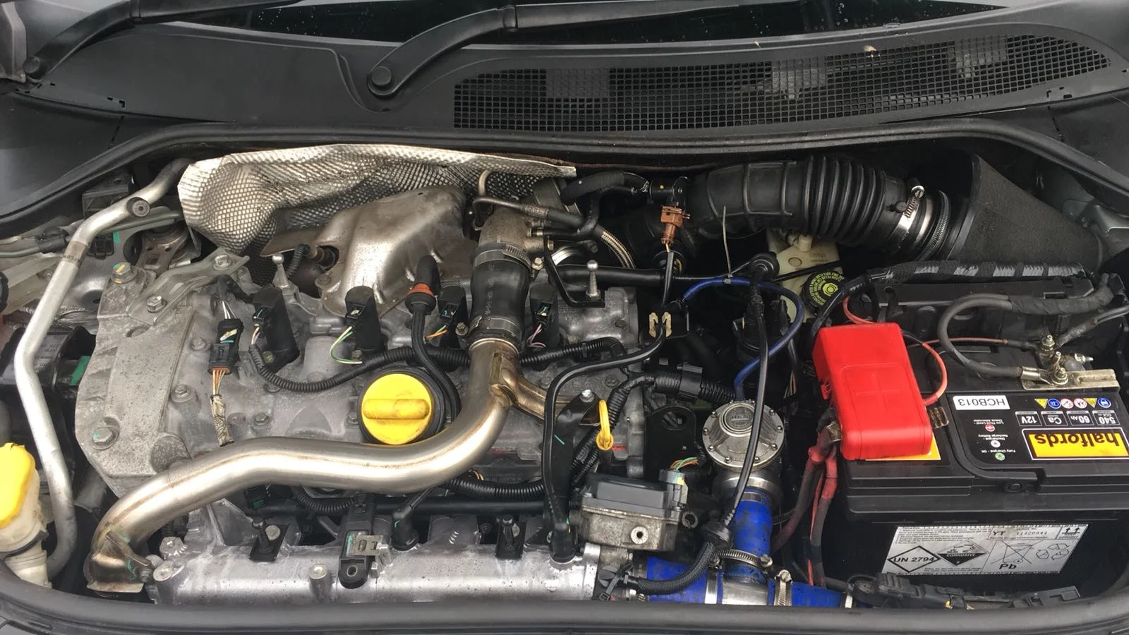

Nice clean engine as well, very happy.

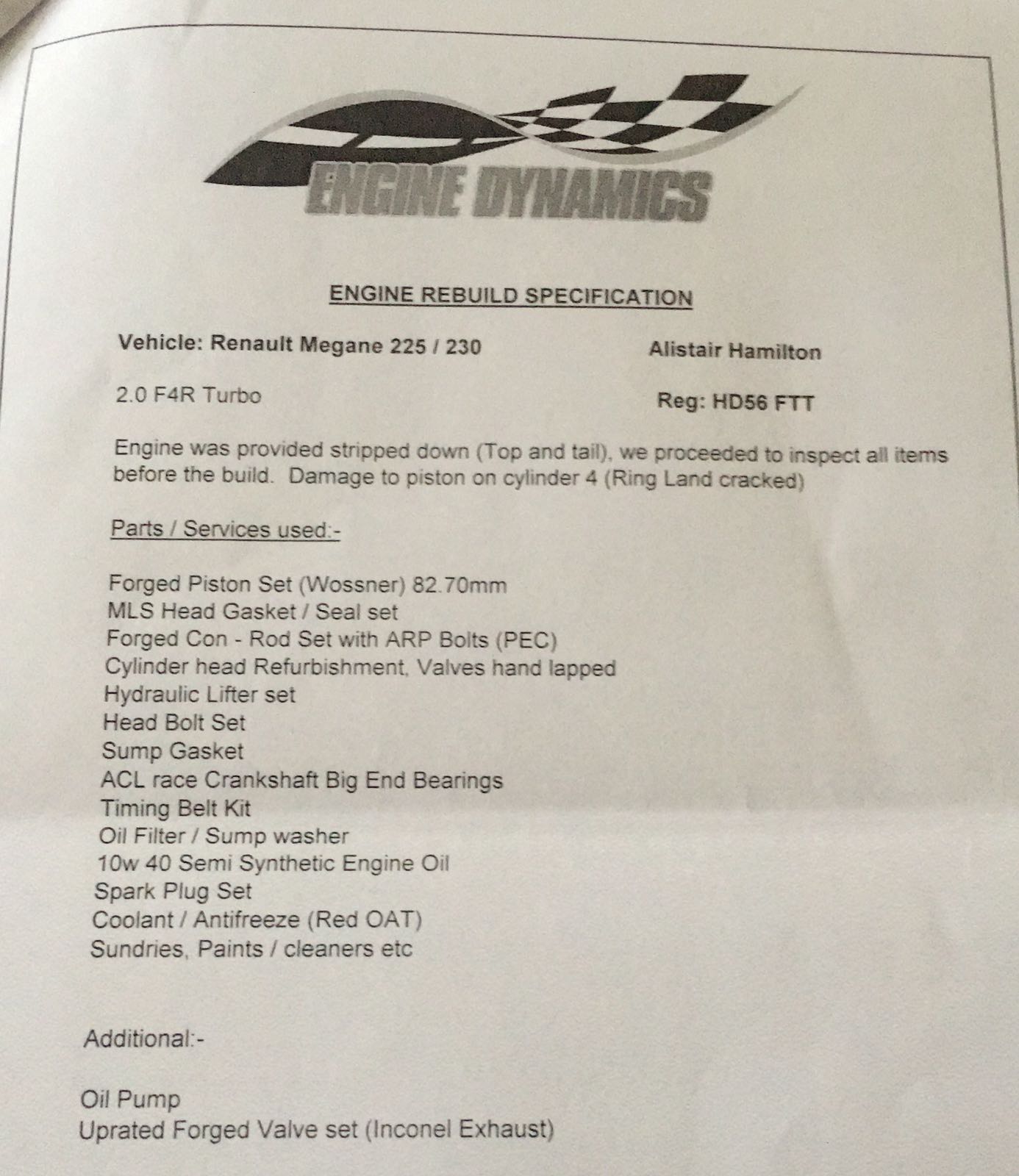

Ill stick up a picture of the spec of the engine, too much to type!

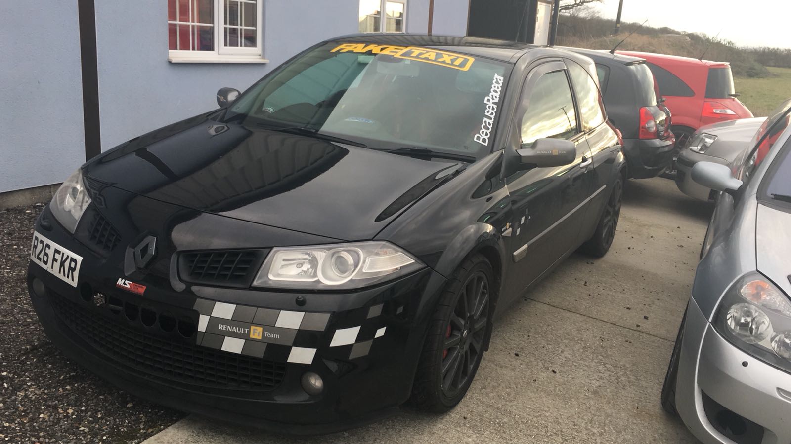

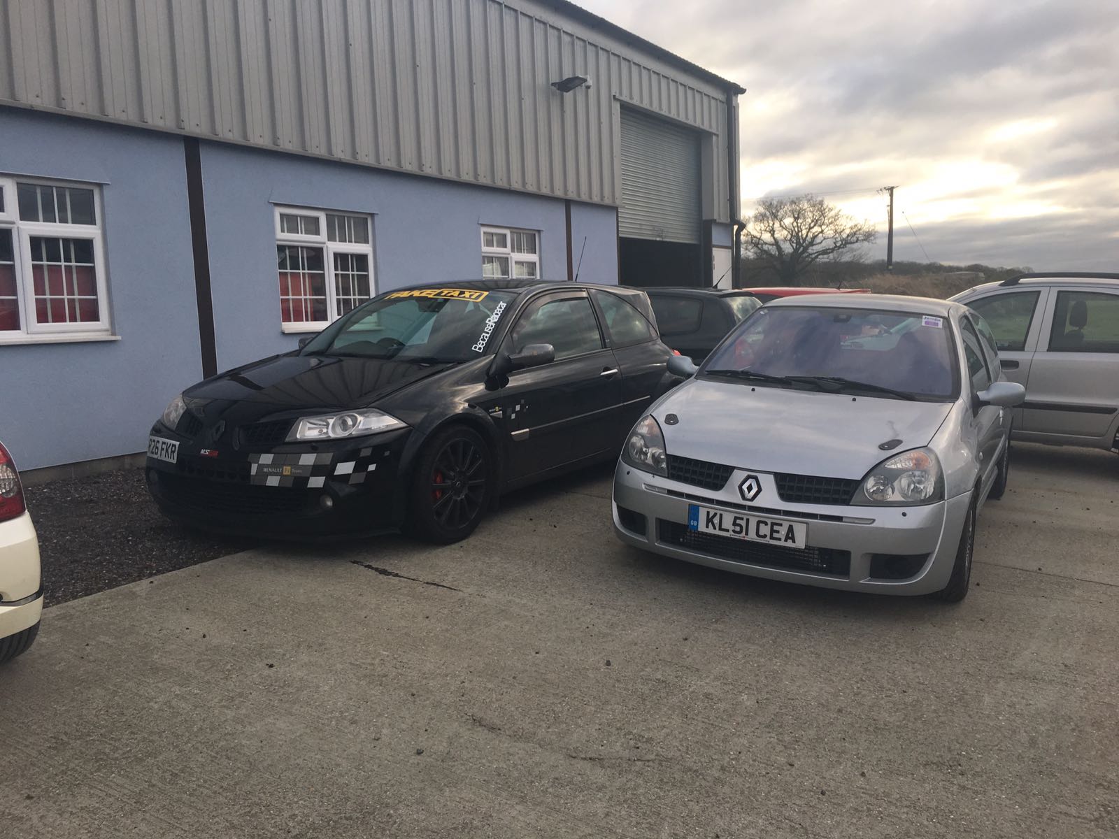

Saw these two down there which caught my eye as well, (I THINK) its a high boost Clio, and a pretty powerful R26, external fuel/swirl pot set up in the back!

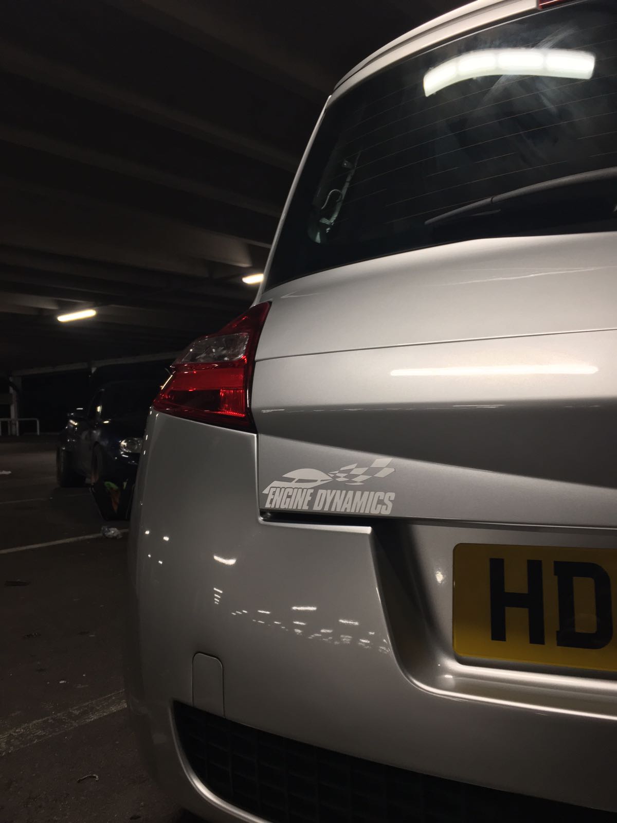

All in all, extremely happy with the service of Engine Dynamics, would recommend 100%!

What power you after with the forged lump? 270/280?
TRH_Racing
South East - Herts/London
Nice spec
When does it go back for mapping or isit already mapped?
Its mapped currently, but after run in, it'll be back on the dyno for a tweak / make sure its all fueling correctly and hopefully add a bit more power!
with a new cooler and exhaust, 290+ .. meg250 turbo will be bring me to 300 .. so ill be happy with a 300/300 car

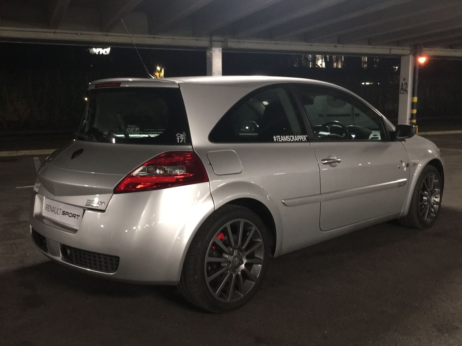

How I missed driving it, having a lot of fun atm getting used to the car again, obviously not acceleration wise due to the run it period.
Managed to fit a new slightly wider sun strip today, looks alright, a lot better inside now!

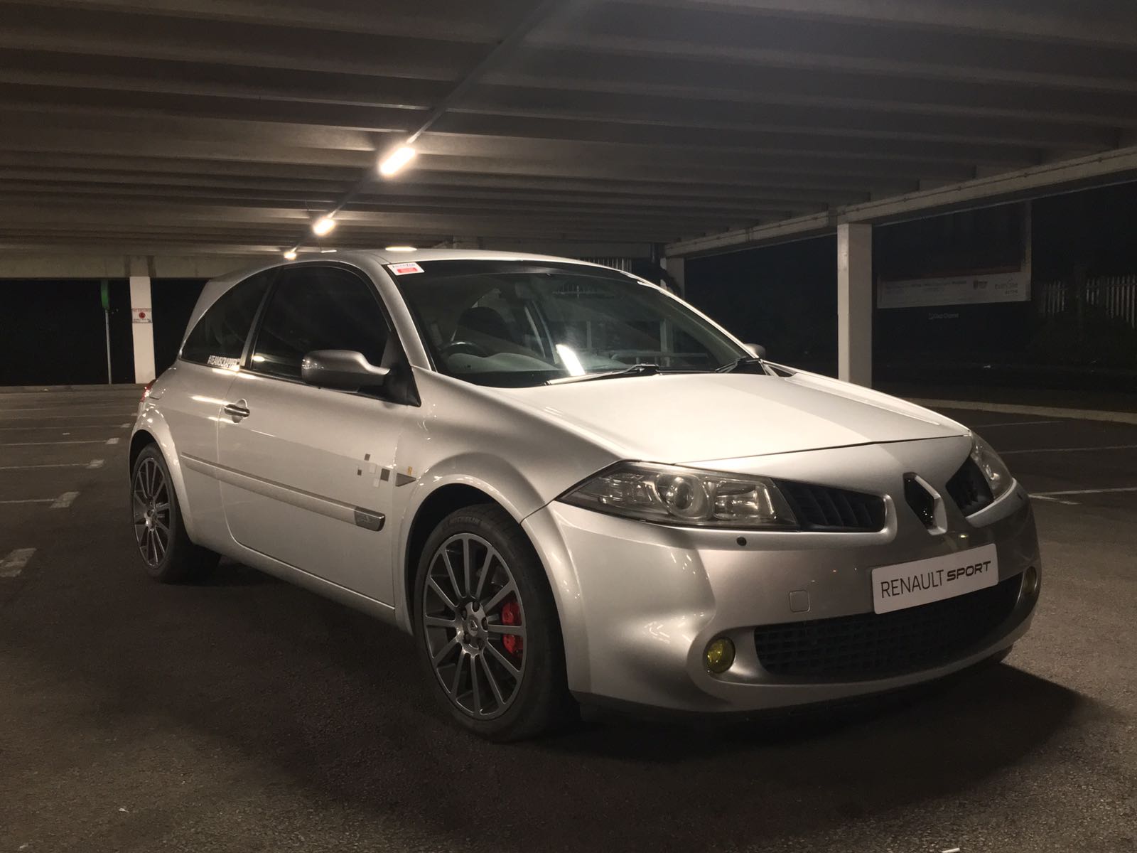

got a few pics down the local asbo spot, lighting was s**t as per usual.
Ride height is atrocious atm, arch gap for days. Coilovers should be here this week so that'll sort that out.

I've seen a few megs on here with worn fuel pumps, it might be worth considering replacing yours with either a new standard pump or an up rated one, I would hate to see this engine fail because of a weak fuel pump, I think it's number 4 that suffers.
I'm sure Dan who's building the meg powered Clio has replaced the fuel pump.
