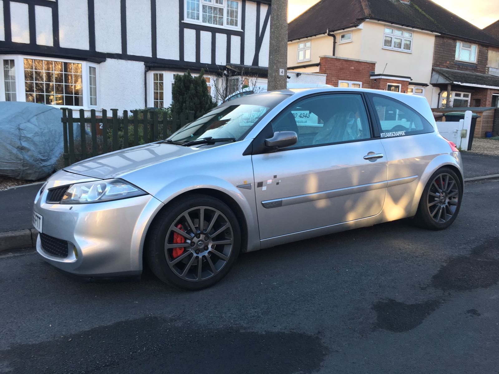

Why is it so high? weird!
The interior is stripped hence the awful height.

and they're on! feel great, front end needs to come down a bit tho, too much arch gap :(

Lowered the front a bit more today, might leave it as that as certain speed bumps are scraping the splitter ..whoops.

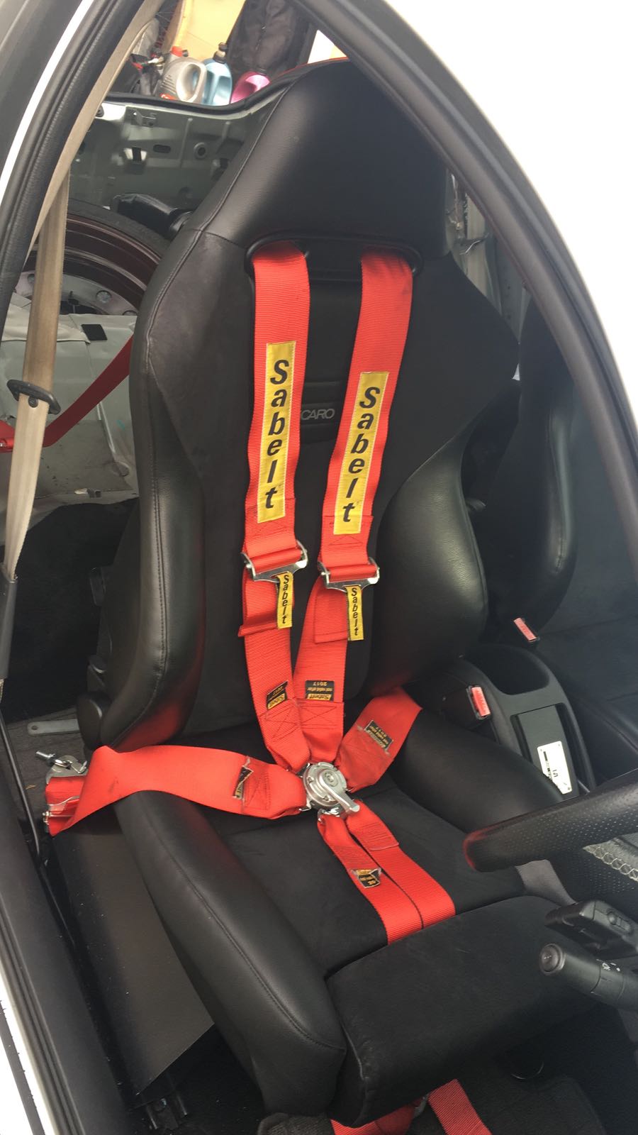

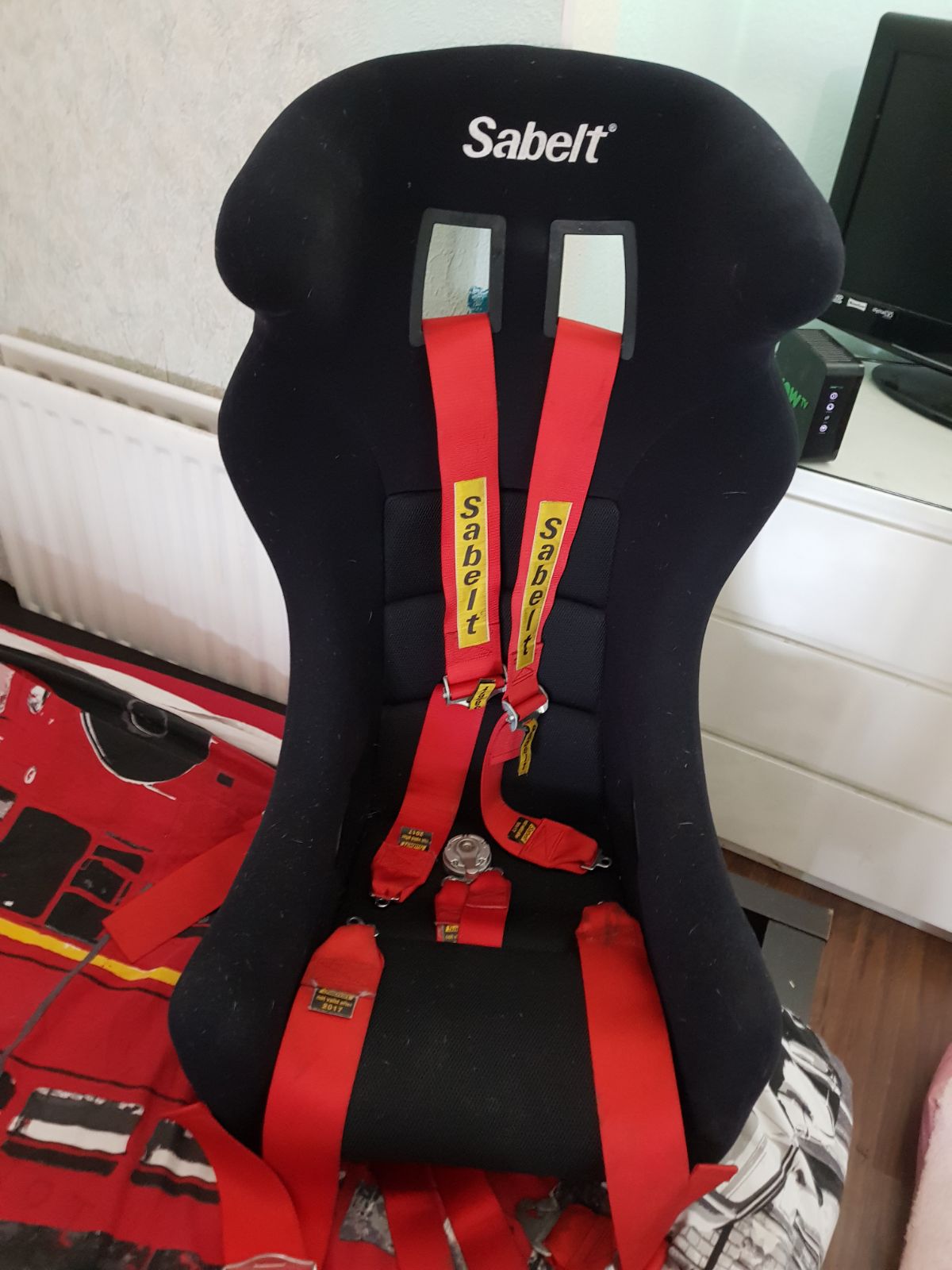

so 95% of my eyelets came for the harness today .. i cocked up and didnt buy an M10 .. so that should be here before friday and HOPEFULLY get it fitted before Spring action day!
small mock up, may end up selling the bucket seat, harnsses and recaro's are comfy as for a road car anyway!
