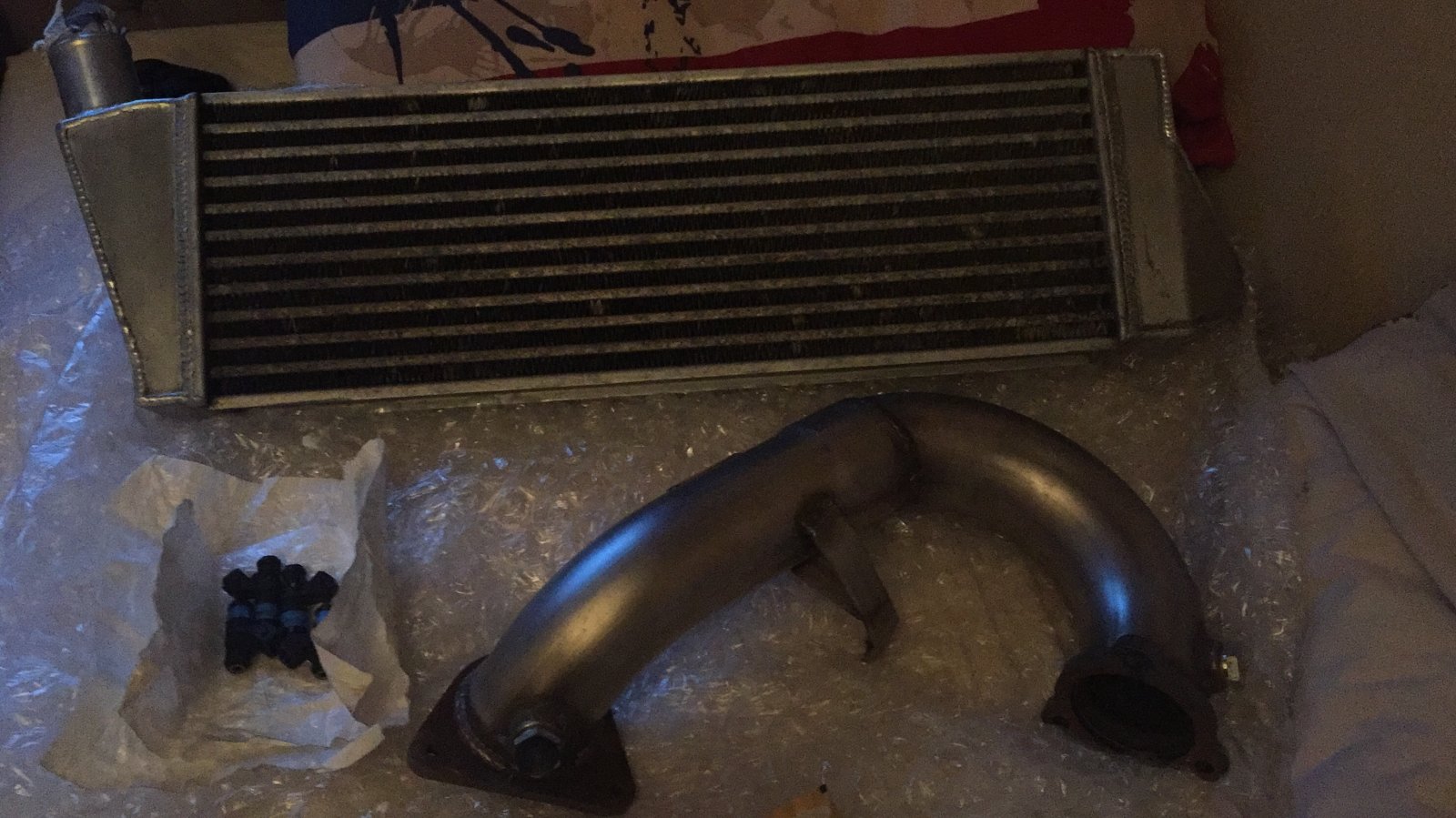

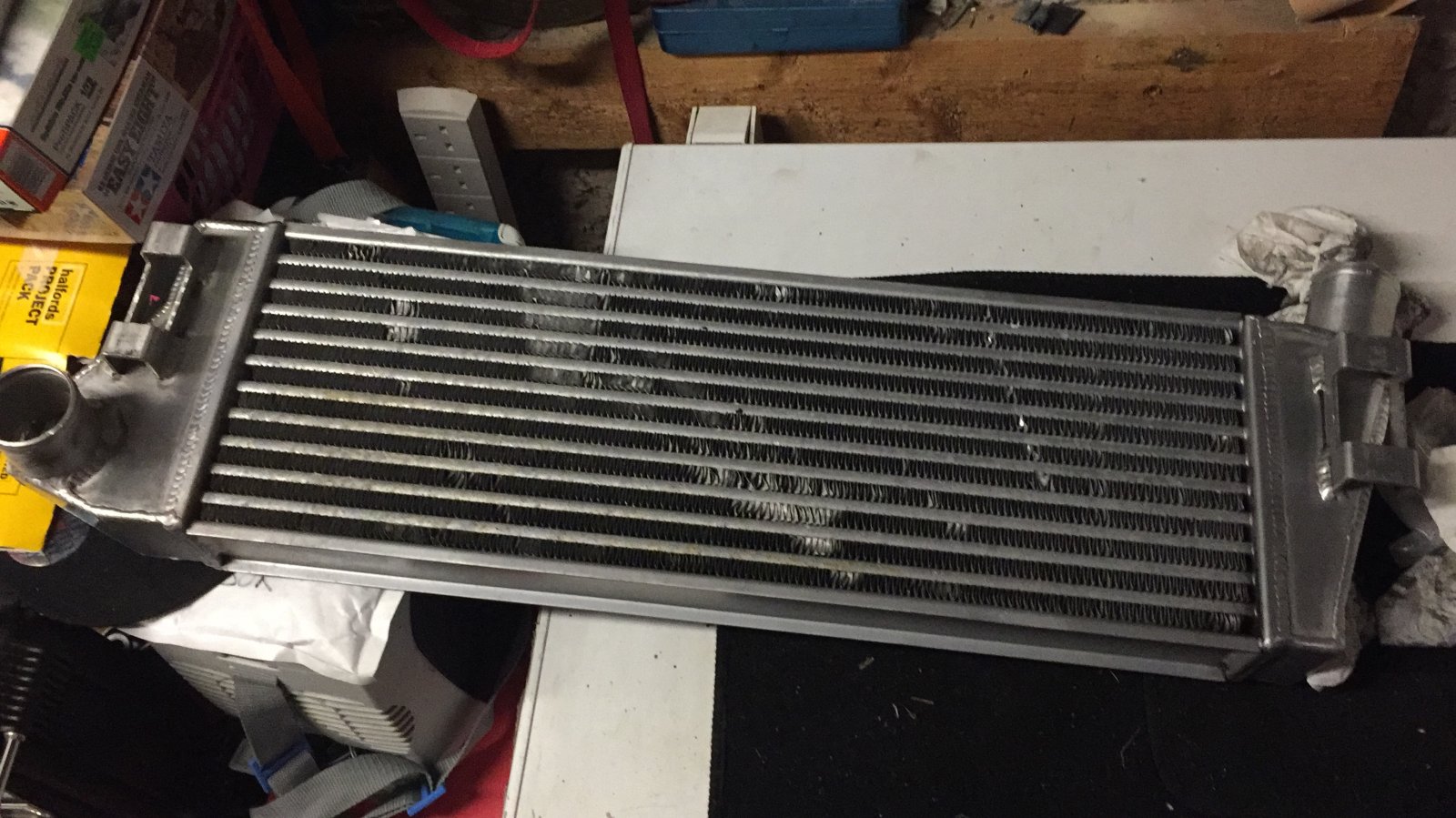

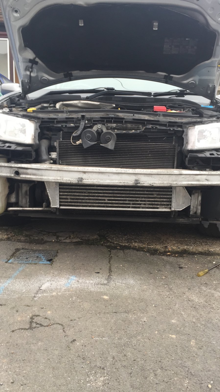

So, intercoolers on .. Cars clean on this lovley day! .. Went and saw Matt for a few hours to help him out with a few bits and pops so it's been pretty productive :)
Old / new cooler look the same size but the newer one is slightly deeper .. Turbo sounds like it's getting more air due to a higher pitched whistle at high revs (?)

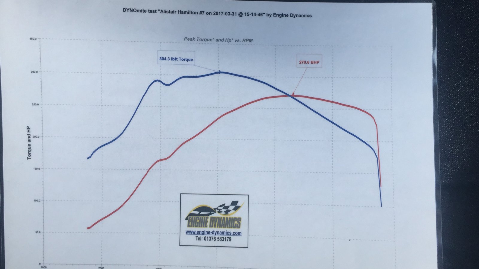

So today was mapping day, went all good!

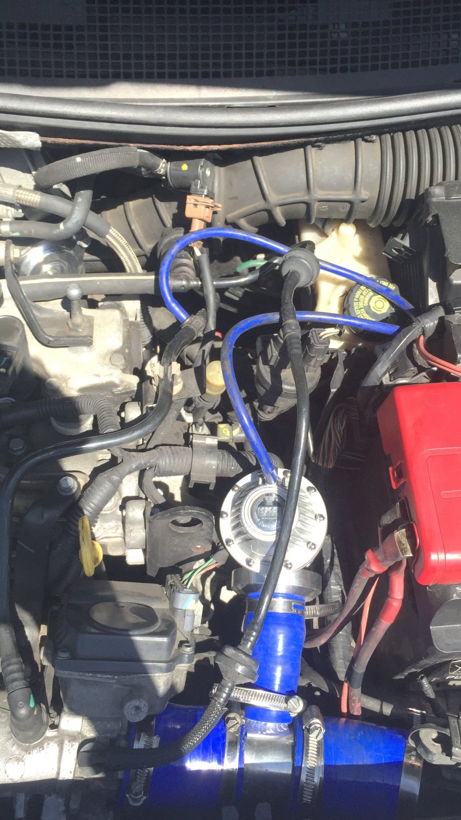

Had a leaking recirc valve that we blanked off and also a new boost solinoid put on .. Gotta sort a 3" exhaust, bigger front mount and a proper induction kit set up and I'll have a fair few more ponies to play with ..
But currently as it is it's amazingly quick, didn't expect it, drinking fuel like anyone's business haha
270/304

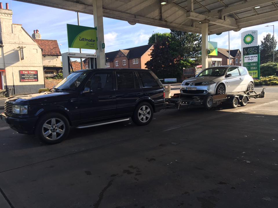

Cars booked in for tuesday .. being picked up tomorrow night loaded onto a trailer, and then towed down saturday and left there for the week!
cruising round in a 1.4 fiesta is hard to get used too after turbo!

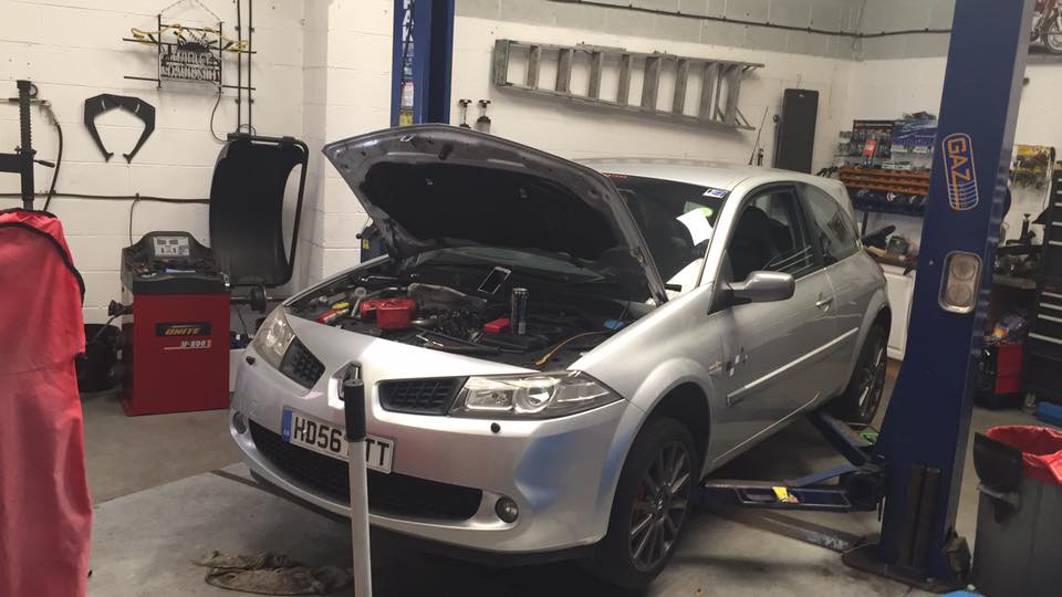

Took another trip to see Mr. Black today .. This time for timing belt, aux and water pump, done in roughly 2 hours which i was amazed about!
Last things left to do is a steering arm bushing (?) and a steering arm iirc .. and then its onto tracking it and having a lot of fun!
