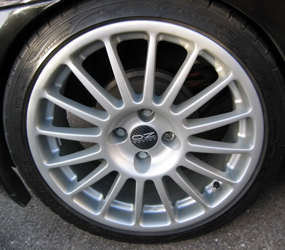

MrBillyUK this wheel was badly kurbed used metal epoxy on it then when it went hard sanded it down... try and get as much excess of as yo can before it sets cos its hard to sand down, heres a pic of one of the wheels I refurbed which was quite badly kurbed.
Good job there mate . They look mint :)

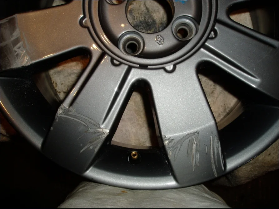

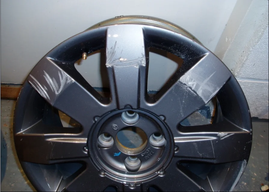

A couple of pics

I would get it blasted and see how deep they look then. Spray it with hi-build primer and take it from there.
god that is kirbed.
did they drive up against a brick wall. i wouldnt wanna take that task on.

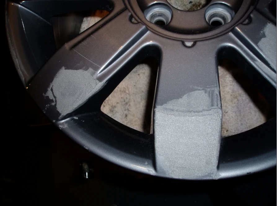

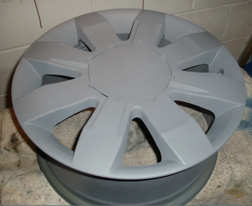

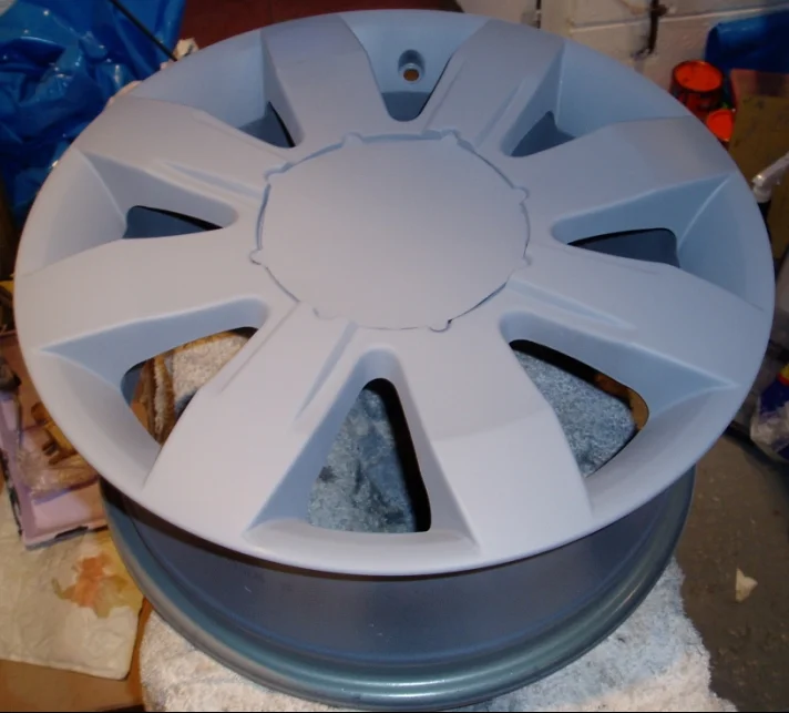

A couple of updated pics .
Filled , sanded , first coat of primer . In between washing the car in the freezing cold :( .
Time to eat now , sand the primer later tonight with some 1500 - 2000 grit .
Not bothered if its not 100% perfect as long as it looks 100% better than it did , only a spare after all .

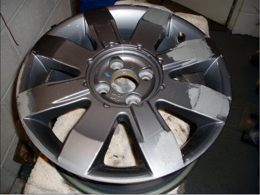

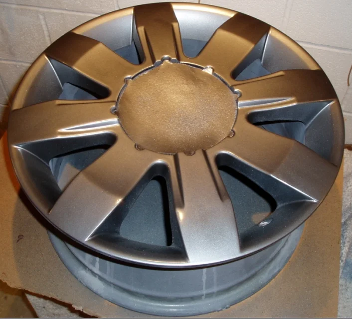

A couple of updated pics . Need to let it dry then wet n dry . Then a couple more coats of colour and lacquer , work n time permitting .Results are lookin' promising , not exactly 100% colour match but near as damn it for the spare wheel :)

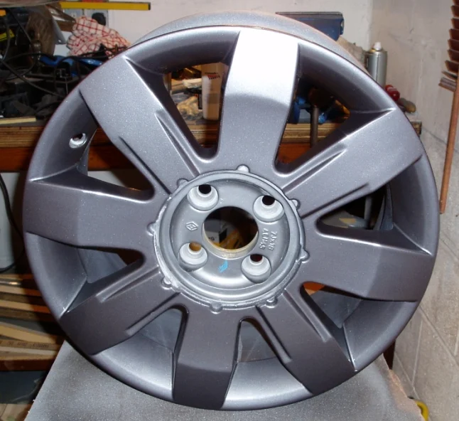

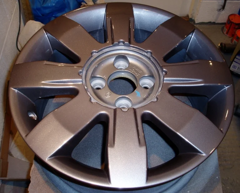

Finished at last :)
Process :
Cleaned wheel with AG Engine and machine cleaner . Washed then dried .
Filled all the scratches with Upol D Metallic filler .
http://www.paints4u.com/productsbyC...inSelection=2&SubCategoryID=10&Subselection=4
Wet n dry 320 grit .
Primed and sanded 320 grit , not too smooth so the top coat would key to the primer .
I couldn't find any local motor factors who could make up the the anthracite paint , not even Renault could supply it or new anyone who could . Thanks Renault ;)
Got the local motor factor to make up some Rover storm grey with a touch more red in it .
A couple of thin coats of storm grey then 1500 grit wet n dry . Then final couple of coats and left to dry for 24 hours .
3 coats of clear , 2000 grit wet n dry . Washed then Meguiars scratch X .
I'll AG super resin polish then extra gloss protection when i get time just to add some protection .
New tyre to be fitted then in the boot she goes for a spare .
Pretty happy with the results and it was pretty easy to do :)
Just a recap of the pics and final pics :

Final results :)
MrBillyUK !
Cheers :)
Final pics look a bit ropey , not the best shed to take pics in ,lol ;)
