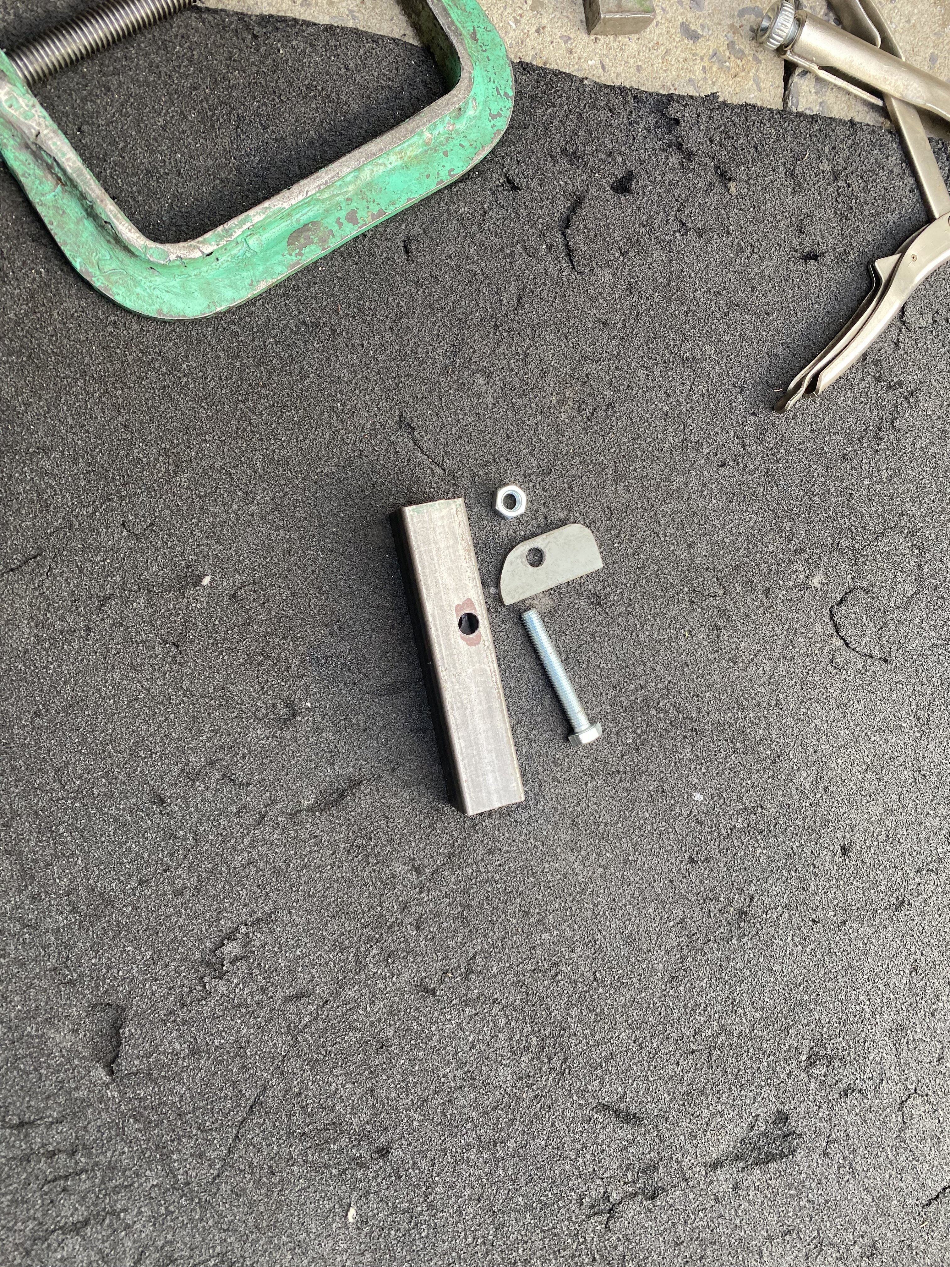

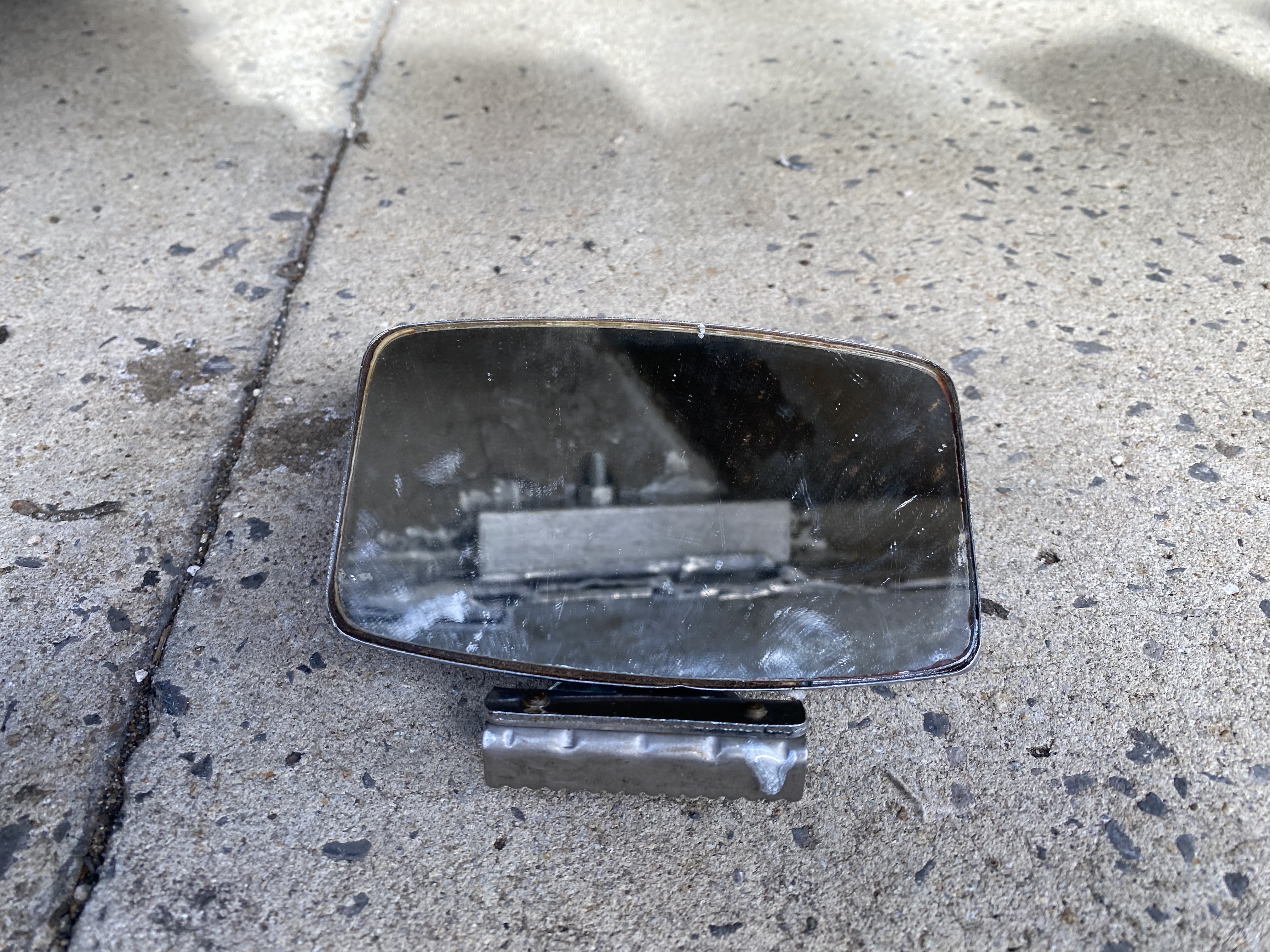

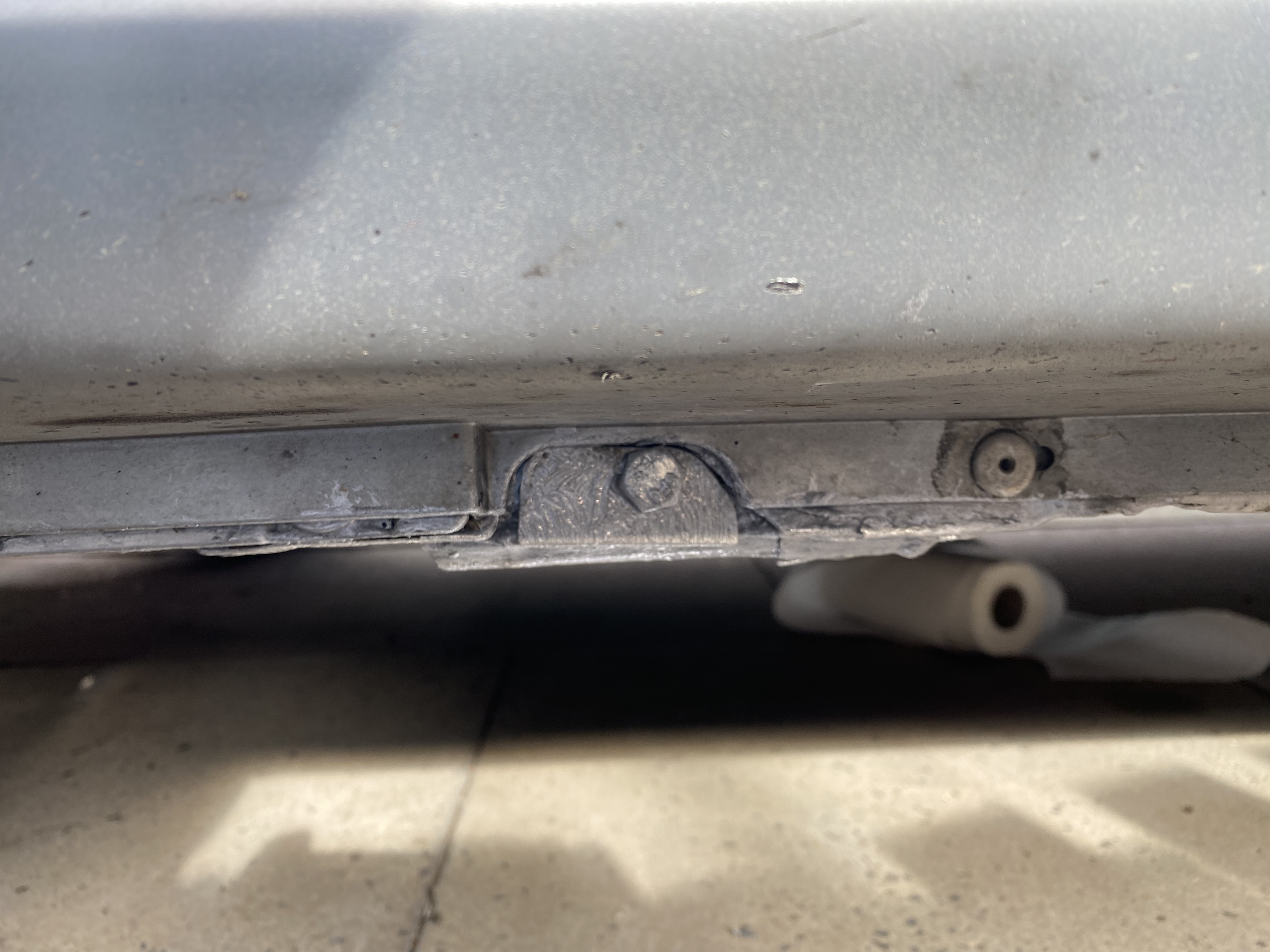

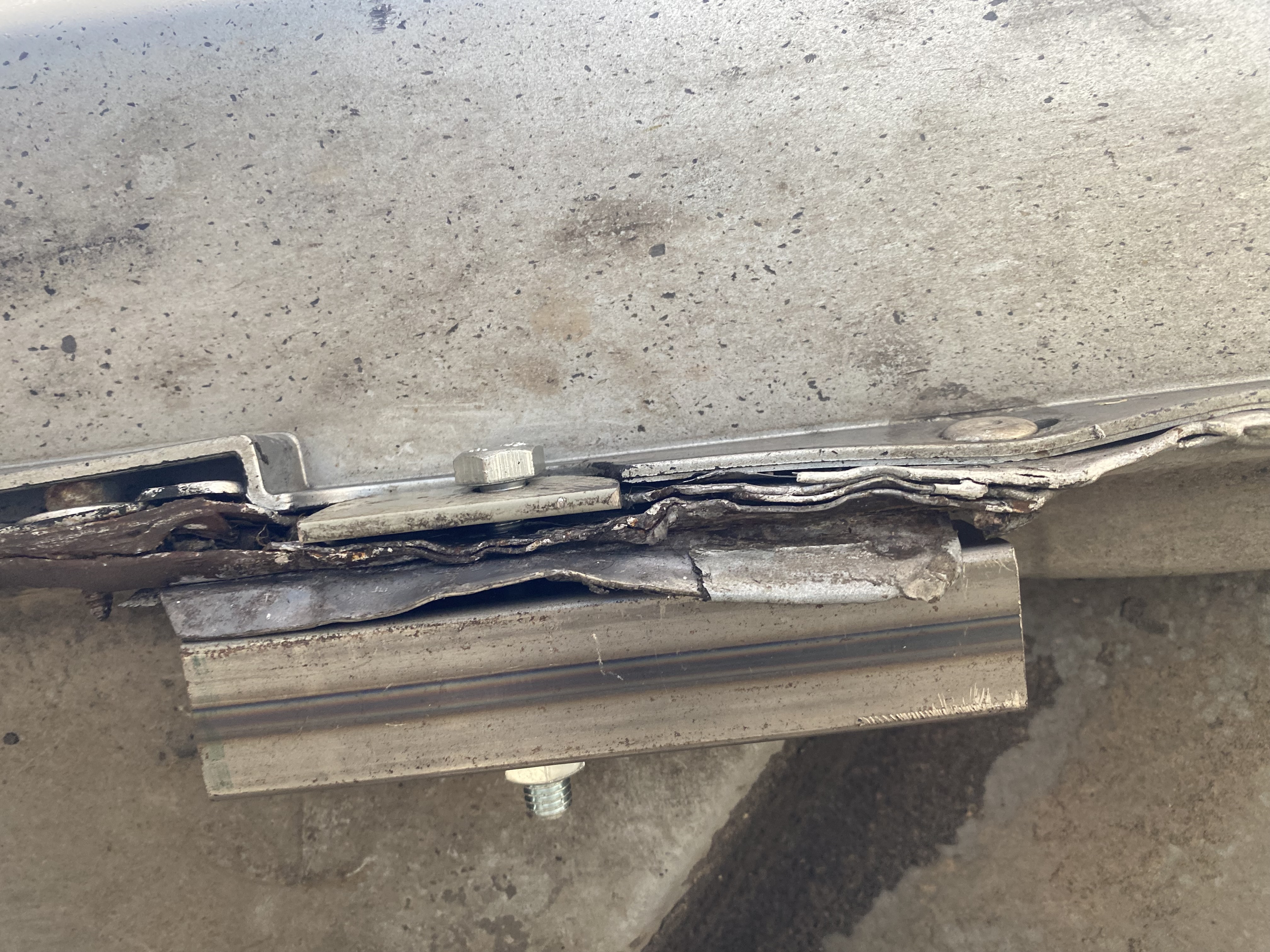

Bend em back then bolt a bit of box section behind them 👍
Matt Cup
  Leon Cupra
Here are my fronts, but a bit of fiddling and you can do something similar with the rear.
gudger12345
  Ph1 172
i was tempted to fit these to my ph1 when all the welding work was undertaken but i decided to just jack off the front wishbones.
