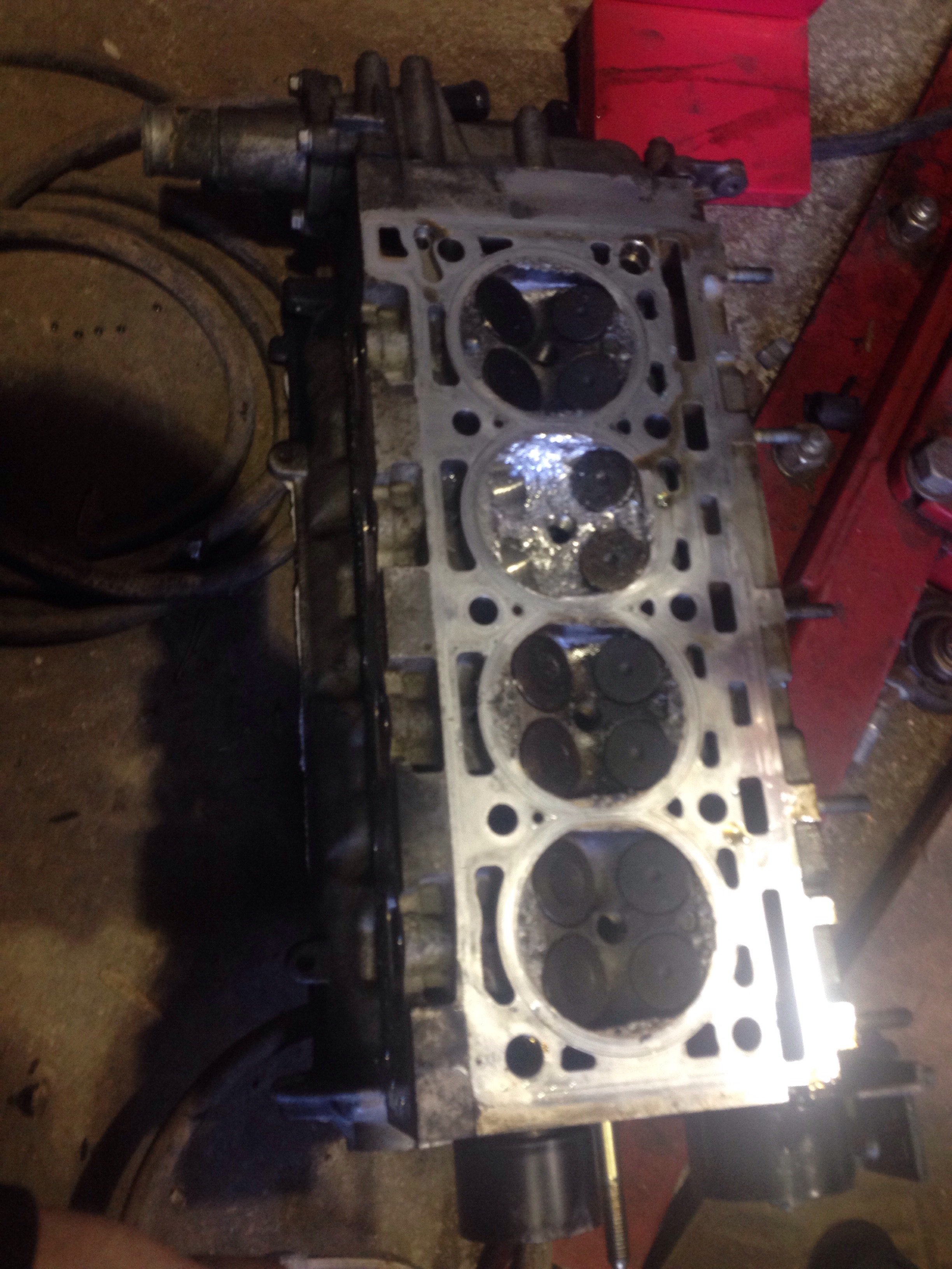

keep a eye on your alternator belt guys, bit came off mine got in timing cover, it slipped its timing and bent few valves.. gutted, thats but a stop on the miltex exhaust i was saving for ha.

It'll look like this

That one failed at 2000rpm. I've seen no end of pattern valves fail. Renault or Supertech imo
i appreciate your advice and letting me no of pattern valves, and wish out of peace of mind i got genuine valves now, the boy has already started rebuilding head he does a lot of engine rebuilds and said AE are fine ?? just out of curiosity did engine with dropped valve have standard cams,
Yup 100% standard. Seriously, save yourself the pain of one letting go and get genuine valves in there. It will be new engine time soon otherwise.
