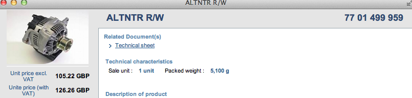

The 172 cup is 75 Amp,I believe.THat`s a 2 year old price from Renault for a 172 cup.If the brackets/pulley are the same,I cannot see the harm in putting 110 Amp on a cup,but not the otherway round
